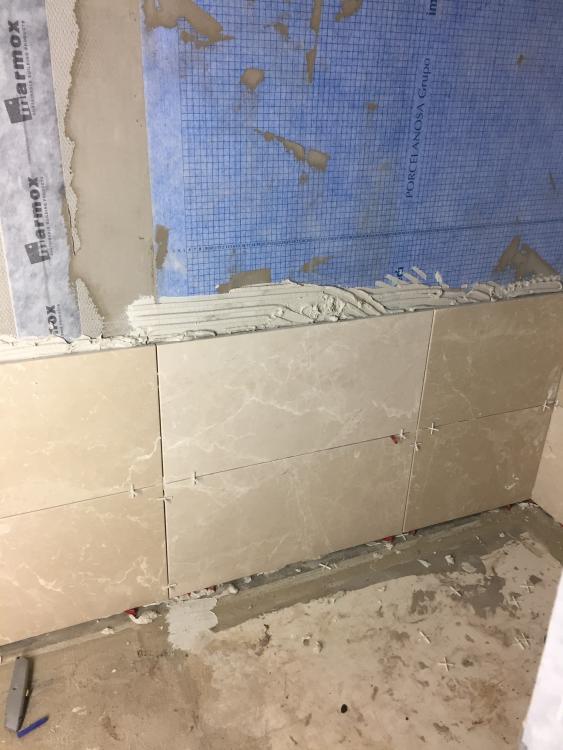

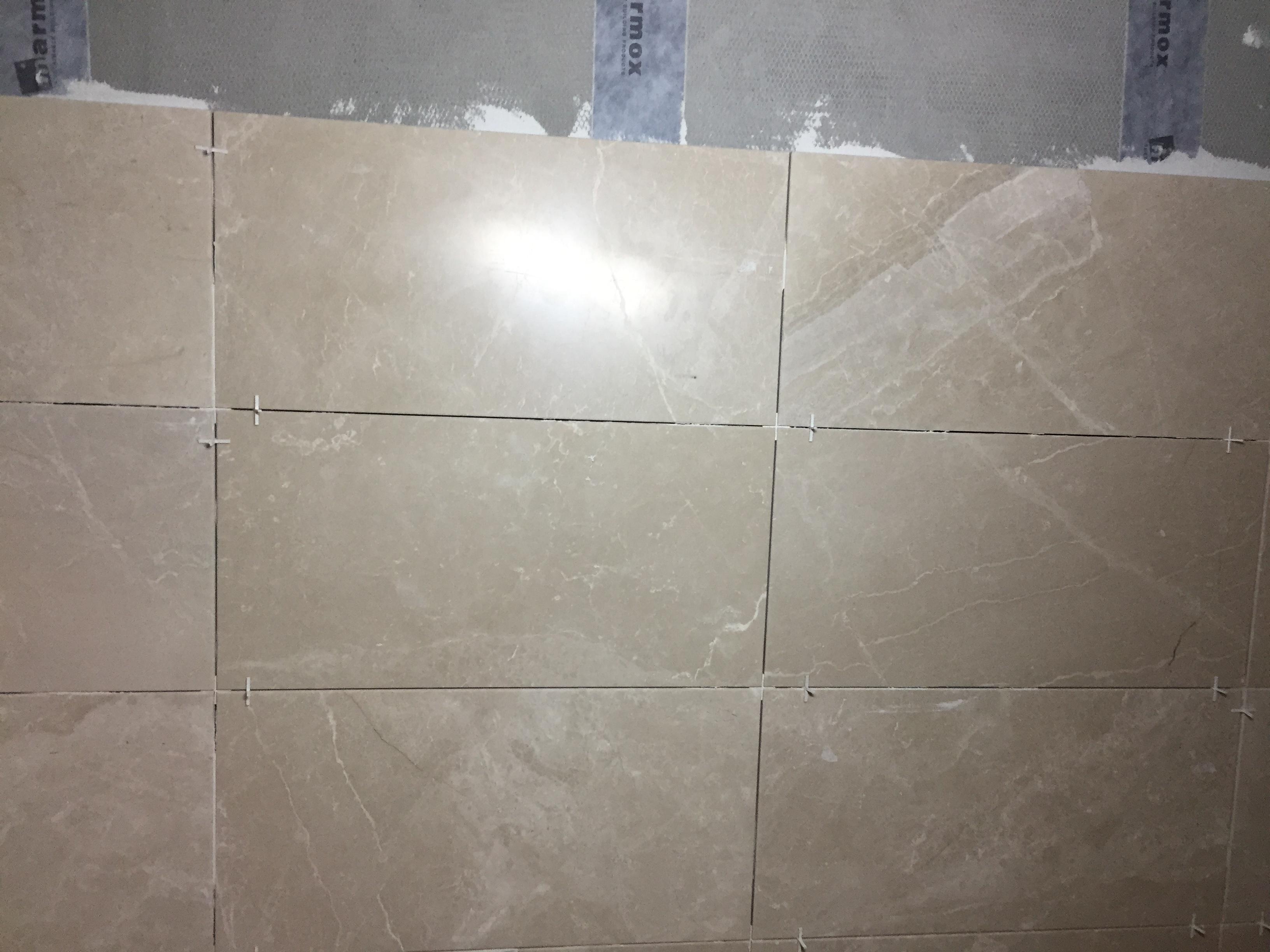

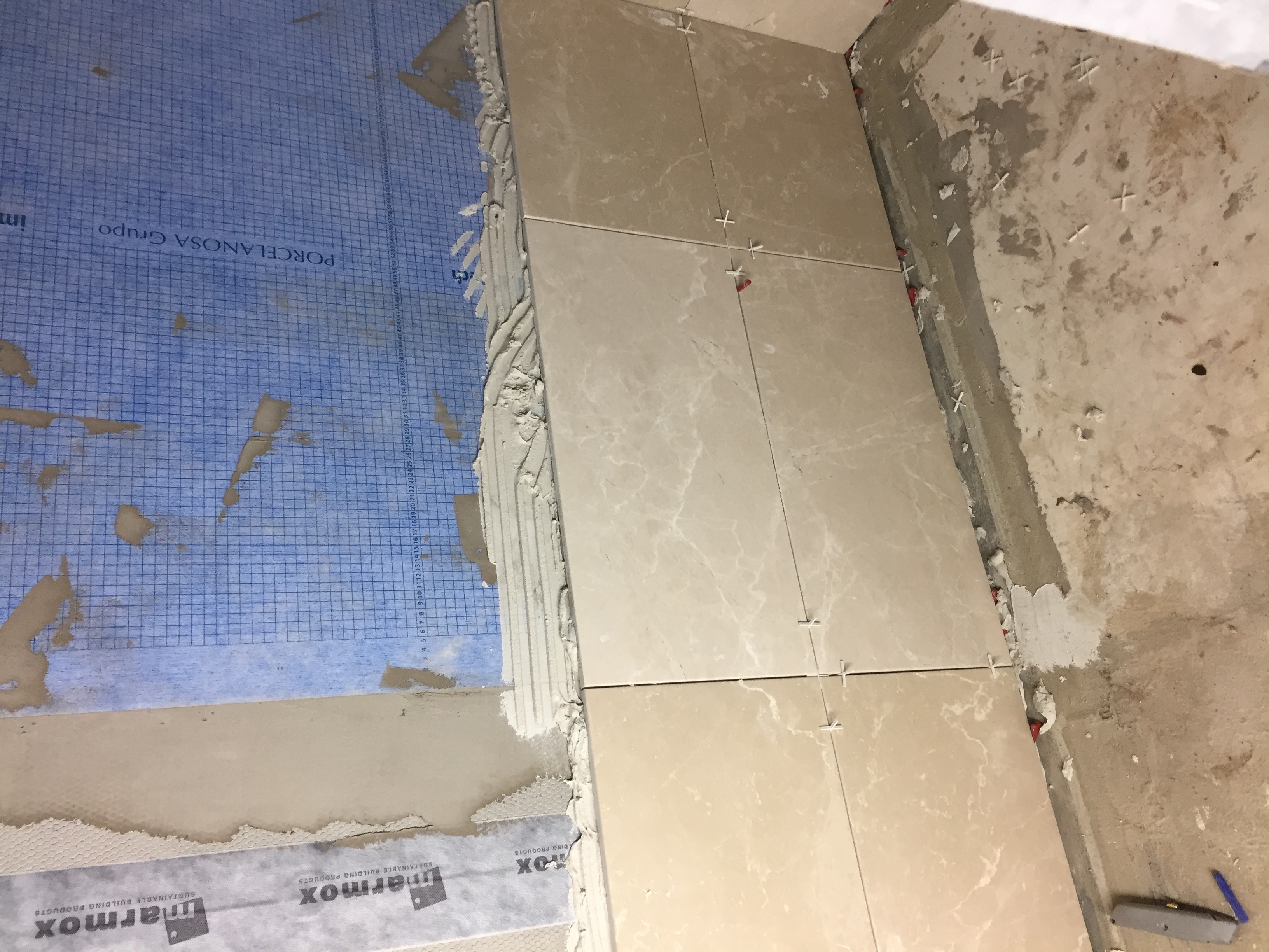

AliG Posted January 31, 2018 Posted January 31, 2018 Hi, Tilers started on our en suite today where we have splashed out on marble tiles, something I have never dealt with before. Builder immediately had them stop as the colours looked odd. All the boxes of tiles have the same batch number/shade number but there are lots of different shades. They spoke to the supplier who said that they are supposed to be mixed. I only heard about it tonight. Before I speak to the supplier, is this normal for marble tiles? They are a natural product so I guess you get variation, but this looks pretty extreme.
nod Posted February 1, 2018 Posted February 1, 2018 There correct in stating that it’s a natural product and you will get variations But these are two different colours I normally sort through them before starting Some will have much heavier vaining than others which is normal But the base colour should be constant

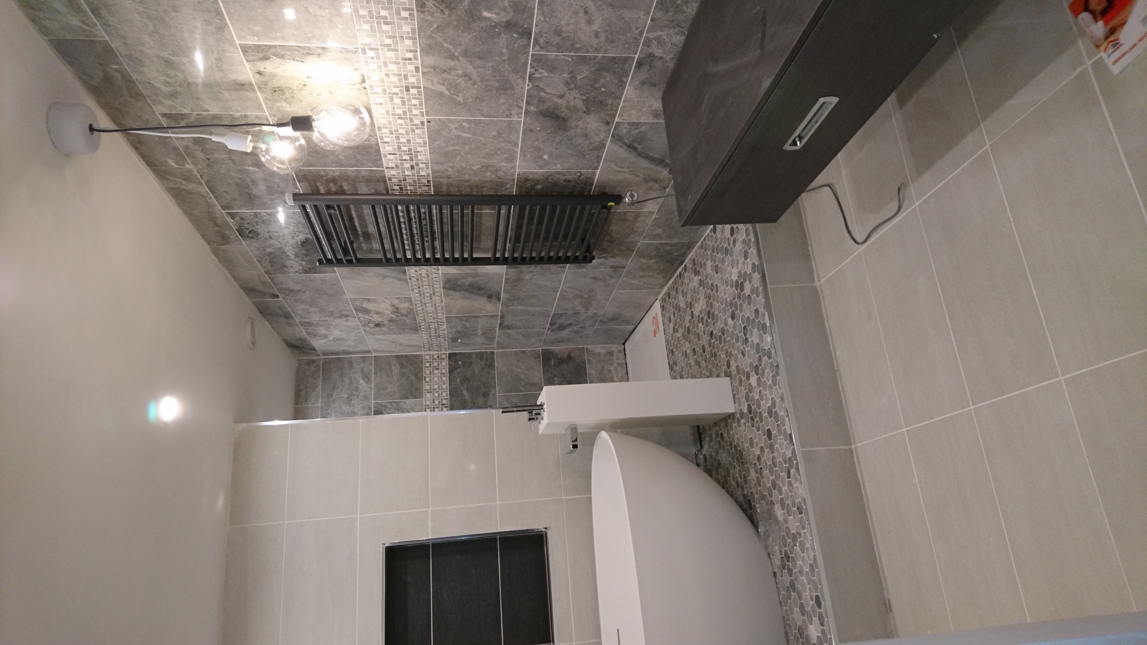

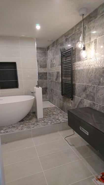

jamiehamy Posted February 1, 2018 Posted February 1, 2018 It is normal, but they should be sorted to spread then out rather than what has been done here. That said, these look like different tiles rather than variation in colour. I've attached a pic of ours, you can see some really dark ones in the mix. At the least they need to sort and spread them out rather than put light ad dark in a line.

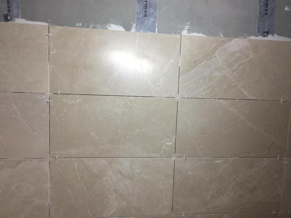

AliG Posted February 1, 2018 Author Posted February 1, 2018 They mixed them up and now they look fine. I think it was just bad luck that the first few came out looking like stripes and they didn't know that they had to mix them. I also suspect that it you take a picture straight on the middle tiles look a different colour due to the flash. 2

RichS Posted February 1, 2018 Posted February 1, 2018 I'd be a bit concerned it the "tilers" didn't know that they should mix them. That is standard practice for any tile.
Nickfromwales Posted February 1, 2018 Posted February 1, 2018 12 minutes ago, RichS said: I'd be a bit concerned it the "tilers" didn't know that they should mix them. That is standard practice for any tile. I disagree with that. Natural tiles aren't often encountered and some tilers will be doing it for the first time. Its the supplier that should be highlighting this TBH.
RichS Posted February 1, 2018 Posted February 1, 2018 58 minutes ago, Nickfromwales said: I disagree with that. Natural tiles aren't often encountered and some tilers will be doing it for the first time. Its the supplier that should be highlighting this TBH. I appreciate that, but mixing from different packs is common practice in a number of trades.
Nickfromwales Posted February 1, 2018 Posted February 1, 2018 35 minutes ago, RichS said: I appreciate that, but mixing from different packs is common practice in a number of trades. When it's man made you should be fine to keep taking as they come out of the box, it's only when good old nature gets involved that things go south. Large format marble effect is often a nightmare, with the last one I did having just a few boxes bought and the pattern repeated a lot so that kept me on my toes. I did my bathroom floors in travertine and I had to switch my OCD off and just lay them. Worst thing someone can say to me is "can you lay the tiles in a random pattern". That's me, head fried.
