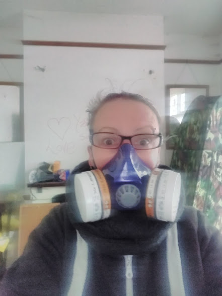

Yzzy Posted April 24, 2018 Author Share Posted April 24, 2018 (edited) Where does one get a full face mask? The half masks hurt my face and I end up with red marks around my nose/mouth that make me look like Droopy for 3 hours after! OK nevermind, just found them on Screwfix..... £100 plus!!! eeeek... will stick to Droopy... Edited April 24, 2018 by Yzzy Link to comment Share on other sites More sharing options...

Yzzy Posted April 24, 2018 Author Share Posted April 24, 2018 Going to give these a try, they look less heavy.. https://www.screwfix.com/p/gvs-elipse-half-mask-respirator-p3/6922g Still P3 though so Link to comment Share on other sites More sharing options...

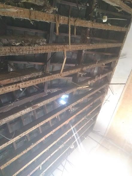

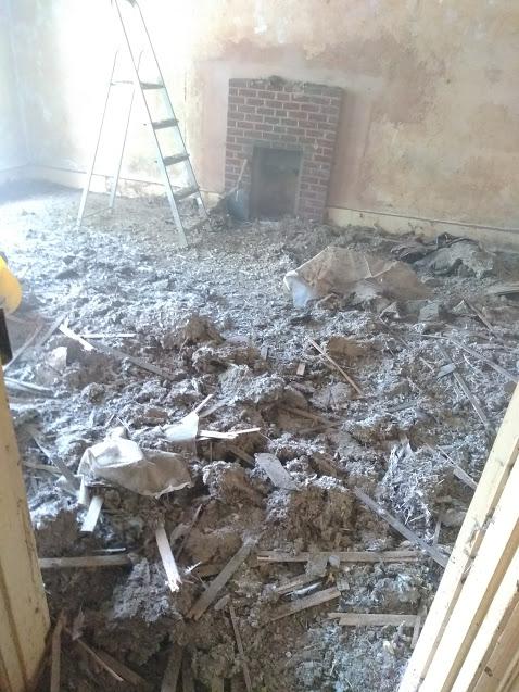

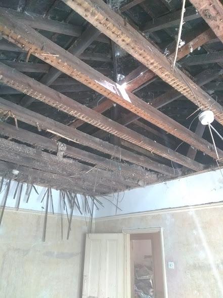

Yzzy Posted April 25, 2018 Author Share Posted April 25, 2018 Oh my goodness, we are in pain ha ha.... such hard work. Would be SO much easier if it wasn't for the mega blanket of bird shit we have to bag up. I have spent my afternoon up a ladder ripping down stubborn laths and getting a lovely shower of crap over my head for the effort... wouldn't be so bad if I didn't have dreadlocks! Anyway, room one on the ceiling destruction is now DONE and bagged up and swept, took us all in all 5 days, not all of them were full days like yesterday we only did a couple of hours. Moving on to room 2 tomorrow... urghhhhh On the plus side the P3 masks from Scewfix (GVS Elipse) are bloody amazing!!!! I can actually breath, don't get as sweaty, it doesn't hurt me at all and well ok so I still end up with a red 'droopy' mark on my face but... For £18 it's fab! Photos show just before I tidied up stray laths. Link to comment Share on other sites More sharing options...
Yzzy Posted April 25, 2018 Author Share Posted April 25, 2018 ooohhhhh meant to ask.... All the Lath nails.... I say hammer them flat into the Rafters and the plaster board will go ok over it. Hubby says we need to get on ladders and pull each individual one out... This makes me sad. Link to comment Share on other sites More sharing options...

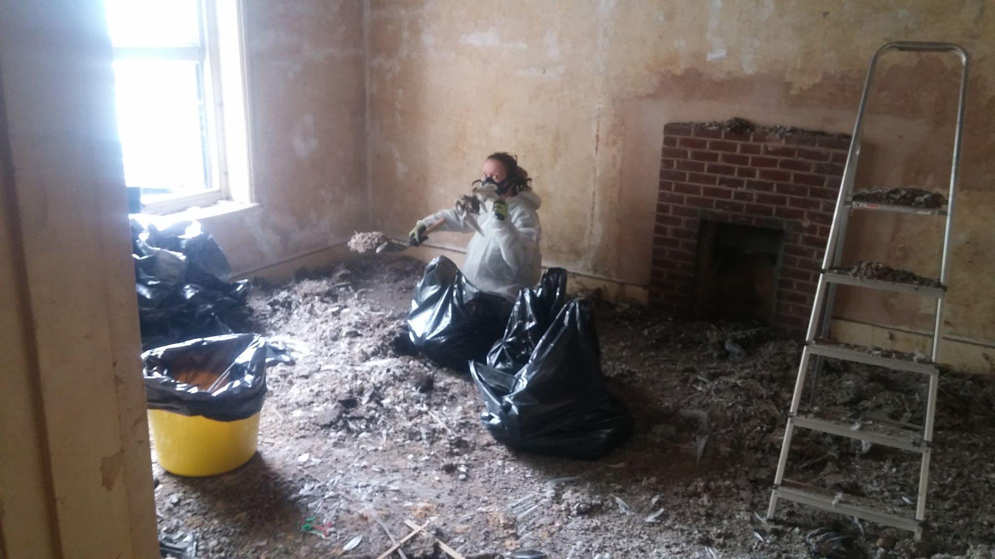

Yzzy Posted April 25, 2018 Author Share Posted April 25, 2018 Ha ha, Hubby just sent me this, me on my knees surrounded by poop! This wasn't too bad really, I just sent my mind of on thoughts elsewhere... but standing in the almost open attic stamping down the ceiling was not so much fun, looking down 10 foot and realising I've been running around that attic since 1979 and not even thinking about what if I tread between the Rafters! I didn't realise I didn't like heights until today! LMAO!!! I have to do it all again ! Link to comment Share on other sites More sharing options...

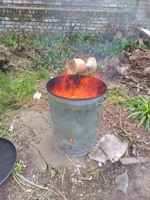

Yzzy Posted April 27, 2018 Author Share Posted April 27, 2018 So I got cold and thought... build a fire with the laths! OMG they burn fast and furious don't they? Is it the pigeon poop fueling the inferno? Almost managed to burn a whole ceilings worth in about 45 minutes! Plaster is now off room number 2, today we bag up the plaster and start ripping laths down... and more pooooooo 1 Link to comment Share on other sites More sharing options...

Yzzy Posted April 28, 2018 Author Share Posted April 28, 2018 When I was about 13 I'd been tending to a bonfire in that exact spot (but I was braver so no metal bin, direct on the floor!) walked into the kitchen, my dad used to run his business from the back workshop and his worker, Peter was working late and making himself a coffee... Peter: "Peww, you stink!" Me: "Yeah, I'm burning stuff outside, it's sooooooo beautiful" Peter: "You're always burning stuff out there" Me: "I know, I love fires, they look so magical.... actually ... I think I may be a Nymphomaniac" I had NO idea why the guy was almost choking on laughter until Mother walked in wanting to know what the fuss was all about so I told her, she laughed and suggested I go grab a dictionary... 3 Link to comment Share on other sites More sharing options...

Yzzy Posted April 29, 2018 Author Share Posted April 29, 2018 On 25/04/2018 at 19:33, Yzzy said: ooohhhhh meant to ask.... All the Lath nails.... I say hammer them flat into the Rafters and the plaster board will go ok over it. Hubby says we need to get on ladders and pull each individual one out... This makes me sad. Anyone know? Also.... is there a vacuum cleaner that we can buy / rent that is strong enough to suck up piles and piles of pigeon shite? It's all very well bringing ceilings down and ggetting it out the attic but I now have RSI on my right thumb joint from shoveling the plaster and crap up ... would be SO much easier to suck it up! Link to comment Share on other sites More sharing options...

Russell griffiths Posted April 29, 2018 Share Posted April 29, 2018 Pull all the nails out (sorry). Forget ladders though, get a couple of hop ups and a scaffold board so you are at a comfortable height to walk from one end of a joist to the other so you get a good rhythm going. I used a leaf blower on suction mode to suck up piles of loose loft insulation, just walk out to the skip open the zip and blow it into the skip. 1 Link to comment Share on other sites More sharing options...
