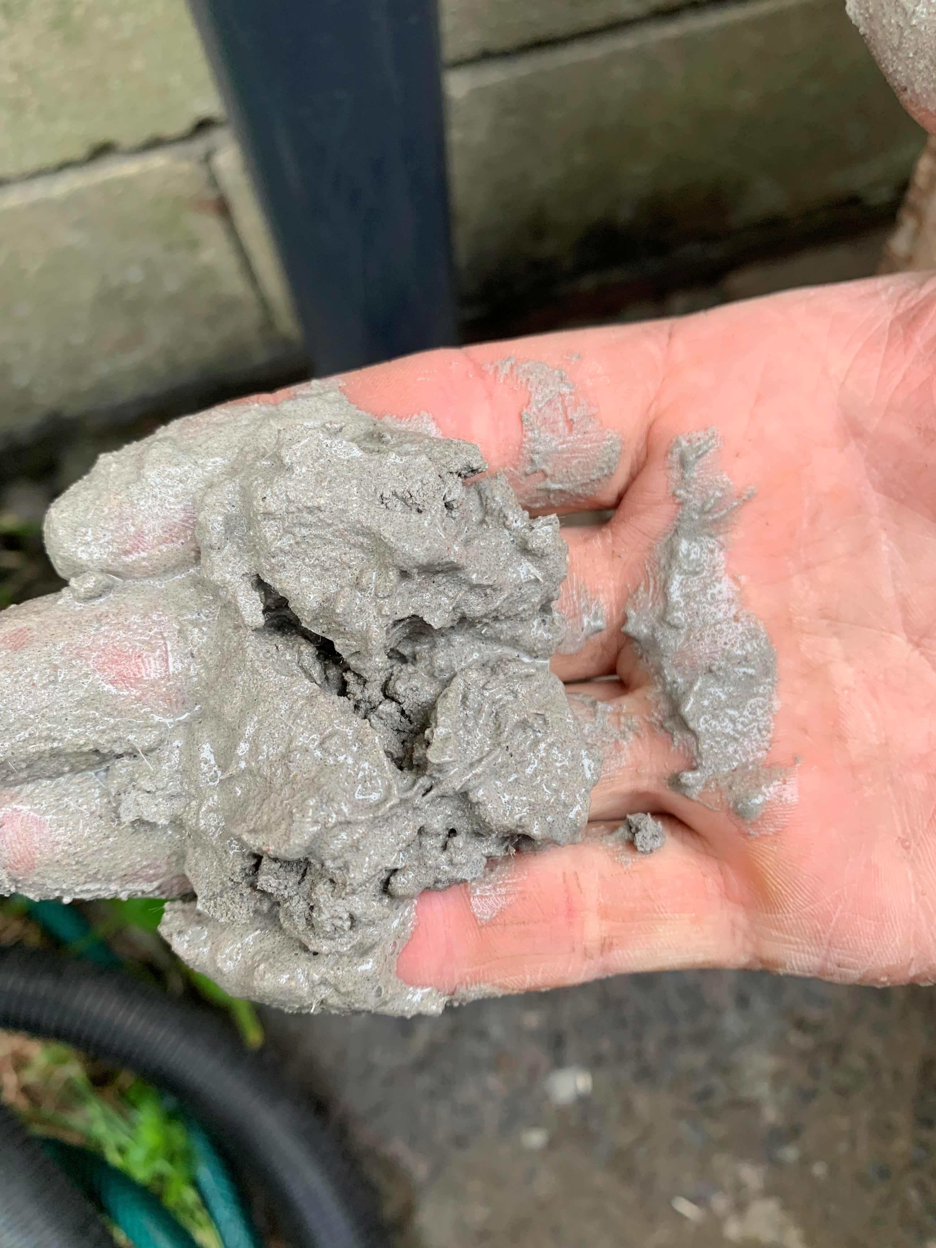

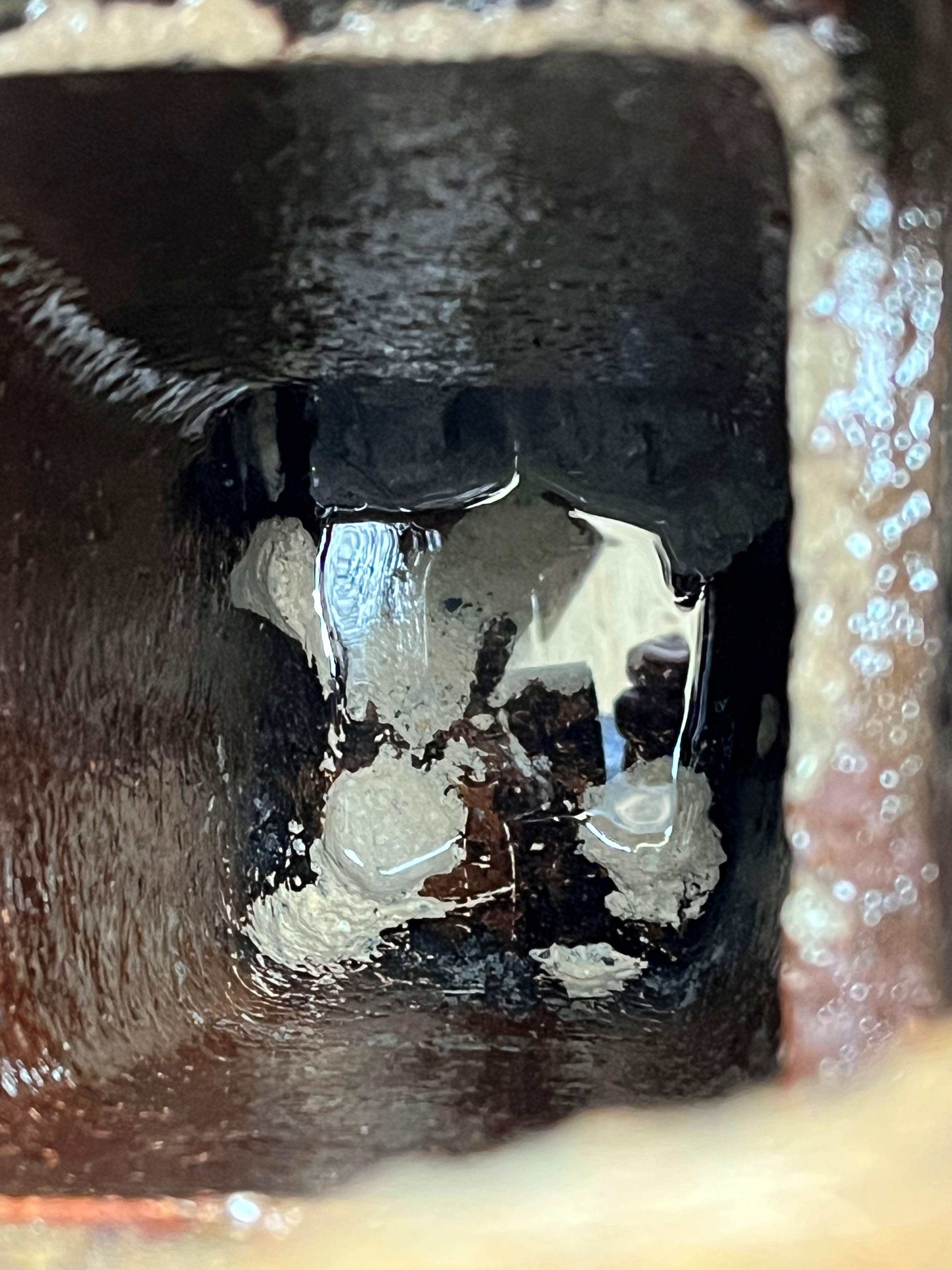

So our flooring contractor has managed to pour floor levelling compound down one of our drains !

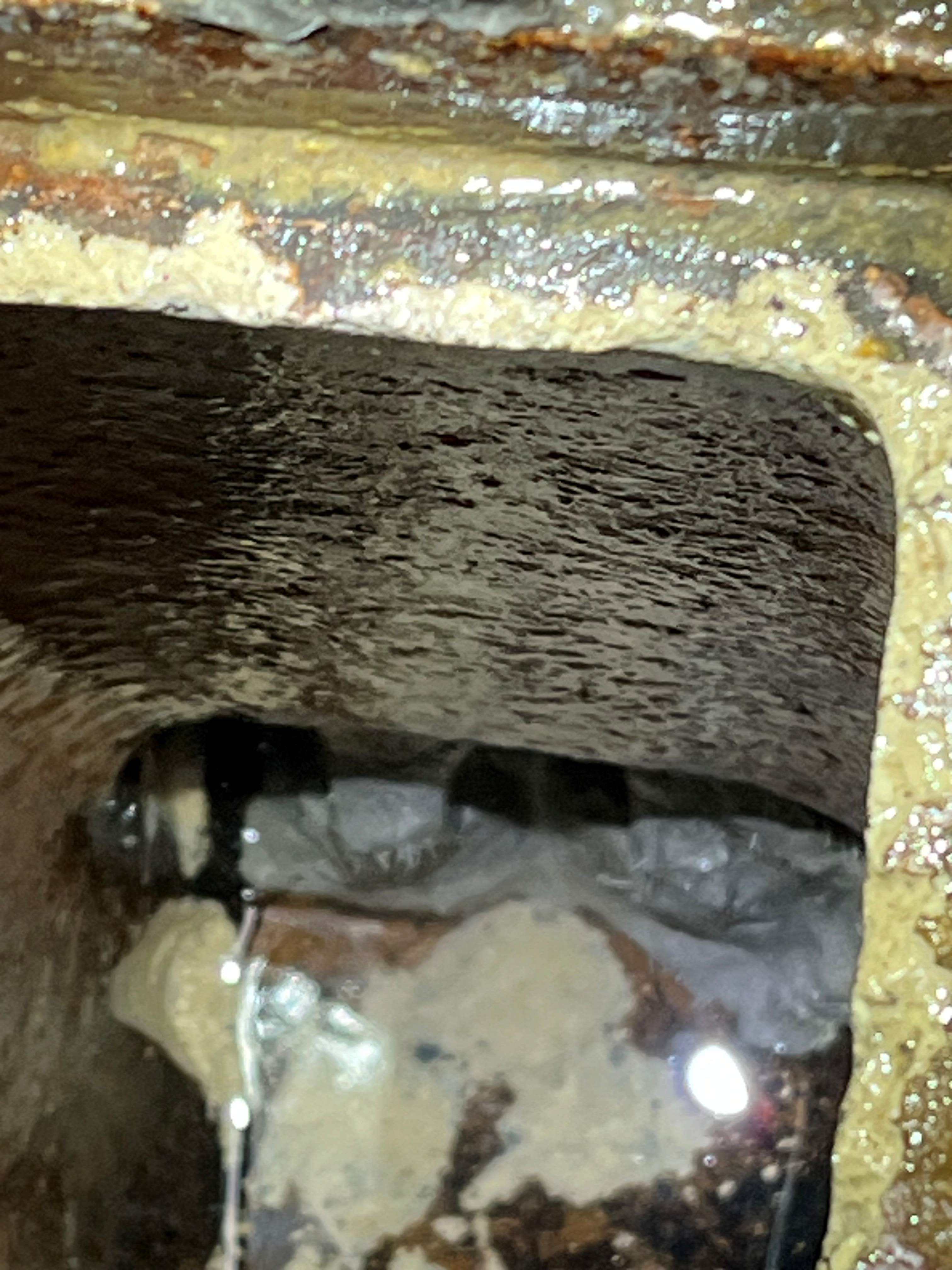

We have a rain water drain that is completely blocked at the u-bend.
Other parts of the drain had deposits.
Is there any way we might be able to unblock the rain water drain ? Some kind of solvent or acid ?
Plumber cleared some from the vertical part of the drain using a very long drill bit, but clearly won't go around a bend.
Drain pipe is clay. Levelling compound is Bostik C530 which has fibre reinforcement.

Keep it wet, keep the u bend completely full, if you let the air get to it it will harden.
get a piece of 15 mm hep 2 pipe and ram it around the trap, back and forth
take detailed timing of how long this takes and charge the flooring contractor

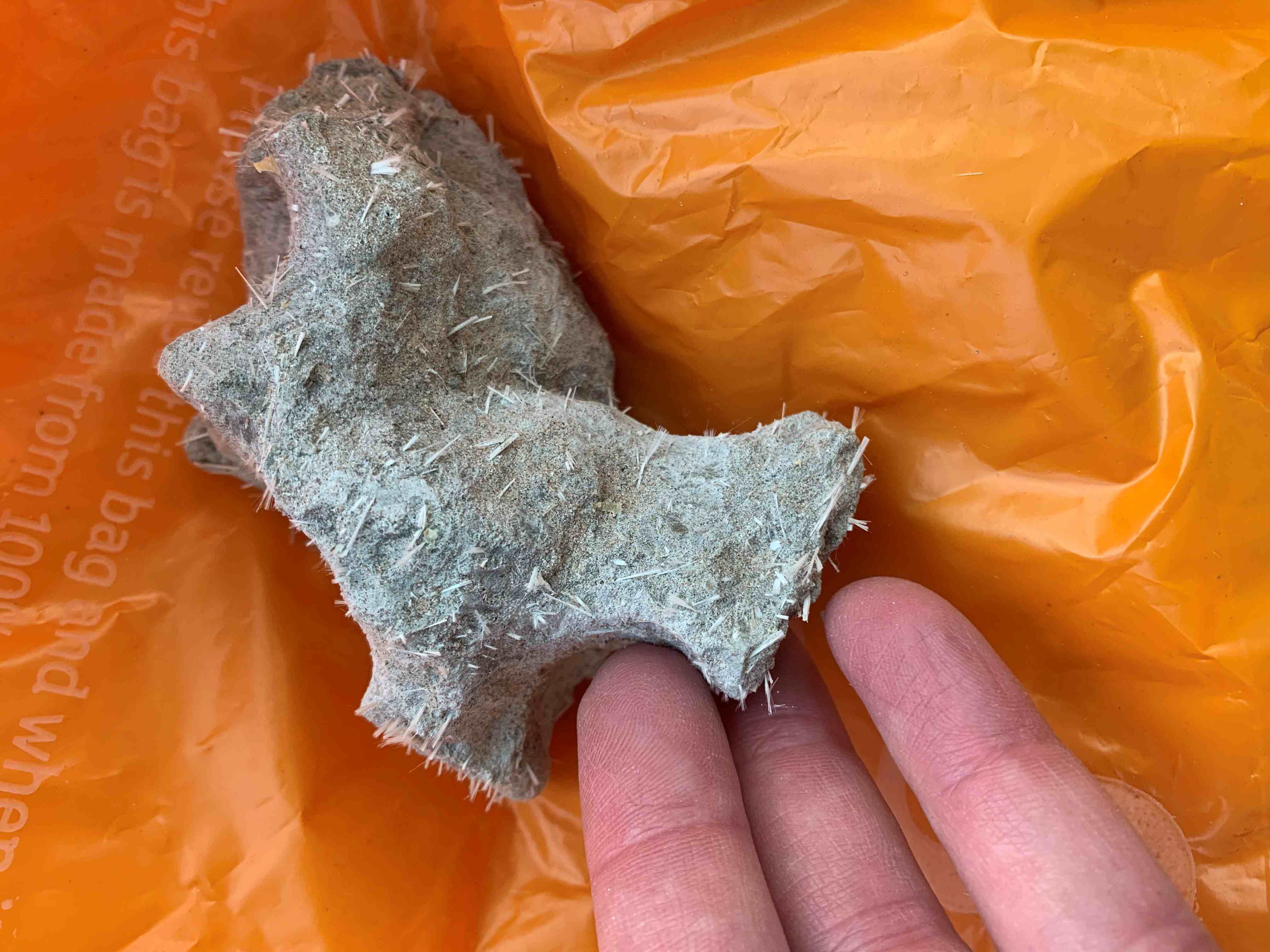

Here is a piece the plumber drilled out of the pipe vertical - see photo.
You can see the reinforcing fibres in the leveller, and you can see some sticking out in the middle photo above.
I doubt the 15mm hep 2 pipe is going to do anything TBH. The plumber was having to drill bits out.
That said I did get some bits out of the main drain pipe by ramming some 32mm MDPE up and down the pipe - but that was straight pipe and only congealed pieces stuck to the bottom of the pipe.
Plumber was of the opinion the drain would have to be replaced - but once you start on clay pipe that is 90 years old you are likely to end up replacing the lot.

Replacement seems likely, but clay pipes are pretty robust so it will likely only be a localised replacement. At least they didn't tip it down an internal drain...

Are you saying this was poured down the drain as a way to clean up at the end of the day and dispose of the excess goop?
I can only presume so as I didin't see it occur. There were two people, the older experienced guy was in the kitchen pouring and spreading the leveller, and then a monosyllabic youngster preparing tubs outside with water from the outside tap.
Work was done at the start of an extended dry spell. Some 7-10 days later we had heavy rain and SWMBO went to empty some waste water down the drain. Noticed the water level was very high near the top of the drain. Opened the main chamber shared with the neighbour but on our property and u-bend water was also high with stick test showing there was something in the bottom of the u-bend there too. Week later plumber finished fitting our water softener and so we investigated further with the help of his water vaccuum. Found leveller blocking the rainwater drain and stuck to bottom of main drain pipe run and in bottom of main drain u-bend.
Plumber explained and demonstrated how old clay type drain risers above the u-bend are actually permeable to water. So the drain doesn't necessarily completely overflow, water leaks out into the surrounding soil/ground through the sides. If you suck the water out of it, it refills as water from the adjacent soil/ground drains back into the riser again.
I called the manufacturer Bostik in search of some kind of solvent/acid that might attack the leveller but not the clay - he hasn't called back.
It might not be terrible hard If it is cleaning of tools slops then it will have been very wet and that makes it weak.

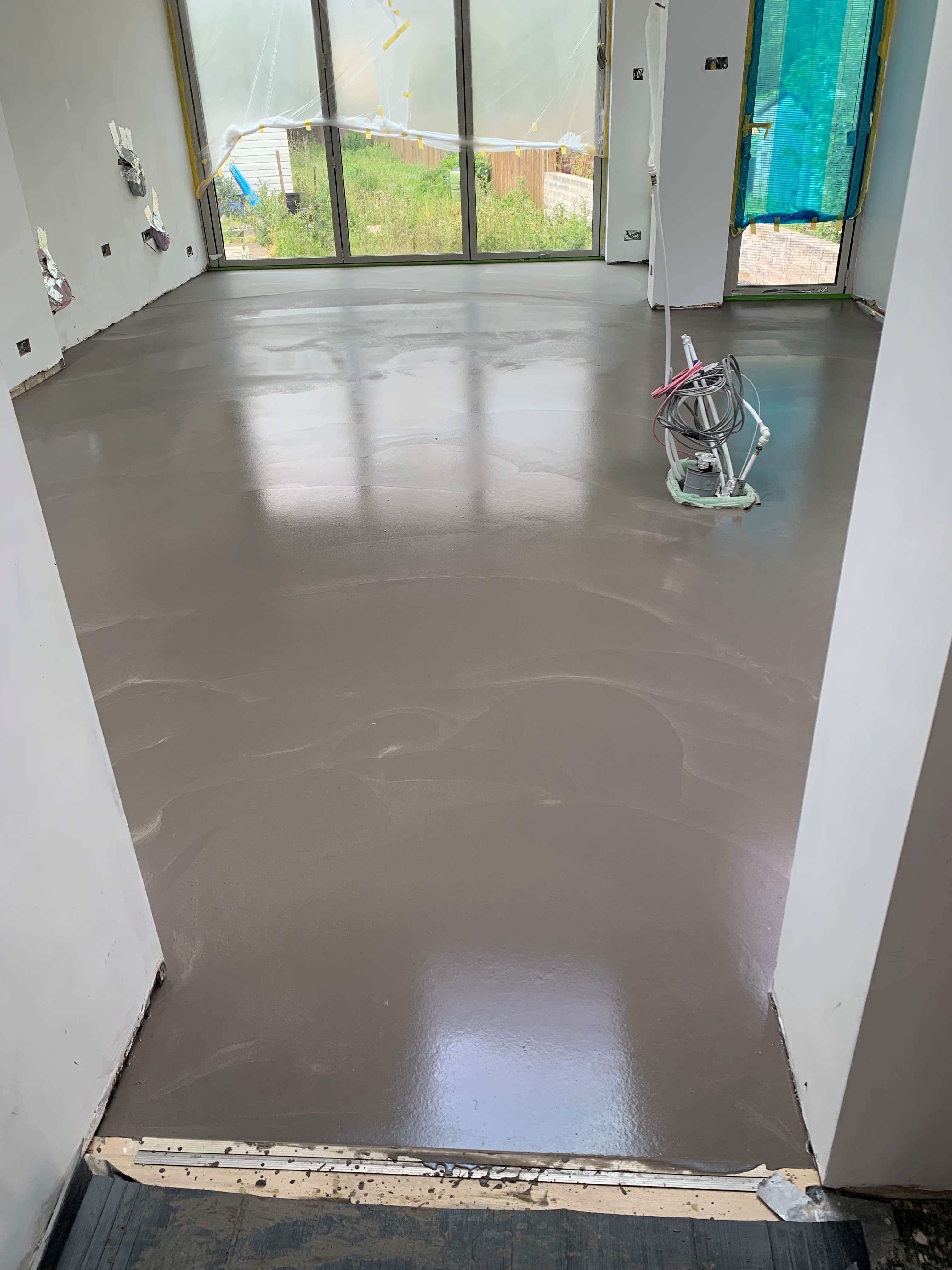

Good News...
Looks like I probably have a decently level floor at the right level after they came at the 11th hour yesterday. (see pics)
Can anyone advise on how precisely level I should be going for to get a good LVT result ? I believe there are feathering compounds which might be used on small variations ?

It will depend on the spec. Some is very thin and would show every ripple. Some is thicker and may have a backing.
What will it be stuck down with? It might be enough.
It may be better to gently grind than use filler. It looks pretty good.
You are needing smooth rather than level.

SLC looks good from here, and it is your floor layer who should now survey and advise; if it’s pretty good then maybe just a rub with a carborundum block may suffice, vs additional feathering with another compound.

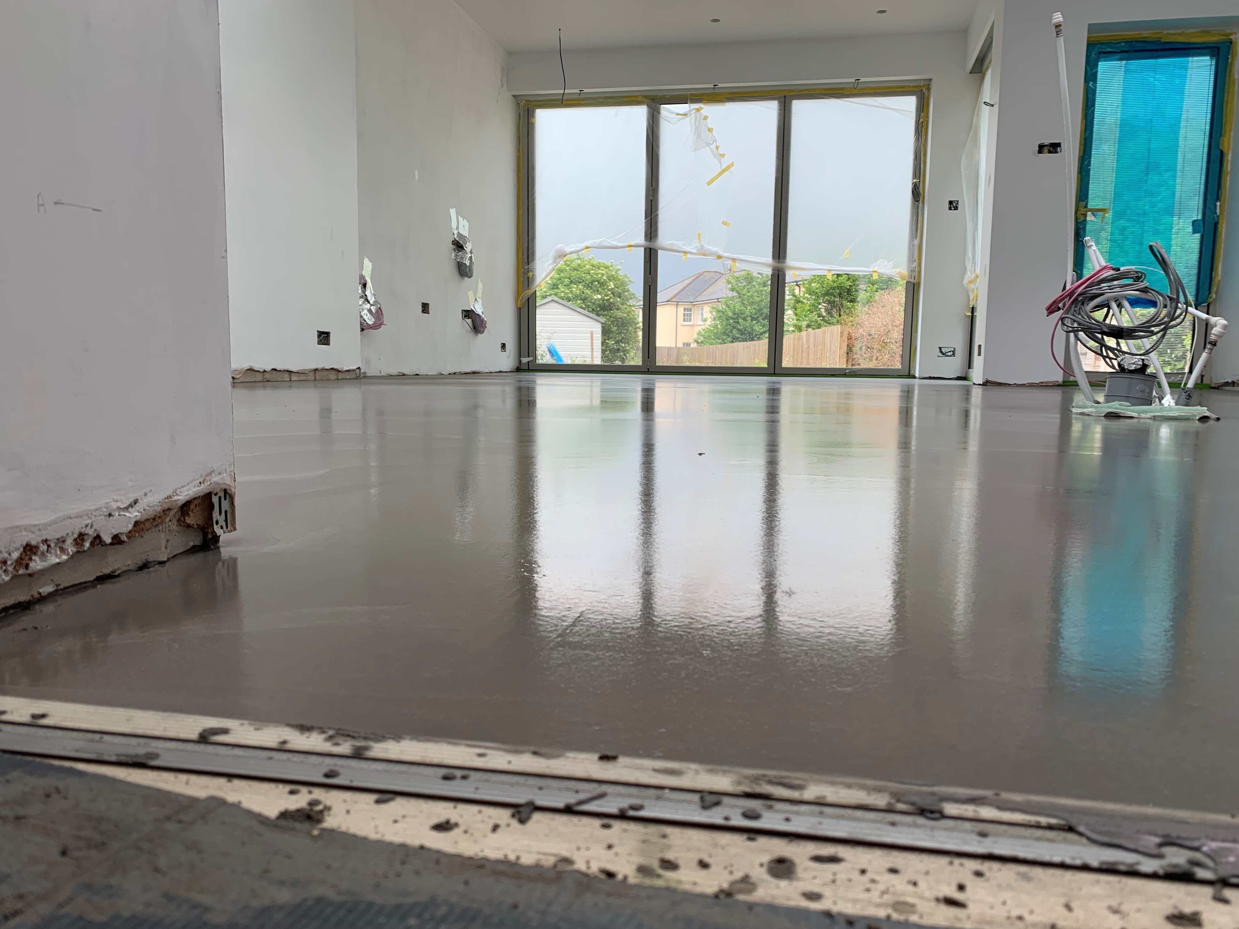

Guy from flooring company did come this morning with a measuring device (fold out metal straight edge and a metal wedge to measure gaps). Placed it around the floor and took some photos. Declared the floor to be very good (are they ever likely to say otherwise, unless it is obviously awful).
I haven't had a chance to go all around the floor with the 8ft stabila level that the plasterer has kindly lent me as yet.
Currently I would say it is good for height and good overall plumbness. There are certainly some places you can put the level and it will rock a bit when you press one end down, or show a gap under where there is a dip - maybe 2mm ish, maybe 3. (There was one place the guy put his instrument down across which looked a bit worse. I noticed he didn't push the wedge in then, but slid it further across the floor to where the fluctuation was less. so I need to have a closer look at that area.)
We are having Amtico spacia from front door, down hallway, and down to the bifolds at the back - so 15m without any threshold. Open the front door and look through the house. So don't want the look to be one of obviously unflat flooring. Also wouldn't want to be putting dining table and furniture in to find the legs are wobbly - but maybe I am unrealistic.
I am thinking seems good enough to deliver and fit the kitchen. Kitchen company have said they can leave off end panels and plinths and cut them later when the floor covering is down. (I think they trim the tops, but presumably don't scribe the bottom ?)
Soldiers were put in at about 2.3m intervals using my borrowed stabila, and I asked for 2/3 extra as they were doing it. I'd say it took 60-90 minutes to put down using a two bucket approach.
It took more than expected - 38 bags - and this time they robbed another order to have enough. Mainly because they didn't take full account of the target level for the flooring at the bifold end where we have a, not flush but low threshold and want to avoid a trip hazard. We will now be having 6/7mm on the suspended floor.
If it looks OK then it is OK.
