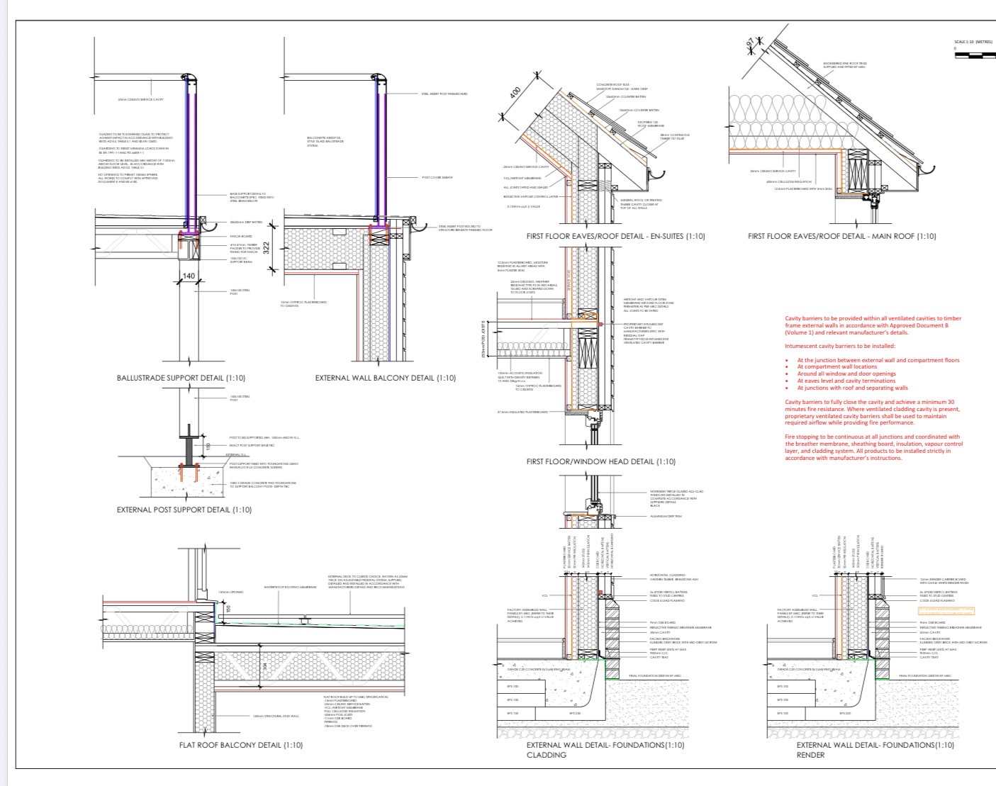

Do you have any section drawings to share what you have so far?

Apologies, forgot to post reply to this. Do we use the Rockwool type or the flexible pvc wrapped cavity barrier?
Thank you
Cavity barriers and firestopping is often left to "others".  They often get left out as nobody really knows what to specify or order or fit.  Were they specified and detailed on the architects drawings?  Rockwool would be a decent choice for non-vented and Envirograf for intumescent, vented rainscreen applications.  I would want detailed spec and drawings, so nothing gets missed on your order or on site.
Advice please re fire rated mineral wool cavity closure. We will be having part timber clad and part render on our MBC timber frame airtight house. Do we need different types of cavity closure according to surface. No. ADB lists the types of cavity barriers to can use - and as long as they close the cavity they should be fine. Normally 38mmx38mm timber to the perimeter of windows and doors or bagged mineral wool by Rockwool.
What about ventilation? The cavity needs to be ventilated (and drained). Where a cavity closer bridges the cavity vents and a drain should be provided.
You need different things for the different finishes.  Ours - timber frame (MBC) will be part stone clad - off SurCav and part Wood clad.  The whole thing needs to breath, but our stone mason is used to putting in what he calls fire socks to the Surcav bit.  And we'll be using something like VFB 60/60 from Tenmat as cavity closures in the wood bits.   I'm still worried about providing housing for a whole menagerie of critters so will be doing some more work on keeping them out, but MBC are only bothered about the need for ventilation and BC are only bothered about the fire risk so those elements are a must.  Critter barriers it seems can be "model's own".

What you are doing is on the face of remarkably tricky! Your builder is showing positive signs by asking about this. Yes you need different types of cavity closing and the cavity ventilation details change depending on location for example; above the windows, up the sides and under the cills! It takes a lot of experience to get this these details correct and coordinated with say MBC.
On 04/06/2026 at 09:36, Selfbuildsarah said:
apologies, forgot to post reply to this.
Unfortunately I can't read the detail as it seems to be a screen shot. The fundamental "hard thing to do" is to have a ventilated cavity, that get's closed if there is a fire.
I and others may be able to help. I might even post some of my drawings that show examples / give you pointers on the key things you need to consider. But first I would want to see what and where you have got to in the detailing stage. Can you post the actual drawings you have rather than screenshots?
