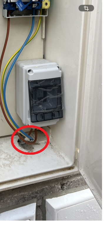

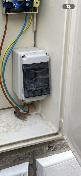

Best way to fix this mess
Needs to be in containment.
Yes.
But by what, can you suggest a product?

I have seen similar poor installed wiring.
What is the best way around this?
Can a flexible sheath be used?
How would the ends be terminated around the existing wires?
In all honestly I'm reluctant to make a definitive statement on that as it's really not my area. I call the electrician I work with! All I know is that you really need cables that are insulated and sheathed then made off correctly into stuffing glands either into a CU or junction box etc. or appliance and that's it's really good practice to run visible and exposed cable, even if it's insulated and sheathed, in trunking (unless it's something like HO7 or armoured and then it can take care of itself, but these also need to be properly made off into wherever they're coming from or going to). And also that you always use grommets into back boxes etc.
6 hours ago, SteamyTea said:
Yes.
It should enter into a junction box, fixed to the back of the cabinet.
From there it can be either trunking or conduit, trunking prob easiest here.
Basically you shouldn’t be able to see the brown or blue cables at all as they’re not PVC/PVC.
I assume this is a newish house built in the last couple of years.  Do you know who the house builders are?  Should be available from your local planning office.
Find their contact details and tell them that this is a non-compliant installation and demand that they provide electrician details for reporting to NICEIC / NAPIT.
Get as many neighbours invoilved as possible so they sit up and they might take notice.  See what reaction you get.
The only way that we'll stop all this cowboy bulldust is to hold them to account.

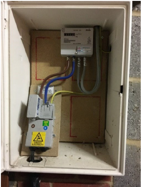

https://professional-electrician.com/technical/guidance-on-installing-equipment-within-meter-enclosures-niceic/
Whether, as @ProDave says, anyone pays any attention or the CPS takes any action whatsoever is another matter. As a mate of mine once said. If you're not a member of a scheme and you do something stupid, they come down on you like a ton of bricks. If you're a member of a scheme and do something stupid, they wag their finger and kindly ask you not to do it again.
1 minute ago, JohnMo said:
So, looking at the images there appears to wiring exactly the same as the OP, so whats the issue? What is non compliant?
Not to me. The images show double insulated tails not single insulated cables.

The wires look the same to me, first image from the liked website, the other the OP.  OP's not tidy and thrown in, but tails look the same - what is different, as I said simple terms would be good.  So anyone following this can actually tell correct from wrong.
In the circled area you can see that this is a T+E cable with the outer shealth stripped. This means the remainder of the cable is single insulated.
