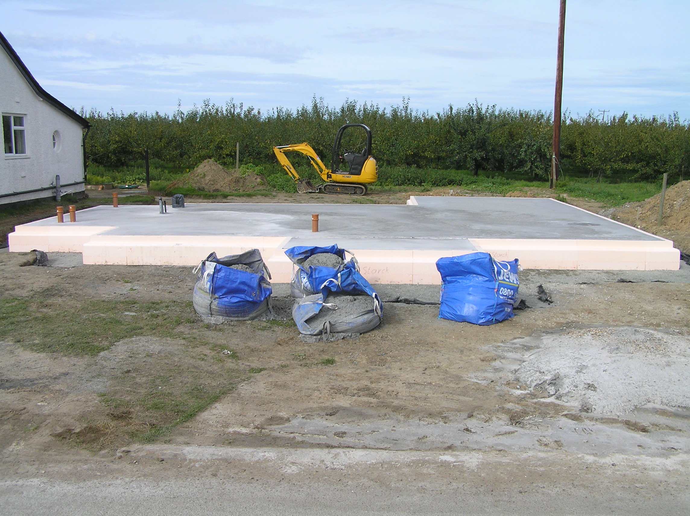

March 18Mar 18 Author 11 minutes ago, crispy_wafer said: Been thinking about sharing these... Found's werent as longs as yours and no pump, because we had reasonable access all round @flanagaj but if you wanted a quick vid or two, we did have a bit of rain between dig and pour, and we handballed a little slop out when an edge or two fell in. But that's the nature of it. If I remember rightly, we had a surveyer mark out the layout, sprayed blue line paint between the pins. Nothing too technical. We used pins in the sides of the trench for depth management. and a laser with staff for levels! What's the pea shingle for?
March 18Mar 18 14 minutes ago, crispy_wafer said: Been thinking about sharing these... Found's werent as longs as yours and no pump, because we had reasonable access all round @flanagaj but if you wanted a quick vid or two, we did have a bit of rain between dig and pour, and we handballed a little slop out when an edge or two fell in. But that's the nature of it. If I remember rightly, we had a surveyer mark out the layout, sprayed blue line paint between the pins. Nothing too technical. We used pins in the sides of the trench for depth management. and a laser with staff for levels! Did you have a normal mix or use that trench flow stuff? Your gear flowed pretty well. Fair play to the driver I wouldnt of thought they would drive on mud like that. What time of year was it?
March 18Mar 18 8 minutes ago, flanagaj said: What's the pea shingle for? I think its limestone type1 ish stuff for a base just to get out the mud isnt it?
March 18Mar 18 Yeah, type 1, just to give the slop a bit of body! and a 9t of sand for the brickwork delivered. That was late August, so ground pretty dry, but a downpour raised my pulse level a bit! Then well, I couldnt stop myself, in and out of the trench, when really I should have kept well clear. In terms of concrete, not sure, let the builder deal with that. The concrete firmed up pretty quickly though.
March 18Mar 18 It was probably just a standard mix it seemed like your wagon could get all around the building.
