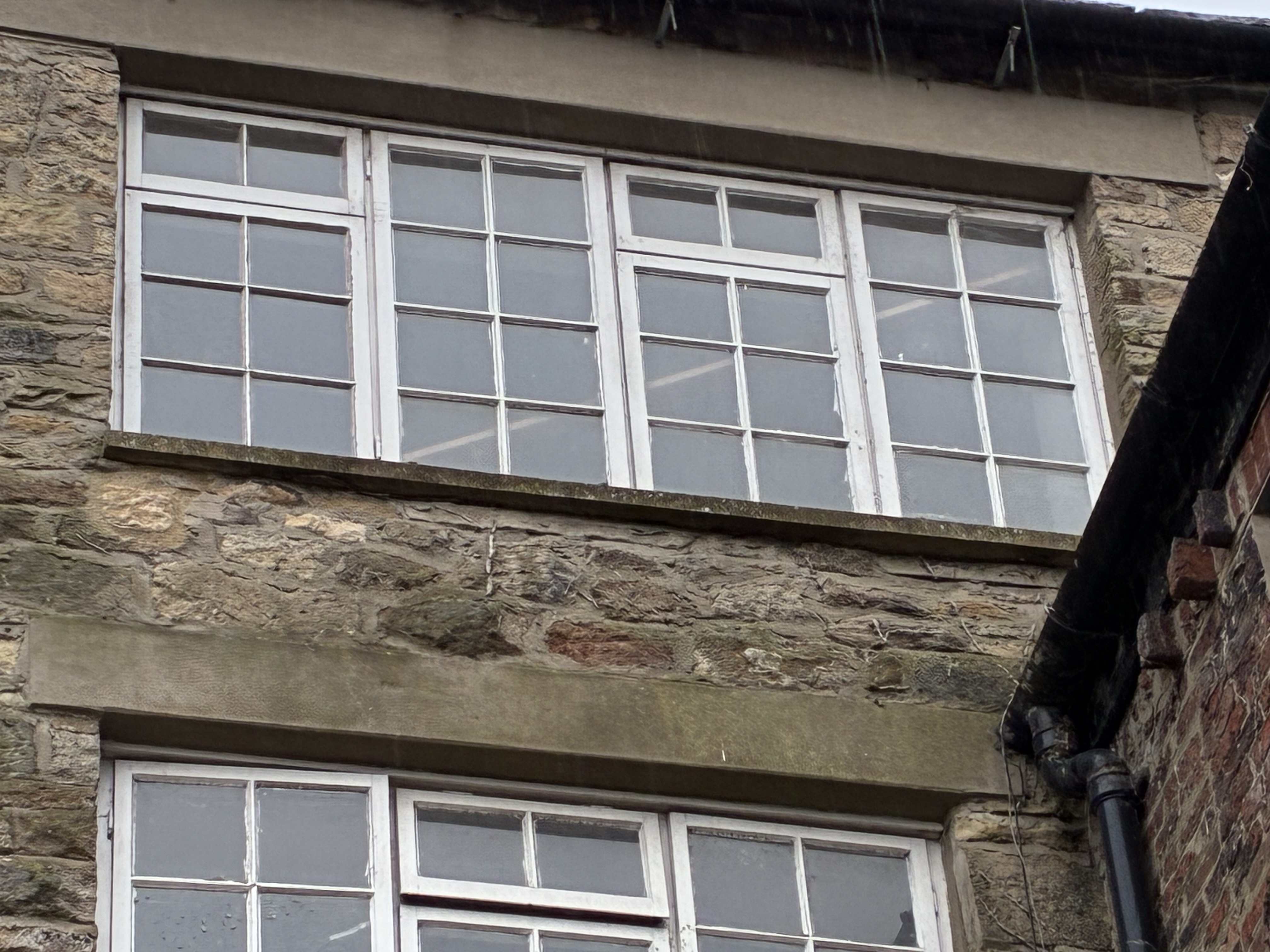

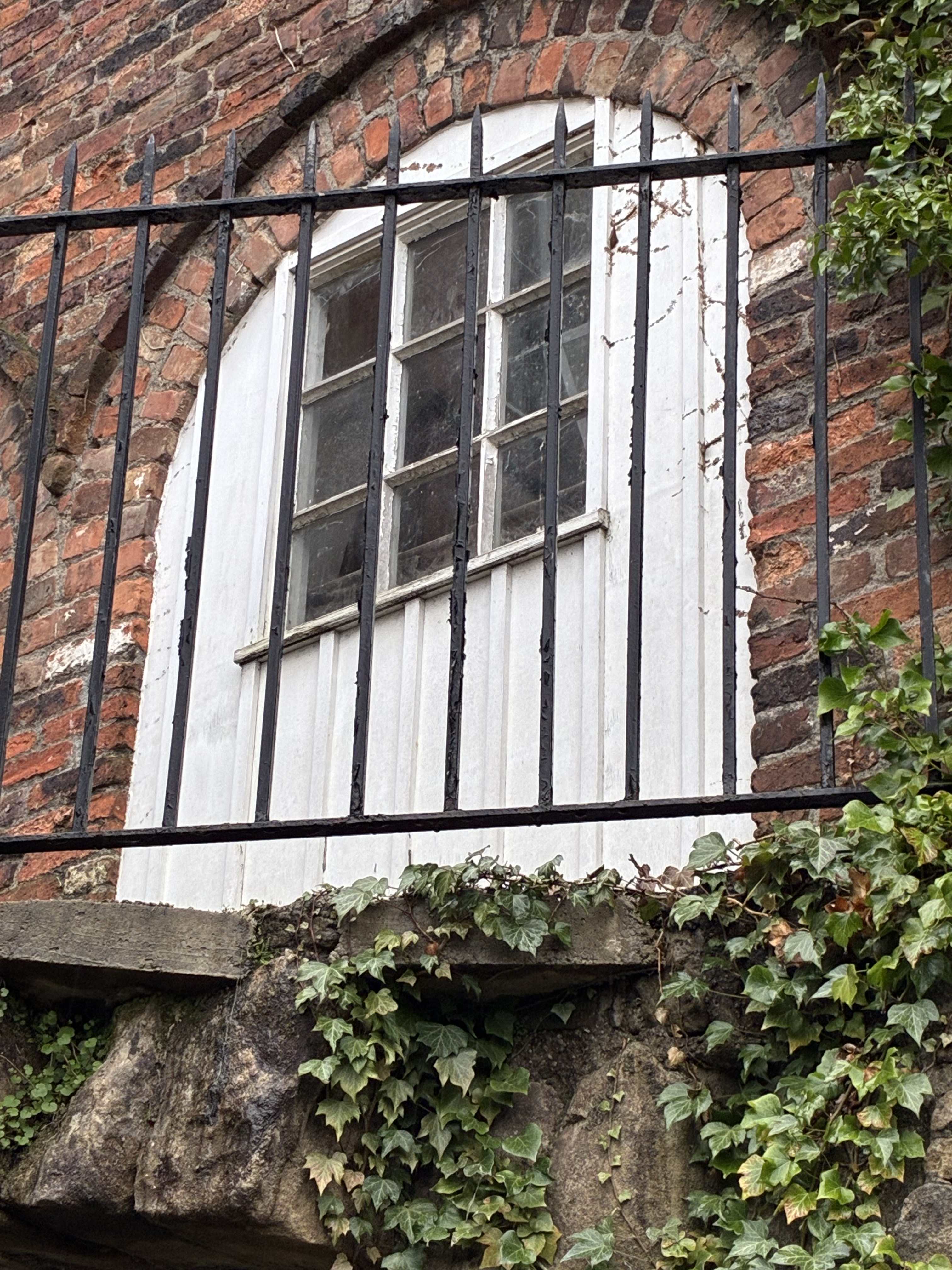

Does anyone have any experience or expertise re replacement of windows in Grade 2 listed residential buildings. I am considering a significant renovation job which is G2 listed. There is existing planning consent but it does not appear to include replacement of any of the windows. The statement in the approval document simply states “existing made good”. I can’t think why the planners or conservationists would want to retain the existing windows as they have no architectural or historical merit as far as I can tell (pics attached). To me they look like 1970s ish replacements complete with inappropriate lintel and sills. What does anyone think about persuading the planners to accept a tasteful, heritage sympathetic but energy efficient replacement (about 10 windows in total; similar story with all of them). Many thanks!!

they look like 1970s ish replacements... What does anyone think about persuading the planners to accept a tasteful, heritage sympathetic but energy efficient replacement
They do look 1970's, but roughly like copies of Crittall windows; I wonder if that's what they replaced?
Since they look similar, there may be a chance of persuading them to let you install similar new Crittall windows, on the grounds that they'd be more authentic (as well as being better insulated). If you can find old photos that substantiate my suspicion it would help.

More details of the period and listing would be useful, but I'd suggest that the width of those openings isn't original so any replacement will be equally 'unauthentic', if visually more pleasing. If you're also in a conservation area, what's in adjacent buildings may also have a bearing.  Have a chat with the conservation officer, some of them are almost half-reasonable.  Failing that, secondary glazing is actually pretty good.
The skinny window bars is all that matters for the retained appearance. So the modern equivalent has exactly the same appearance with main frames  matching your main sections, but infilled with single panes, rather than multiple small ones, and dummy astragals inside and outside.

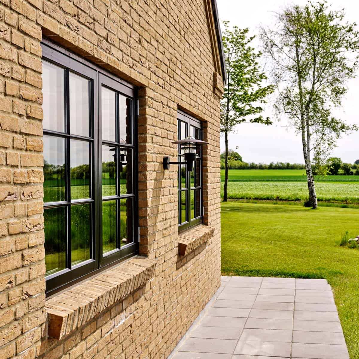

When these Rationel heritage windows were launched both we and our window contractor saw them  and thought ahaa, that's the answer. True enough the listed buildings architect approved them, having previuosly stated "only crittall". About 10 years ago?

I too have been traumatised old Crittall windows, but their new ones are very different, with thermally enhanced / thermally broken power-coated & galvanized frames + double or triple glazing. More here. So technically they can be a sensible option, but no longer the cheap option that they once were.
