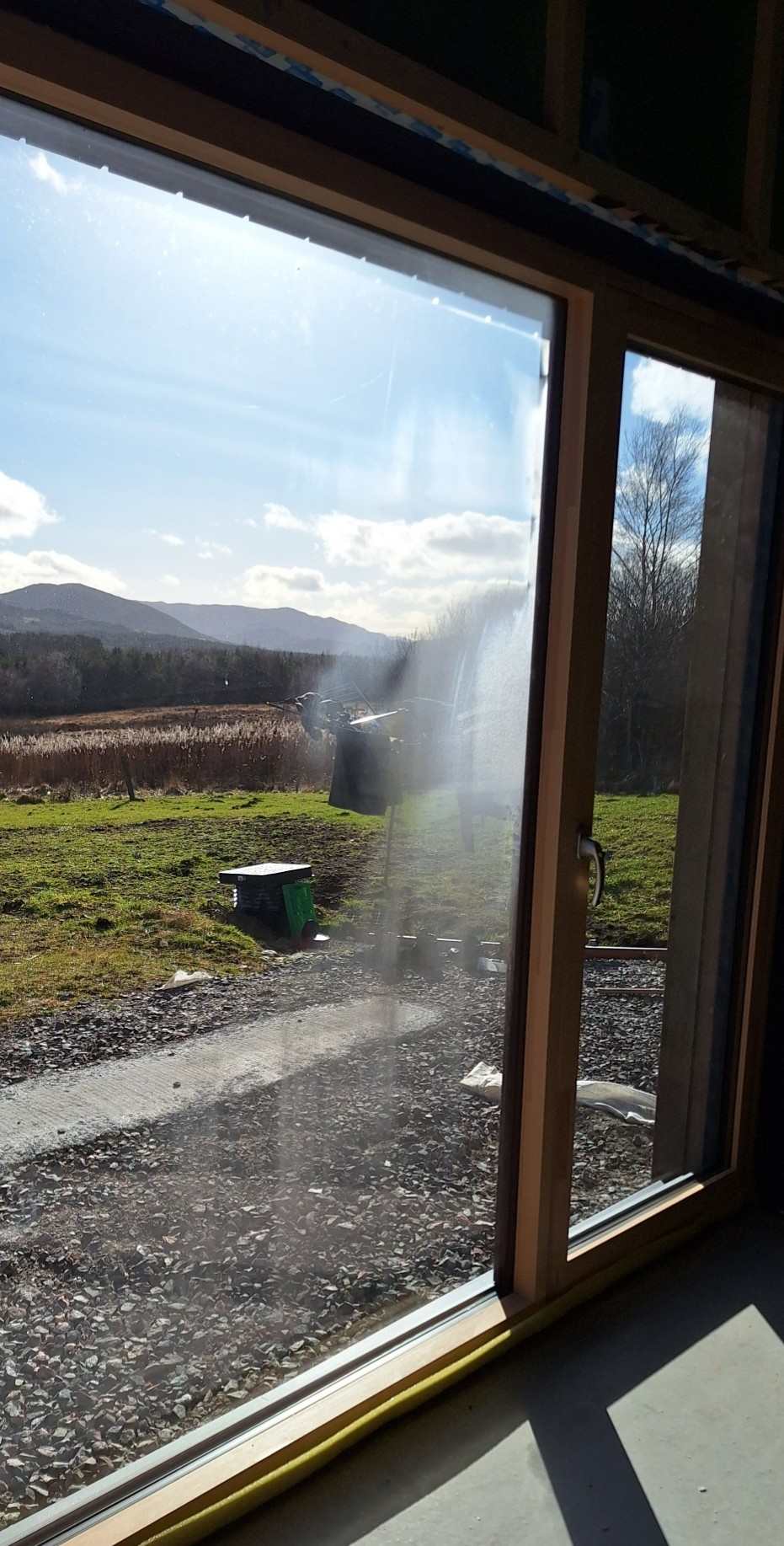

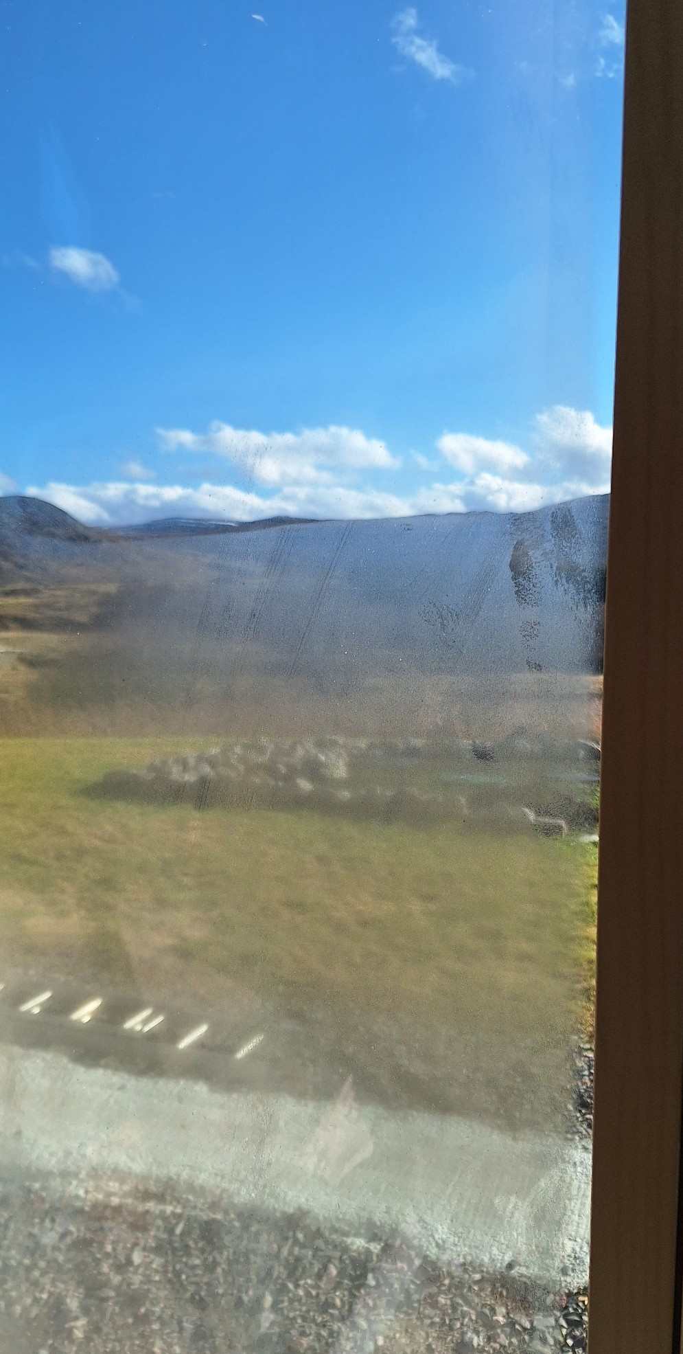

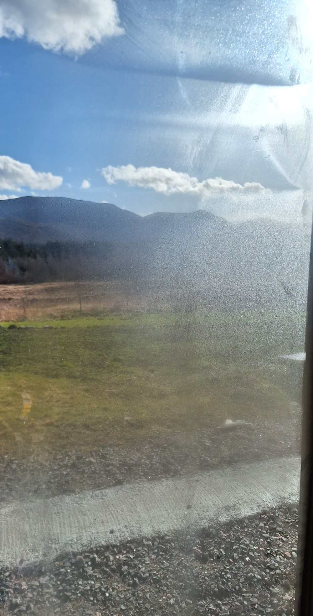

Bright sunny day today (for the first time in a while) and noticed what seems to be condensation or contamination between the panes. It's not on either touchable surface; it appears to be between the glass panes. Seems to be only in the large fixed pane which is ~2x2m; the opening pane beside it is fine. South facing if that makes any difference. Triple glazed, aluminium clad, installed 2025.
Any ideas what this is? Causes? Solutions?
Posted
The glazing units seal has failed, allowing moisture into the gaps.
Only fix for triple glazing is to replace the glazed units with new. As they are so new, you should be covered by the warranty, and these should be replaced FoC

Posted
Well that's disappointing to say the least. No end of trouble with these windows. I really wish we'd gone with another manufacturer.
Installed by their "recommended" installer, so not a direct link there. But at least we know I didn't mess it up. Will have to check the warranty to find out who's paying for the labour.
Rather gutted as we just finished cladding that side today. The timber in the window reveal will presmably have to come out to allow access.
There just aren't enough swear words today 😡

I don’t know how timber windows are fitted with glazing units, but hopefully there will be some kind of beading holding the pane in and that’s all that will need removing.
Posted
My timber cladding reveal boards overlap the aluminum of the window which itself ovelaps the glazing unit - they'll have to come off unfortunately. Doable, but irritating given I only finished installing today.
You might get lucky as you might be able to slide the new glass in from the casement side? Hang fire taking off the cladding for now!

I have just remembered something from 40 years ago.
I had a misted up DG unit that got cracked.
The misting vanished.
I wonder if a small drill hole in the edge (that pane separator bit) may cure the problem.
May give it a go.
Posted
May give it a go.
That's not replacing the argon + seal. So even if it clears the view the window is still performing far worse than designed.

Posted
On 03/03/2026 at 07:33, craig said:
High probabilty of a failed glazing unit, unfortunately this happens but should be covered by warranty. Do you mind me asking system/supplier?
Glazing can be anywhere between 1 ((ulikely, usually minimum is 5) to 10 year warranty. It’s down to the warranty the manufacturer receives from the glass supplier. Just like hardware (handles for example) it is down to what the supplier of the hardware supplies as to the manufacturers warranty.
You should be covered though for new glass unit.
Dunno if it's in the spirit of the forum to disclose company names? @Buildhub Moderators can delete if required. These are windows from NordVest.
Have checked warranty detail. 2 years parts & labour, 5 years glazing & labour; further 5 years glazing but no labour....just shows how variable warranty can be. Perhaps I should have looked into this in more detail when choosing a supplier. But the headline "10 year warranty" seemed comparable with others. Doesn't fill me with joy for the long term.
However they have accepted the warranty claim with fairly minimal fuss (a surprise based on previous issues). So new glass is on the way.
