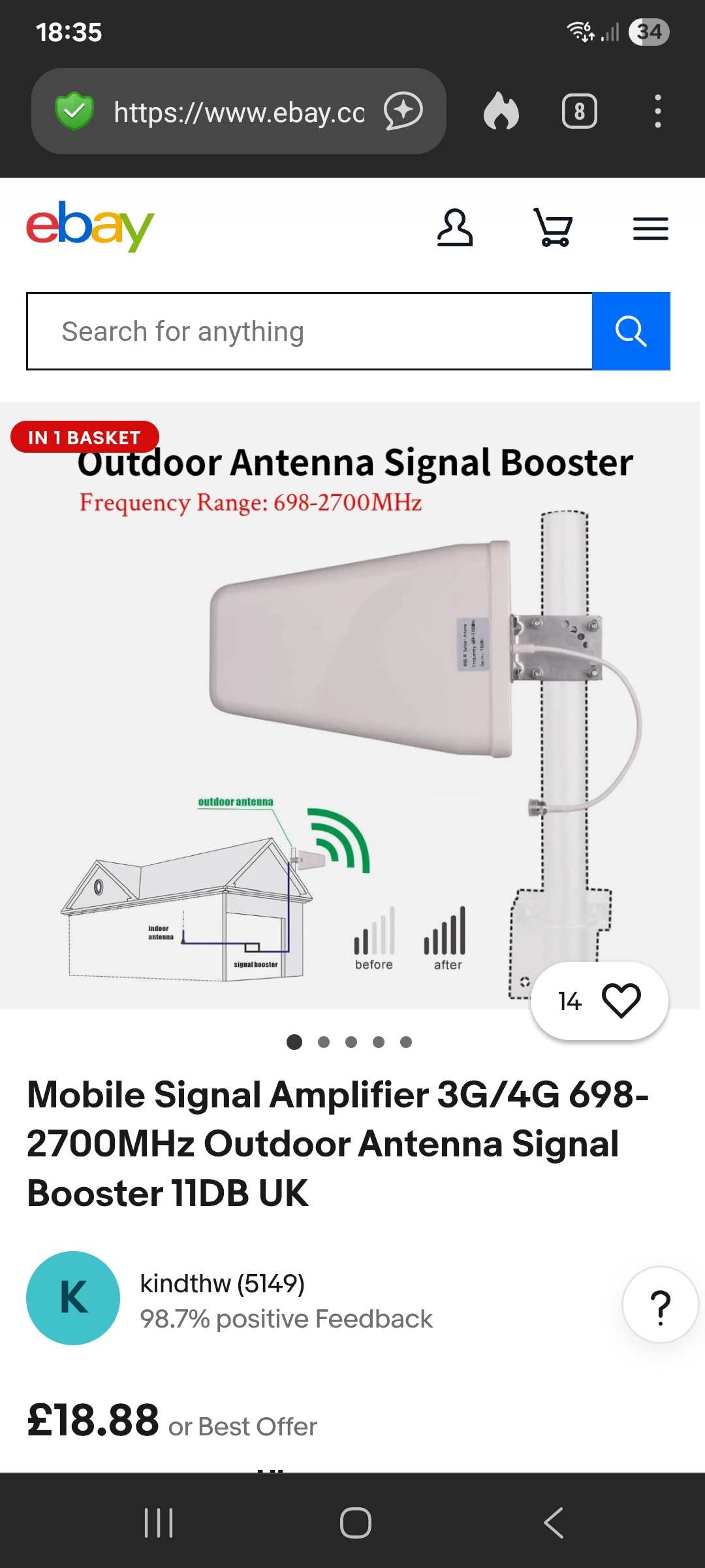

We have a weak mobile phone signal inside the house, likely to do with the concrete walls and 3G glazing.
Im thinking of fitting a signal booster, something like this:
Anyone used anything like this or something similar that they would recommend?

Not enough information.  Need a link, not a picture.
But probably useless at that price.
Do you have decent broadband?  If so you only need a phone and service provider that supports wifi calling when at home.
If looking for 4G or 5G broadband, you need a router that has an external aerial that plugs into the router.  THAT is not that aerial.

@ProDave, Yes, we do wifi calling in the house. I am planning for that next broadband and/or power outage that leaves us dependent on a mobile signal. This is the link to that above picture - https://ebay.us/m/TKwM6Y

that's just an external antenna. You'll need the booster and it's internal antenna too?
Seems you have to spend several hundred pounds. Hey ho.

Try putting a cheap phone up as high as possible and see what happens.
Or you could play about with an old satellite dish and see if you can get a stronger signal.
