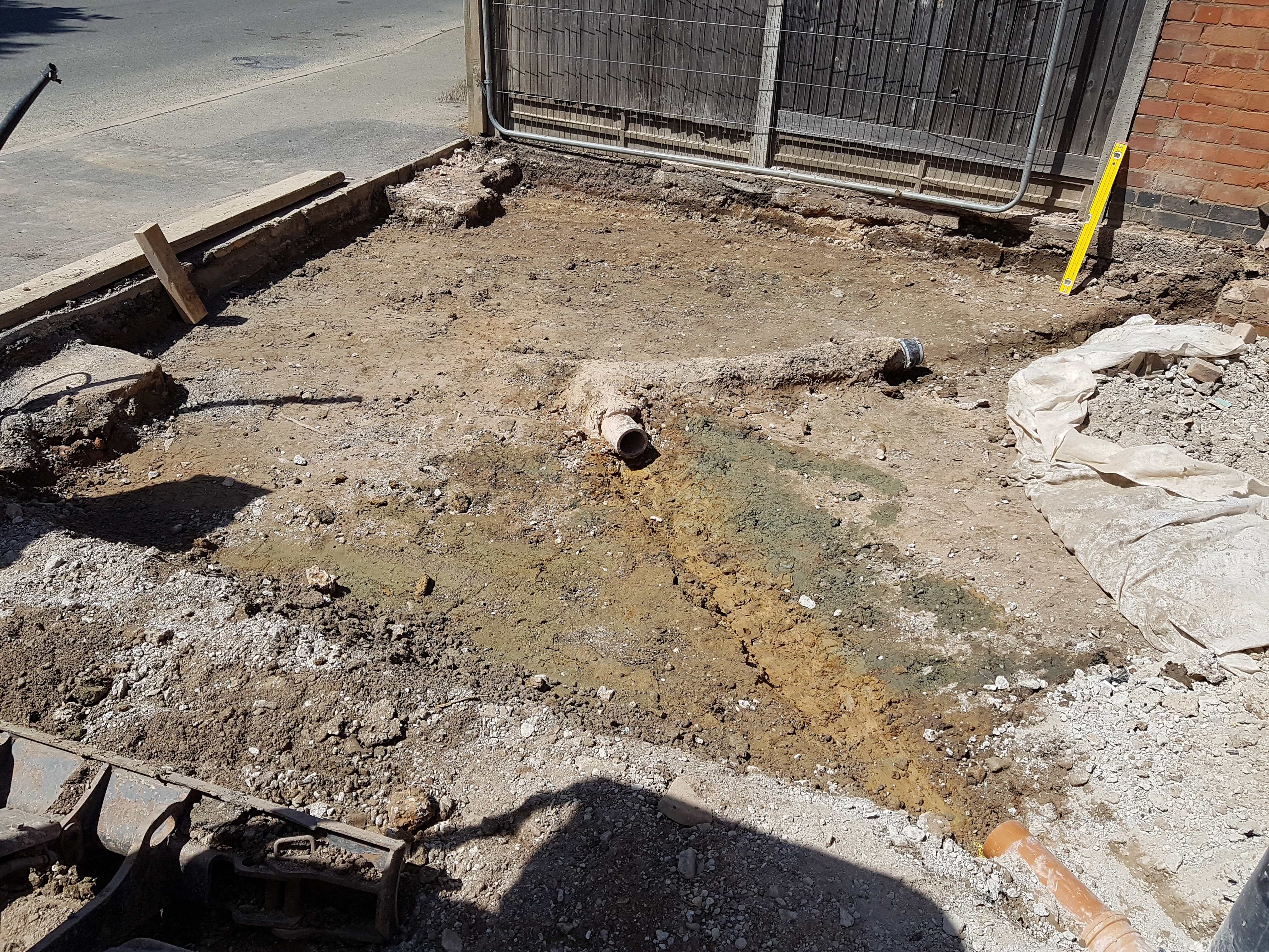

The levels to my existing sewer connection are marginal, and due to excavation I will have around 200mm cover over the pipe under a parking area.
I think it might be possible to make this work with ductile iron pipe?
Or I can make a new connection, that's £5k.
Or I can put in a pumping station and that's £1k.
Struggling to decide. Pumping station seems most cost effective but is it wise to lock in a pumping station long term?
Interesting in everyone's thoughts/experience. Thanks.

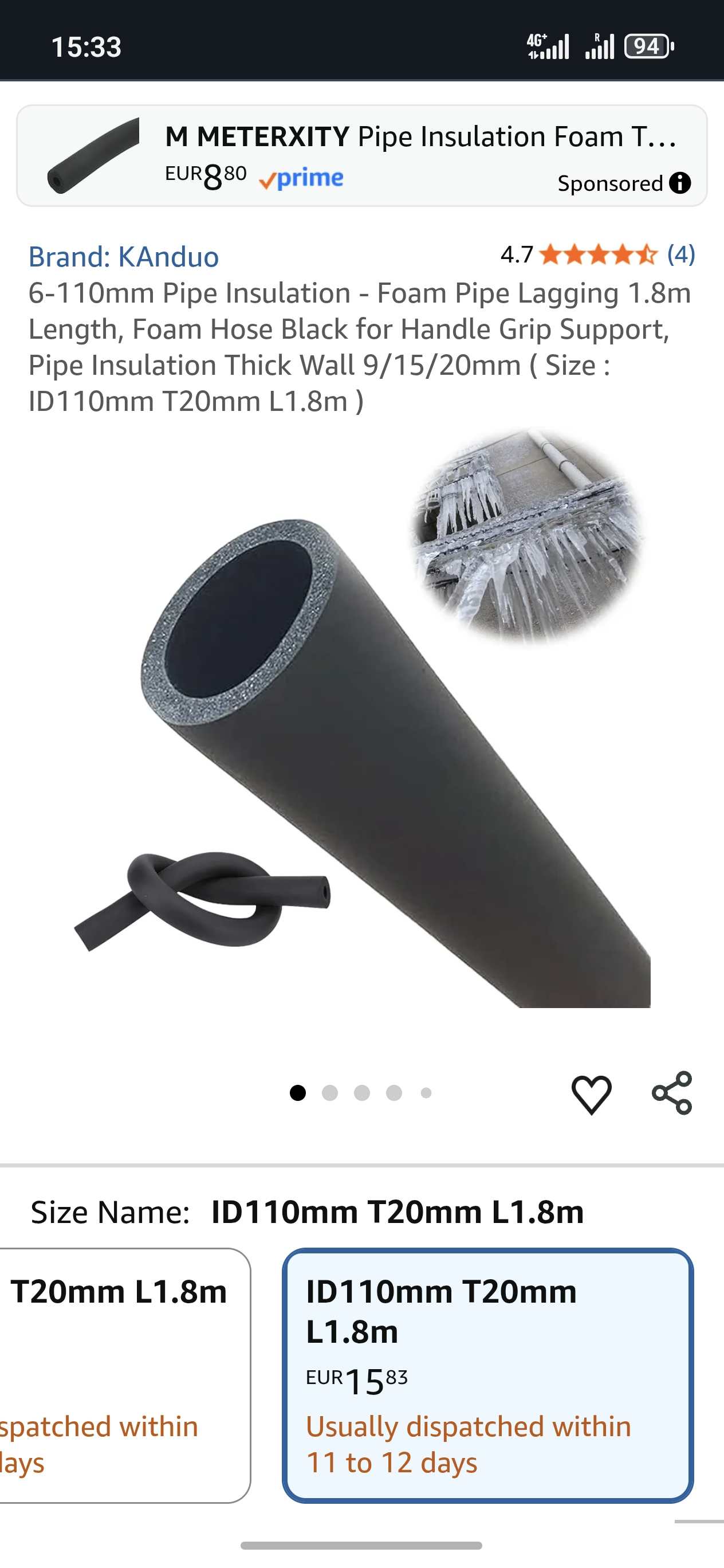

One caveat, I would be worried about vibrations being transferred directly from the concrete into the pipe or if the slab settled it could crack the pipe.
To avoid this I would excavate and consolidate well under the pipe. Wrap the length under the concrete in some pipe installation.
