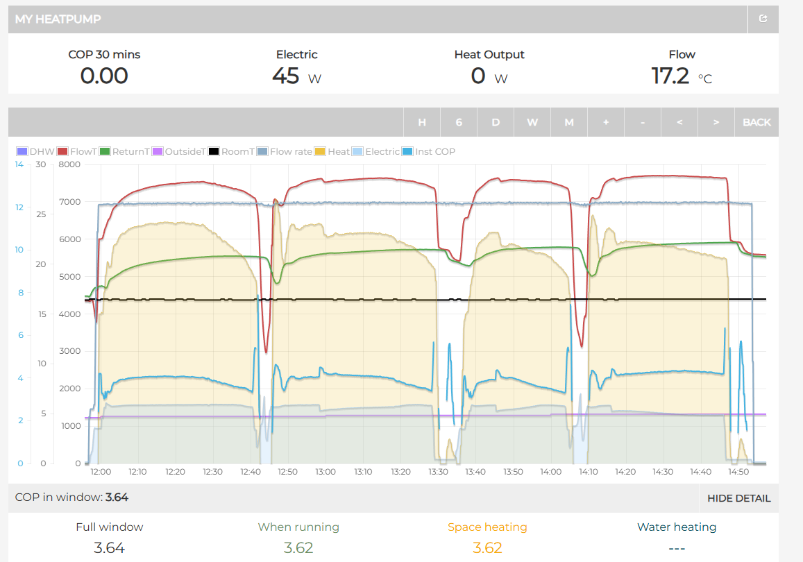

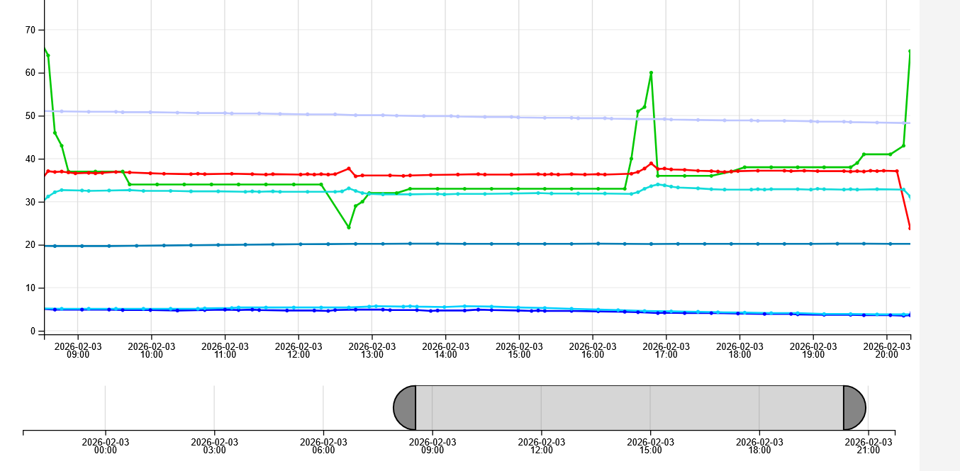

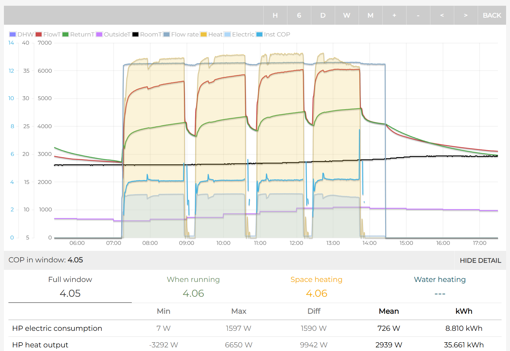

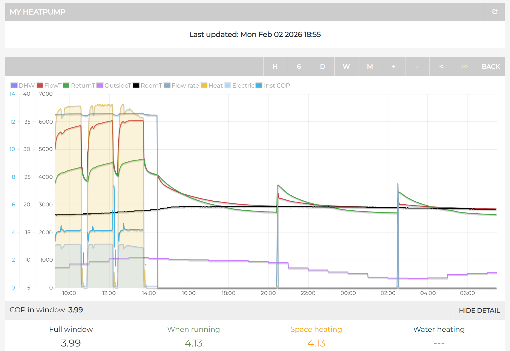

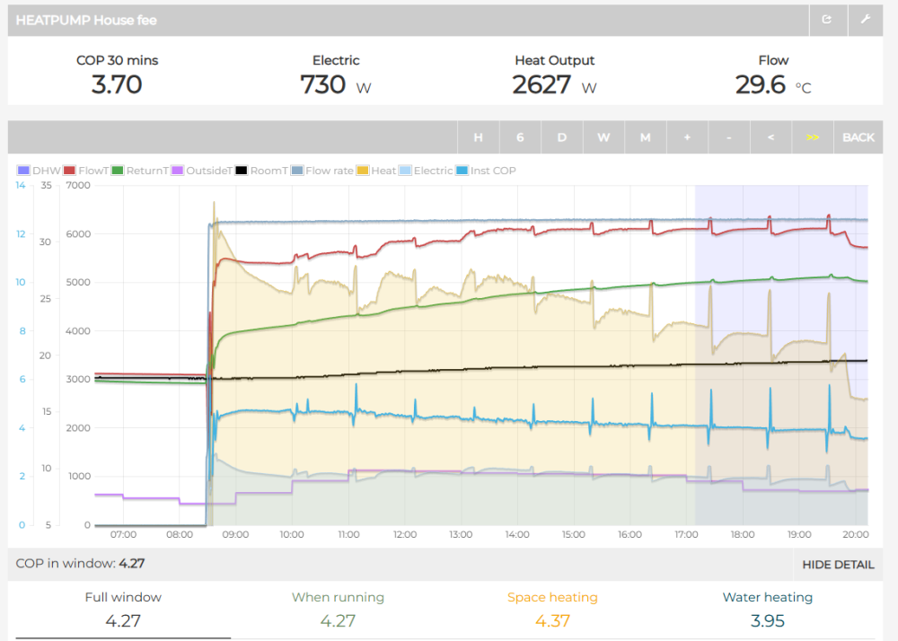

MikeSharp01 Posted February 3 Posted February 3 I started playing with the new heat pump on Sunday, first day I had since commissioning. Thought it would be fun to run it and heat up the slab so just set it going, I had not done any tuning or fiddling about so this is the out of the box operation and in the context of a very cold slab! So we are setting out to raise 70T of concrete 8 or so degrees. (Spoiler alert we still are not there yet.) Here is the first day as observed by the EMON heat meter system. Clearly a number of issues, two main ones - of course the experts I hope will see more. Firstly the delta T is huge 11-12 deg C for the most part, and really does not improve across the day. Secondly the flow rate is quite low - which may explain the high delta. So I did fiddle with the flow meters at lunch time but put them back to where they were as 5l/m was the design flow - rightly or wrongly and it didn't improve the delta T massively although, as you can see it did close to between 10-11. I checked the pump settings and it has a few of them PUMPf. PWM.OUT PE and PUMPf.PWM.IN.PE the former was at 5% and the latter at 15%. (PWM being Pulse Width Modulation and 50% being the duty cycle of the pulse so the motor could be wound up to 100% from there if needed. The room temperature is climbing and carries on doing so after turn off as the slab continues to give up heat to the space. (15.2 at turn off tops out at 16). That was Sunday, I turned it off at 23:00, remotely via the Huilian app, because I was worried about over heating the slab. COP across the day 4.3. I had the set point at 28 degrees, but as we shall see that was a very daft idea as it goes way beyond that, or so I thought! So by the end of Sunday I knew I had a flow problem but was not sure where that was coming from given that the pump appeared to be running at 5% PWM, the flow meters were all, just the three of them, showing 5l/m flows and the calibrated heat meter flow was showing just around 9l/m actually flowing. Something wrong somewhere. So it could be a flow restriction or a pump setting or something I was not understanding. Monday I just started it up again but this time I played with things a lot more in the AM. I spoke to the Heat Pump manufacturer just really confirmed what I already knew. I fitted a slab temperature sensor to give me some comfort I was not going to crack the slab, I had fitted the pockets at the slab pour so now I just stuffed the DS18B20 down the pipe 10m or so and connected to my data logger. (Turns out I could have connected it to the EMON heat meter system had I wished) So I now knew what my slab temperature was mid slab. (I could get the surface temperature via the IR camera.) As you can see the playing did not reveal much I cleaned the filter, tiny amount of clag in it, replaced it no improvement in flow and I adjusted the set point down to try and control the max temperature, as you can see it had no effect - I was obviously not controlling the set point I thought I was. The pulses you can see in the AM are me playing, observing, stopping, making an adjustment and restarting - nothing worked so I set everything back as it was. I looked at the Carell controller settings didn't find much. My setpoint was there but was not affecting anything. The Huilian App has loads more settings, you just have to find the one you want, or think you might want! Lunch time and I thought I would just work through all the settings on the Huilian app and see what was there. I found one which set either 'control on out' or 'control on in' it was set to 'in' I thought that cannot be right for my setup, I suppose you might do that in industrial situations but surely not here, I need to control on flow (out) as I want to limit the temperature of the water entering the slab, don't I? - so I toggled it. Now it looked like I could limit the flow temperature but as a tweaked that down all the happened was that the heat pump shut down hence the pulses after lunch. So I could control the upper limit but not close the delta T gap as if I tried it tripped. At about 15:00 I tried another trick asked the machine to heat the hot water. Let's see what 28mm pipe all the way did to the flow rate. You can see the result below: 19l/m so no restriction in that pat of the system, if that was the problem. So I had a cup of coffee at 3:15 (how very civilised) and took stock over the last M&S chocolate digestive! I thought, OK, the flow must be restricted or the pump settings are wrong. Let's remove all restriction in the UFH system by opening the flow meters to full bore. This did have an effect on the flow rate immediately. I could just about see the outer two flow meters in the bottom of the sight glass and the middle one is maxed out at 5l/m. We now have 12.2 l/m flow and control of the setpoint so the last few runs were done tweaking down the setpoint and I got to a delta T of 6.6 deg C which I thought was OK to head home with. Tuesday (today) could wait but there were still some thoughts to be had. We cannot open the flow any more, but there may be a restriction in the central loop, this is the longest at 185m, as I cannot get the flow meter float into the bottom of the glass, possibly air in there somewhere. The pump looks like it is just ticking over so I needed to know more about the pump and its control but my search on Monday had not revealed any setting for the pumps 'aggression' level! SO I decide that first thing tomorrow I would fit the pressure transducer to the UFH flow line and see just how hard the pump was actually working. Today dawned another day and I had some proper work to do for chunks of it so I left the heat pump off after fitting the pressure transducer. At Midday I started it all going and you can see the results below. First things first the pressure transducer revealed that the pump pressure was about 62 kPa (9 psi ). The pump has a max output of about 88 kPa (12.8psi) so there is some headroom in there to increase output somewhat if it wanted to, or could be forced to. So here, above, are the runs up to around 15:00 from 12:00 today. Looks like its making sense 2 defrosts and one 'breather' maybe not a short cycle because the pump stays running. But at the end you can see what looks like something else! here it is: Two short cycles and defrost over a couple of hours - should I like this - I think not. So where to next. My plan is to pressure flush the UFH loops again, remove all the Glycol (I know I didn't tell you about that but hey you would just have been putting everything down to that if I had told you earlier - didn't want to put it in but felt I needed to for cover over the XMAS break when the system was not running.) and pressure flush the rest of the system and fill it with one of the sludge removing chemicals in case there is any residue in the UFH loops, they have been filled with the previous Glycol since 2018 after all). Anyway if you have been reading this far and have any thoughts, observations, advice or even distain you might like to share I would love to hear it. The playground should you want any further voyeuristic opportunity! 1
JohnMo Posted February 3 Posted February 3 185m loop is very long, it will dominate the system pressure drop I removed glycol a year or so ago, system flow jumped from 18 to 22L/min. Add inhibitor and biocide to system, use only one manufacturer for both - do not mix as you may have chemical incompatibility issues.
SimonD Posted February 3 Posted February 3 Obviously your flow rates & dt need looking, but also be very patient. I commissioned a new installation at the beginning of December that has very thick stone walls and had no heating for 3 months. Initially I thought I'd messed up the installation, but it's taken until the last week or so to find its balance. This is todays: This is what it looked like just after installation:
Gus Potter Posted February 3 Posted February 3 56 minutes ago, MikeSharp01 said: I started playing with the new heat pump on Sunday, And that sir is the fun of it.. play away. I love this stuff. But have not taken time to really study your info. Firstly though. Your building is going to take time to stabalise.. not just the soil dumpling but the exteral walls. The moisture levels and the temperature in the dumplig below your insulation will have to settle into the new regime. Are you moving furniture about, changing rugs on the floor? Have you taken your socks off and just walked about in bare feet? 1 hour ago, MikeSharp01 said: as I want to limit the temperature of the water entering the slab, don't I? Well technically yes. But in real life I've heated floor slabs by accident by a mile with flows in the pipes up to 60 -70C.. but the flooring was laid to compensate for this kind of accident as I have a gas boiler.. accidents do happen? and I'm after all a UFH philistine. Put it in.. lots of short loops for redundancy, make it buildable.. That plant room is a bit of a dream space wise.. you lucky sod! From the graph I think I can see that no flows go above 40C?
MikeSharp01 Posted February 3 Author Posted February 3 27 minutes ago, JohnMo said: 185m loop is very long, it will dominate the system pressure drop Yes, it is. I should have split it. I have not found any controls for the pump in all the places I have looked but I am hopeful that I can squeeze that up a little further and witha complete pressure flush I can get the performance I want. Getting your head around how these things work and the perverse incentives (just the laws of physics really) they seem to have built in is fun. 3 minutes ago, SimonD said: but also be very patient I have had that thought, the whole place is cold and it has a significant decrement / increment delay as you can see from the trends. I need to get the delta T down a bit more, I have 6 or so at the ends of those runs today which is re-assuring. I am hoping its just a sediment restriction in that long loop and I can get it cleared if not I am going to have to think a bit more out of the box aren't I. I was interested today to see how the heating affected the building and the slab. Going into the heating session this afternoon we had a room temperature of 16.5, at the end of the day before we had 16.9 so a drop of 0.4 deg C in 12 hours with a delta T inside to outside of 11 deg C. 6.549 kWh of electricity raised the temperature back to 16.9 deg C now. Over the three days 33kWh (£8.91) has lifted the internal temperature 5 degrees against an average delta of 10 degrees. 3 minutes ago, Gus Potter said: And that sir is the fun of it.. play away. Yes, rediscovering my inner child is real fun, I wish I still had the sponge brain I had then you can learn so much so fast its frightening now to think about how slow I am!

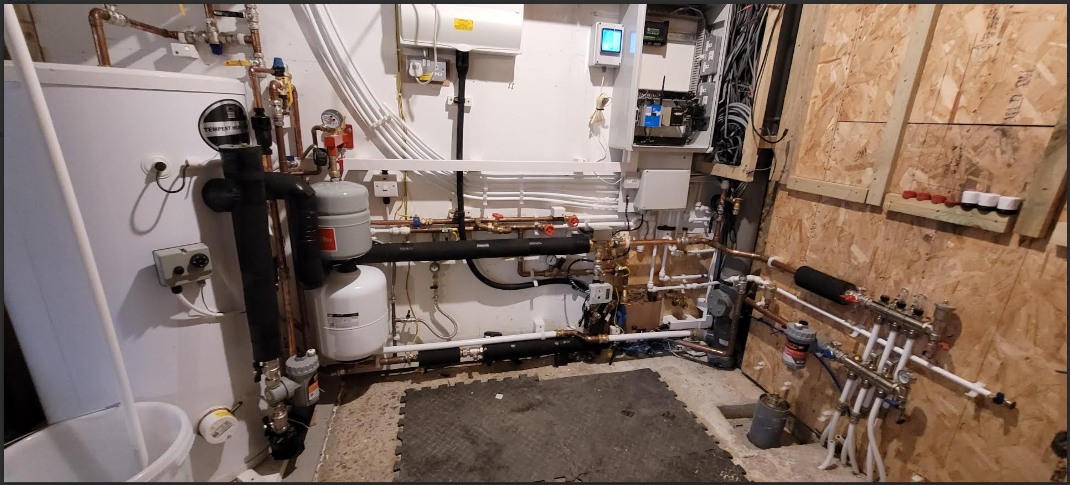

MikeSharp01 Posted February 4 Author Posted February 4 8 hours ago, Gus Potter said: That plant room is a bit of a dream space wise.. you lucky sod! Thanks Gus but the space is not all it seems. I have a space 245mm deep along the wall in front and 125mm on the wall to the right as there are kitchen panels, all openable, along the facing wall and cabinets, all of which will slide out for access, along the right hand wall.
dpmiller Posted February 4 Posted February 4 Can you pop another pump is series to help the flow in that loop? The internal pump on our IVT9 is a bit marginal so I've an external Wilo to support it. Either will *just* satisfy the flow switch so with the externl pump ticking over it allows the Carel to modulate the internal pump nicely
JohnMo Posted February 4 Posted February 4 35 minutes ago, dpmiller said: Can you pop another pump is series to help the flow in that loop? The internal pump on our IVT9 is a bit marginal so I've an external Wilo to support it. Either will *just* satisfy the flow switch so with the externl pump ticking over it allows the Carel to modulate the internal pump nicely I did similar with my super long DHW heating loop. Think it pulled an extra 15 to 20W
MikeSharp01 Posted February 4 Author Posted February 4 10 hours ago, Gus Potter said: Is the black line your actual room temperature? If so that does not reflect real life? What room was that in? Yes it is. It is in the open space on the ground floor. It is the wireless one that comes with EMON system from open energy. How does it not reflect reality?

MikeSharp01 Posted February 4 Author Posted February 4 8 hours ago, dpmiller said: an you pop another pump is series to help the flow in that loop? The internal pump on our IVT9 is a bit marginal so I've an external Wilo to support it. Either will *just* satisfy the flow switch so with the externl pump ticking over it allows the Carel to modulate the internal pump nicely How did you control it.

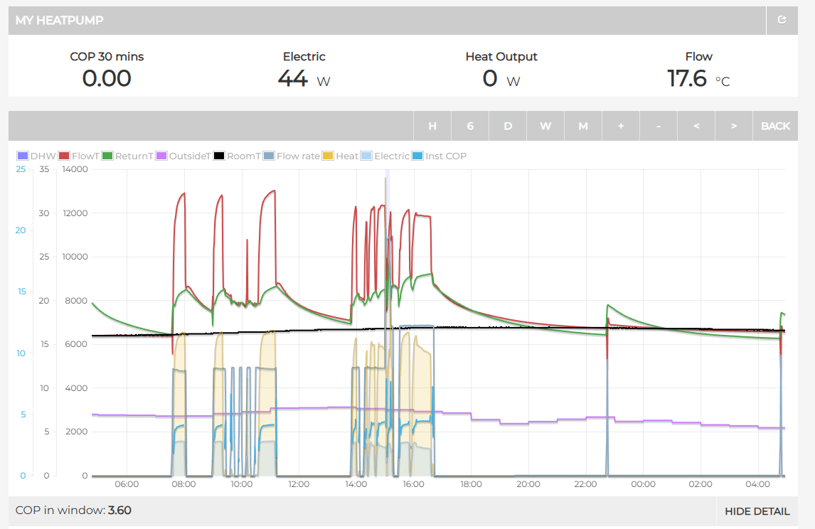

Michael_S Posted February 4 Posted February 4 (edited) Do we know how much of an impact a larger delta T has on efficiency - is it just that to have the same average T the flow temp needs to be higher (eg av flow temp of 35C could be achieved with 40 flow, 30 return or 37 flow, 33 return) or do heat pumps actively dislike a large delta T? Edit: Google suggests a 1C decrease in flow T could result in a 2% increase in efficiency so in my example above the 3C lower low rate would save 6% of energy use Edited February 4 by Michael_S

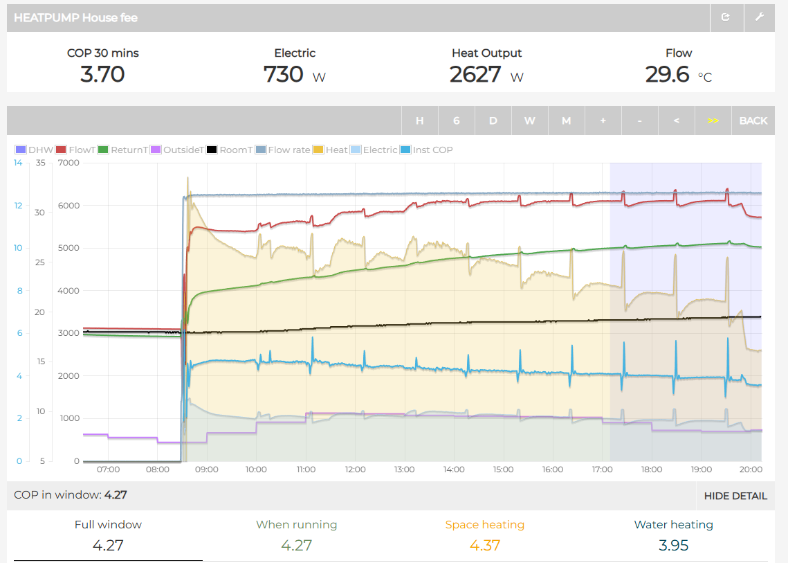

Beelbeebub Posted February 5 Posted February 5 Regarding your large dT What is your room temp and what is your floor surface temp. Depending on your levels of insulation /Air exchange the difference between your room temp and floor surface temp will vary. For example my old place was well insulated. For a 22C inside air temp I only needed my slab to be 24C or so when it was 5C outside. Of it was below zero I might need a floor temperature of 25C. The floor temp is usually fairly close to your return temp, as long as you have a decent floor surface. If you habe carpet, thick wood, rugs it may be lower. The goal is to get your floor slab to the correct temperature to keep your house comfortable in the current conditions. Once that is reached you heating system only needs to put in the heat you are losing. It looks like you were getting to the right return temp when you stopped. The second thing is your long loop will probably need a higher flow rate to achive the power output at a smaller dT. If it is most of the ground floor you might need to put out a kw or two of heat. That requires a fairly substantial flown rate at dt5. It may be you are hitting the flow rate limit of a 15mm pipe (which is roughly what an ufh pipe is) so thr dT needs to be larger to put the power out.

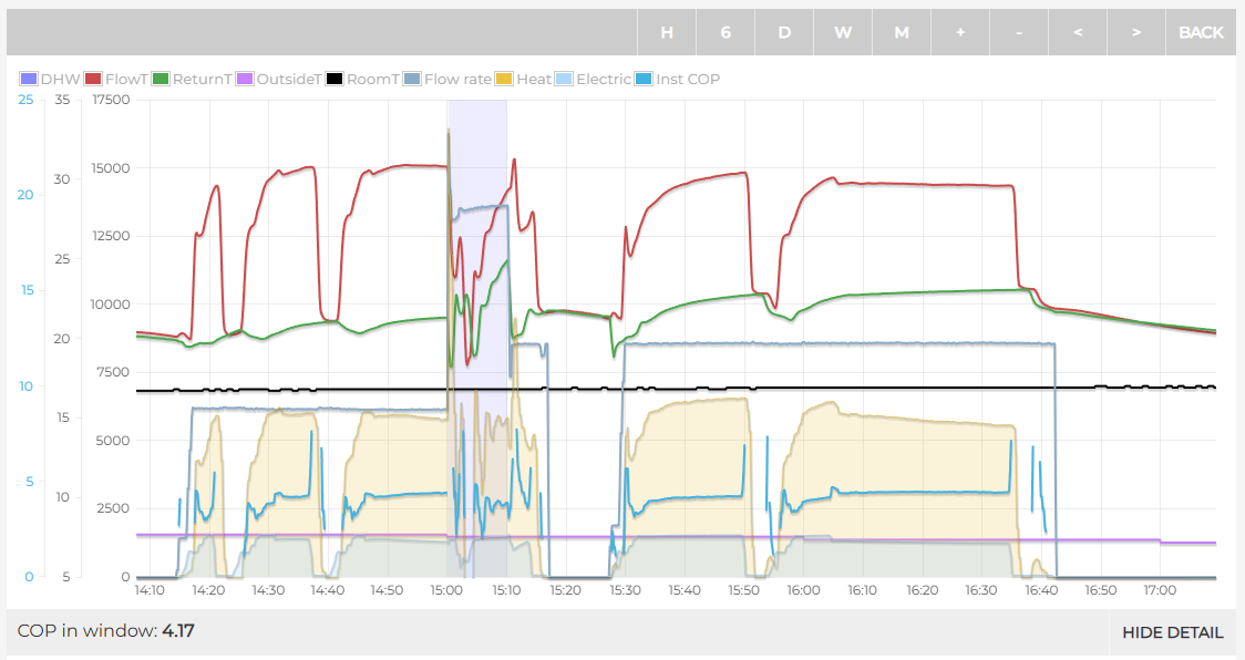

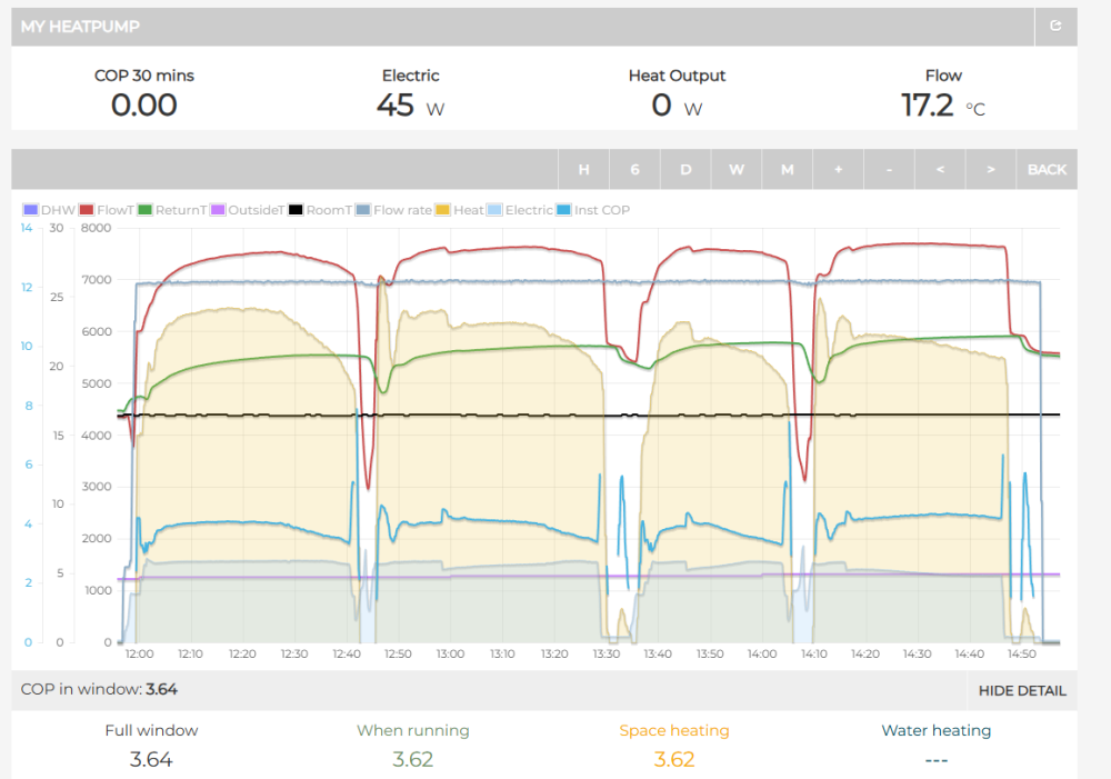

JohnMo Posted February 7 Posted February 7 19 minutes ago, MikeSharp01 said: need to either switch on weather compensation and see if I can tune that or run the UFH in much lower flow temperature chunks That is a bit of trial and error, to see what works for your floor. There is a third option, a slightly elevated WC and thermostat. The ideal is one long run between thermostat trips if you go that route. The 3rd route gives a better overall CoP than a fixed flow temp as your flow temp reduces with warmer weather. Two things to look at, CoP but more importantly is energy input.
SimonD Posted February 7 Posted February 7 1 hour ago, MikeSharp01 said: So where to from here is my next question. I think you've still got a good couple of weeks to go at least until the system balances itself out. I would just go weather compensation, fully in the knowledge you'll be tweaking it for the next couple of months.. The problem I've found with running elevated WC with a thermostat is that they can end up fighting each other, especially if the thermostat has modulating input to the heatpump & flow temps. You then get oscillating compressor frequencies and can even see elevated defrost cycle frequency. Obviously this depends on how the controls are designed and implemented. If you go weather compensation only you're reducing your variables and any diagnostics/analysis of system behaviour becomes a lot easier. 1

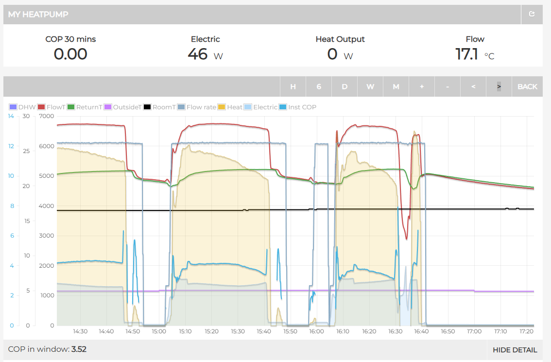

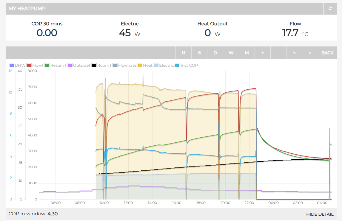

MikeSharp01 Posted February 8 Author Posted February 8 Ok I have set up Weather compensation on the CE-iH6+ heat pump with its Carel controller using the Huilian App. It's a bit of a faff because the manual does make it clear what the various settings are that control that start the end points of the curve (line). Getting ChatGPT and CoPilot (I like to use both so they check each others work!) to hunt around and a bit of experimenting it all became bit clearer. It is clear that two of the values are fixed - you can do nothing about them in this system. The minimum Outside Air Temperature (OAT) is fixed at -5 oC the Maximum OAT is fixed at +15 oC. The curve runs between these two values in X and you can set the Y values as flow temperatures for them both. So for anyone who is using this same heat pump: To set a custom curve (one you can play with flatten / lift / drop) you need to select Curve 9 in the User Para menu via the Huilian App. Then for the top of the curve, lowest Outside Air Temperature (OAT) which is fixed at -5oC, flow setpoint you use "Heat Set temp" parameter and I set mine to 32oC and for the lower setpoint (OAT fixed at +15OC) you actually use the "Auto set temp" parameter and I set mine to 28oC. The Graph is interesting on a number of fronts. The heat pump has been running all day - no cycling or defrosting, although as you can see as I took this screenshot things are happening! I will take a look when I have finished this post. Over the day it has been modulating down the output and the COP has not been bad. The Delta T is now under 5 (approaching 3 at the very end - which is thumping the COP) and the slab temperature (not on the graph has climbed from 19.62 to 23.31oC so a bit further to go and we will hit the hard limit on the slab temperature. Not that I have implemented the stat for that as not sure how best to do it I will just turn the thing off. The best thing today has been the sun shine so for most of the daylight hours we were getting all the heat for free! Perhaps the worst is that looking at how the house performs I really need a much smaller heat pump, might have to think about following in @JohnMos steps. Finally looking at the very end it looks like, for some reason (I have not changed anything), it has jumped (modulated) the output down to 2.6kW and is running it down more slowly from there. Minimum we can go is 1.8kW on this unit! It must give up eventually trying to limbo under the wire. At which point it will go into short cycling. Need to get the BMS connection up and running so I can get some more intelligence into it from there.
JohnMo Posted February 8 Posted February 8 Looking at room temperature the line is steady climb, which is good, but suspect your flow temperature is way to high. A 2 Deg rise over 12 hrs is very fast for thick screed. Your +15 degs I would be setting sub 25, maybe 20 to 23, your -5, 28 to 30. Start low, and move up. A hot house is a horrible place to be, especially when it's a thick floor and it doesn't cool for an absolute age. At 10 degs your house will not need or very unlikely to need heating, when dried out. Your running 30 degs, that is nearer what you will need at -5.
MikeSharp01 Posted February 8 Author Posted February 8 11 minutes ago, JohnMo said: A 2 Deg rise over 12 hrs is very fast for thick screed. Yes. I have now turned it off to let it settle and then tomorrow I will set much lower points and I was wondering if I had the numbers too high perhaps even the wrong way around because there is a hint the heat goes up when the temperature goes up but that may just be surmise as finding those set point parameters was somewhat guess work.
