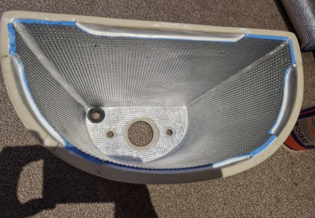

carlos21 Posted Monday at 19:44 Posted Monday at 19:44 the toilet cistern is badly condensated due to the cold water feed being very cold this time of year, so I am going to T into the hot water pipe and put in a valve to adjust the amount of hot water plus a couple of one way valves to stop cross flow, or a thermostatic mixer valve, anyone done this or have any thoughts? thanks carl

stu w Posted yesterday at 18:18 Posted yesterday at 18:18 I line them, cures the problem, very little loss in capacity and no more condensation 3
sgt_woulds Posted 5 hours ago Posted 5 hours ago What material did you use for this? How the metalised finish holding up?
carlos21 Posted 37 minutes ago Author Posted 37 minutes ago thanks for all the replies, i got the hot feed into the cistern, i seems to have stopped the condensation. as people have mentioned the humidity must be high, it is !!! its an old small stone house so humidity is a problem, but not necessarily an easy fix. i figure the lack of condensation on the cistern must be of benefit to the overall humidity in the bathroom. i did try lining the cistern as per photo, i did help but not enough for my needs. thanks for your help. carl
