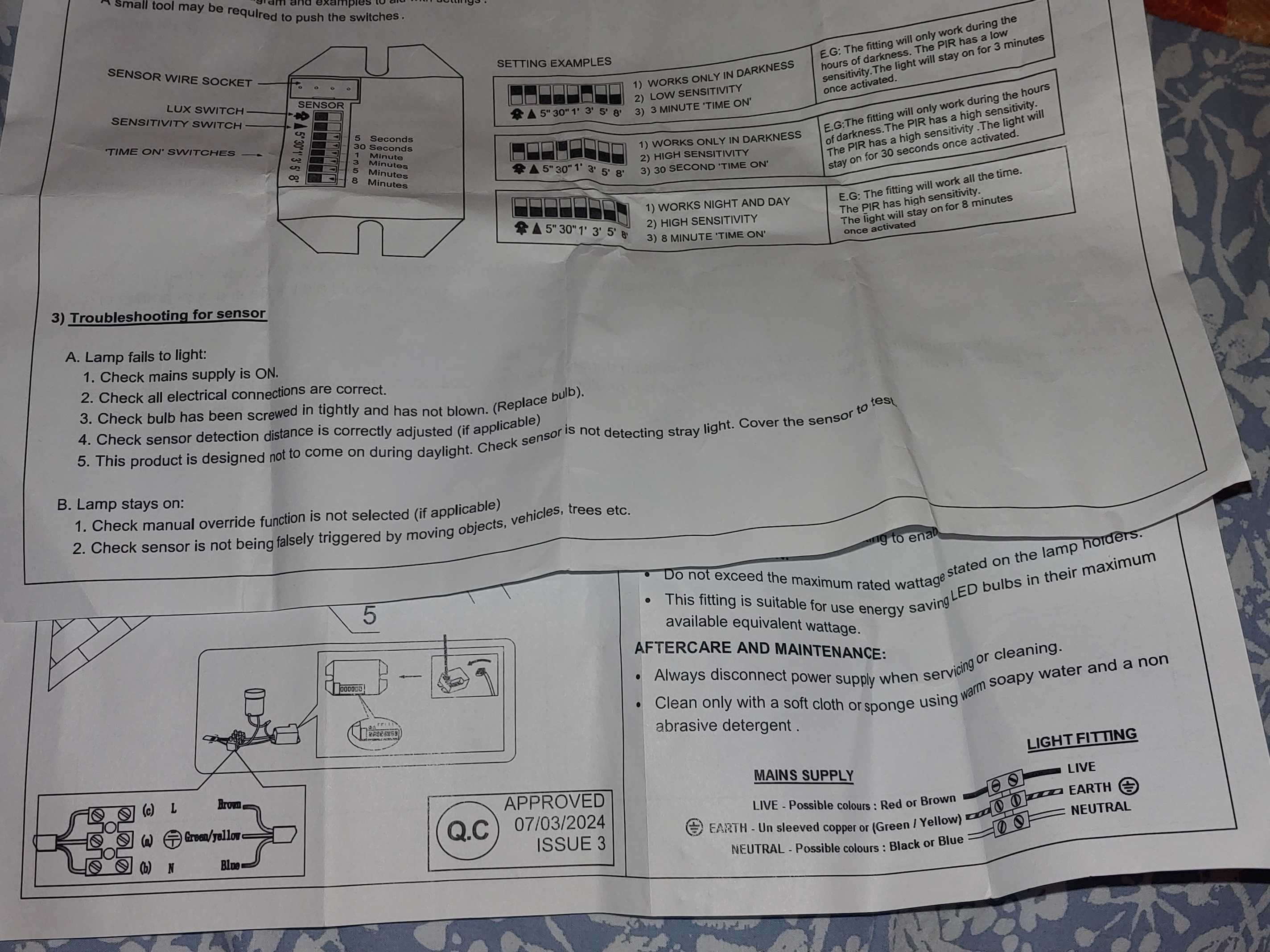

January 27Jan 27 Just doing what i thought was a simple job for family member. Replaced a screwfix dunham light with pir with a new maine pir light. Connected it up the same . (black to neutral and red to live and the earth) didn't work. Being now told that the new light needs neutral, live and earth and it may have live and switched live as its off a switch. Could this be right?
January 27Jan 27 Post a pic of your new light connections, may just need live and switched live linking, but then that could be on all the time. Post a pic of your new light connections

January 28Jan 28 Could it be a class two fitting (all plastic and no earth). And you're confusing the earth and neutral? Perhaps the wiring you have (red/black + other) is a live, switch live and neutral. I think we'll need the instructions and wiring diagram to confirm.
January 28Jan 28 PIR lights will usually have a connector block with 4 terminals. 1) earth (usually just somewhere to park the earth that you have at the end of your cable, and not always needed if “double insulated”) 2) N neutral 3) L permanent live 4) SW L switched live Some will have the L disappear into the fitting and feed the sensor, and then the sensor sends the SW L output back to 4. The factory wiring then has the live to the lamp in there too. Some are set up so you don’t see the 4 terminals, as the factory working is contained within the unit, a-la most modern led floodlights, so you only get to give it L, N and E. 9 hours ago, dave1967 said: I can do but its just earth to earth . red to live and black to neutral. May be a dud light. Do you have a link to the exact fitting you bought?
January 28Jan 28 Author https://searchlightelectric.com/en-gb/searchlight-products/outdoor/outdoor-wall/maine-outdoor-wall-light-black-metal-1-clear-glass-280bk--pir
January 28Jan 28 2 minutes ago, dave1967 said: https://searchlightelectric.com/en-gb/searchlight-products/outdoor/outdoor-wall/maine-outdoor-wall-light-black-metal-1-clear-glass-280bk--pir Just pics and words unfortunately. Can you take a pic of the instruction manual and post it here? Just take the pic and save it to your photos. Then click add files below the text editor here and it’ll ask you to choose photo.
January 28Jan 28 So it is a simple L,N,E connection no need for any switched L. So it should just connect in place of the old lamp.

January 28Jan 28 But the old light MUST have had neutral to it, so I still don't see why you cannot connect the same L, N, E that previously went to the old light, to this new one. As already mentioned you will have to leave the switch in the house turned on all the time for it to operate automatically at night. Post pictures of the actual cable you have coming from the house and how you have actually connected it to the light.
January 28Jan 28 2 minutes ago, ProDave said: But the old light MUST have had neutral to it, so I still don't see why you cannot connect the same L, N, E that previously went to the old light, to this new one. As already mentioned you will have to leave the switch in the house turned on all the time for it to operate automatically at night. Post pictures of the actual cable you have coming from the house and how you have actually connected it to the light. Yup. If the old one worked, this one can be made to work. Light needs to come off and we need to see some pics, whilst I’ve still got hair! 🙃

January 28Jan 28 Try the bulb in another fitting? Have you checked the configuration switch settings? I would note the default settings and then try the last example (works night and day). Try temporarily hooking up a simple pendant to check the house wiring.
January 28Jan 28 29 minutes ago, Temp said: Try the bulb in another fitting? Have you checked the configuration switch settings? I would note the default settings and then try the last example (works night and day). Try temporarily hooking up a simple pendant to check the house wiring. From what I gather, and as per Dave above, there was a working light here before.
January 28Jan 28 Author Yes. Just brought the light to my house and wired it up inside and it works perfect. Checked the terminals and live light screwdriver. Neutral doesn't. At the other house both live and neutral lite screwdriver. Confused.
