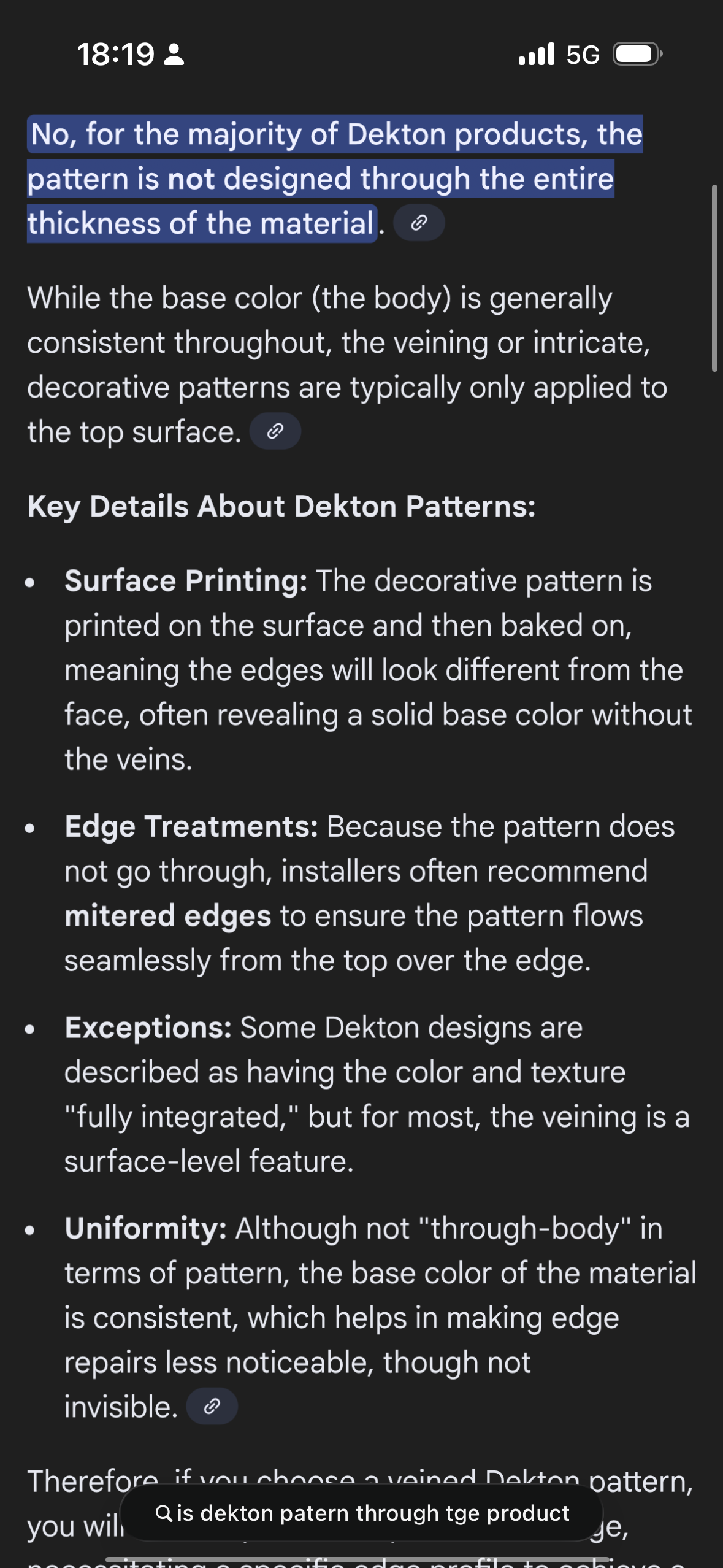

January 25Jan 25 Author 44 minutes ago, Tom said: Dekton is a very different material though In what respects? Better, worse?
January 25Jan 25 I think dekton is what I’d normally call a solid grade laminate - the kind you see toilet cubicles and IPS (integrated panel systems, the things you see behind toilets in commercial buildings) in public buildings which you have high thoroughfare/risk of damage. solid grade as opposed to high pressure laminate which is essentially melamine cited chipboard or MDF. One of the most obvious differences is that there isn’t any stone/quartz and its a „printed” surface meaning the pattern isn’t continuous through the product - cut edges will be collared the same as the core material which may be black, grey, white etc. but because it has no natural material within, it is allegedly more resilient to damage by heat, chemical etc BUT in my view whilst that’s great in some settings, because the pattern is only on the top, any deep gouges or physical damage the impact is more obvious because it exposed the core which is patternless
January 25Jan 25 Author So it is a panel rather than a slab that can be routed etc. Eg a profiled or cut edge would lose tha pattern? A panel for a builder rather than needing stone mason skills? So cheaper?

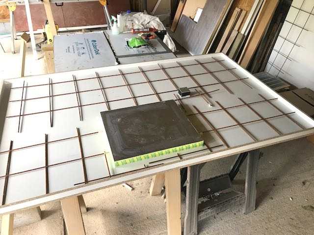

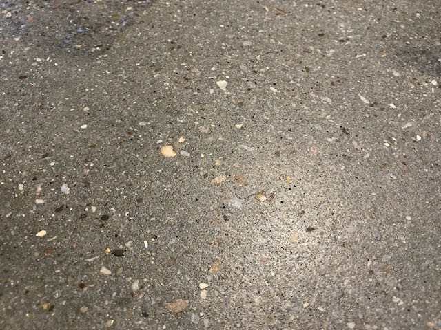

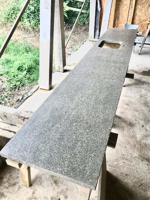

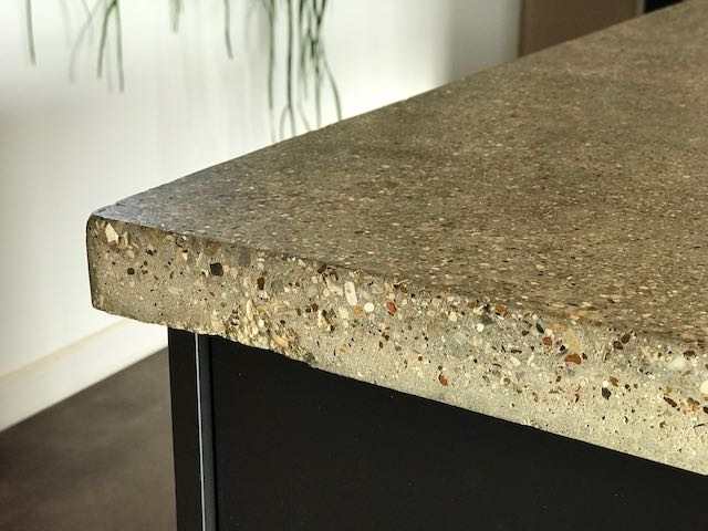

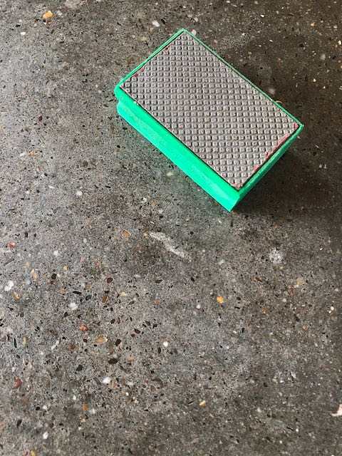

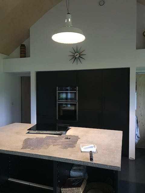

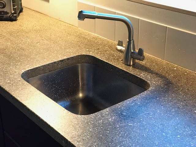

January 25Jan 25 Up for an adventure? Homemade worktops, utility, kitchen and island. Biggest issues were moving from garage to kitchen. More compliments from visitors about the worktops than the rest of the house. Cost was 10% (excluding my time) of the quotes received. It was an enjoyable part of the build.
January 25Jan 25 55 minutes ago, Nestor said: Homemade worktops, utility, kitchen and island. Looks good. I do like the idea of concrete in a build, though I'm more hesistant on the idea of kitchen surfaces. Looks a fair bit different from the other concrete worktops I've seen people make. A few questions if you don't mind! Did you colour it? Specifically choose agregate? Did you grind/polish? Do you have issues with staining? Concerns about dirt build up in the texture/keeping it clean?
January 25Jan 25 41 minutes ago, -rick- said: Looks good. I do like the idea of concrete in a build, though I'm more hesistant on the idea of kitchen surfaces. Looks a fair bit different from the other concrete worktops I've seen people make. A few questions if you don't mind! Did you colour it? No, natural aggregate. Specifically choose agregate? I will have to find the invoice but purchased 25kg bags for consistency. Did you grind/polish? Yes, a lot. Purchased cheap 5" wet grinder. Full waterproofs needed and space. Do you have issues with staining? Yes, not personally an issue. Lemon and limes. The stains do fade after time, I can't explain why. Concerns about dirt build up in the texture/keeping it clean? Easy to clean, a few tiny pin prick holes in some of the surface. Not noticeable. I used to regularly clean with a diamond pad and recoat with water proofer but not for 5 years now. I does take on more of a mottled surface visually overtime so not everyones taste. But it works here, a slight relief as most other materials in the build are very uniform, floors, doors, cills, etc. The concrete samples I received were so perfect they could have been moulded plastic. I do like a challenge and did test first. Edited January 25Jan 25 by Nestor
January 25Jan 25 7 hours ago, saveasteading said: In what respects? Better, worse? A lot better. 7 hours ago, BadgerBodger said: I think dekton is what I’d normally call a solid grade laminate - the kind you see toilet cubicles and IPS (integrated panel systems, the things you see behind toilets in commercial buildings) in public buildings which you have high thoroughfare/risk of damage. Eh? What makes you think this? It's what they call "sintered stone" I think, basically a mad made stone created with immense temperature and pressure. It's very like pocelain, but better. It's practically impervious to any scratching, solvents, staining etc - unlike the resin composite worktops. The downside is it has to be cut, machined etc by specialists.
January 25Jan 25 1 hour ago, Tom said: A lot better. Eh? What makes you think this? It's what they call "sintered stone" I think, basically a mad made stone created with immense temperature and pressure. It's very like pocelain, but better. It's practically impervious to any scratching, solvents, staining etc - unlike the resin composite worktops. The downside is it has to be cut, machined etc by specialists. I may be wrong in part then. I went to as showroom, saw the product and what I saw was a solid core colour, with a patterned surface, but the routed grooves were solid colour like the core, indicating that the pattern was not throughout. It would seem the core and product is indeed some sort of composite, as you have deceived from tge product literature. But the patter IS only skin deep… in the products I saw certainly.. perhaps not in all… So still a solid grade laminate but not the same as trespa… Although looking at it, you can get Dekton cladding panels… that would be something Edited January 25Jan 25 by BadgerBodger
