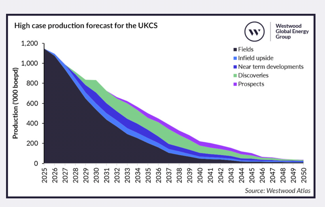

Beelbeebub Posted 2 hours ago Author Posted 2 hours ago 3 hours ago, SteamyTea said: Is it the term 'net zero' that some people have a problem with? Do people understand what the 'net' actually means in this context? Have people also forgotten what the end products are that the consumers use? I think it does. To a certain person "Net zero" provokes rants a but "Greta" and "ULEZ" etc. Almost inevitably a (parroted from some blue tinged or red hatted politician) rant about "Net zero is stopping us using the vast reserves of fossil fuels in the north Sea to achive energy independence" follows. Which sort of was my reasoning behind this thread - energy independence via domestic fossil fuel production is not possible for the UK.
