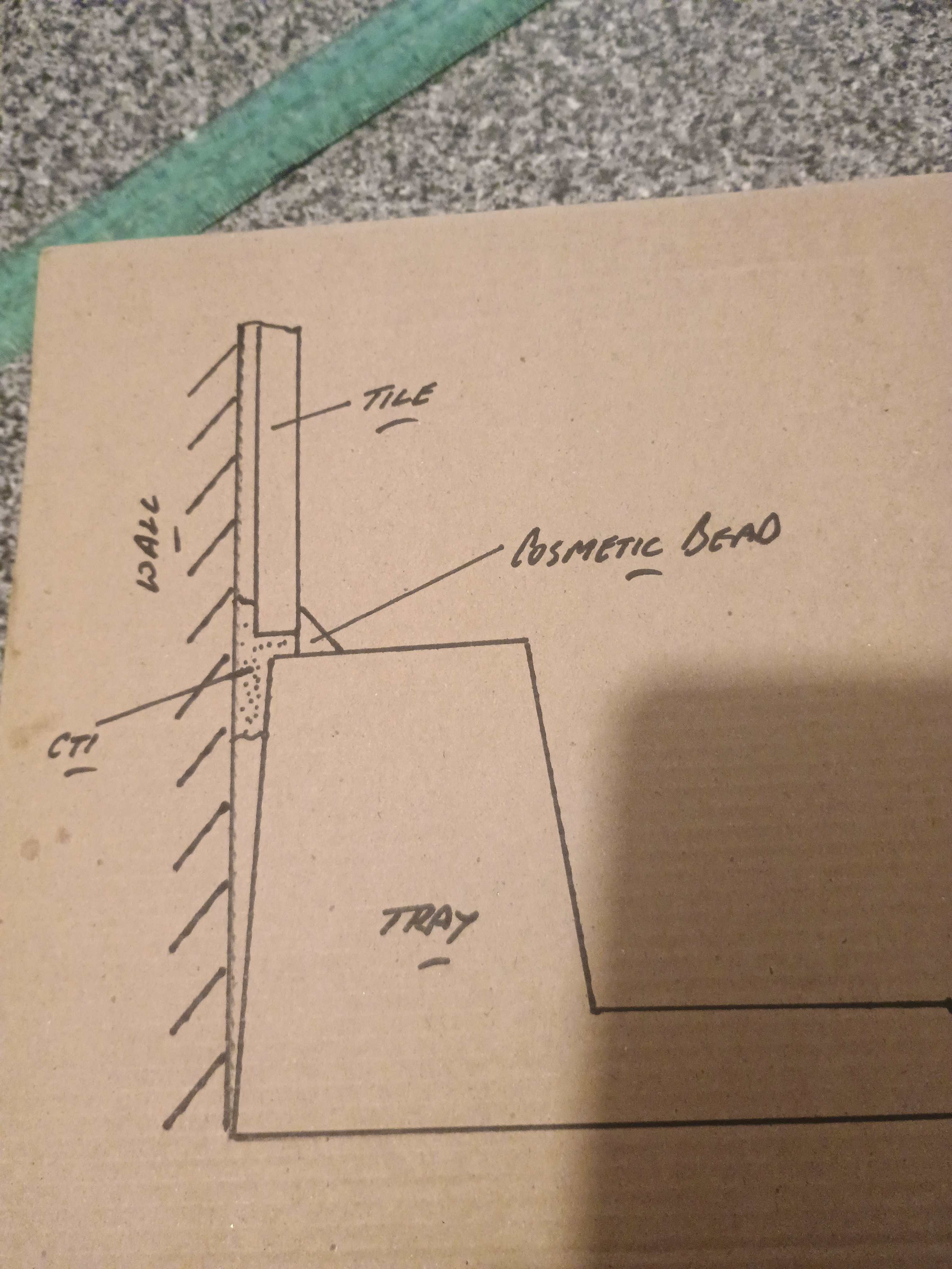

January 18Jan 18 12 minutes ago, Russell griffiths said: Just buy a box of Recommendations for the silicone sealer I should have to hand by the dozen? And the current iteration of Snibbo ? Being more specific: I need to change the failed mastic to a shower tray. Something that stays white, doesn't get mouldy and stays sealed. If it can be easy to handle for this amateur then that's a big plus.
January 18Jan 18 8 minutes ago, saveasteading said: Recommendations for the silicone sealer I should have to hand by the dozen? And the current iteration of Snibbo ? Being more specific: I need to change the failed mastic to a shower tray. Something that stays white, doesn't get mouldy and stays sealed. If it can be easy to handle for this amateur then that's a big plus. Rip it all out seal and any gaps with clear CT1 as the waterproof element then dressed flush with a Fugi Cramer tool kit. Apply a cosmetic bead of Forever White. Have an open black bin bag at the ready and a couple of packs of the cheapest, unscented baby wipes. As you get too much silicone on the tool take it off with a baby wipes and drop into the bin bag.
