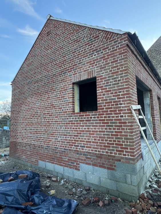

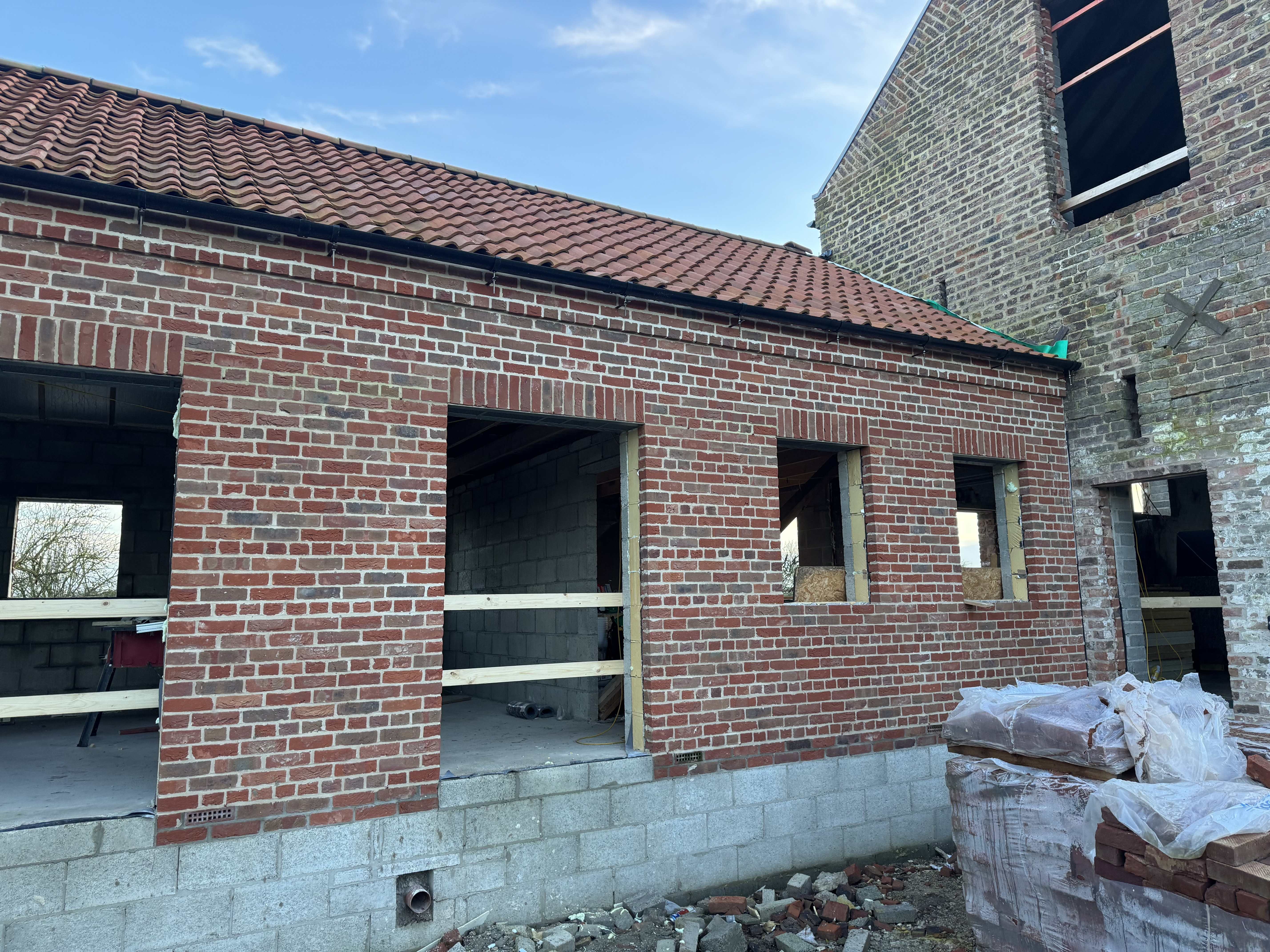

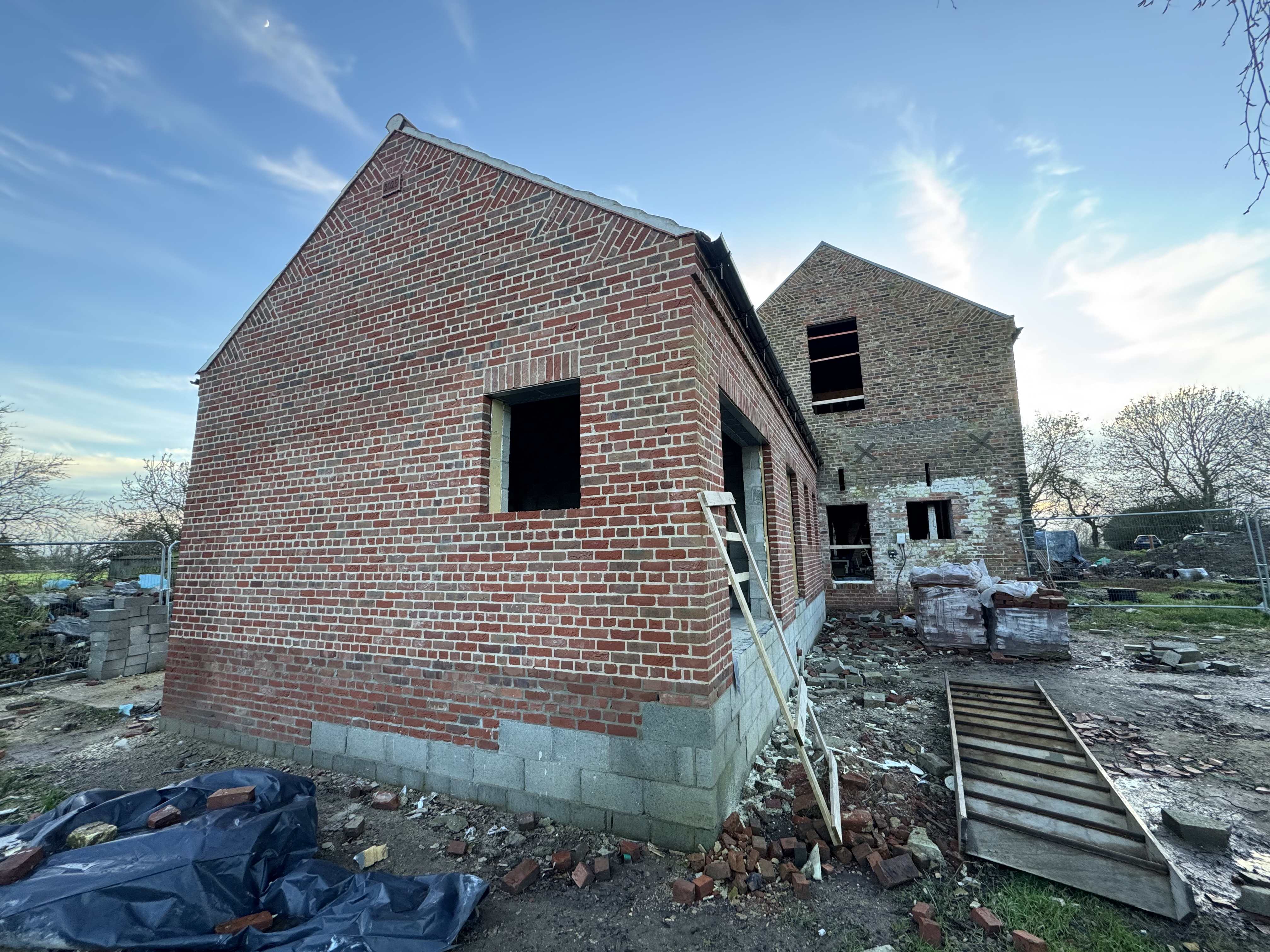

31 minutes ago, Russell griffiths said:
Lovely brickwork @BadgerBodger
I’m so happy with they way it turned out.
absolutey worth the small extra cost.
you can see the below ground in OPC instead of white cement and the difference the white mortar makes
Are you going to get the original building cleaned up a bit.

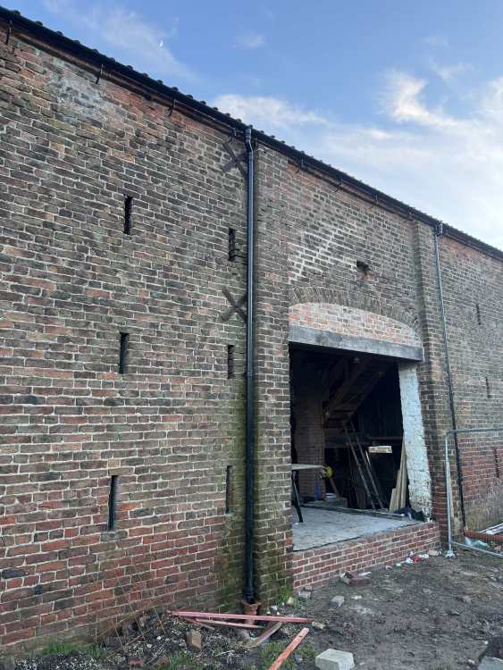

yes. In time. The quotes for pointing were wild. (380m2) so when all is said and done I’ll see what’s left and see what the best way of going about it is.
likely nothing in left in the pot so it’ll be time to learn how to lime point. When I chose my scaffold tower I had this in mind and got something to reach everything.
I’ve had the tops of the gables done while I had a scaffold up for the roof.
39 minutes ago, Nickfromwales said:
A light sand / media blast would bring that back to life ;)
I’m in two minds about this. it would essentially make the barn look a lot cleaner but it would also turn it bright red and, I think lose a lot of character.
It’s got a burnish to the brick l, whether that’s age and „pollution” or how they were fired, I don’t know but inside the building they’re solid reds.
I quite like how you can see how the old buildings abutted from the paint on the outside (which would have been in)
I think I’ll just wire brush the most offensive areas as I point it. You can see the gables look great without

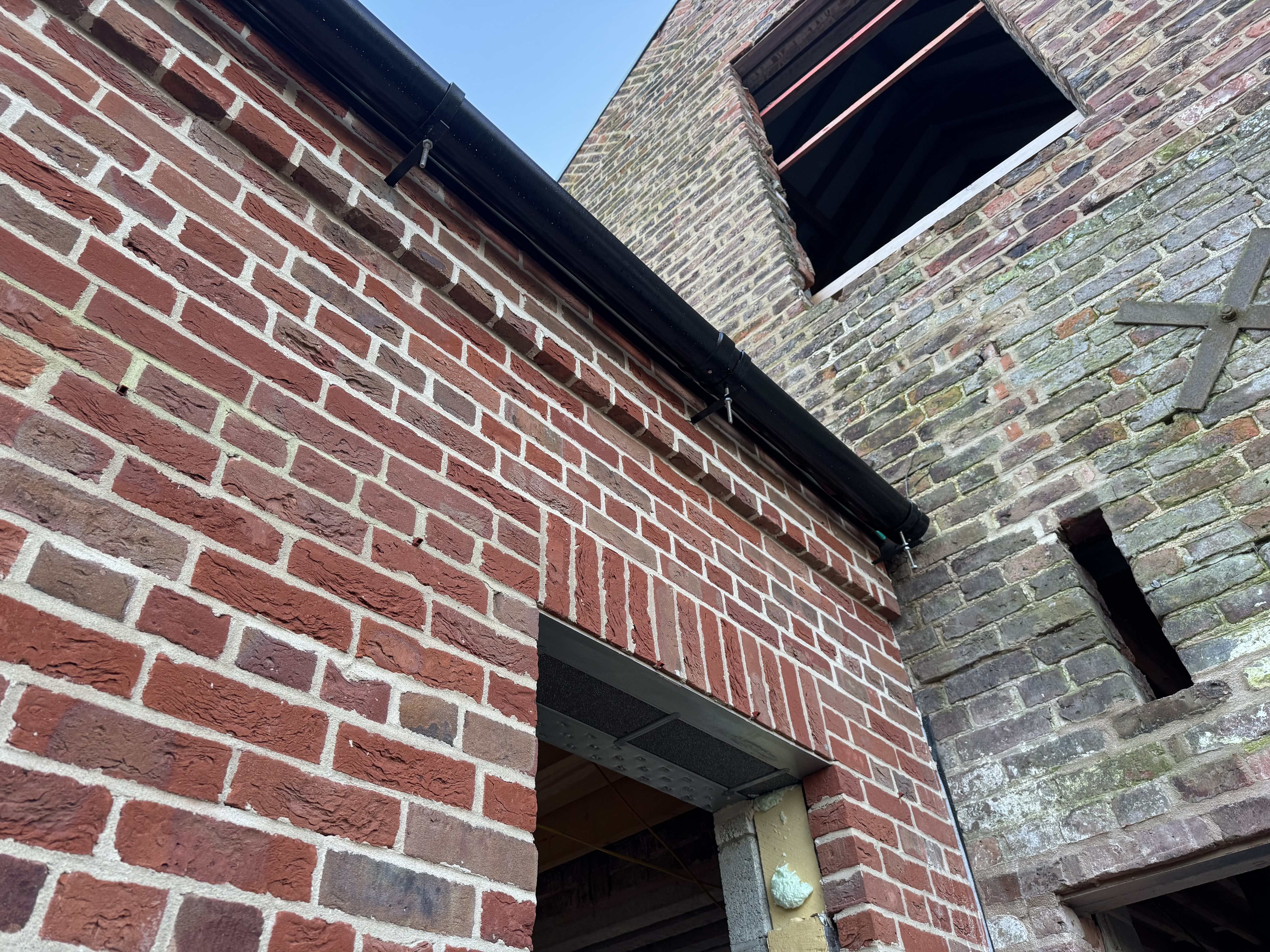

7 minutes ago, Crofter said:
I've always wondered, what's the advantage of metal guttering? It's a huge price premium over plastic which, in my experience, works perfectly well.
Is it mostly an aesthetic thing?
Longevity, they say 50 years+ (more with maintenance)
mine was mandated by the conservation officer (listed building)
I wouldn’t have used it if not. Material cost - £6,500 +/- if I recall. 70m 125mm 1/2 round with 40m downpipe inc brackets, fixings etc
for cast effect plastic you can half that
for straight plastic less than half again
