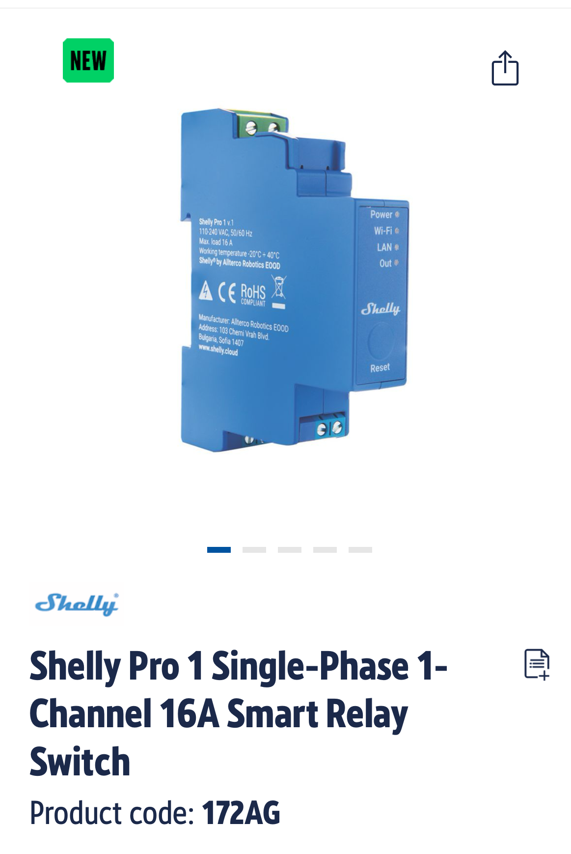

I thought the Shelly’s could be bought with switching capacity for direct connection to the immersion.
depends
is it 16A real and continuous, or chinese...
Hmm. The Pro 4PM is rated for a maximum switching load of 16A per channel, subject to (1) a maximum of 40A across all channels at once; (2) leaving 10mm cooling space around it for currents over 10A and (3) using solid core heat-resistant wire (4) adding a snubber across inductive loads. However the Live input has a 2.5mm² connector which would normally be fused at 16A or 20A, limiting the total continuous load.
IMHO it would seem wise to use the Shelly for control and contactors to handle any serious loads.
I use contactors every job, hence me saying it was my understanding that ‘they’ did this function. I’ve not used Shelly’s before, but they seem an elegant enough solution for not much money.
@TerryE used solid state SSR’s to power up his heating and hot water gubbings, so the attraction is there if you want silent operation vs the clunk of a contractor. @RedSpottedSev, you may want to consider the clunking of 3 contactors and how / where you mount these things.
Due to the size, I assume the Shelly’s are contactors and not SSR’s.
Anyone living with a Shelly care to comment?
