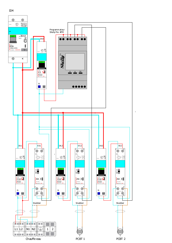

To recap I want to have tight and remote control of x3 3kw immersion heaters. 50Amp RCBO at the main CU. 8m straight 10mm 3 core to loft. Aux CU.
Option a) x3 of: Shelly Pro 1pm (16amp) , then 16amp RCBO then contactor then to immersion. RC snubber but.not really clear if this goes across the shelly pro? Does it have to be physically very close and how does it sit in a DIN CU?
Option b) Shelly pro 4pm (40amp), then 16A RCBO, then contactor... same question re RC snub
Option c) forget Shelly, 16A rcbo in aux CU, then immersion heater, and use this for remote control https://www.tsmart.co.uk/

For the Shelly solutions, the main practical difference between the Pro 1PM and the 4PM is that you need 1 x 1PM for each device (heater, in your case) that you want to control. The 4PM can control 4 devices (and has manual controls in addition to smart controls) and would work out cheaper.
Here's a diagram (modified from my installation to cut out some bits) that shows the wiring; your electrician may prefer to use RCBOs instead of the breakers & RCCB shown here. The latest version of the 4PM has a single live supply terminal, not 4.
I'll be wiring the snubbers directly across the contactor terminals, as shown. The one Shelly sells has bare leads, which would need covering in heat shrink sleeving for safety.
@RedSpottedSev I should have mentioned another safety point on this topic, if you choose to go down this route. The wires held by screw terminals on contactors (as well as RCBOs and the like) must be the same size, so that they are properly secured in place. So, if you were to use 1mm² contractor control wires (black in my image above), you'd need to solder short stubs of 1mm² wire to the end of the contactor leads before applying the heat shrink (unless they're already 1mm² - I can't remember).
