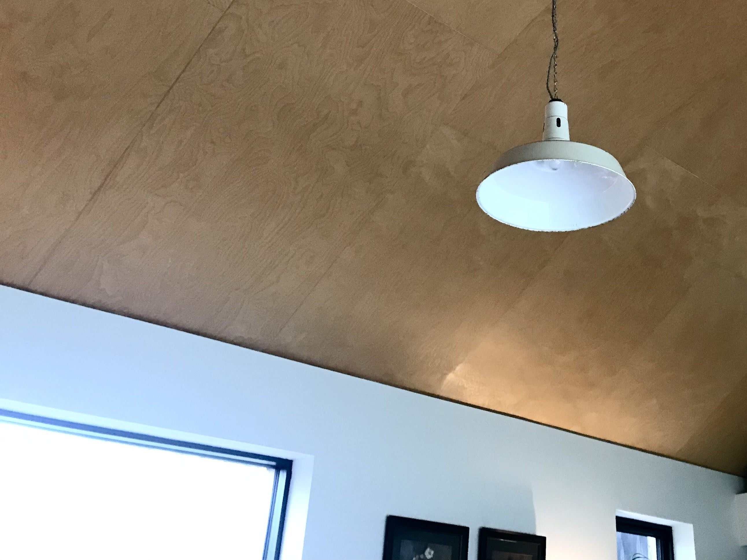

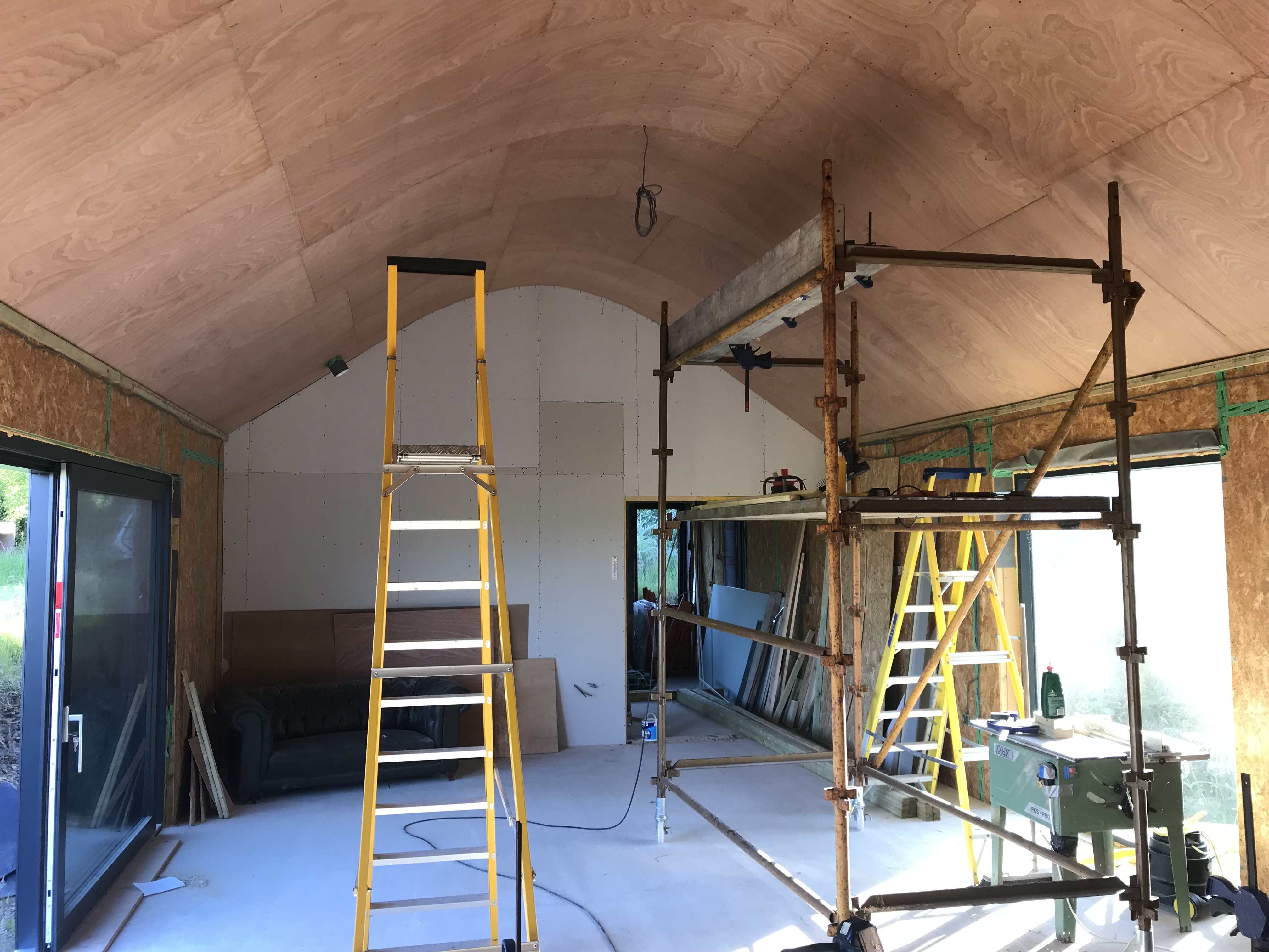

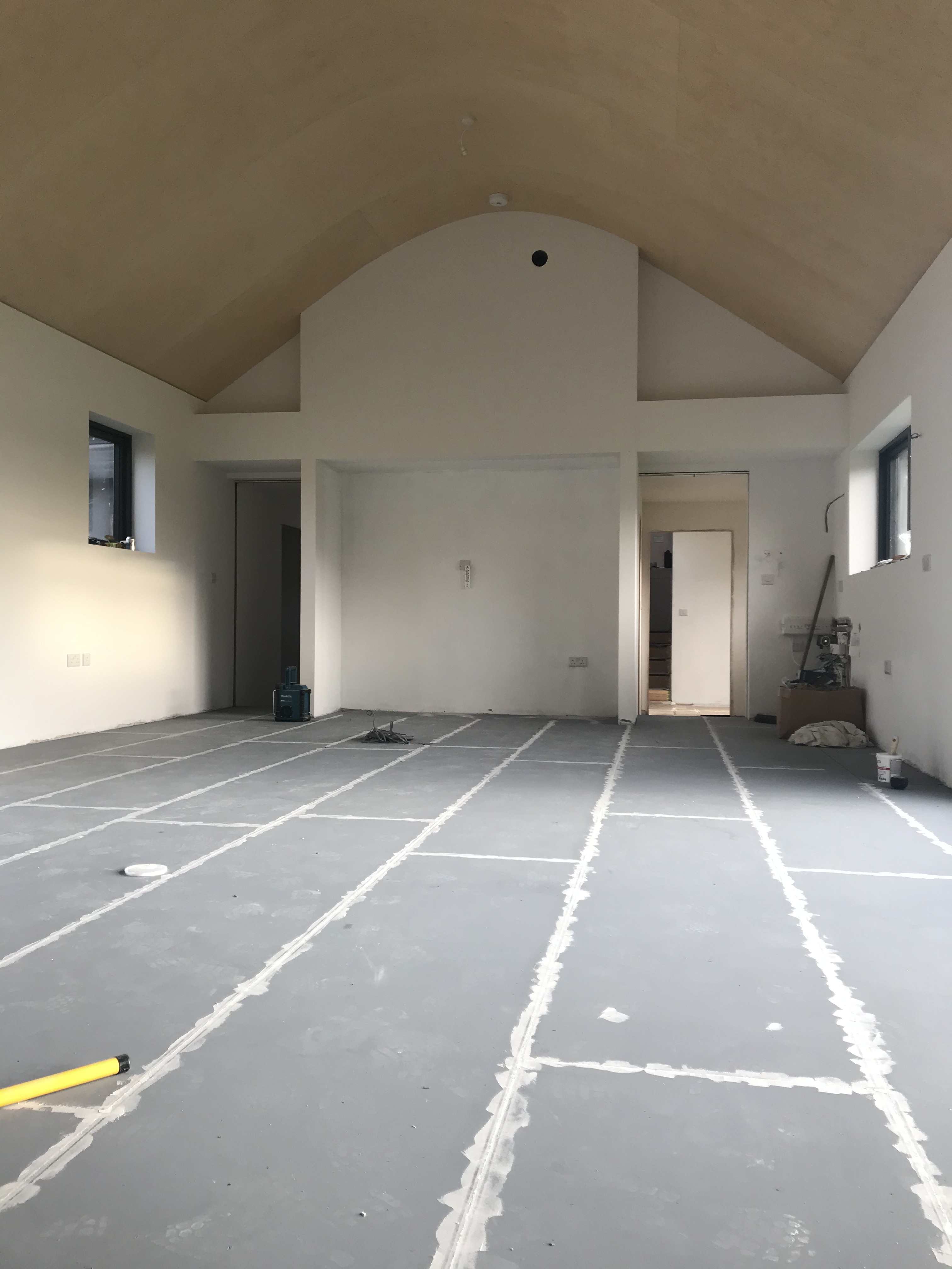

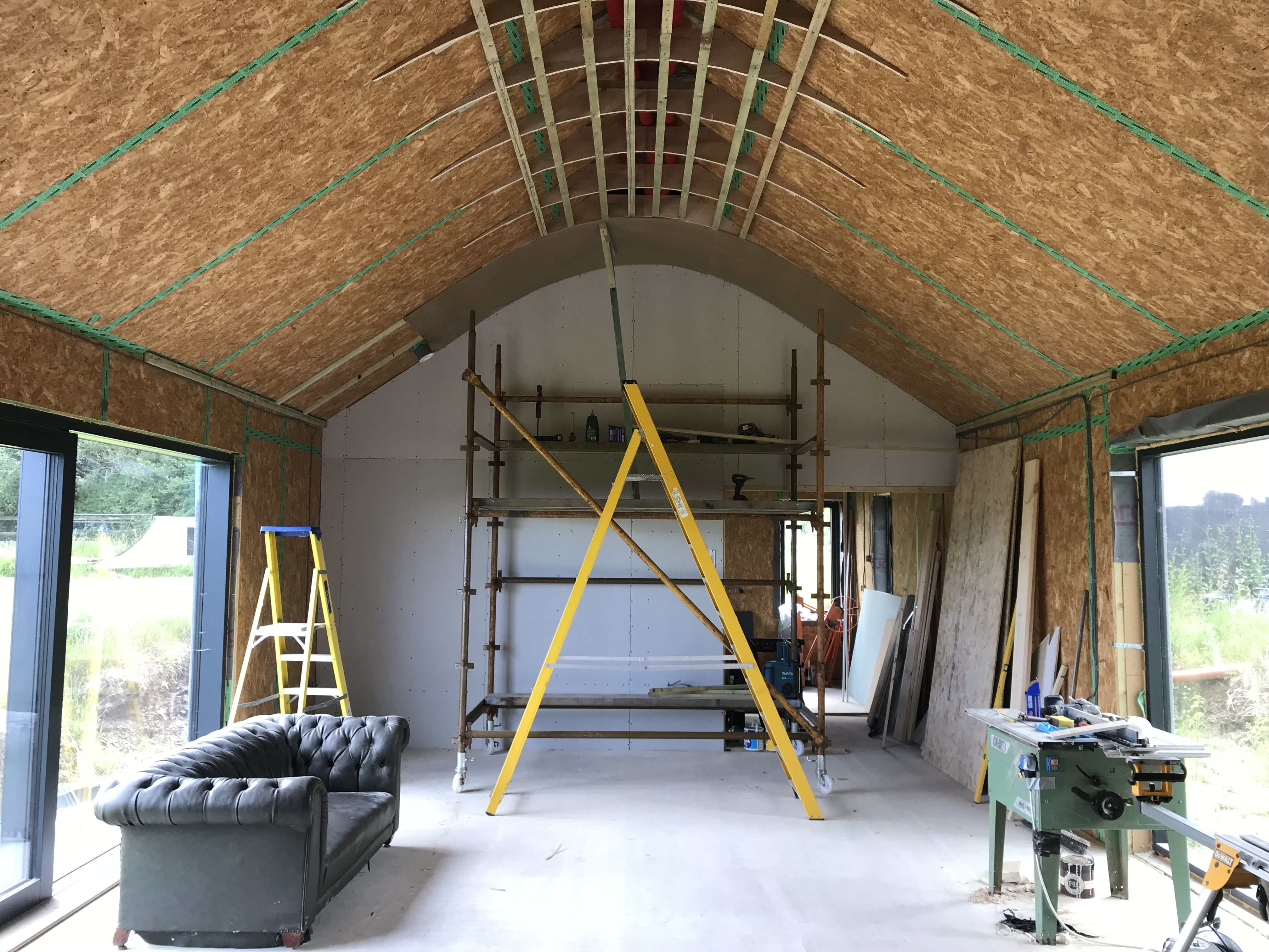

Nestor Posted January 10 Posted January 10 (edited) I had a 10.5m steel for the ridge and did not want to just box it in. So made a frame, similar to a skateboard halfpipe, covered in red faced plywood, then glued and pinned 4mm birch ply. Have two long pendant light fittings, one over island, other over dining table. Your friends might well be right. Will try and find recent photo. Edited January 10 by Nestor 2 1

Great_scot_selfbuild Posted January 11 Author Posted January 11 9 hours ago, Nestor said: I had a 10.5m steel for the ridge and did not want to just box it in. So made a frame, similar to a skateboard halfpipe, covered in red faced plywood, then glued and pinned 4mm birch ply. Have two long pendant light fittings, one over island, other over dining table. Your friends might well be right. Will try and find recent photo. @Nestor thanks - Ihad been wondering if you went for ply to keep its natural colour, but looks like you’ve painted it. What was the reason for going for the ply? was it the curve? We have a spiral staircase and I’m yet to get to the challenge of working out how to get plasterboard to fit without snapping (one for another day).

Nestor Posted January 11 Posted January 11 4 hours ago, Great_scot_selfbuild said: @Nestor thanks - Ihad been wondering if you went for ply to keep its natural colour, but looks like you’ve painted it. What was the reason for going for the ply? was it the curve? We have a spiral staircase and I’m yet to get to the challenge of working out how to get plasterboard to fit without snapping (one for another day). Yes, 6mm + 4mm for the ceiling curve. All depends on the radius and how much pressure you can apply before fixing. Birch ply was only treated with clear osmo oil. I had to create a very tight curve above some stairs and cut lines on the back of the plasterboard, it did work. 1
