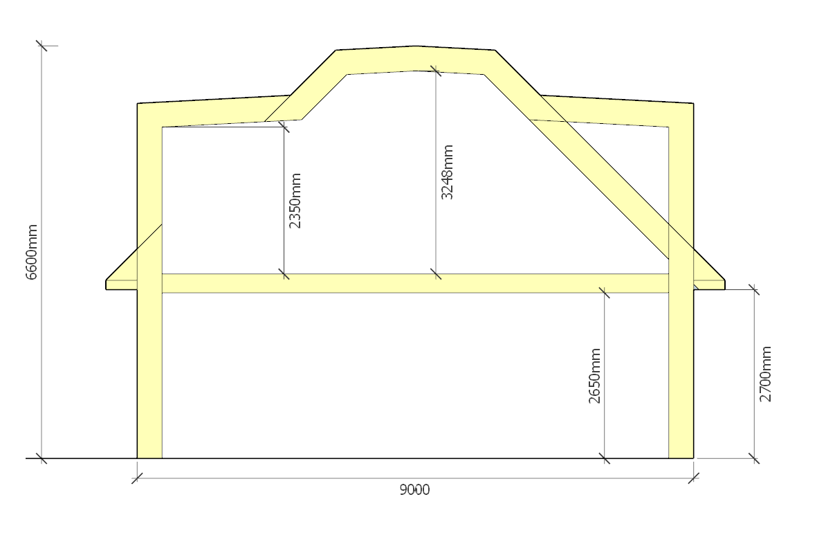

Iceverge Posted January 9 Posted January 9 Based in your design constraints a section like this would be much more buildable. No steps in the upstairs. 45 deg roof into a 3 deg section in the middle for sanding seam. likewise with the dormer. 400mm allowed for the walls and roof for plenty of insulation.
Tony L Posted January 10 Author Posted January 10 @Iceverge. Thank you again for your work on this. I'm pleased you support the idea of "flat roofs" being standing seam at 3 degrees. Let's hope the planners consider this a reasonable fall for my approved flat roof sections (I'm not intending to ask them). I've been working on some detail drawings for the roof intersections this morning. I have to go out now, so I'll aim to I'll finish these off & post them this evening, along with responses to the other points from your post above.

Tony L Posted January 10 Author Posted January 10 Thanks again for this, @Iceverge. I like what you’ve drawn. Sorry, the roof can’t be at 45 degrees because this would stretch the flat roof section at the top & make the building look very different from the approved plans. 400mm EPS in the walls is appealing, but it would make the inside too small & it can’t happen because [I’ll be in big trouble with you when you read this] the substructure is already built. For the benefit of anybody reading this whilst researching your possible self build, & to save @Gus Potter & @Iceverge the trouble, l will just explain: building the substructure before your superstructure drawings have been finalised is a very bad idea.

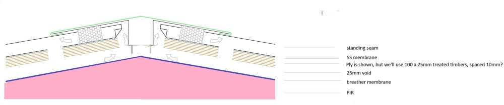

Tony L Posted January 10 Author Posted January 10 I’ve added to a drawing I found online to show how the ventilation & drip edges will work at the apex of a standing seam roof, at 3 degrees .

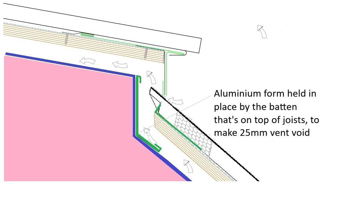

Tony L Posted January 10 Author Posted January 10 & here’s a detail for where the 3 degrees centre section meets the 42 degrees section. I’ve added in some L shaped plates (green) to prevent rain being blown up the roof & into the vent void. This same detail could be used where the the 42 degrees sections meet the backs of the 3 degrees flat roof sections over the dormers.

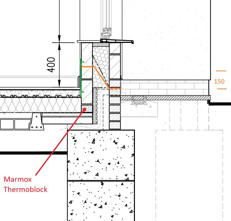

Tony L Posted January 13 Author Posted January 13 20 hours ago, Gus Potter said: This cavity tray detail for example does not work, not least as the piece of masonry on the inner leaf will just come loose when you bed the cill, probably before that, there is no insulation under the cill. The shaped insulation is not achievable. What will happen is that you will end up paying for something that does not get delivered on site. Thanks very much for pointing out this error - I hadn't spotted that one. Although, I don't understand which bits are, "the shaped insulation". I'd expected the air brick periscopes would be drawn, hard up against the outer leaf, & I'd have more EPS beads under the cavity tray & between the periscope & inner leaf, right down to the trench blocks. As it is, there's a gap on one side of the periscope & some unspecified board on the other side. The brick sized cross section at the bottom of the inner leaf, on top of the block & beam, is a Marmox Thermoblock. 20 hours ago, Gus Potter said: Now I've distilled your problem down. So all of a sudden that looks a bit more hopeful! Yes, it does. Thank you. 20 hours ago, Gus Potter said: What has happened is that as you have learnt more about the bit in between the outside and the inside you are discovering that it is hard Yes, it's hard for me to learn, especially with the house build being just one of several significant responsibilities I must devote time to. I am keen to learn all about this, but when I began this project, I didn't imagine I'd be forced to learn in so much detail, to mitigate the losses from people who want to rip me off & others who are just incompetent. 20 hours ago, Gus Potter said: Consider trying to find someone who has the skills to review your design in the whole, identify a way forward that is buildable, knock heads together when required. That includes knocking you into shape I have already been thinking, with his limited talent, this arch tec’ is only going to be able to get us so far & unless I start again with somebody else (4th re-start) with the drawings, I’m going to need to pay somebody who knows what they’re doing to go through everything the current arch tec’ draws & re-work the details he’s not able to design properly. I know I can’t trust my arch tec’s work, because, even with my very limited understanding of what needs to be done, I can spot many errors & I can see he doesn’t fully understand how to do his job properly. Even if I start again with somebody else, there’s no guarantee the next person would be any better. I came across Richard Bendy, who may be the right person to check over the drawings. I haven’t made contact yet: https://www.thehealthyhome.uk Ideally, my arch tec’ would pay Richard to show him where he’s gone wrong, & teach him how to do what I’ve contracted him to do, but I know this won't happen. Richard Bendy's services include training architects. 20 hours ago, Gus Potter said: They pay professionals, but only from the neck down! Re. paying professionals: I had a good meeting with a proper architect, who has designed & overseen the completion of some certified passive houses. His quote (& this is for a house that has already been designed to PP level & for which PP has been granted) was £28,272 inc VAT. This included 12 hours for electrical layouts, which my current AT’s contract doesn’t specify, & some of the things that my AT has so far failed to include in his drawings, such as door threshold detail & intermediate floor to external wall detail, were specified in the £28k+ quote. There was also a substantial fee for, “building contract admin, PD & on-site support”, which I negotiated down from the quoted fee to £2,160/month (inc VAT) for the duration of the project. I was told that it would be very unusual to proceed without this monthly fee, but if I chose to do so, I’d be completely on my own once the drawings had been handed over & I wouldn’t be able to call for help with the build (a condition arising from the architect’s insurance policies). So that’s £50k, assuming we pay the monthly fee for 10 months & don’t need any extra drawings. & this fee was based on me providing the .dwg format drawings (which I had only as .pdf) from the AT that I was about to sack, for being quite a lot worse than the current one. A prominent member on here explained, many architects overcharge for work that’s often sub-standard. He highly recommended the AT I‘m trying to work with now. This BH member gives out good advice here on BH all the time & I trusted his judgement. Here’s an excerpt from the current AT’s quote: My fee to prepare a detailed set of construction drawings for a dwelling of this scale and design, including detailed floor plans, 2 x sections, annotated elevations, site plan showing drainage and services, specific details of key elements which require further thought/ironing out such as the cantilevered box and corner glazing and a set of construction notes/specification, would be £6000 plus VAT, 50% of which would be payable upon instruction with the balance payable upon issue of final drawings. This is an all inclusive fee for the complete set of drawings and details. There are no further charges for any amendments required or liaison with structural engineers or building control, or indeed yourself. Therefore there are no nasty surprises further down the line. 20 hours ago, Gus Potter said: I'll leave these thoughts with you. Thanks again, Gus. I’m away from Friday, for 9 days, so I must just explain: any comment anybody posts will be gratefully received, although I won’t respond until the week after next, because I’ll be having a fantastic time snowboarding & screen time will be limited to essential work comms only.
Tony L Posted January 13 Author Posted January 13 I thought I'd put up a clearer picture of the poor detail @Gus Potter pointed out so that anybody who's interested can see it clearly. I'm wondering if the cavity tray went in under a full block (see orange line), this would make the arrangement sufficiently robust. We could also attach some steel brackets under the window (green line), with bolts into resin & appropriate attention to air tightness detail, behind the brackets. I've only just come up with this idea. No doubt there will be a proper way to do it, which will work better & cost less - please advise. The cill projection, at about 100mm, looks vulnerable & is much wider than I want. I've asked for this to be reduced to 45mm.
Tony L Posted January 13 Author Posted January 13 The orange 150, above, is supposed to represent the height difference across the orange tray. I've just realised the top bar is drawn a little low, & my 2 minutes, or whatever is allowed, of editing time has expired.
Iceverge Posted January 14 Posted January 14 2 hours ago, Tony L said: I thought I'd put up a clearer picture of the poor detail @Gus Potter pointed out so that anybody who's interested can see it clearly. I'm wondering if the cavity tray went in under a full block (see orange line), this would make the arrangement sufficiently robust. We could also attach some steel brackets under the window (green line), with bolts into resin & appropriate attention to air tightness detail, behind the brackets. I've only just come up with this idea. No doubt there will be a proper way to do it, which will work better & cost less - please advise. The cill projection, at about 100mm, looks vulnerable & is much wider than I want. I've asked for this to be reduced to 45mm. We had a separate DPC on the external leaf 150mm above external ground level. There's no need for a tray here. Just let the EPS beads fill to the bottom of the cavity.
