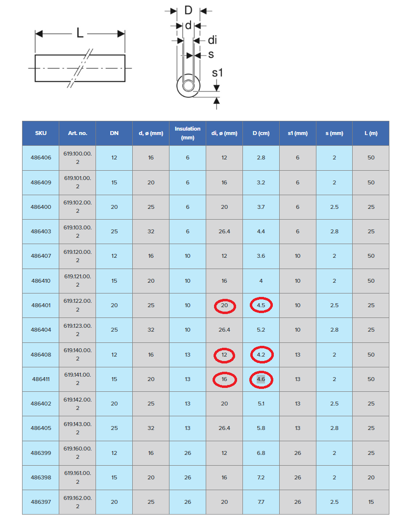

I've been looking at these Geberit FlowFit Pre-Insulated pipes to use as supply pipes to the bathrooms running in a 50mm service cavity. Probably 20mm ID to bathroom and split locally to taps / bath / showers? (Kind of assuming there's nobody else in there when someone is taking a bath/shower). I've highlighted the ones that have max insulation but just fit in my service cavity. No need to insulate cold? Anyone have any thoughts?
https://www.pipestock.com/geberit-flowfit-pre-insulated-system-pipe-blue-coils

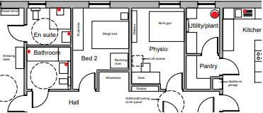

Yes, my thoughts were that we are a pretty habitual family and our DHW usage is pretty much confined to two distinct blocks of time 0500-0800 (showers and washing up) and 1700-2000 (baths, showers and washing up) with random intermittent use inbetween.
I’m putting the tank right above the main cloakroom which will get the majority of the use during the day. But the longest run is likely to be 55m if I did it radially (one of the kids bedrooms) and when it’s bathtime it’s bathtime if you know what I mean.

No. But thinking about more deeply a good bit less. Tank is at east end nearest heat pump.  Length of build from on end to the other 32m + 6m elevation between GF and FF. ad in a bit for not being able to make the most direct route. Call it 45m on the safe side.
Nonetheless. Having to draw down on 45m pipework to have a shower, run the water to wash your hands is gonna waste a good lot of water and I imagine, in the case of the WHB, you’ve probably washed your hands before you get the hot water in the most extreme case.
The kitchen and master bed are still 15 and 25m respectively!
