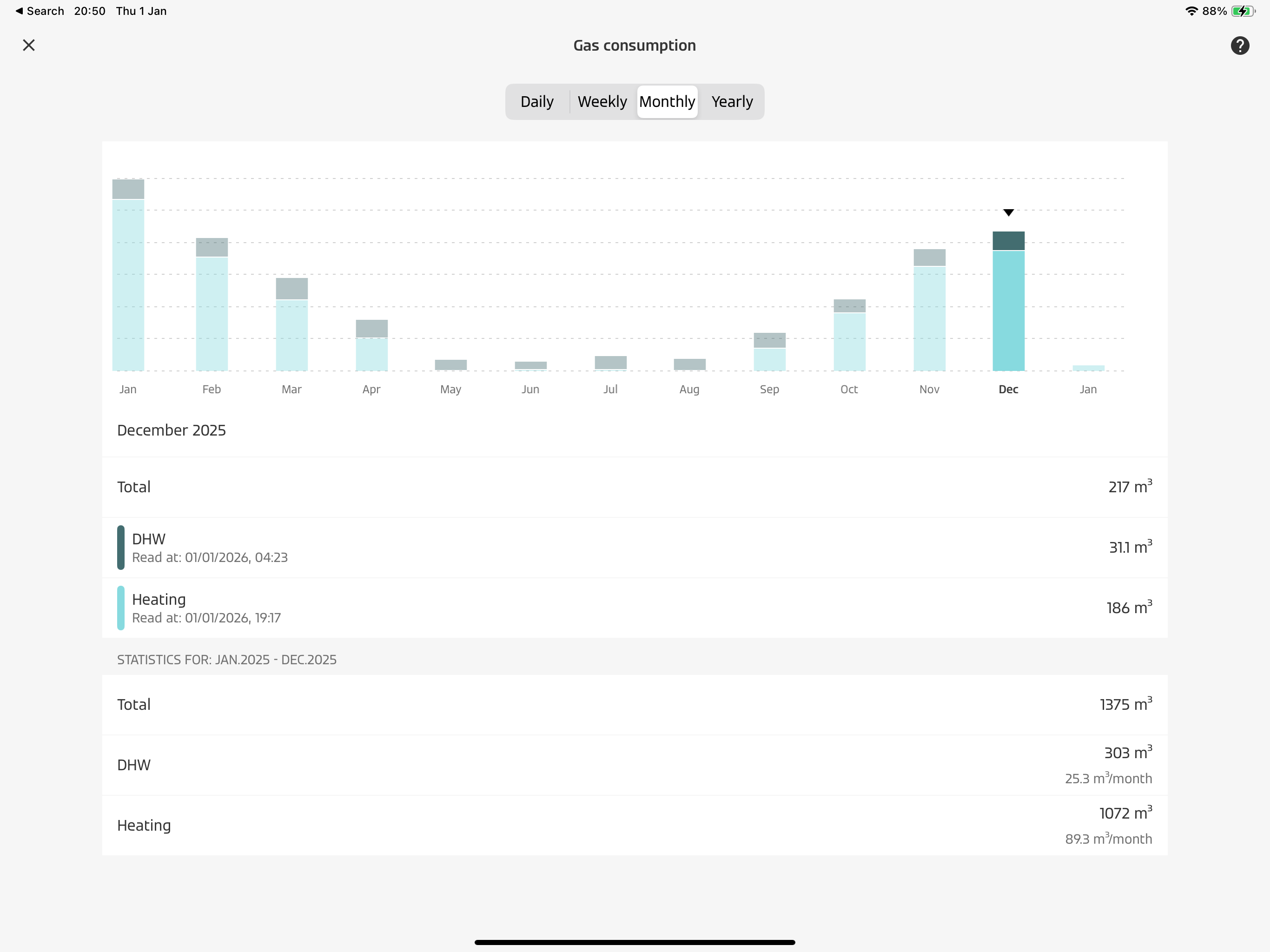

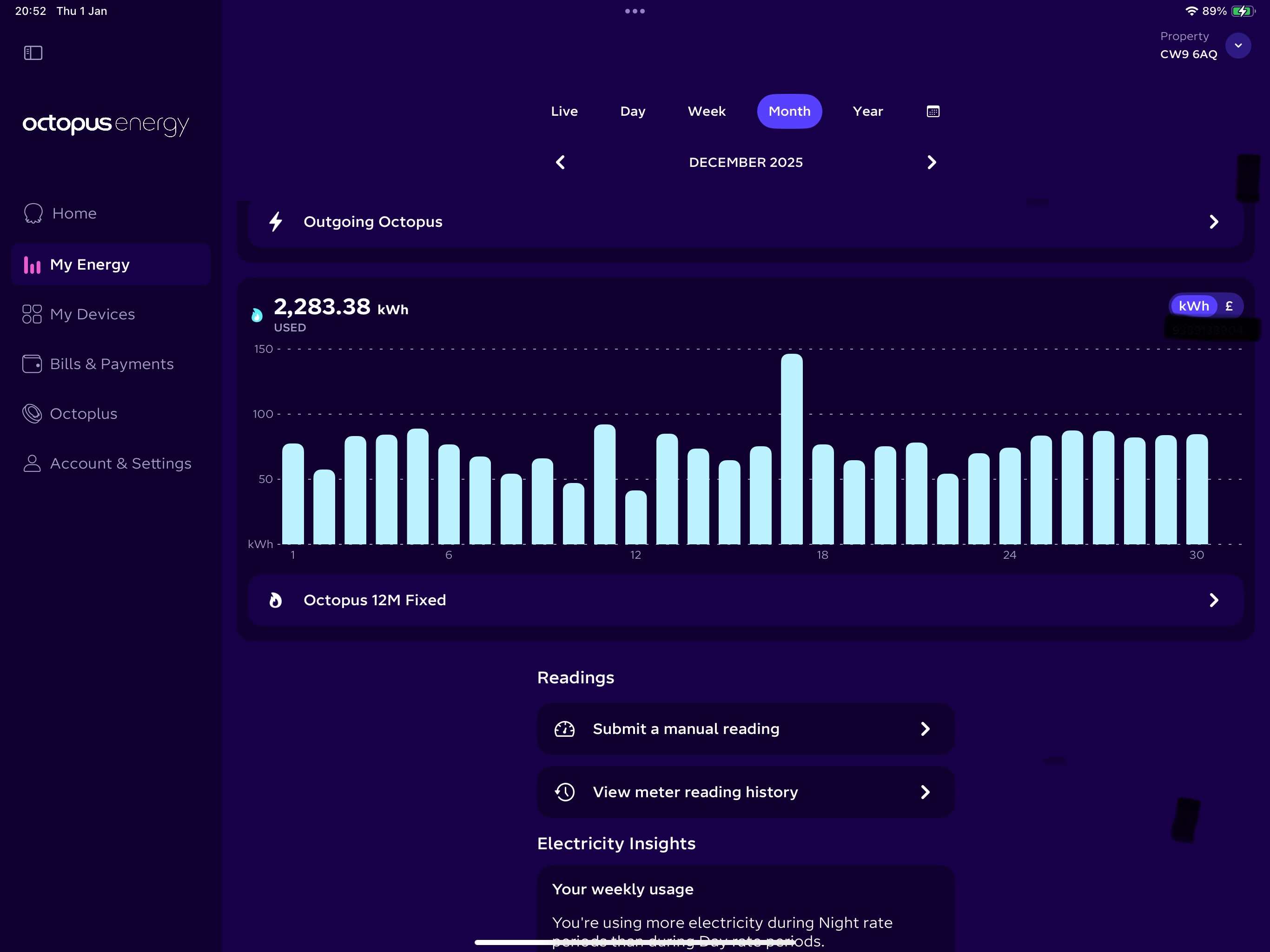

Here’s the stats for the boiler space heating vs DHW
Measured at the boiler and it aligns with actual usage measured by Octopus.
