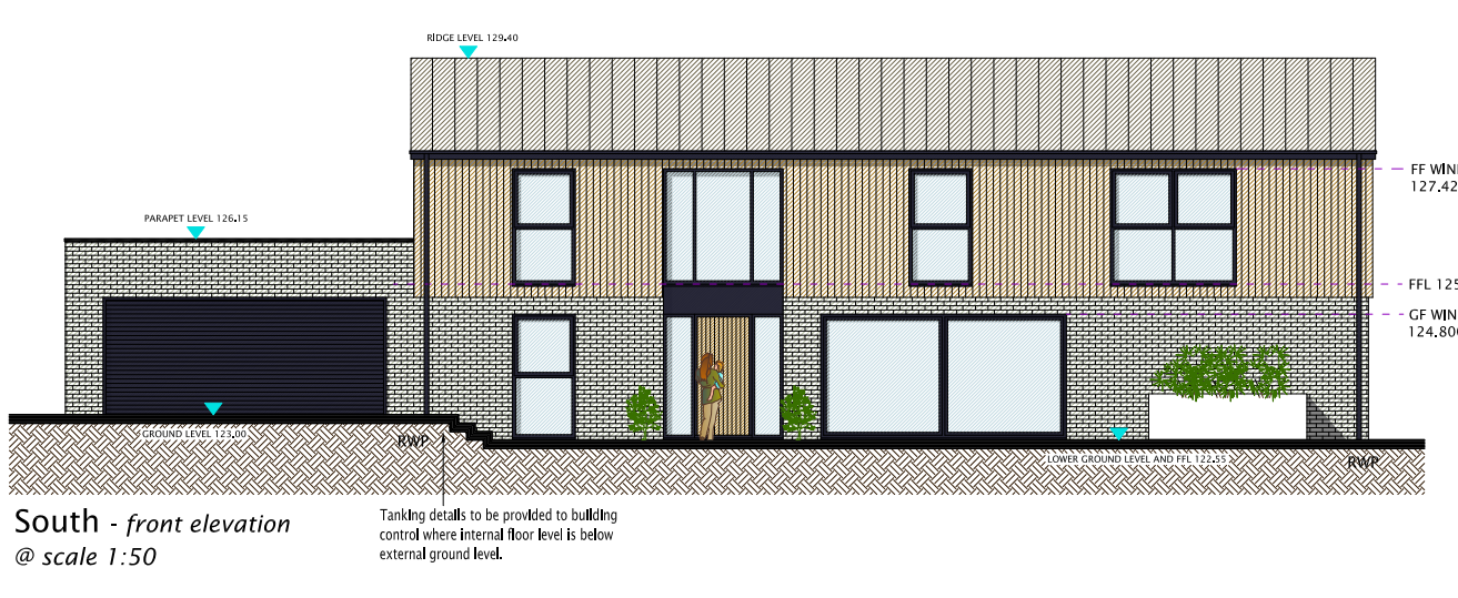

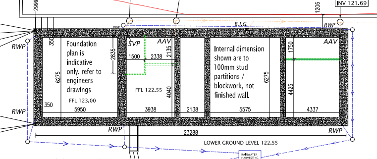

flanagaj Posted 5 hours ago Posted 5 hours ago The attached single storey garage of our house has a finished floor level 450mm higher than that of the house and I am trying to work out how best to do the footings. My original idea was to simply dig the footings of the garage to the same depth as that of the house and then just have an additional two course of blocks. I mentioned this to a builder and he said that nobody will want to be in the trench to do the blockwork and instead I should just pour an additional 450mm of concrete. So I am a bit confused as to how to proceed. I have read on the NHBC guide about stepped footings, but not sure how this works with the adjoining cavity wall that is shared between the garage and the house (see below)
JohnMo Posted 5 hours ago Posted 5 hours ago Don't you have a design from either the structural engineer or architect or both? You normally have a stepped strip foundation, but this is normally detailed on your drawings.
flanagaj Posted 5 hours ago Author Posted 5 hours ago Just now, JohnMo said: Don't you have a design from either the structural engineer or architect or both? You normally have a stepped strip foundation, but this is normally detailed on your drawings. The technical architect didn't provide details and the SE was as much use as a chocolate teapot
Mr Punter Posted 5 hours ago Posted 5 hours ago 1 minute ago, flanagaj said: SE was as much use as a chocolate teapot Get them to do the drawings and spec. You don't want to be designing this yourself or winging it on site when you have paid a professional to do this.
flanagaj Posted 5 hours ago Author Posted 5 hours ago Just now, Mr Punter said: Get them to do the drawings and spec. You don't want to be designing this yourself or winging it on site when you have paid a professional to do this. Ok. I will see if I can find another SE who is local to us.
JohnMo Posted 5 hours ago Posted 5 hours ago 1 minute ago, Mr Punter said: Get them to do the drawings and spec. You don't want to be designing this yourself or winging it on site when you have paid a professional to do this. And don't trust your builder to make engineering decisions - he isn't qualified 1

Temp Posted 3 hours ago Posted 3 hours ago (edited) Ok so the issue is where the higher garage founds meets the lower house. The ground must slope down to the house in this area so you also need to think about drainage and the visuals. You don't want to be looking at exposed concrete. I would expect a standard stepped foundation a few feet along the garage wall away from the house depending on how the ground rises. Some engineered bricks might be needed where partly burried? Check ground levels carefully to avoid the wall of the house accidentally becoming a retaining wall. I agree an SE needed to design how the garage floor slab abuts the house. Edited 3 hours ago by Temp
