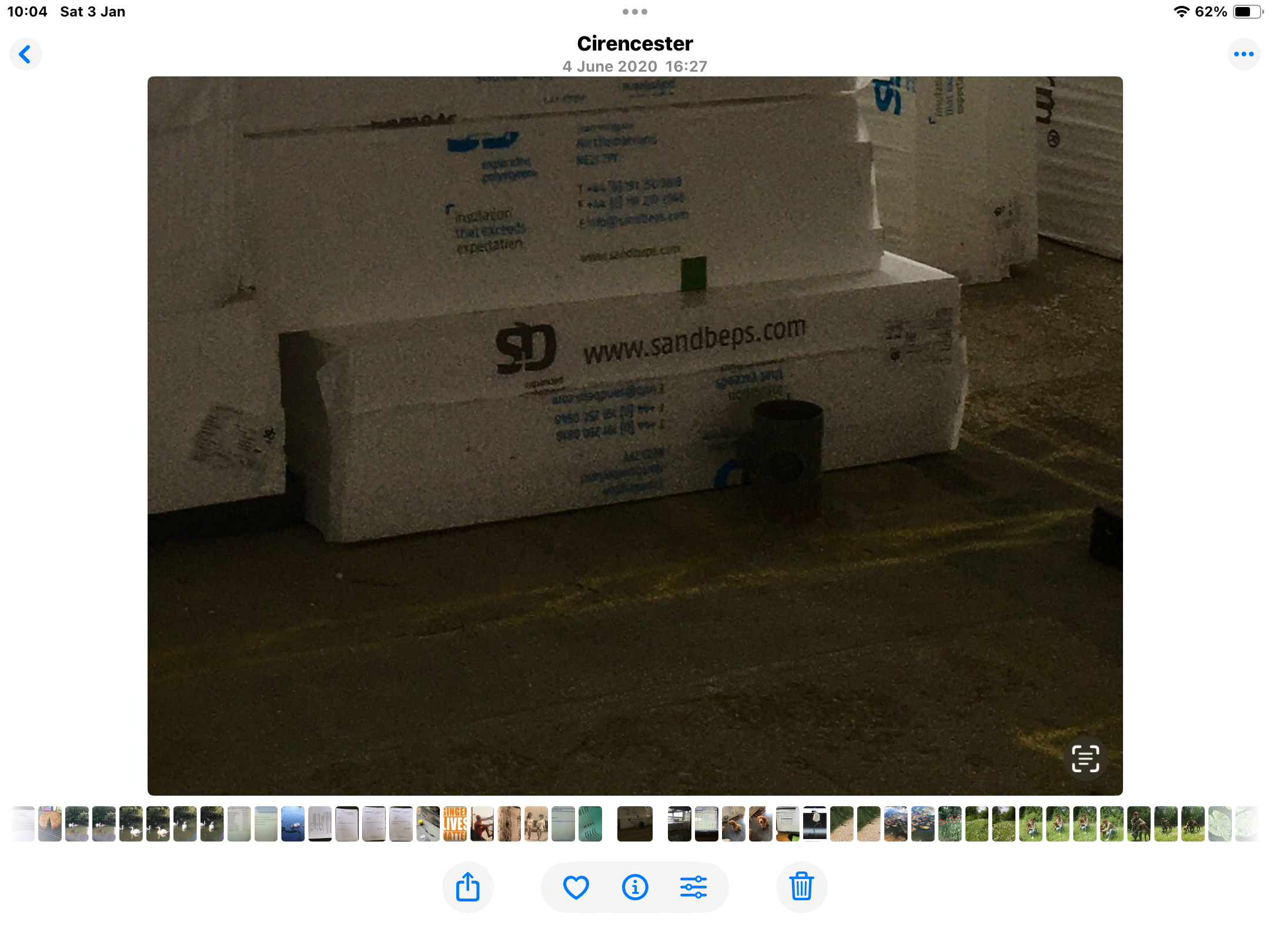

Russell griffiths Posted 10 hours ago Posted 10 hours ago The problem with all these comparisons is you are comparing the prices from the builders merchants if buying EPS you can deal with the manufacturer, pir manufactures won’t deal with you. I got my EPS100 at a third of the price of pir.
saveasteading Posted 10 hours ago Author Posted 10 hours ago 2 minutes ago, Russell griffiths said: a third of the price of pir. where, where, where please?

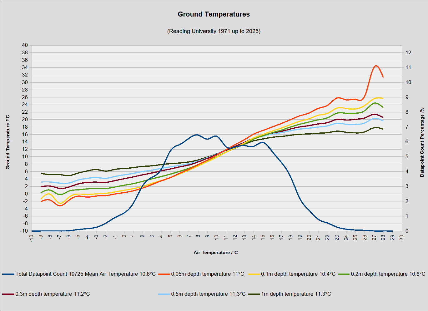

SteamyTea Posted 9 hours ago Posted 9 hours ago 45 minutes ago, saveasteading said: wonder how much the temperature at 1m depth drops by the end of winter. By the new mean yearly temperature. Ground at a metre depth is generally about the mean yearly air temperature. But as I mentioned earlier, it is more complicated than that.

saveasteading Posted 8 hours ago Author Posted 8 hours ago 18 minutes ago, SteamyTea said: Ground at a metre depth I meant after a winter of the ground source pipes removing the therms. They look like this but with arms and legs: 10 minutes ago, SteamyTea said: the finickity losses. That needs an Ancient Greek letter. 15 minutes ago, SteamyTea said: 0.2m extra thickness over 100m2. You mean deeper to the perimeter? It makes sense to have deeper insulation round the perimeter, and shallower to the middle, but that isn't happening. It's just going to be a less efficient area of the building, balanced by the centre of the slab being over-insulated. Perhaps PIR to full depth around the perimeter and 2 layers eps centrally is the pragmatic (and finicky) decision. It is intuitive rather than proven, but I'm confident I could write a page of 'proof' for the building inspector if it was necessary... but it isn't and will just be our decision.
SteamyTea Posted 8 hours ago Posted 8 hours ago 6 minutes ago, saveasteading said: Ancient Greek letter A bubble. 7 minutes ago, saveasteading said: It is intuitive rather than proven I think it is proven, but may have to ponder it a bit more. Then do a bit of modelling. Thermal losses can be quite accurately modelled using the cube root of the sum of 3 dimensions, 4 dimensions if you want to add in time. Or use a Fourier multiple sine wave calculation, but I never intuitely understood that.

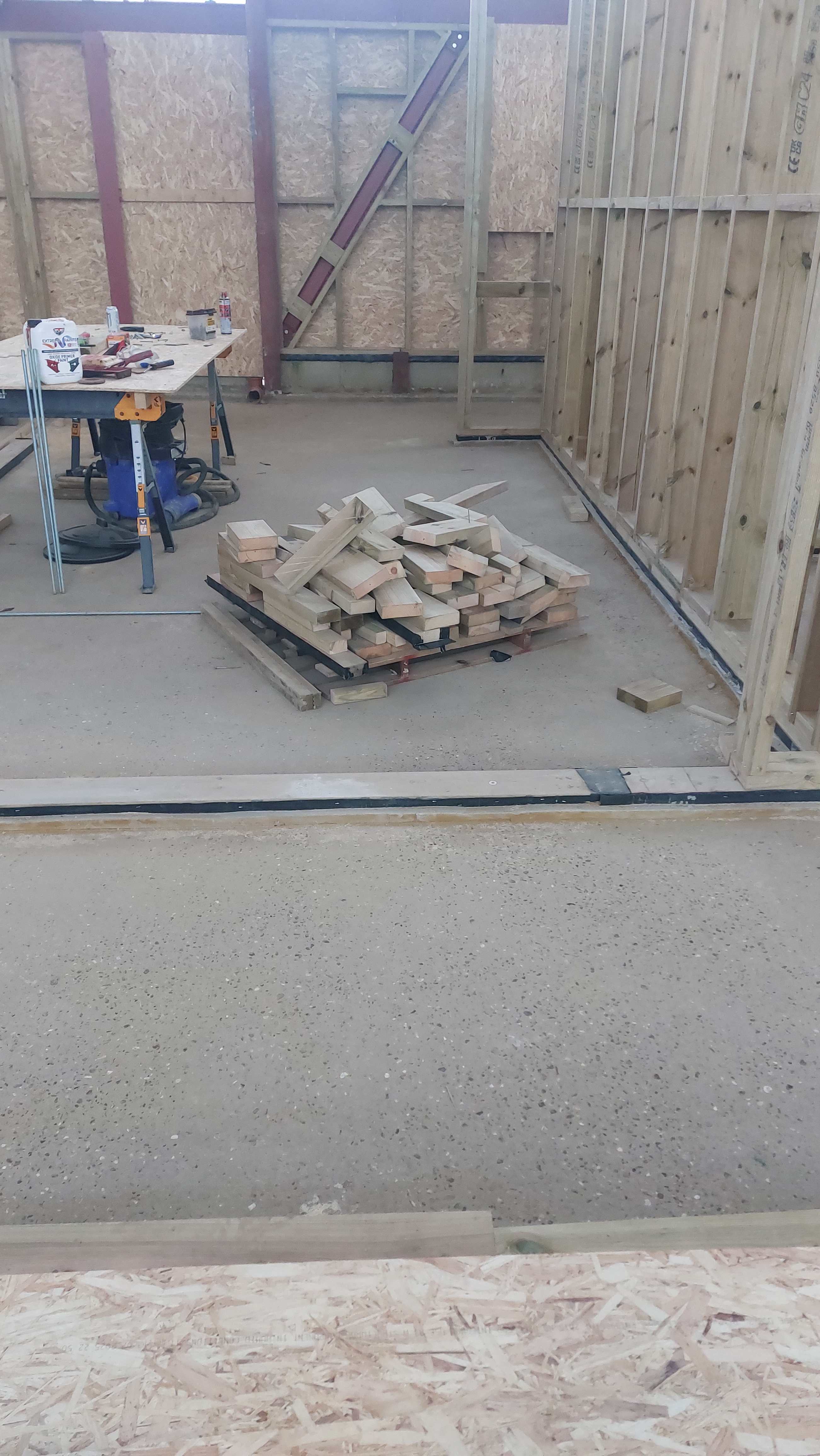

Gus Potter Posted 7 hours ago Posted 7 hours ago 21 hours ago, saveasteading said: I'm aware of that but reminders are no bad thing. I wonder how well a soft packaging eps would fare beneath 100mm or more of PIR and a grand piano on top. perhaps with a big enough dish under each wheel it would be ok. This is whimsical: I am not saving amazon packaging to try it. Interesting! In SE terms. For fun let's take a grand piano. That weighs about 550 kg and has three legs. Thus about, say 183 kg per leg. A "20 -22 stone" rugby prop can in the modern fast game can be 110 kg, but say the team just needs dead weight, so take the prop as 140 kg. Not far off the load from a grand piano leg. But the piano does not walk about, the prop does so lets add a bit of dynamic load to their foot fall. Say 20% thus 1.2* 140kg = 168kg. And all of a sudden we realise that locally on a screed a big lad has something to say and a point to make! Welcome @rjclark71 to BH! To delve into @saveasteading question do we put EPS on top or below the PIR? In this case we are looking at a ground bearing slab that is not supported by (at the edges) or transferring load to the perimeter foundations. There is a cement based screed with underfloor heating pipes (UFH) embeded in it. Now we have a point load ( a piano has a larger foot than a shoe, take the shoe heal as this load is more concentrated. The load from the heal of the shoe gets spread out at roughly 45 degrees down through the screed and onto the first layer of insulation. It then gets spread more down through the insulation thickness. Therefore the compressive stress gets less the deeper you go as the load is spread out more. In conclusion it makes sense to put the weaker insulation on the bottom as the loads are more distributed. 1
saveasteading Posted 5 hours ago Author Posted 5 hours ago 2 hours ago, Gus Potter said: weaker insulation on the bottom Yes, but does the floor screed move or crack under the foot of Xander Fagerson? And will the tv packaging be strong enough?

Gus Potter Posted 4 hours ago Posted 4 hours ago 20 minutes ago, saveasteading said: Yes, but does the floor screed move or crack under the foot of Xander Fagerson? And will the tv packaging be strong enough? On my phone but quickly. He went to Strathallan so his weight may be under estimated.. Yes technically the screed will crack further. The screed had no residual tensile strength due to the UFH pipes. So it really works in direct beating only. On balance the packaging is likely not suitable. The screed has a small aggregate and thus aggregate interlock is less reliable. But the shrinkage still remains.
