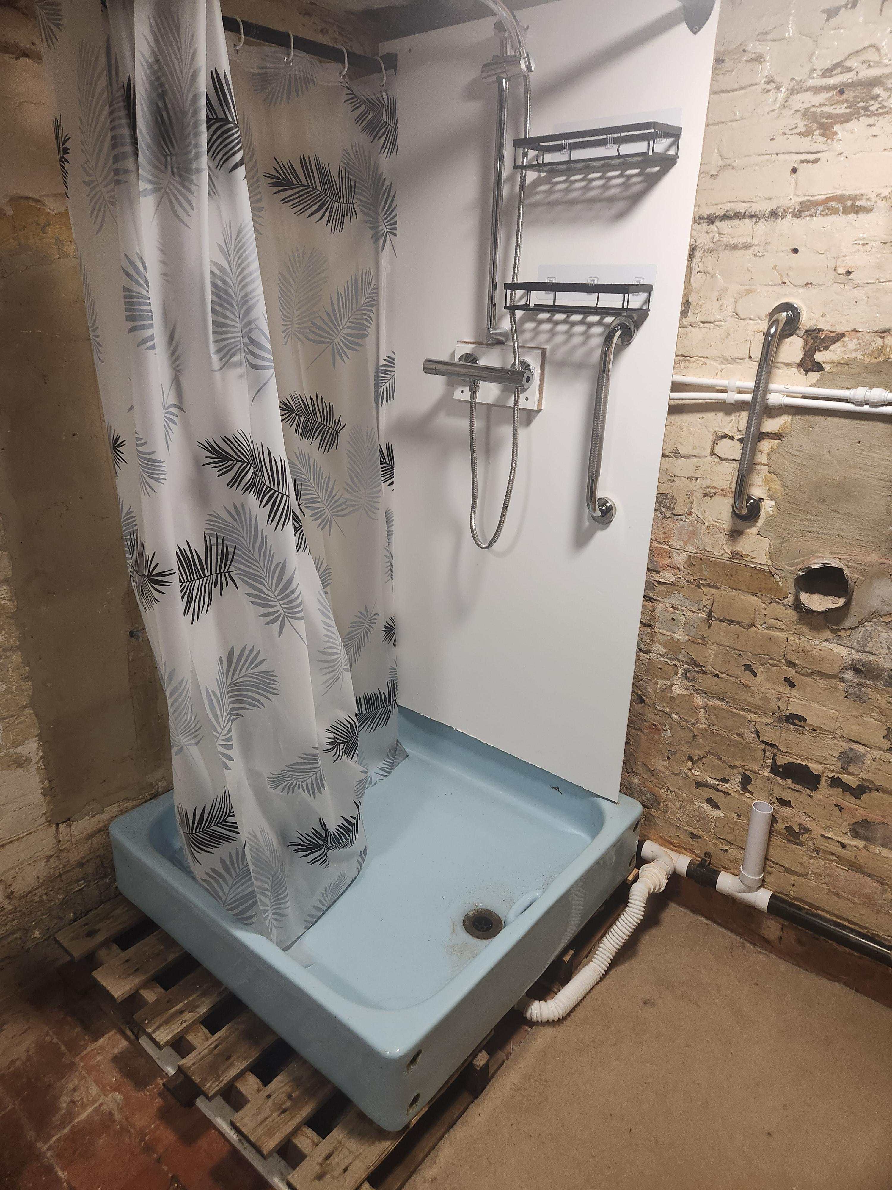

paro Posted December 28, 2025 Posted December 28, 2025 Hi All - I'm preparing for the next part of my refurb which is making good the upstars bathroom and am looking for ideas for how to build a super easy and cheap temporary shower cubicle in the old kitchen space downstairs. Has anyone done anything like this? I remember seeing little cubicles at the gym that were brought in when they were re-doing it up but can't seem to find anything like it for a reasonable price. I have mains water and waste I can tap into in the kitchen and will have gotten rid of any local electrics so as not to have any zoning issues. Thanks, Paul

paro Posted January 11 Author Posted January 11 Apologies. Completely forgot I had posted this one. I was quite happy to use a tent outside but the rest of the fam gave that hard no. I've cleared out my old kitchen now so have a space in the corner that I can break out hot and cold. It will be a bit of a challenge getting the water out with the waste quite high up and the ceiling really low. Think I'll have a go at building a frame and get some hygene board silconed together with a camping shower base. Maybe a pump of some kind to push the water out.
Mike Posted January 12 Posted January 12 19 hours ago, paro said: Think I'll have a go at building a frame and get some hygene board silconed together with a camping shower base. Maybe a pump of some kind to push the water out. I've did similar. Bbattery powered camping shower + shower tent + paddling pool + drill pump. It gave a pretty good shower. 1
paro Posted January 26 Author Posted January 26 To close this off thought I'd share the frankensteins monster that is my new shower for the next couple of months. Just hoping my custom non standard waste has enough silicone rammed in to stop it leaking. 4

tuftythesquirrel Posted January 27 Posted January 27 Yes I agree absolutely beautiful, I was wondering how you will get the water to flow out of the shower and UP🙃 into the waste pipe. 1
-rick- Posted January 27 Posted January 27 Excellent job (assuming the intention is to provide motivation to get on with the main job asap). Curtain on three sides must make it extra enjoyable to use!

paro Posted January 28 Author Posted January 28 23 hours ago, -rick- said: extra enjoyable to use! Takes me back to my childhood when curtains were the norm and a standalone shower was a luxury. The secret is to push the curtain out and glue it to the sides of the tray with water before you start and hope you haven't picked up too much static on route. I've been using it for the last couple of days to make sure it actually works and have found a nice side benefit in that the water pressure is much better. I tried this on with the fam but they are still insisting on going to the in-laws. On 27/01/2026 at 10:48, tuftythesquirrel said: , I was wondering how you will get the water to flow out of the shower and UP🙃 into the waste pipe. Technically the top of the drain hole and the bottom of the waste pipe are the same height so whilst the flex remains full all the time it is still draining. It just needs to survive for a couple of months without anyone stepping on the flex. This is a big improvement over version 1 with a camping shower base which left 2" of water in the bottom. I just wished I'd checked what it was made of before going to collect. Stupidly assumed some kind of fibre glass but not it was about 120kg of porcelain. 1
