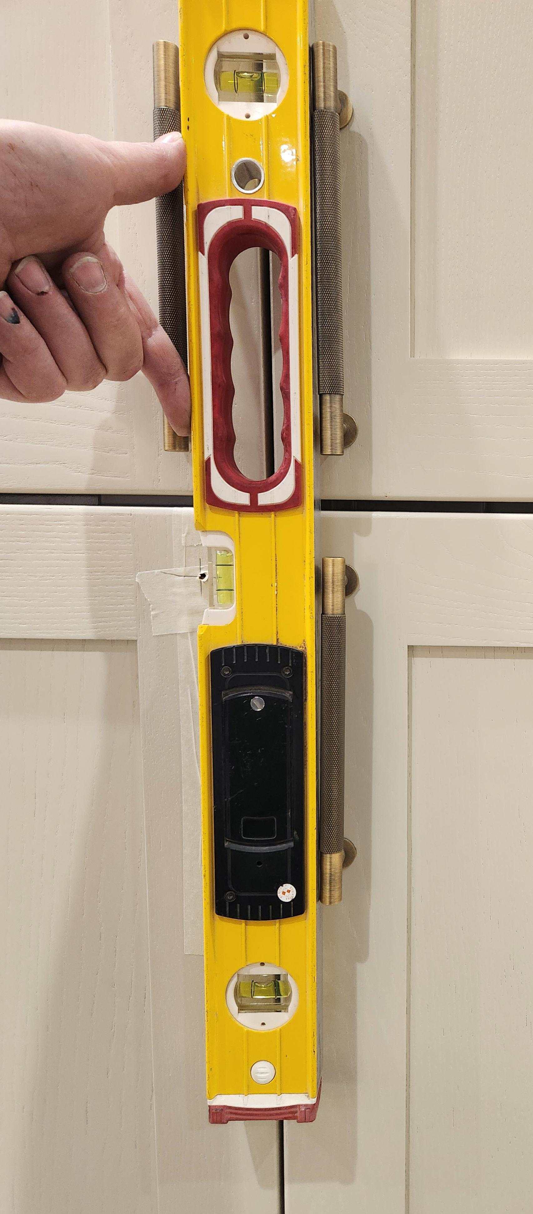

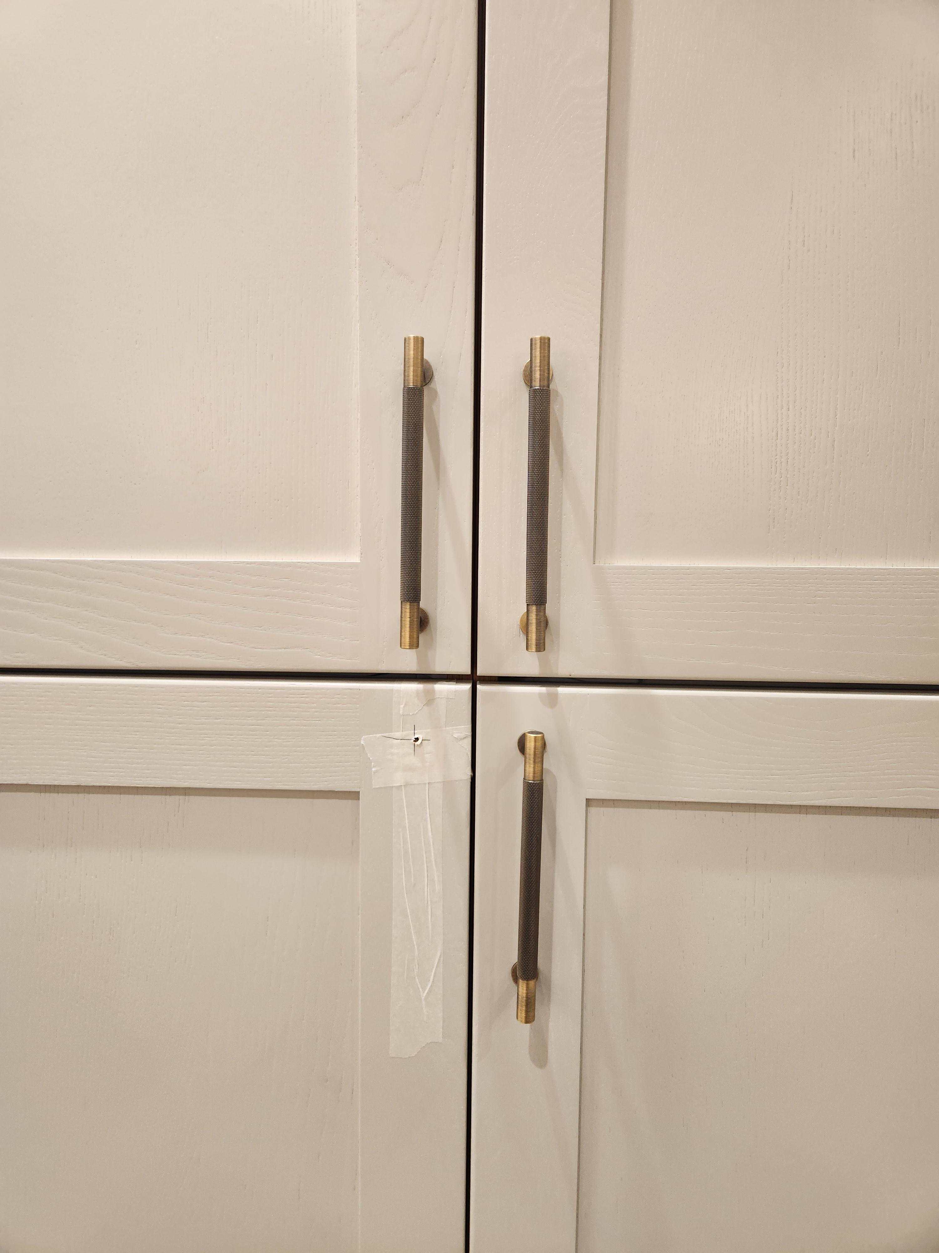

December 22, 2025Dec 22 Hi All - So in my mad rush to get everything usable for Christmas I've managed to mess up the handles on the tall cupboards. Not quite sure how I did it, but no matter it's done now. They are about 2mm out. I tried drilling a larger 5mm hole to get some play but its not enough. Before I bite the bullet and drill an even bigged hole is there any other one ways to solve this? Doors are MDF -- no idea how diy-kitchens get to sell it as solid wood when it's all chipboard and mdf, but that's another thing. Cheers, Paul
December 22, 2025Dec 22 You have a bit of luck, as the base of each handle has those larger 'feet', so I would just drill incrementally up in size until you get to where you need to be. If it's up/down, then maybe use the 5mm bit to just elongate to make a slot, vs making bigger holes, plus you may need to fit washers to the screws so they don't pull into the (real wood) of the door and then move back to where you don't want them to be from the tightening action (rotational movement of the pan head screws). Very slow and very steady wins the race, so don't do this in anger.
December 23, 2025Dec 23 If you have lots of these still to drill it is worth making up a template from ply or mdf and clamping it to the door. Forgive yourself. We have all done far worse.
December 23, 2025Dec 23 If you are handy with a drill, use same size bit to rout the hole to elongate it in direction needed, bit more fiddly than larger drill but removes less material and only in direction needed. And yes we have all done it … or worse, marked several doors and fitted handles before hanging the door …..handle on hinge edge 🤫
December 23, 2025Dec 23 @paro, I use the toothpick with wood glue trick to adjust screw holes. Here is CharlieDIY demonstrating it with matches. Edited December 23, 2025Dec 23 by Nick Laslett
December 23, 2025Dec 23 I always remember the saying of an old chippy I used to work with.. "jobs only as good as your pencil is sharp" The more precise the mark, the better the finish.
December 23, 2025Dec 23 A tip I learned for kitchen door handles, is make a jig. A simple bit of plywood with 2 bits of wood fixed to form an edge so it sits onto the corner of a door, and your handle holes drilled in that. No need to mark out individual doors, just place the jig in position and drill.
December 28, 2025Dec 28 Author Thanks all. Apologies for delay in replying. I took the eolgation route and it worked out well. I bought one of those common jigs from Amazon which seemed to work well on the smaller drawers but at some point it must have taken a knock as it was just not lining things up properly as that's how I wound up with the problem. After that I just took a slowly slowly measure 3 times approach with a pocket square. Thanks again.
