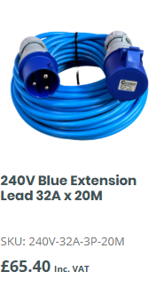

saveasteading Posted December 5, 2025 Author Posted December 5, 2025 Thanks. I didn't know HD 240 existed. I now see them advertised at all sorts of amperages if that's a word. should I be looking for one that will reach the middle of the building? what amps might be a sensible spec? I see so far 13, 16 and 32A. will these be 3 pin or the round socket sort? in the building what will we have? a single 110V transformer or a multi socket one, or as many singles as are wanted? is blue a preferred colour to indicate what the cable is? i see them in blue or black and even orange. if i am understanding. In either the garage or canteen we plug a 240V domestic type plug into a normal socket. perhaps with a conveter from domestic plug to round. We then take that cable to the barn, perhaps well above ground to avoid accidents. Blue or orange would be safer than black. in the barn it is dry now, or soon will be, so we simply have a 240V socket into which we plug a transformer. thereafter the guys just plug in what they want. Perhaps @markc 's idea too. so the 240V for most purposes but retain the trailing separate 110V to a few lights, in case of a local trip.

ProDave Posted December 5, 2025 Posted December 5, 2025 1 hour ago, saveasteading said: is it as simple as this, or 2 of these\? https://www.screwfix.com/p/masterplug-ldct2513bq-4-xd-13a-4-gang-25m-cable-reel-240v/54615 Conductor area 1.25mm No I would not buy that. My long 250V extension lead is self made using 5 core 2.5mm with 2 cores in parallel for both L and N. I doubt you will find a pre made lead with 2.5mm cable, read the small print. Buy a drum of 3 core 2.5mm flex and make your own lead to the length you want with no joins and a good quality plug and socket each end. 1
garrymartin Posted December 5, 2025 Posted December 5, 2025 59 minutes ago, saveasteading said: is it as simple as this, or 2 of these\? https://www.screwfix.com/p/masterplug-ldct2513bq-4-xd-13a-4-gang-25m-cable-reel-240v/54615 The cable used in those is listed as 1.25mm2 - you should go for something much heavier duty. Minimum 2.5mm2 considering the distance and use. 2
markc Posted December 5, 2025 Posted December 5, 2025 Just now, garrymartin said: The cable used in those is listed as 1.25mm2 - you should go for something much heavier duty. Minimum 2.5mm2 considering the distance and use. Really, the ones I picked up are 2.5mm, sorry @saveasteading I just opened the link but didn’t check details. You do need 2.5mm2 minimum on the cable at 25m long

garrymartin Posted December 5, 2025 Posted December 5, 2025 Something like this; 2.5mm2 3-core with 4 sockets https://www.amazon.co.uk/Portable-Blue-Extension-Lead-Cable/dp/B0FVZH1JQD 1

saveasteading Posted December 11, 2025 Author Posted December 11, 2025 We have bought a cable reel with 2.5mm blue cable, 25m long. It is rated at 3,100W. It is to 'Arctic' ,specification for outdoor use. It is very visibly a much heavier duty than normal cable, and the spec confirms it. We plumped for a reel rather than a loose cable as it will be e asier to move around /relocate/ remove and be less vulnerable to damage. The downside would theoretically be that it is lft prly oiled, but our guys know this and we will remind them. From what I can find, the most powerful 110V router/bench saw draws 2,100W I have also taken on board the suggestion to retain 110V supplies for the lighting. As well as spreading the load this might stay on if the other circuit trips. It cost about £70. The one shown in earlier discussion seemed cheap but doubled when the checkout page added 'delivery'. Also I trusted the specialist supplier more than the other options through Amazon etc. Thanks for the advice. 1
