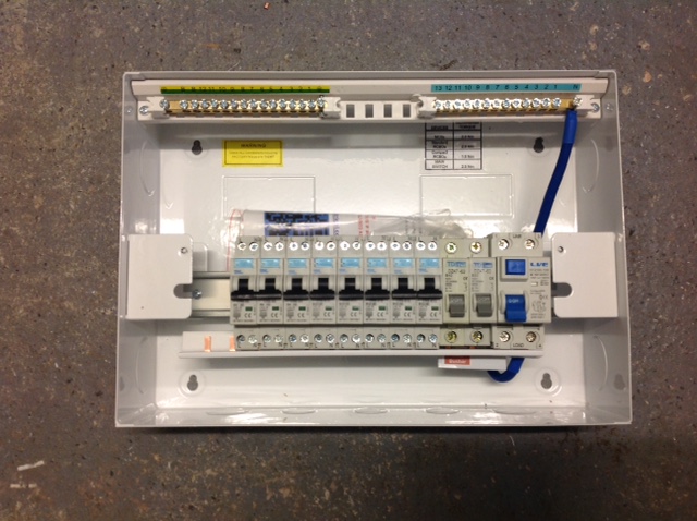

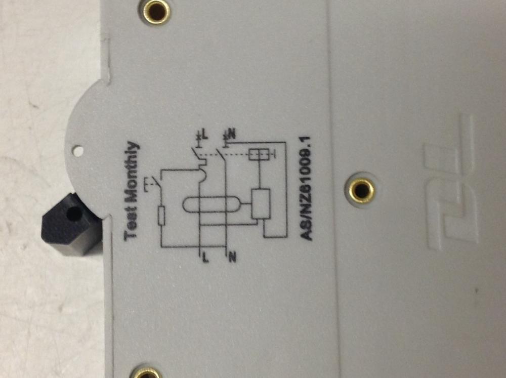

Onoff Posted January 18, 2018 Author Share Posted January 18, 2018 Schematic on a typical SBS Compact RCBO: This from Dave at SBS: "The GARO is a true 2-pole device, but its biggest size is 25A. Probably couldn't achieve 6KA at bigger sizes. Couldn't therefore deal with 32A rings or 40A showers. It is LIVE IN at the bottom only, which shouldn't be a problem in the UK." Link to comment Share on other sites More sharing options...

ProDave Posted January 19, 2018 Share Posted January 19, 2018 That's about spot on @recoveringacademic All I would add is the type that SBS sells, with a dual busbar is better as you don't have the flying neutral lead from each rcbo to terminate. Point your sparky to SBS so he can see for himself. Having said that my board is all Hager rcbo's with the flying lead. Link to comment Share on other sites More sharing options...
ToughButterCup Posted January 19, 2018 Share Posted January 19, 2018 2 hours ago, ProDave said: [...] All I would add is the type that SBS sells, with a dual busbar is better as you don't have the flying neutral lead from each rcbo to terminate. Point your sparky to SBS so he can see for himself. [...] Thats interesting.... The second busbar obviates the need for the flying neutral, then? (excuse the possibly stupid question) Ian Link to comment Share on other sites More sharing options...
Jeremy Harris Posted January 19, 2018 Share Posted January 19, 2018 5 minutes ago, recoveringacademic said: Thats interesting.... The second busbar obviates the need for the flying neutral, then? (excuse the possibly stupid question) Ian Yes, and makes for a MUCH tidier CU, with more room to lay things out neatly. All those flying leads always end up making the box cluttered and a PITA to work on, IMHO. Link to comment Share on other sites More sharing options...

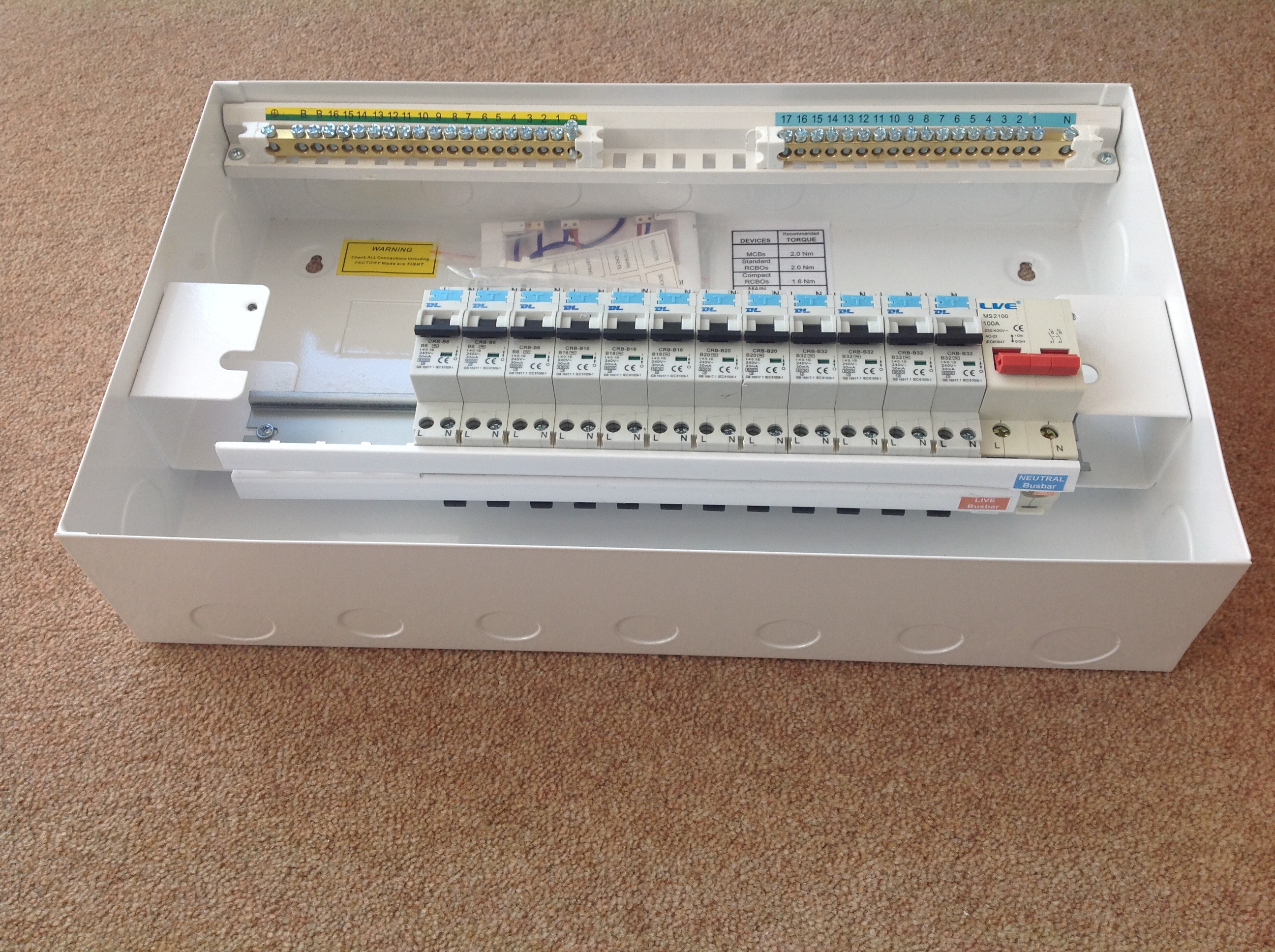

Onoff Posted January 19, 2018 Author Share Posted January 19, 2018 23 hours ago, JSHarris said: Thanks for that, so you could "mix and match" DP RCBOs for the lower loads, with a few bigger SP ones for the higher loads? That neatly gets around the problem for things like electric water heaters that need a higher rated one. Yes. The picture below from SBS shows a line of Compact RCBOs on the left then two MCBs before the main switch. Subsitute full height RCBOs for the breakers: The busbar along the bottom is in fact two, one for L and one for N insulated from each other. They pick up from the main switch. Only the Compacts are fed like this. The full height RCBO's (or mcbs in this case) are fed conventionally. Link to comment Share on other sites More sharing options...
SBS Dave Posted January 20, 2018 Share Posted January 20, 2018 Thanks OnOff for your support. The photo shows the double busbar setup. Note, in the previous photo, I also fitted a 100A/100mA TD RCD in place of a Main Switch, as specified by my customer. SBS Dave 1 1 Link to comment Share on other sites More sharing options...

SBS Dave Posted January 20, 2018 Share Posted January 20, 2018 As I recall, the customer was supplying 2 outbuildings via the 2 x MCBs. The outbuildings each had an RCBO board. The TD RCD provided protection for the feed cables to the boards, whilst providing discrimination between the TD RCD and the series connected RCBOs in the boards. Thanks for the welcome OnOff and I will be happy to answer any questions the Forum may have. I am not here to promote my Company or its products, as I am sure the Moderators would take a dim view of that. If anybody wants more information, please PM me. Link to comment Share on other sites More sharing options...

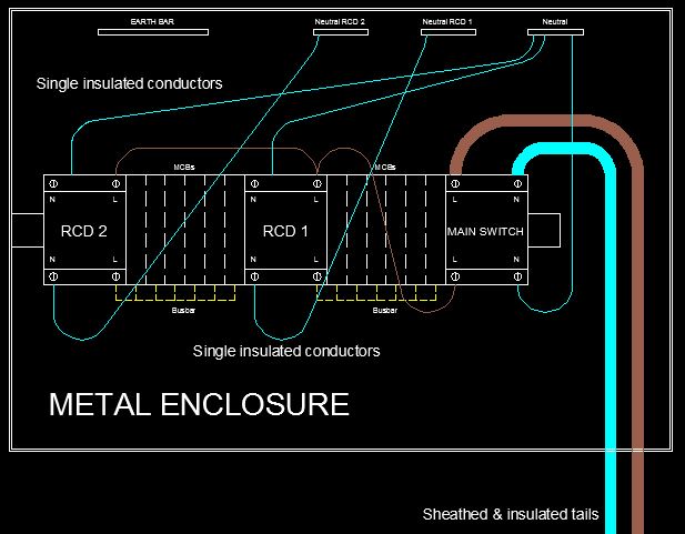

Onoff Posted January 20, 2018 Author Share Posted January 20, 2018 (edited) Ah! I didn't realise the board was feeding sub mains. I thought it was an overkill seeing as you are using Compacts hence no fly leads! For others here thinking wtf, consider a metal cu on a TT system. The earthing arrangement is likely nowhere near as good as with TN systems. The incoming meter tails are stranded copper cores that are sheathed and insulated, in effect double insulated but it's actually wrong to call them that even though the sheath is insulating! They will come in through a plastic gland. Quick CAD sketch (in lieu of my earlier fag packet sketch - felt the thread deserved better): You have in the cu for want of a better word "fly leads" from the main switch to the individual RCDs in the case of a split load board. These fly leads are single insulated. They're also pretty flexible by construction. Add to that the modern move away from two screw terminations in main switches to one bfo screw (bad move imo). That's a big bone of contention on the basis it's easy for it to loosen. NEVER, EVER think that these screws are factory tightened properly, always check. So with potentially dodgy single screws and springy, single insulated, flexible conductors, if one comes adrift it could easily touch the metal enclosure...and that's BAD! Wasn't a huge issue before when a TT enclosure had to be made from "plastic". So the way round this, in a TT is to fit an upfront TD RCD in place of the normal DP main switch. Wire comes adrift, touches the case, TD RCD trips. The 100mA rating is there to give fault protection for the single insulated cables that feed the 30mA RCDs. If you put a normal, no time delay 100mA RCD in front of the line of 30mA RCDs it doesn't guarantee it won't trip first hence the time delay element. Only a TD 100mA provides proper discrimination. There's a lot of confusion over time delay but think of it like this: A fault occurs on an outgoing circuit in excess of 100mA you would think that it should trip the 30mA RCD first if that's before a 100mA RCD. But normal BS EN RCDs (& RCBOs) only have to trip within 300ms. The issue is that the 100mA RCD if non time delay may react quicker than the 30mA RCD. Making the 100mA RCD time delay gives the 30mA a chance to trip first. Hope that makes sense. If you look at the SBS Compact assembly the bus bars take the place of the single insulated fly leads. They're affixed at multiple points and can't really come undone and spring against the enclosure. Edited January 20, 2018 by Onoff Added: "touches the case" + added CAD sketch Link to comment Share on other sites More sharing options...
