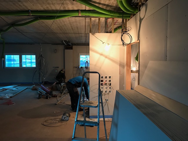

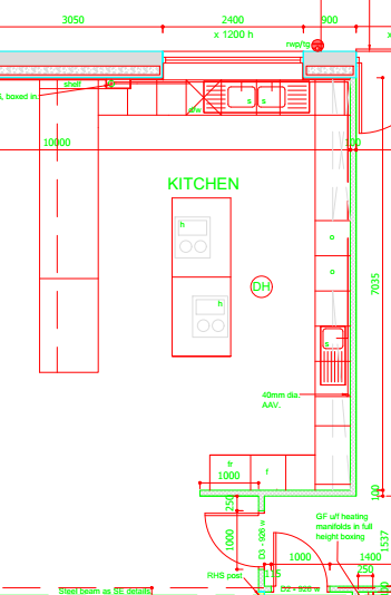

I originally planned all the isolators near the devices, meaning 13/14 DP isolators around the kitchen:
  • 4 x Oven
  • 2 x Hob
  • 2 x Extractor
  • 2 x Boiling Taps
  • Fridge
  • Freezer
  • Dishwasher (scope for second slimline)
Representation of the kitchen below.
In the end I decided to put them all on one wall behind the hall door so out of the way but accessible:
Picture below shows the bank of isolators (first fit), including Fire Alarm test point and a double socket below:
These all run to unswitched outlets/connector plates for 3 of the ovens and hobs.
Planning is everything, but either way that is an amateur job at best and not worthy of a "professional".
