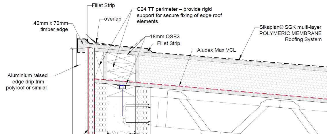

We're in the process of detailing our whole house roof with a Sika single-ply membrane. We'd like a nice kerb-edge trim (ideally Zinc/Alu), but how would this be detailed if fitted after the membrane? Is this a normal thing to do? I've not approached an installer yet, maybe they'll know the answer, but asking you good chaps!
If anyone has done similar, pics would be welcome.

I guess the drip edge could be turned back up on the inside and fixed to the underneath of the 40x70 timber, they're used to that detail with Zinc roofing if I was to get trims done by a Zinc installer. But how to seal it to the Single-Ply on top? Architect seems to show another membrane.

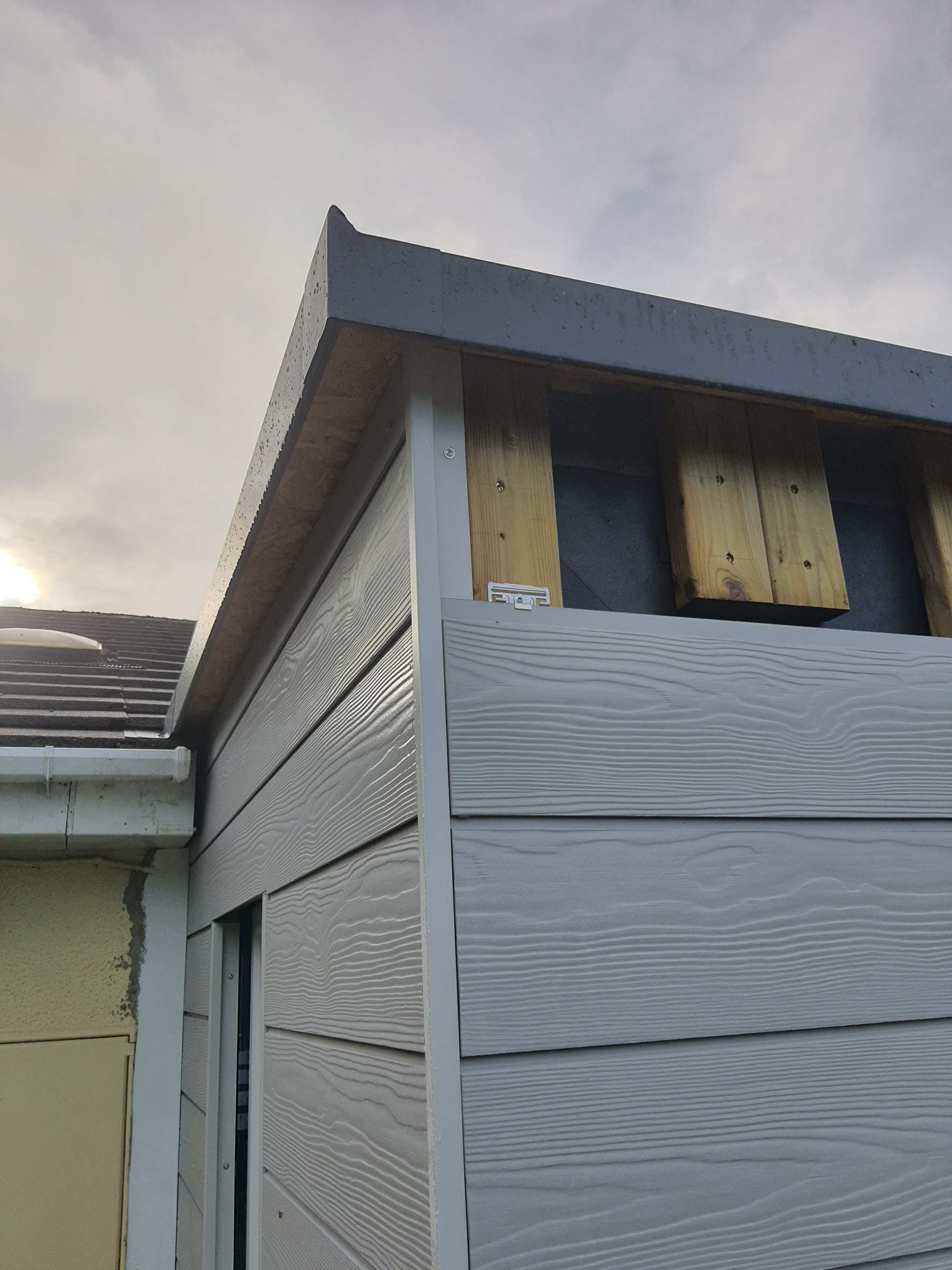

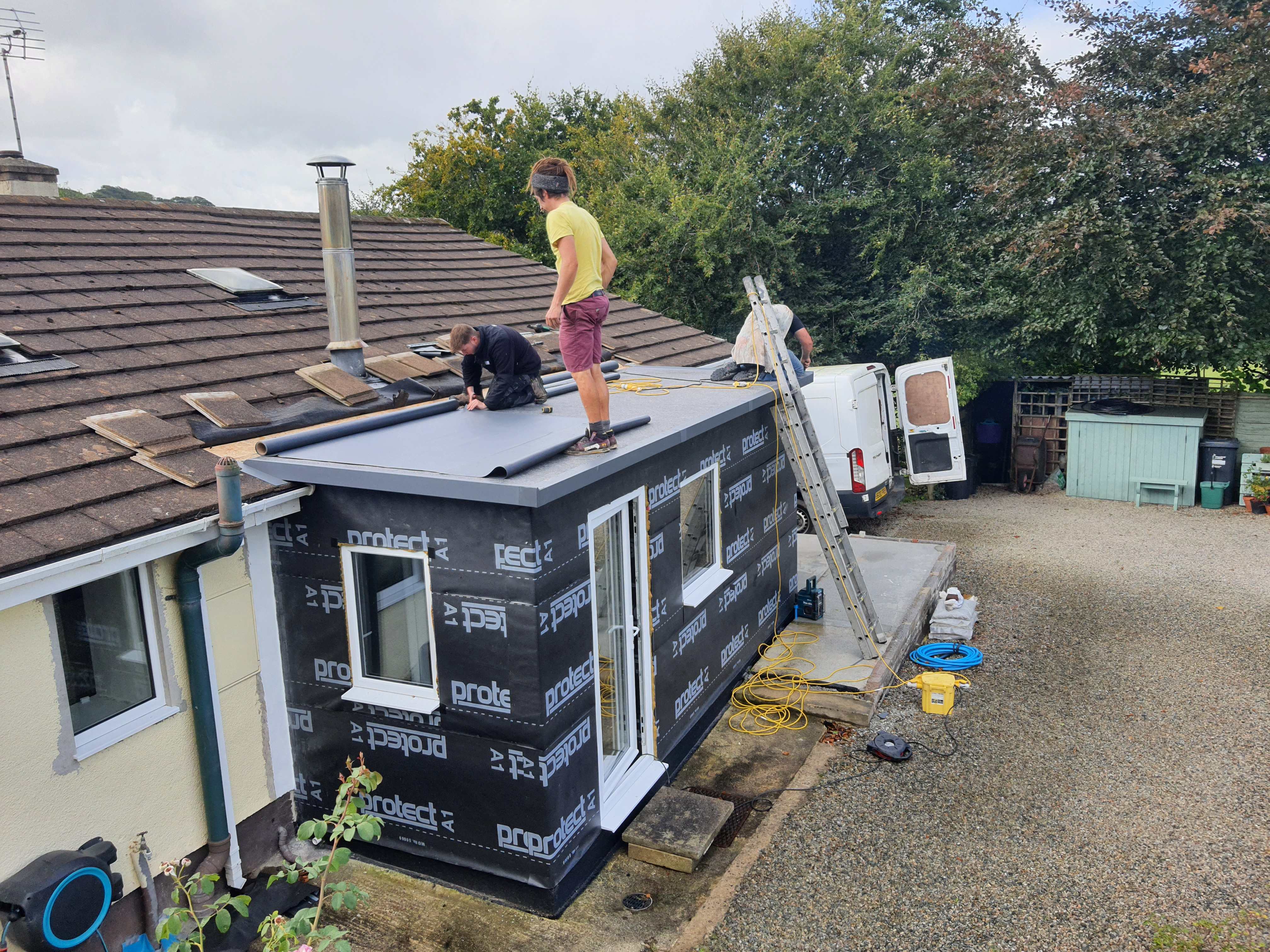

Posted
We had a Sika single-ply membrane installed on a small extension a couple of months ago. The edge trim upstand is a steel profile covered with a membrane. The profiles were fitted first, then the underlay and then the roof membrane was welded to the profile. The edge of the roof was just a double layer of 18mm OSB.
  • Like 1
Posted
Thanks for this. Helpful. So the steel profile is seen from the ground I assume? Don't suppose you took any pics of it in progress?

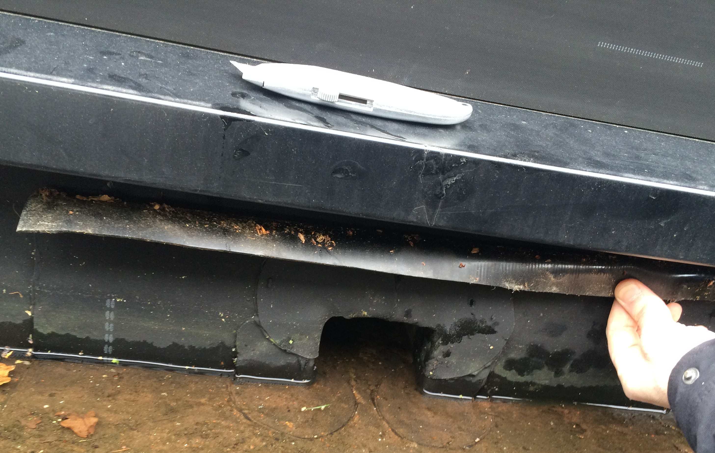

Posted
10 hours ago, Gone West said:
These are the best I've got, sorry.
Shouldn't be an issue if they have welded it correctly but that up-stand should be on top of the base layer.
  • Like 2
Posted
IIRC the upstand is on top of the underlay.
Posted
8 hours ago, makie said:
The bottom picture, it is not.
I don't understand. The underlay used is a material that looks like a dark green nylon pot scourer and isn't visible in the last picture 😕.

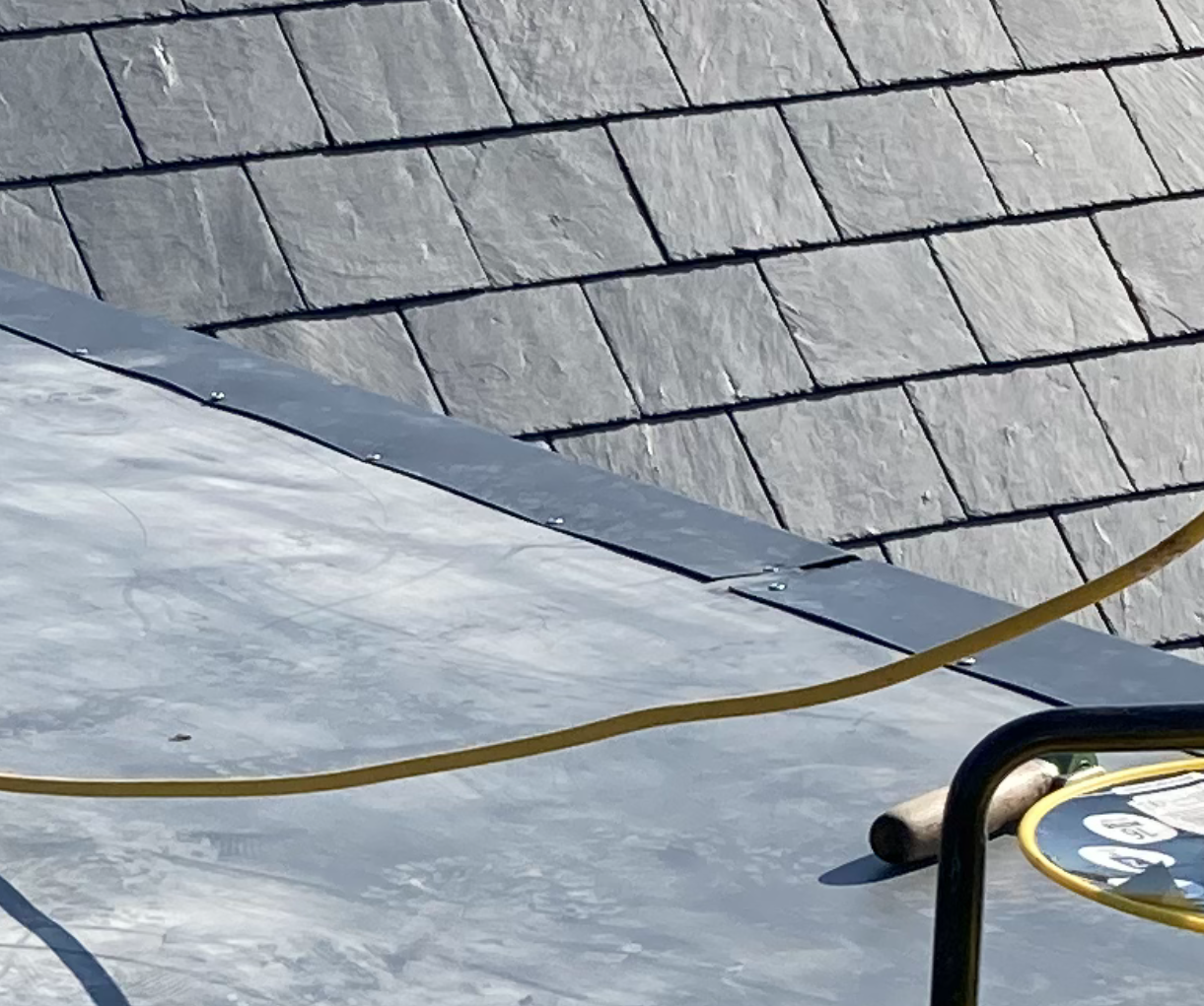

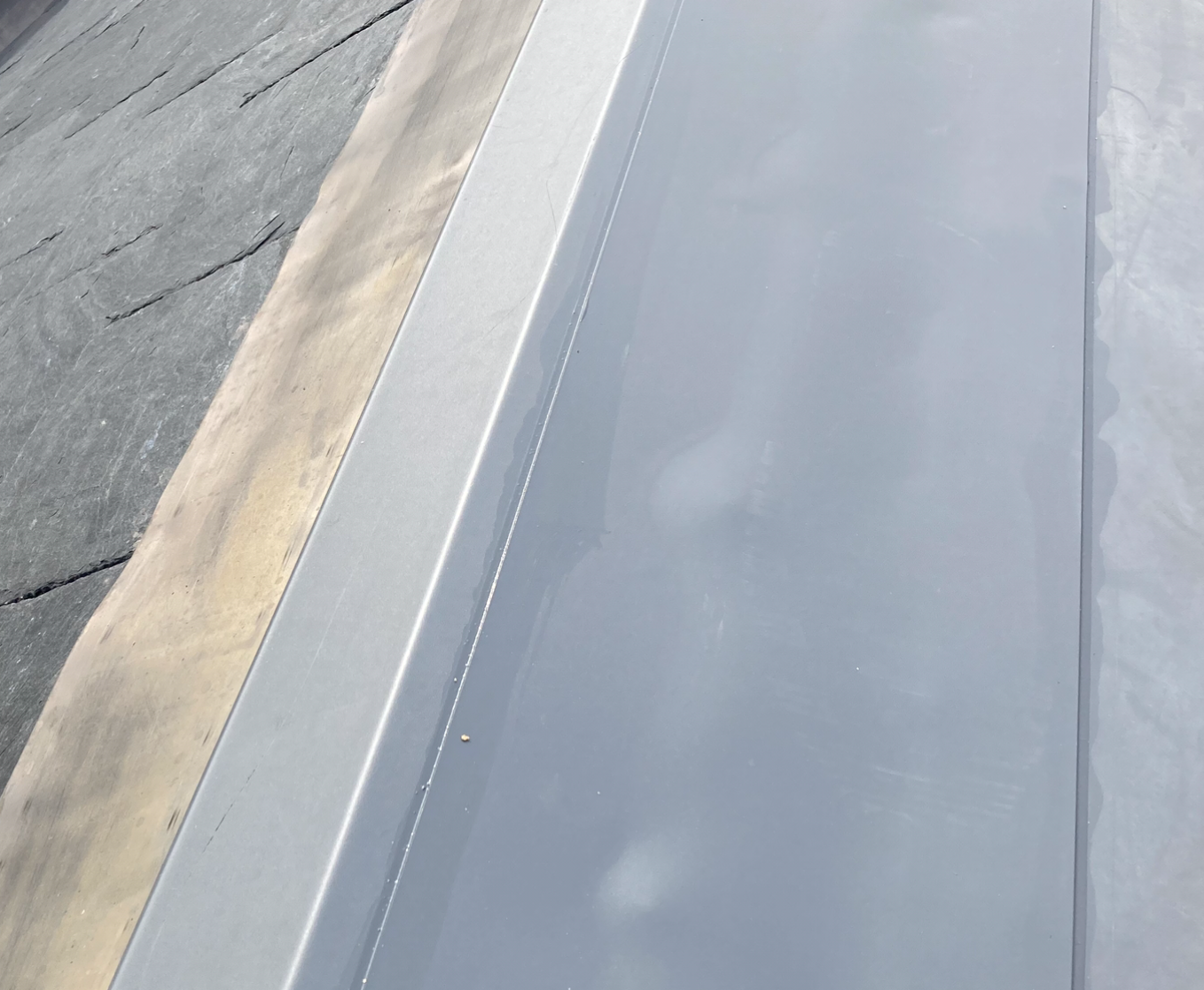

@Mulberry View, not the exact same finish requirements, but here are some pictures of how they did our flat roof. Aluminium trims are fitted at the same time as the Sika membrane.
The bespoke Aluminium Trim appears to be riveted to the Sika membrane.
Then another strip of membrane is glued over the top. Hard to tell, but from left to right it goes: slate tile, lead, aluminium, membrane strip, membrane.
For your detail, you would have a bespoke piece of aluminium to cover the curb.

Posted
That's interesting, our trims were steel and were screwed down and the membrane was welded to the trim.
Posted
I actually think the ones in my picture and link are galvanised steel.
Looking at our flashing schedule they called it “Trocal Metal”
https://grc.sika.com/dam/dms/gr01/3/010945011000000001_Sika_Trocal_Metal_Sheet_Type_S_eng.pdf
I’m not sure why I thought they were aluminium. So ours are galvanised steel too.

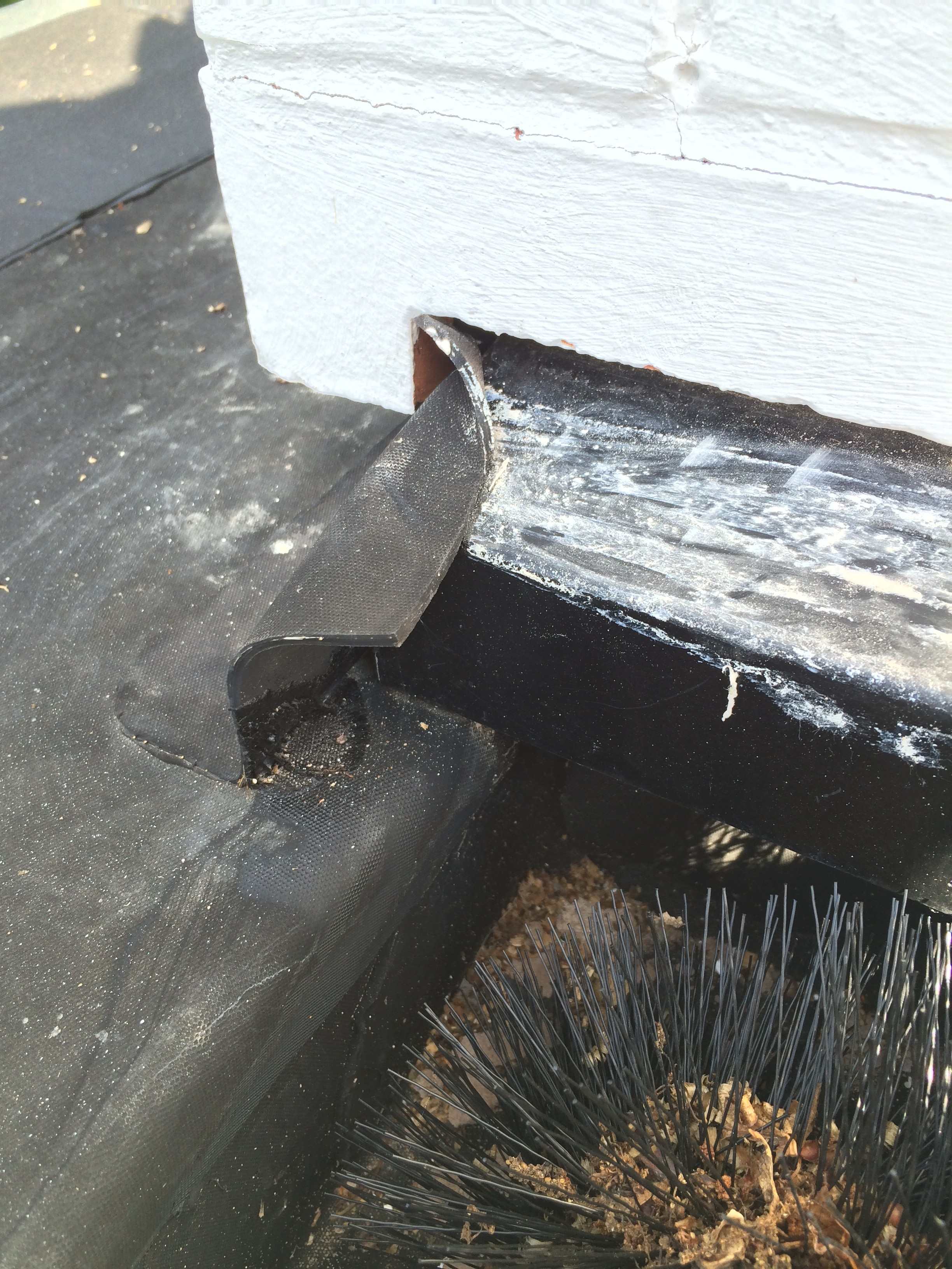

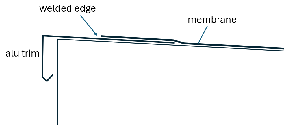

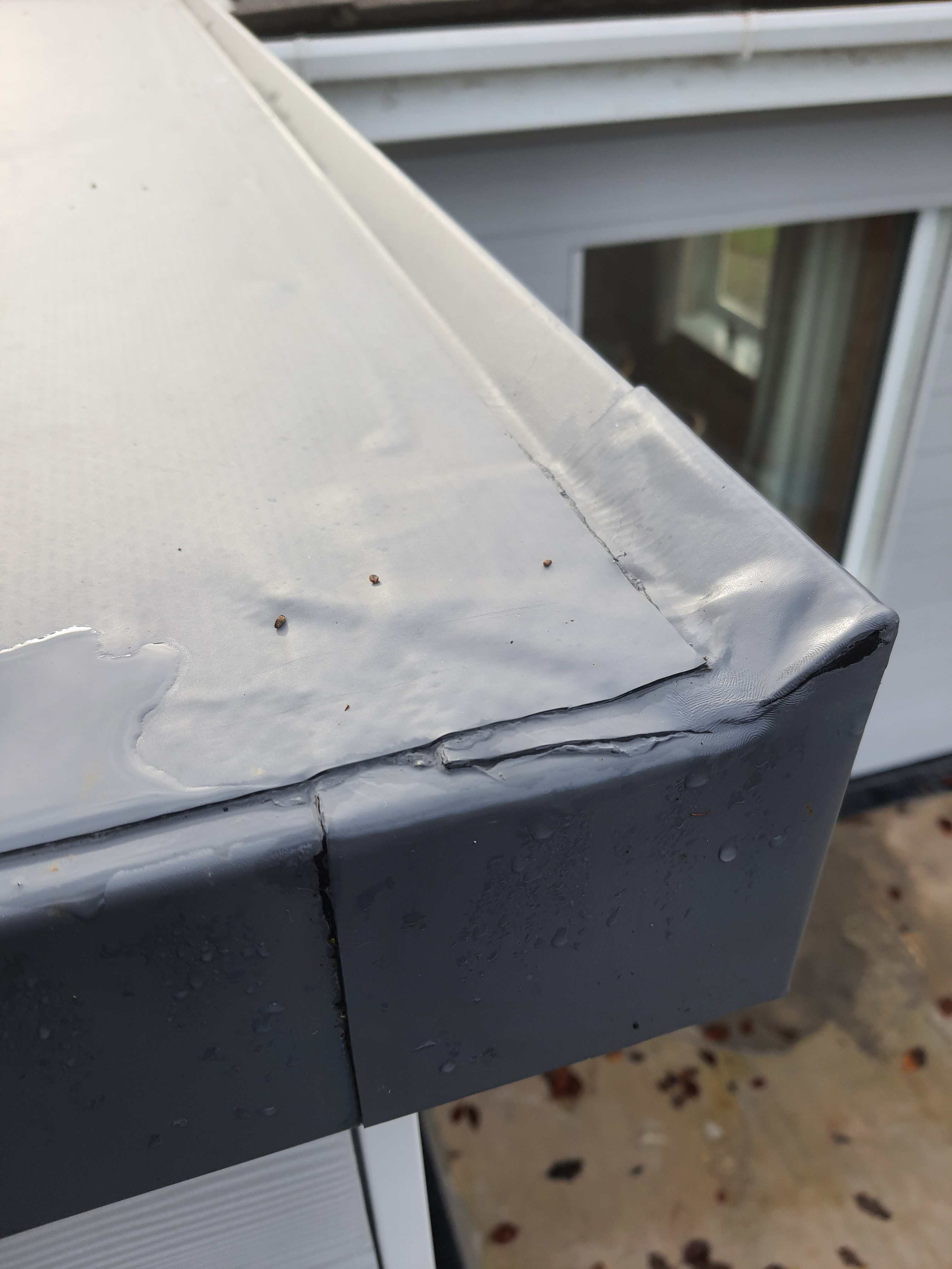

Posted
I don't like the idea of welding a membrane onto a trim where the slope is away from the trim towards the membrane.
We have a Resitrix membrane and I've been really unhappy with how it was done. The detail over the outside edge of our parapet wall looks like this:
It's theoretically fine as long as the welds (they're modified bitumen based) hold.
The problem is that the trims are aluminium, so there are joins at least every 3 metres. As the trims expand and contract with temperature, the welds near the joints are put under quite a bit of lateral stress. In our case, many of them have failed for a couple of inches either side of the joins. I don't doubt that water getting into the space and freezing makes it worse over time.
Also, water tends to pool along the welded edge due to the direction of the slope, making it very easy for water to get into the failed joins. It would've mattered a lot less of the weld had failed but the slope were in the other direction.
In summary, if I'd known then what I know now, there's no way I would have accepted this design. Assume that welds, joins, glue, etc. will always fail over time. The design needs to be such that, if that happens, water is still largely shed in the correct direction without having a route into the structure through the failed join.
  • Like 1
  • Sad 1
Posted
Why was the trim not put on top of the membrane?
Posted
I assume it's because the installer was incompetent. Unfortunately, I didn't realise how bad a job they were doing until it was too late.

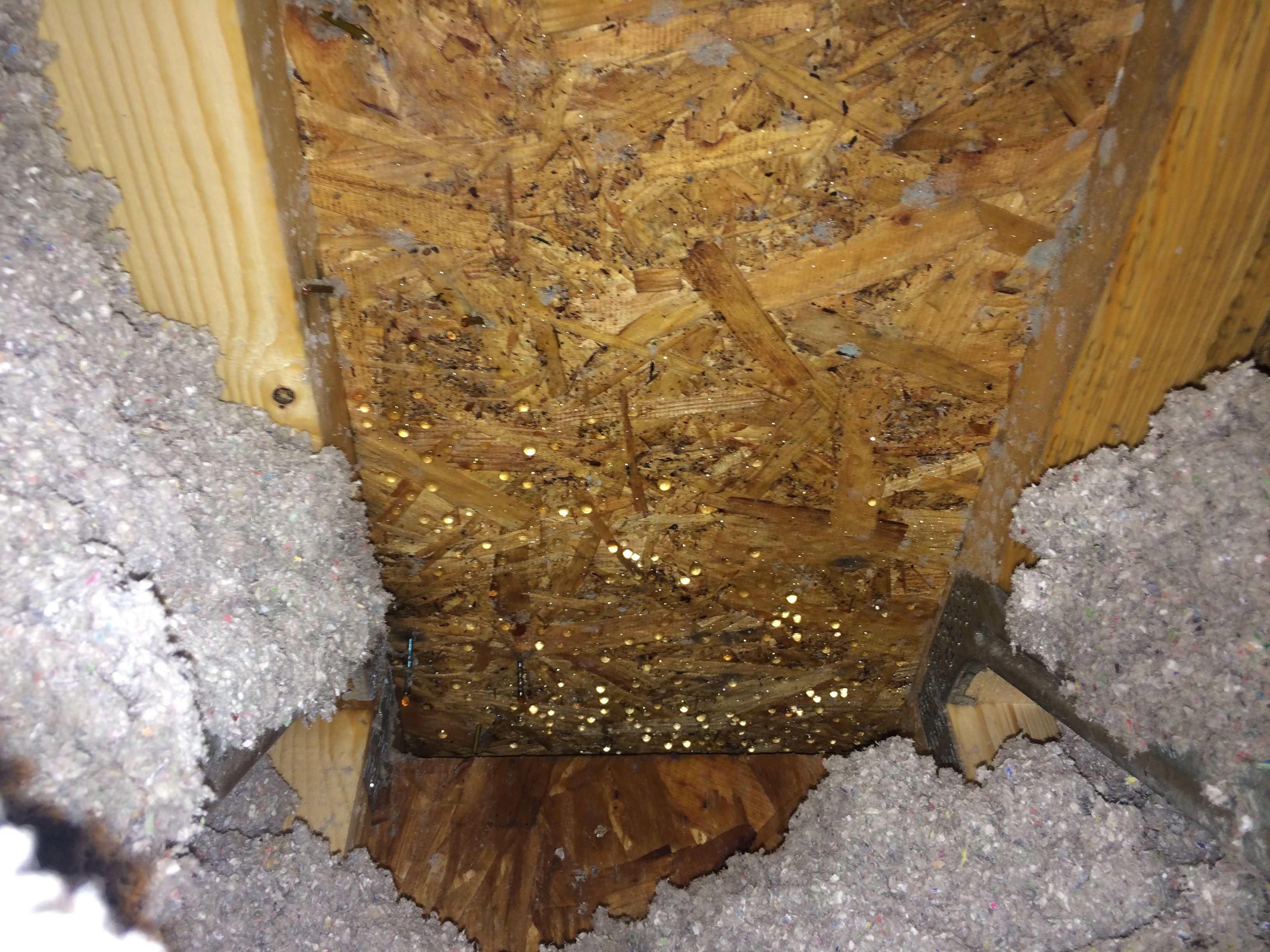

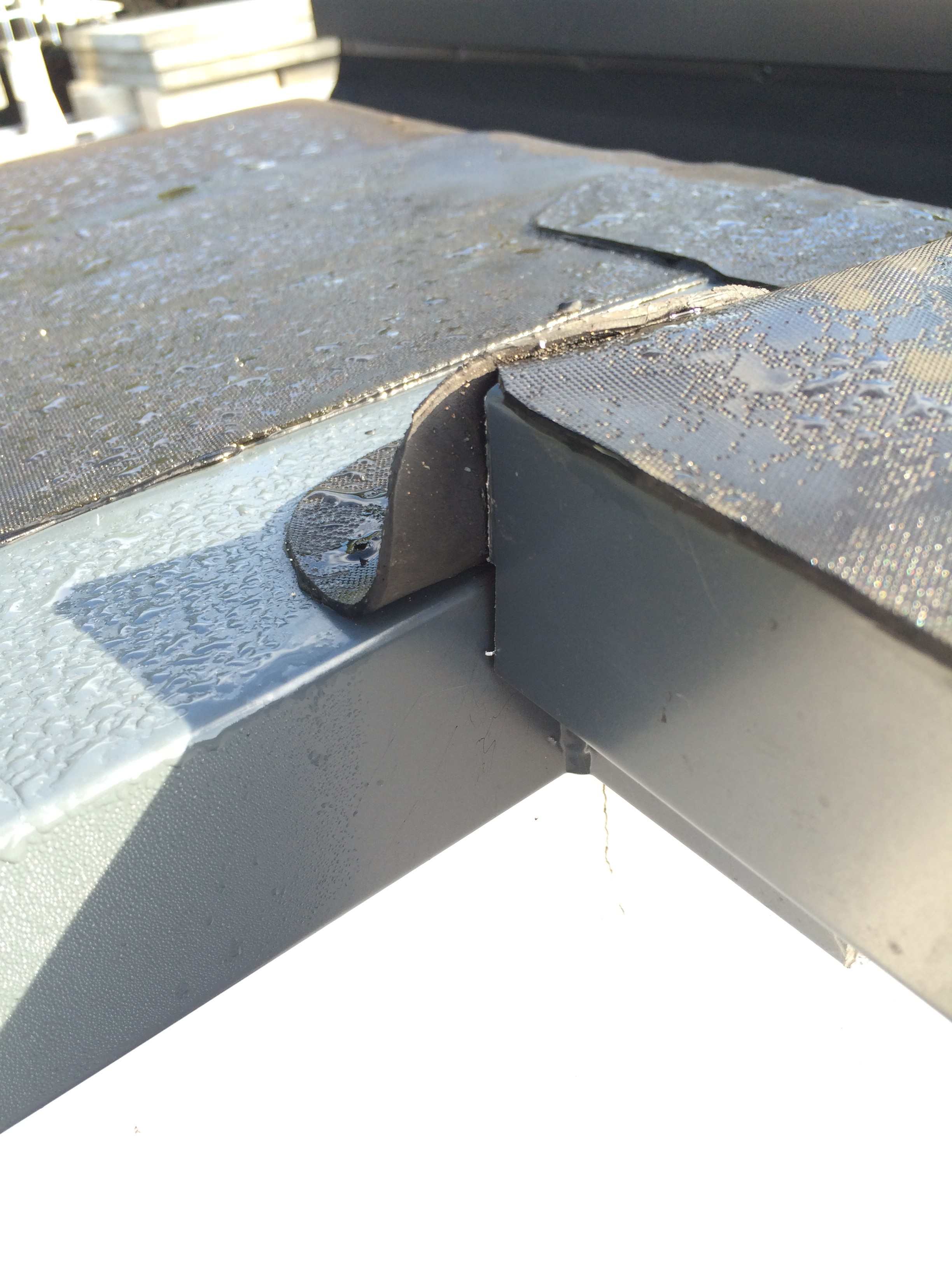

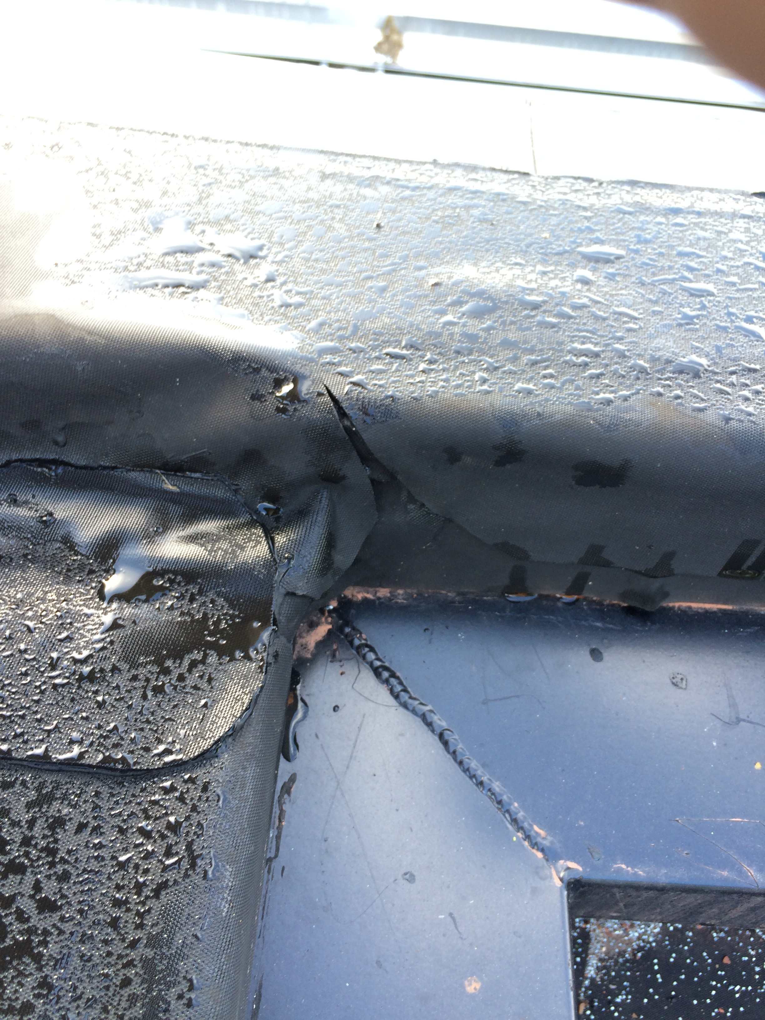

I've previously documented some of the issues we had with them, particularly the multiple serious leaks we had within a month of moving in. This was the worst leak:

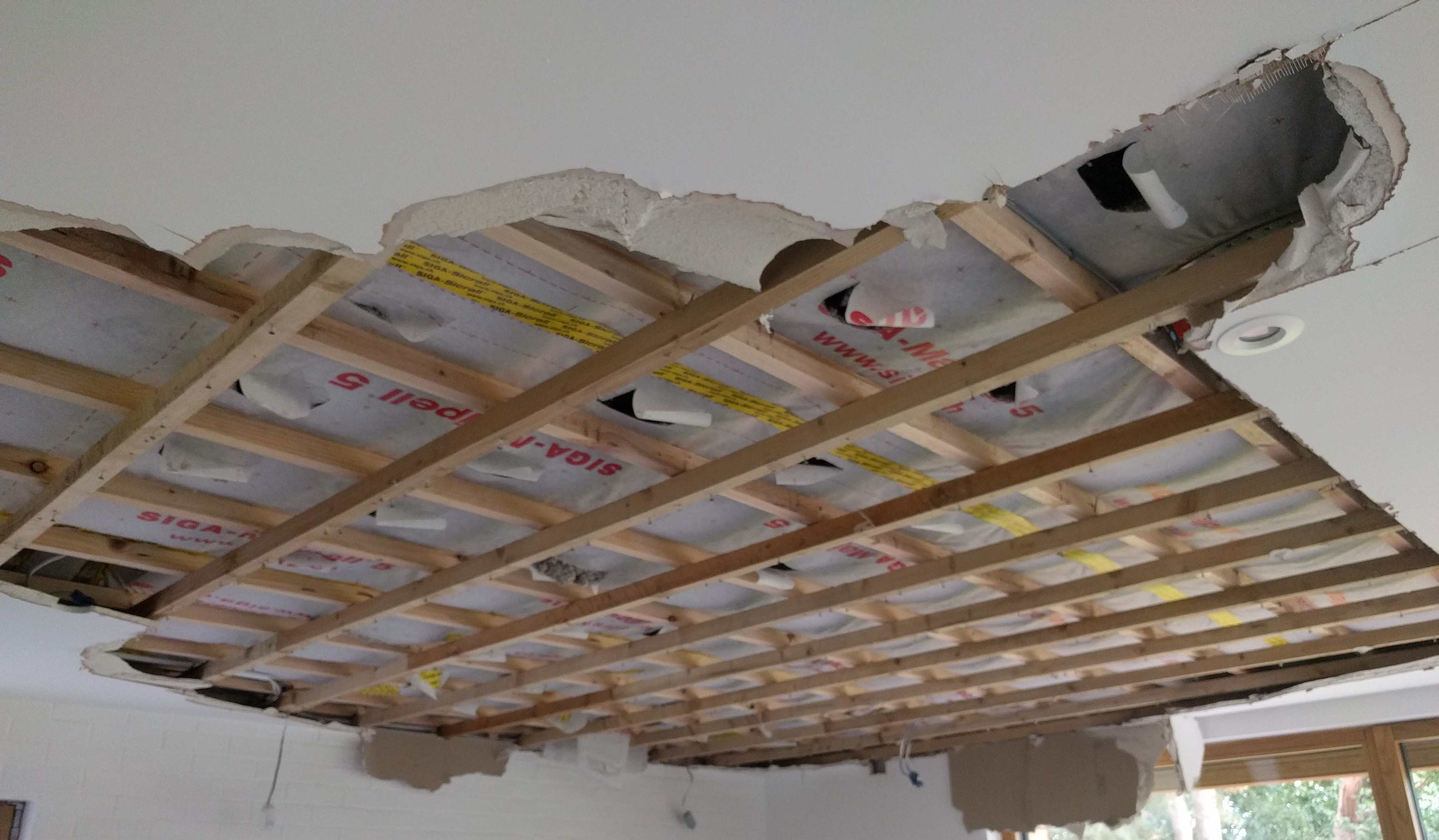

And the extent of the damage arising out of that particular leak:
There were plenty of other problems along the way:
This is just a small subset.
I got them back a couple of times to fix the worst of the issues, but it's still a dog's breakfast.
We were so worried about the installation that we demanded the Resitrix rep come out and inspect it, particularly in the areas that ended up being the source of the leaks a few months later. Disappointingly, the rep wrote a report saying that all work was of the "usual high standard" (or words to that effect) expected of their authorised installers.
It's a shame, because the Resitrix product itself is clearly very high quality.
Posted
@jack I agree with you. That looks like a right mess. I have no training, but i have done a few EPDM roofs.  Some quite complicated. The oldest must be about 12 years old now. I have never had a leak.
