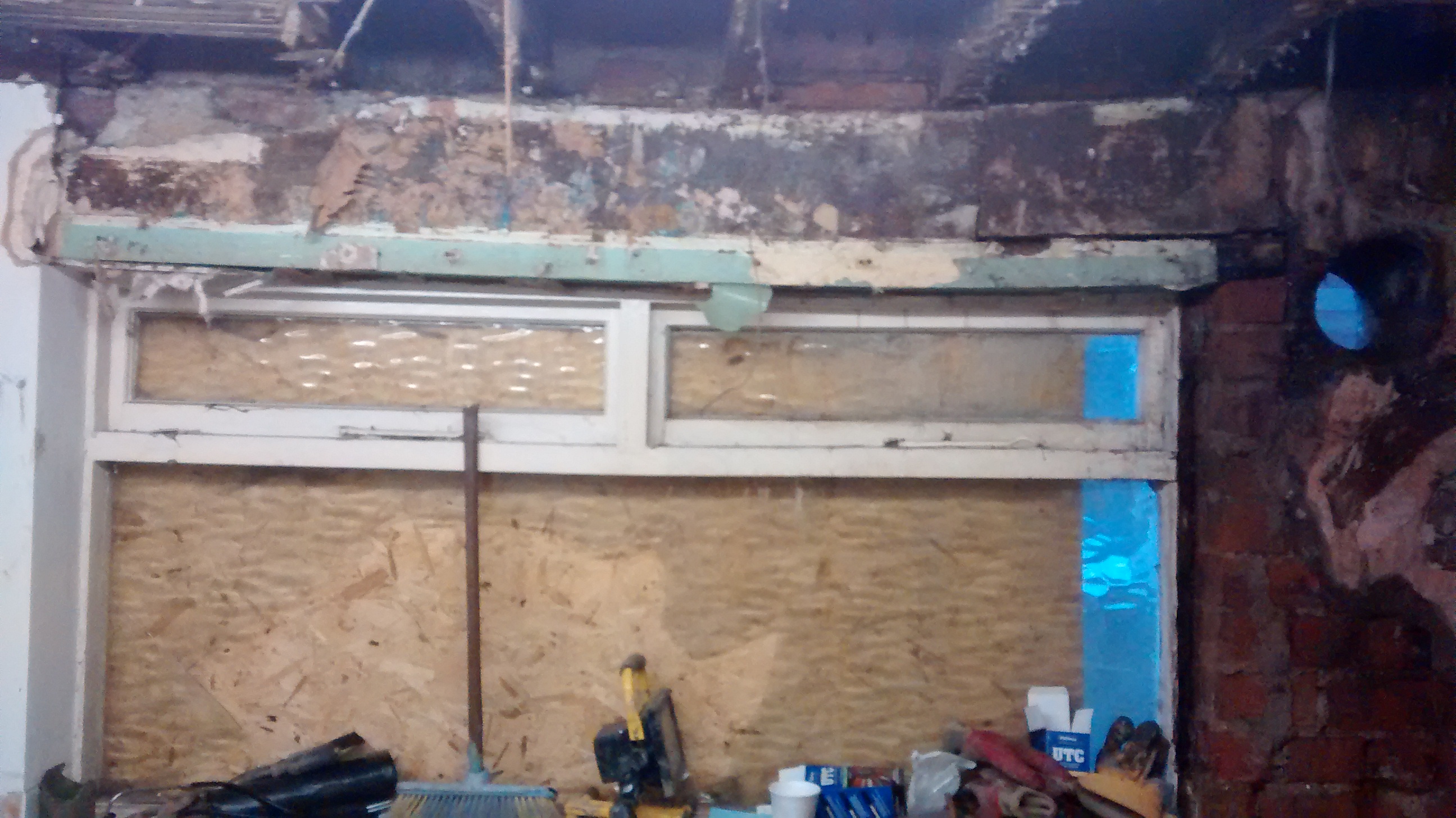

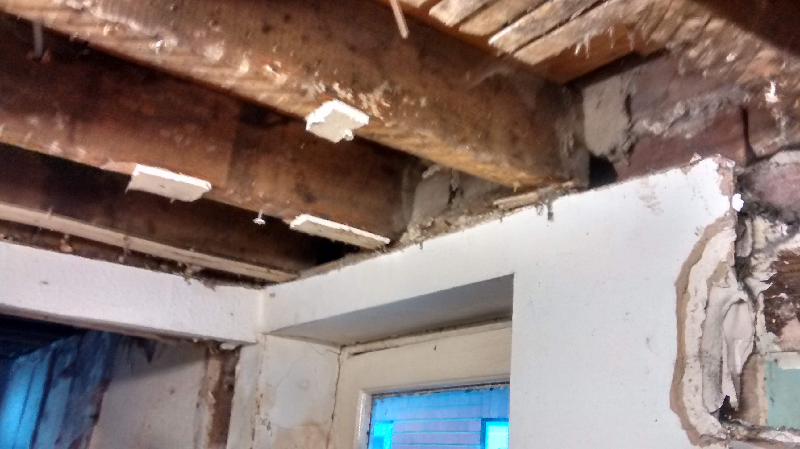

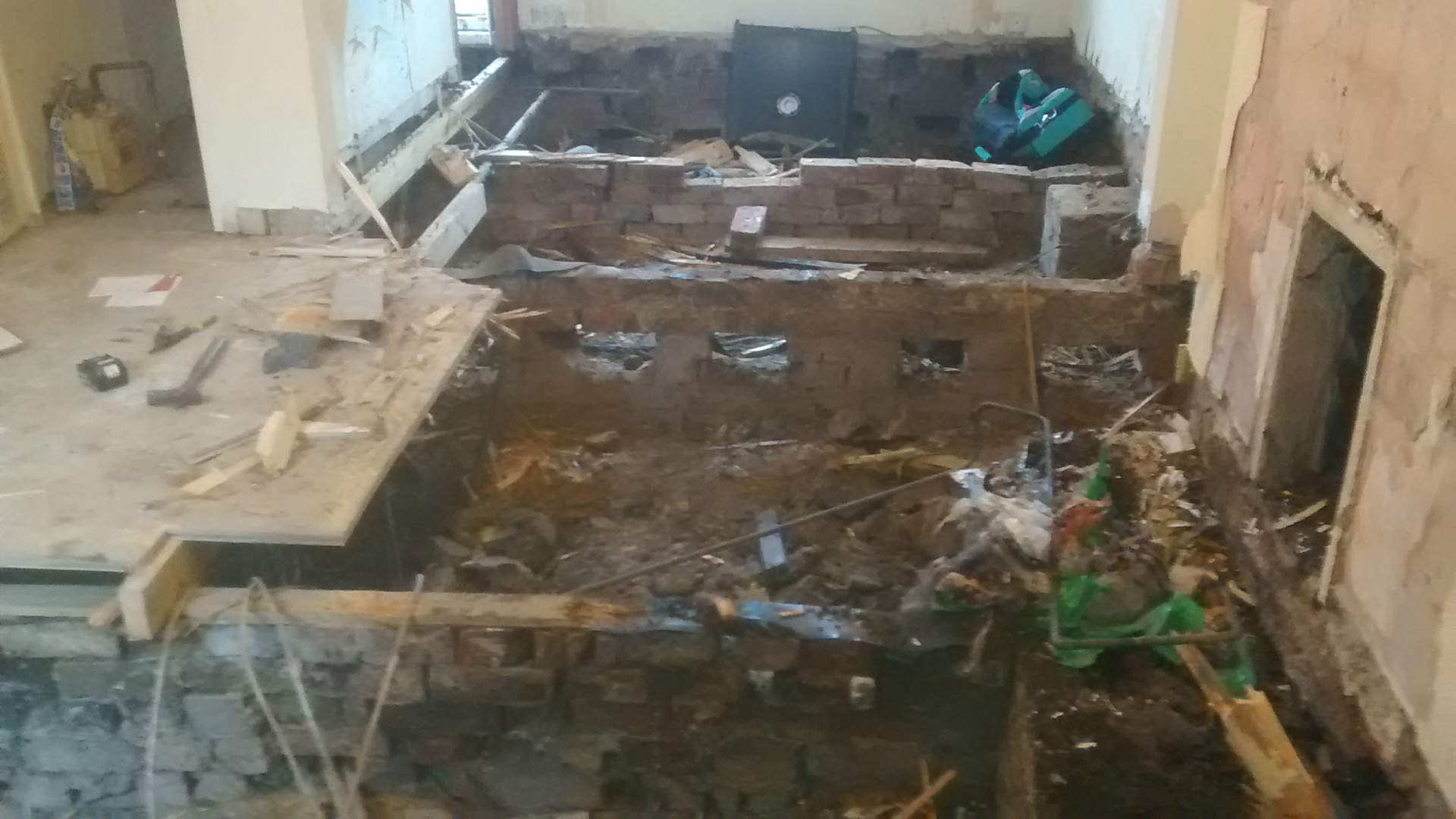

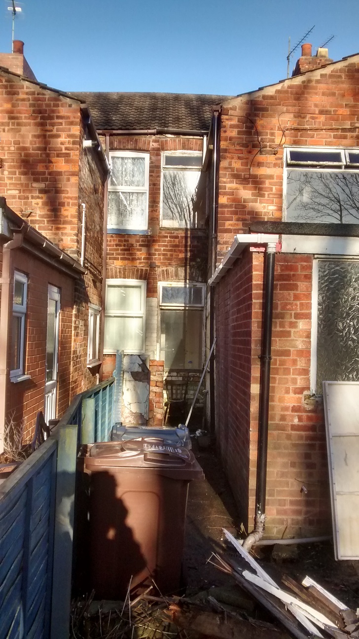

legepe Posted January 15, 2018 Posted January 15, 2018 Hi all, Ive completely ripped up all the wooden floor in an old terraced house which was badly affected with dry rot, and would like to replace it with a concrete floor. The house is in a real sorry state in general.. brickwork with cracks above window sorting out, lintel installed, some of the walls need to be taken back to brick before boarding/replastering, some of the plaster has just fallen off. tree growing through wall into ceiling void, exterior wall at back of house out of plumb around 2.5" requiring floor joists to be extended to support upper floor properly... etc, etc... ive attached some of pics to show general condition. If I make an application to building control for the concrete floor installation.. will they then give me a problem and ask me why I have not made full application for the rest of the works that need to be done.. and will they insist I do all the other things in the house to current building regs... ie insulate all exterior walls either inside or out? etc... or because this in only a renovation and not a new build Im i worrying too much..!? Any advice very welcome Thanks lepend
Nickfromwales Posted January 15, 2018 Posted January 15, 2018 Hi, and welcome to Buildhub. Ok, that's a chunk of work that needs doing there. You'll definitely need a building control application, a domestic one, and a quick call to your local council will give you the fees. That'll give you the specifications you need to be working To for the floor insulation, lintels etc and also if your doing electrical work that'll need an relevant certificate too. Is this a renovation or a house for yourself to live in for a while?

Nickfromwales Posted January 15, 2018 Posted January 15, 2018 11 minutes ago, legepe said: I know it all makes sense what you have already advised on... Still waiting on call back from bso.. Ill let you know what he says... Ok, we'll stop beating you up now For some other info, don't go filling that floor up with heavy and costly to handle hardcore. Instead buy as much damaged eps ( jablite ) as you can and make the floor up with that, stopping 150mm shy of the required finished slab level. Then go for concrete with steel reinforcing mesh and it'll be job done. You could even have Ufh at that stage but rads are so much easier and more widely expected in such a property.
legepe Posted January 15, 2018 Author Posted January 15, 2018 2 minutes ago, Nickfromwales said: Ok, we'll stop beating you up now For some other info, don't go filling that floor up with heavy and costly to handle hardcore. Instead buy as much damaged eps ( jablite ) as you can and make the floor up with that, stopping 150mm shy of the required finished slab level. Then go for concrete with steel reinforcing mesh and it'll be job done. You could even have Ufh at that stage but rads are so much easier and more widely expected in such a property. wow... reinforced concrete.. is that not a little ott.. I was contemplating not even putting concrete if I could get away with it.. I was informed that 50cm of hardcore properly compacted would never move..
billt Posted January 15, 2018 Posted January 15, 2018 34 minutes ago, Nickfromwales said: Also remember that failure to inform and apply for building control is a jailable offence iirc. You don't recall correctly. There are various actions that a LA may take in a breach of Building regs, jailing someone is not one of them. The local authority may take enforcement action under Section 36 of the Building Act 1984, which is the most common action taken. Building Control may serve a "section 36 notice" requiring rectification of works which do not comply with building regulations within 28 days. If the building owner does not comply, Building Control can carry out the works themselves and recover the cost from the owner of the property. The section 36 notice must be served within 12 months of the breach. In addition, or instead of serving a section 36 notice, Building Control can also apply for an injunction to require work to cease or to compel the building owner to undertake specified works to rectify a breach. Because the costs associated with the application process are so high, injunctions tend to be reserved only for the most serious or extreme breaches, for example where a building is dangerous to occupants or neighbours. An injunction can be sought at any time after the carrying out of the works if they are deemed to be dangerous. A minor breach is highly unlikely to result in action by the LA, it's to expensive and time consuming to be worth pursuing. Which is not to recommend proceeding with substantial works without getting the right bits of bureaucratic paperwork. Not having it is likely to lead to further bureaucratic problems in the future, for instance, when you try to sell the property. 1
Nickfromwales Posted January 15, 2018 Posted January 15, 2018 12 minutes ago, legepe said: wow... reinforced concrete.. is that not a little ott.. I was contemplating not even putting concrete if I could get away with it.. I was informed that 50cm of hardcore properly compacted would never move.. It also wouldn't insulate anywhere near as well How much would it cost to get that lot bought, delivered, manhandled into place and compacted ( in layers ) then topped with screed ? Add all that up and have a chew over the numbers. .

Oz07 Posted January 15, 2018 Posted January 15, 2018 Meanwhile in the real world he's banged 100m stone in, 2 layers, 100mm pir in, dpm above and below 100mm concrete in maybe even self compacting for ease of use and flow and job done. Loads better than what was there before from thermal and durability point of view. Happens up and down the country all day every day. Like i I say not advocating any bodges, work has to be up to scratch but next thing u know he will be having soil survey, enviromental searches, radon barriers. Just get it done and do it right - too much bureaucracy 1 1
legepe Posted January 15, 2018 Author Posted January 15, 2018 6 minutes ago, Oz07 said: Meanwhile in the real world he's banged 100m stone in, 2 layers, 100mm pir in, dpm above and below 100mm concrete in maybe even self compacting for ease of use and flow and job done. Loads better than what was there before from thermal and durability point of view. Happens up and down the country all day every day. Like i I say not advocating any bodges, work has to be up to scratch but next thing u know he will be having soil survey, enviromental searches, radon barriers. Just get it done and do it right - too much bureaucracy Thanks.. I ant gonna be bodging anything here.. its not in my interests and i will do the things right.. Im just nervous of having any comeback if I go it alone.. especially with floor.. but on the other side i don't want to be dictated to on every single aspect... I cannot afford it..

Nickfromwales Posted January 15, 2018 Posted January 15, 2018 40 minutes ago, Roger440 said: If you just "repair" the floor to back to how it used to be, will anyone know? That looks like it needs a bit more than just repairing to me
Roger440 Posted January 15, 2018 Posted January 15, 2018 Just now, Nickfromwales said: That looks like it needs a bit more than just repairing to me Just an "extensive" repair! But ts still a repair if it goes back the same. Otherwise, where does it stop? If you had one rotton joist to do, still notifiable?
