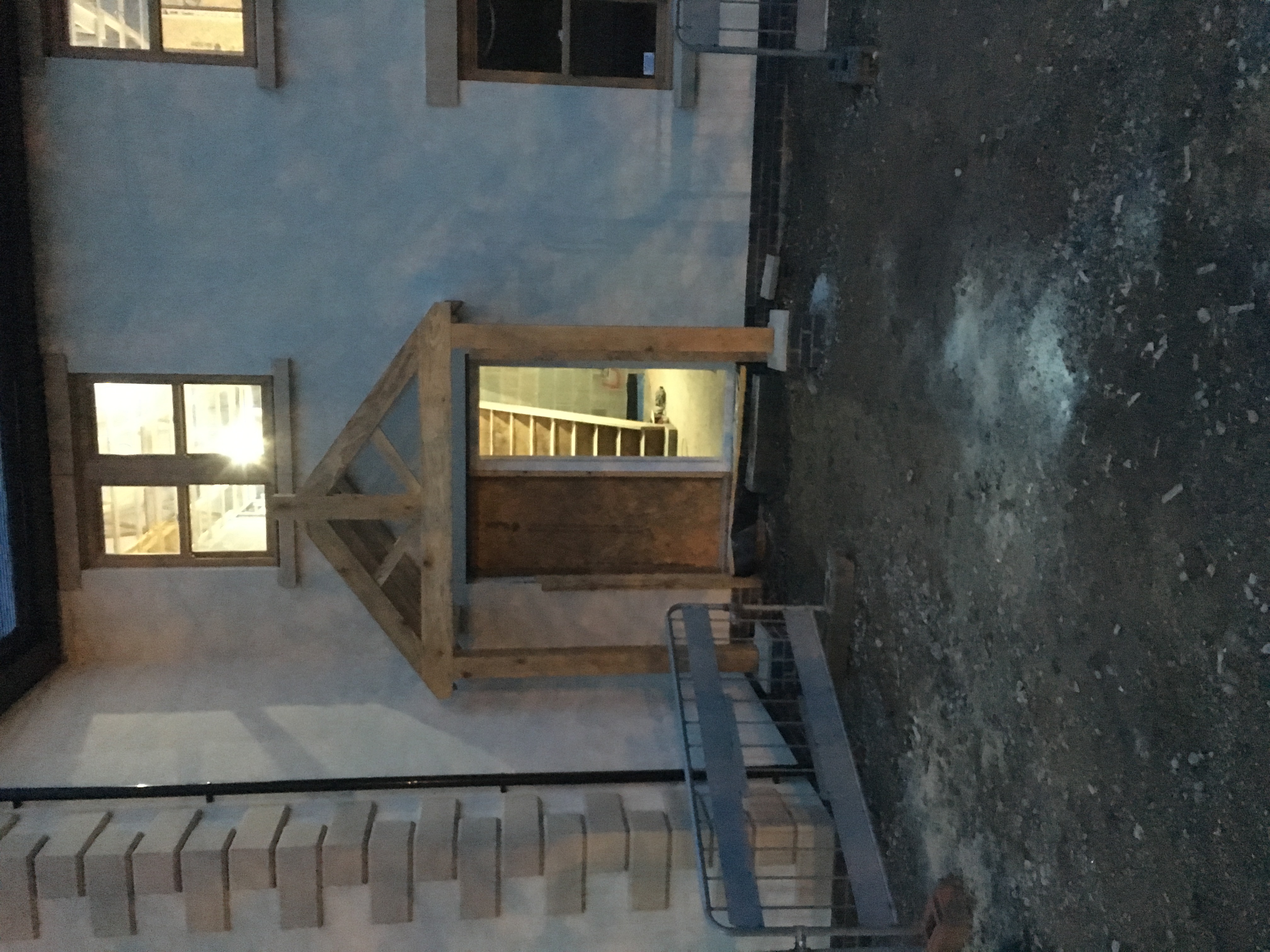

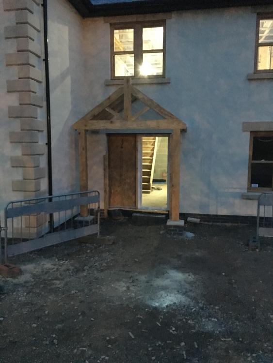

nod Posted January 15, 2018 Posted January 15, 2018 2 hours ago, Russell griffiths said: Hi I’ve just made a name sign for outside our site out of oak and would like to protect it, it’s going to hang on a post like an old pub sign so will be swinging in the wind and rain for a good few years (I hope ) any veiws on a good sealer protector I want it to stay oak coloured and not grey off. Cheers. I’ve just started putting my oak canopy together I used the Omo clear and it’s brought the grain out nicely I’ll add a few decent pictures next weekend 1
