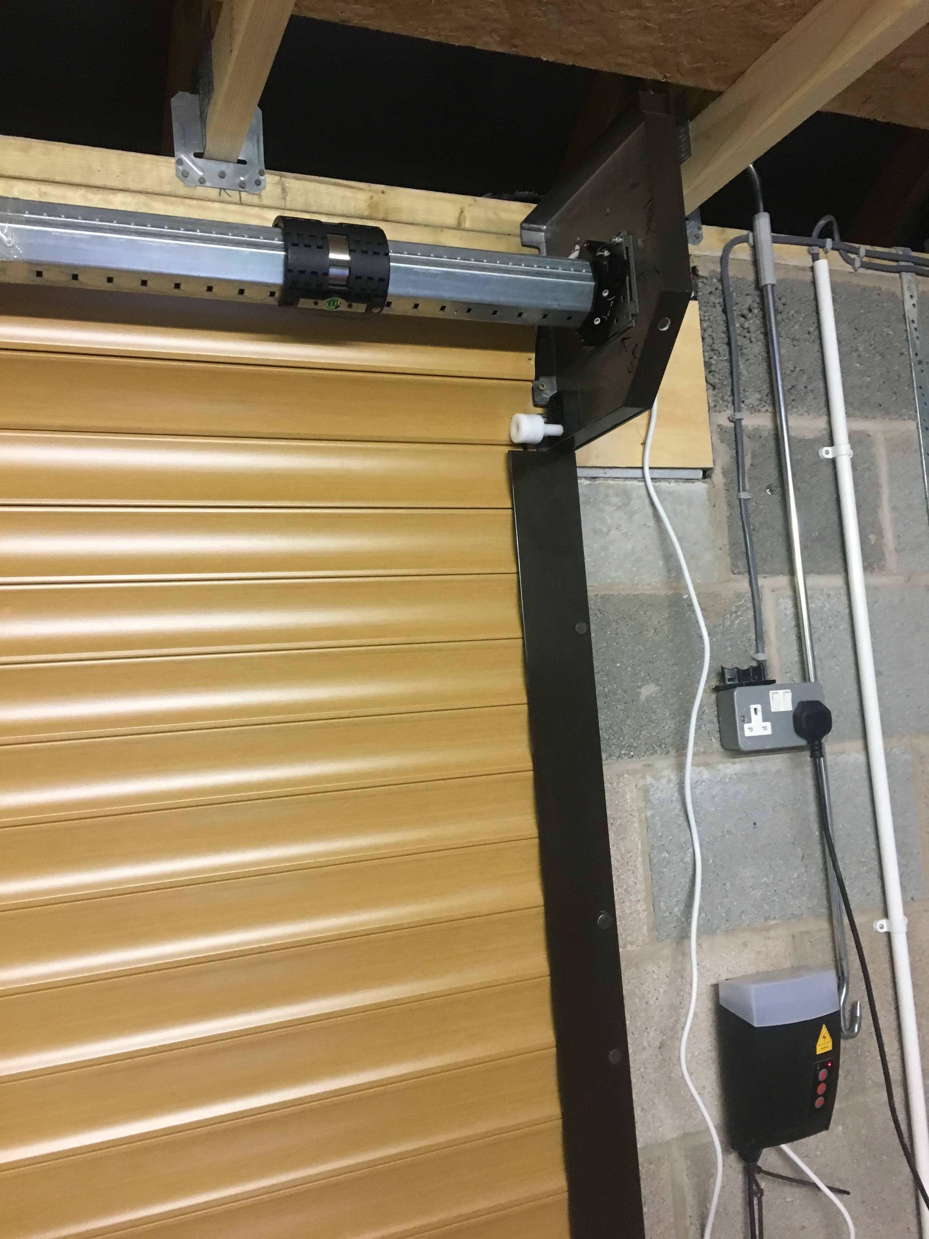

nod Posted November 7, 2025 Posted November 7, 2025 We fitted a roller doors on our previous build Very simple to fit Electrics are colour coded The only difficult thing that we found was feed the roller door in While Im a strapping 6”4 and 15.5 stone My wife is 5”6 and 8 stone We managed But could have done with another pair of hands 1

nod Posted November 7, 2025 Posted November 7, 2025 1 hour ago, saveasteading said: @nod where did you get the door? Was it one complete kit, and well thought through? I've had a quote of £1,200 + vat, delivered. It's 3m wide which is more than the standard. As an industrial door, in plain galvanised slats it would be £400 cheaper. It was from garage doors online It wasn’t a real colour so an extra 150 £825 all in 6 years ago 3.7 wide x2000 Full kit everything there It took wife and myself 3 hours to fit We built a garage for my know it all neighbor He bought and fitted his himself and had all sorts of problems As he fitted the Motor on the wrong side which made it upside down Quick fix Took us four hours as he wouldn’t listen They ask you which side you are fitting the motor as it’s built into the bar It’s one of those things that one d you fitted one it’s a doddle One unit two runners slat door electric box 1
saveasteading Posted November 7, 2025 Author Posted November 7, 2025 Such useful responses thanks. The @nod one is like I want. I've gone on the Garage Doors Online website. There is an immediate difference between them and most others. Information on the products. They have an address. Their enquiry form is interactive and there was an immediate quote for supply. Unfortunately that quote is nearly double what I've had before. But then they are an intermediary and have a web presence to pay for. @nod are the laths insulated? Was it the model flagged as diy friendly? And i can't resist this, sorry: How durable is it in use? Because " He who's laths last, laughs longest." 1
dpmiller Posted November 7, 2025 Posted November 7, 2025 The one in Nods photos is the same as ours, supplied for our shed by Garage Door Systems https://garagedoorsystems.co.uk/products/insulated-roller-doors/ foam filled slats, brush seals at the sides etc 1

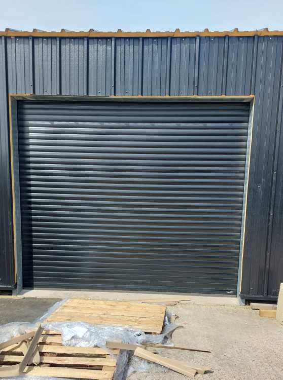

ProDave Posted November 9, 2025 Posted November 9, 2025 I bought mine from Rollerdor on ebay. Made to my size and delivered for about £500 Mine fits to the inside face of the opening not "in" the opening and is sized for that. It came with the door rolled onto the roller mechanism and the side rails separately. It was easy to fit but a 2 man job to lift the roller assembly into place. As well as electric opening with 2 remote controls, it can be opened manually with a handle from inside if needed. 1
saveasteading Posted November 9, 2025 Author Posted November 9, 2025 44 minutes ago, ProDave said: rolled onto the roller mechanism Were these foam-filled laths or plain? Coloured? There seems to be a jump in price somewhere beyond 2m width, but £500 has to be good for the standard size. I've filled in their enquiry form for an "instant quote". As often it's not a quote at all, and they will phone. But at least they have an address.
ProDave Posted November 9, 2025 Posted November 9, 2025 10 minutes ago, saveasteading said: Were these foam-filled laths or plain? Coloured? Foam filled, white, 2.5M wide 2.7M high 1
