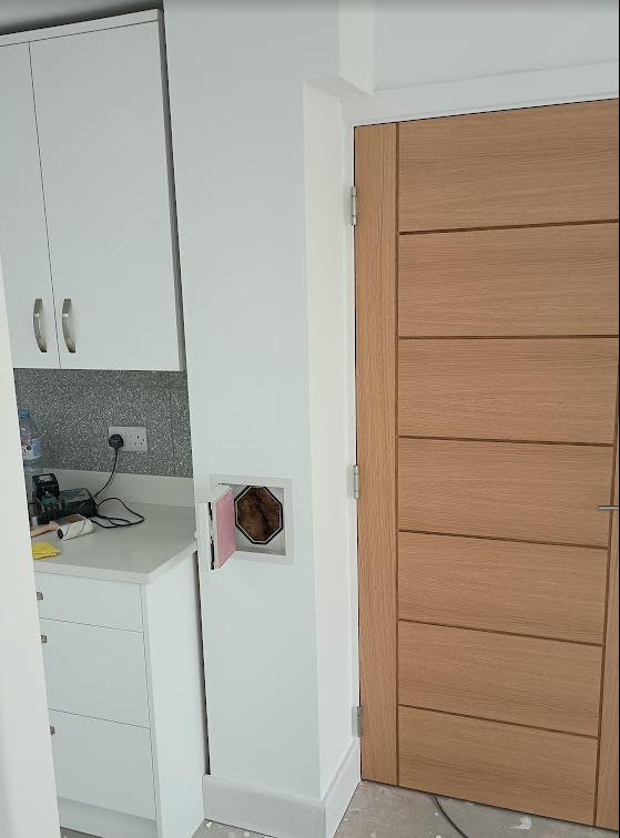

Mr Punter Posted Wednesday at 13:51 Posted Wednesday at 13:51 I have just done a small bit with the metal reinforced paper tape on some boxing. It was not too bad. If I was doing it on price we would be hungry! 1

Mike Posted Wednesday at 18:45 Posted Wednesday at 18:45 4 hours ago, Mr Punter said: I have just done a small bit with the metal reinforced paper tape on some boxing That's an unusual octagonal access hatch...
Mr Punter Posted 17 hours ago Posted 17 hours ago 13 hours ago, Mike said: That's an unusual octagonal access hatch... Yes a bit odd. It is fire and acoustic rated. Maybe the octagon made it a bit stronger? 1
