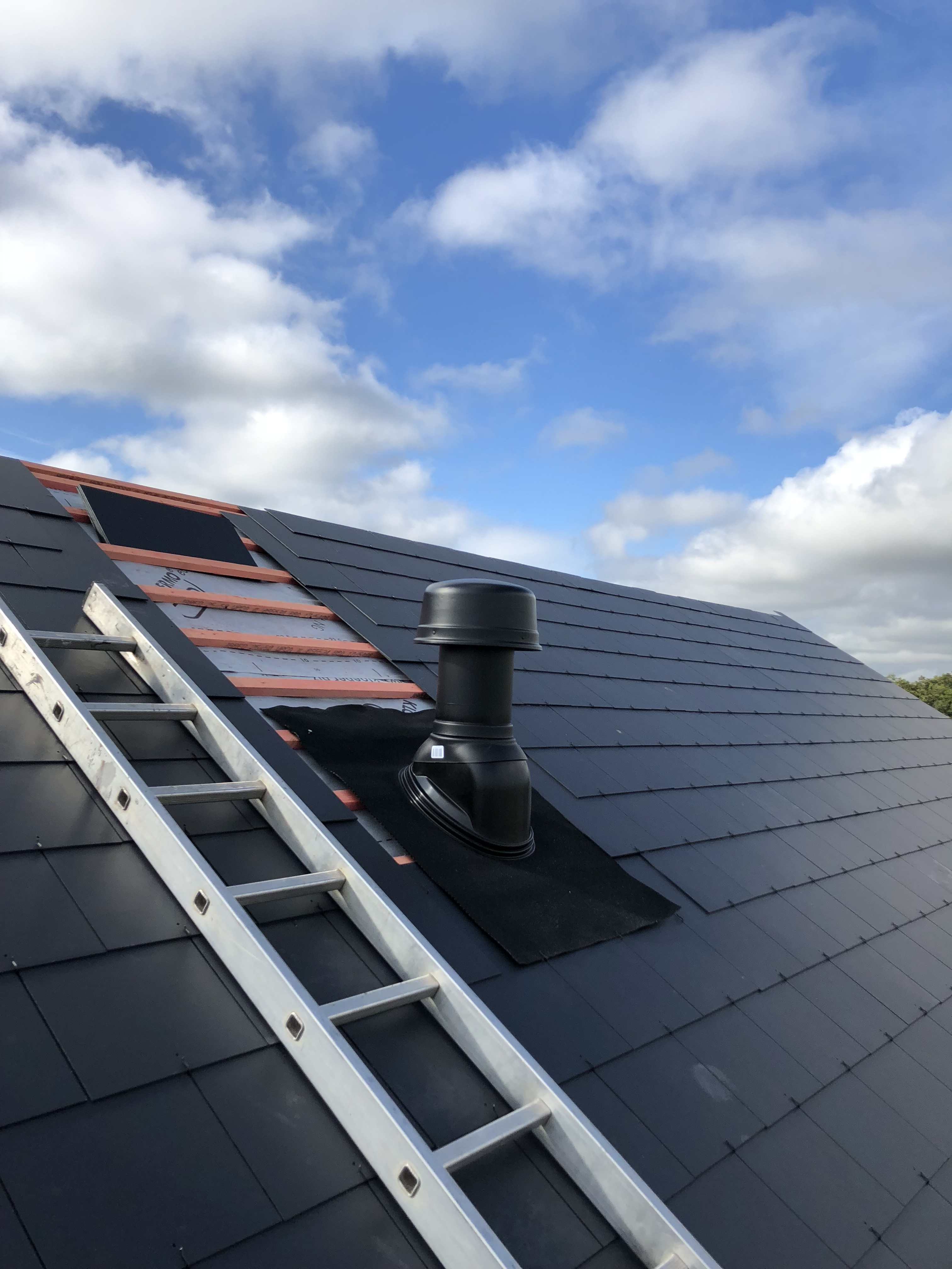

Nickfromwales Posted November 3 Posted November 3 4 hours ago, Alan Ambrose said: To avoid collision with my PV panels and Velux windows, is there any reason why I shouldn't put my MVHR external vents under the gable soffits using terminals like these? Ventilation Tile UB19 Slates 500mm x 250mm (NJ) Anthracite | Ubbink Also, can I use these, this time on the top of the roof, for SVP vents rather than 110mm pipe? For various reasons, mainly aesthetics, but again I want to avoiding shading my PV panels. I fit these, not too tall tbh. Put the SVP elsewhere? Or out horizontally at the top of a gable maybe? Done that a few times too.
Mike Posted November 3 Posted November 3 6 hours ago, Alan Ambrose said: is there any reason why I shouldn't put my MVHR external vents under the gable soffits using terminals like these Not sure what you man by 'under', but first check that they can support the required airflow rate 6 hours ago, Alan Ambrose said: can I use these, this time on the top of the roof, for SVP vents rather than 110mm pipe? No problem, provided they respect the distances from windows required by the Building Regs.

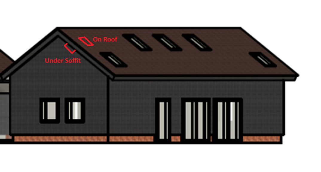

Alan Ambrose Posted November 3 Author Posted November 3 @Mike - I was meaning here (below) and yes, the MVHR calcs say a 180mm diameter vent (i.e. 25,000 mm^2) gives 2.3 m/s on boost and the UB19 is 22,000 mm^2 - so 'close enough for government work'. @Kelvin - that's clever, but we don't have any waste running from the garage, and it's also some distance away.
Mike Posted November 3 Posted November 3 37 minutes ago, Alan Ambrose said: the MVHR calcs say a 180mm diameter vent (i.e. 25,000 mm^2) gives 2.3 m/s on boost and the UB19 is 22,000 mm^2 And Ubbink have a 180mm pipe / duct adapter to suit? 19 minutes ago, Alan Ambrose said: I was meaning here So you'd screw the tile upside down (sideways?) - I guess physically that could work, provided you can get the duct connections within the space. However if upside down then the upturned cowl would be liable to collect snow / leaves / other debris which might cause a maintenance problem, and you'd also need the exhaust duct sloping back towards the MVHR unit (it couldn't fall towards the vent as otherwise there's a risk that the upturned cowl would collect condensate too), but that may not be a problem to achieve. Sideways would probably be preferable. However, what's the problem you're trying to solve & why are you trying to avoid regular wall terminals? 1
torre Posted November 3 Posted November 3 If fixing to the underside of the soffit can't you use a simpler cover, just a plain grill or a bull nose? It sounds harder to run the ducting to the soffit versus out of the gable end right next it.

Nickfromwales Posted November 4 Posted November 4 18 hours ago, torre said: If fixing to the underside of the soffit can't you use a simpler cover, just a plain grill or a bull nose? It sounds harder to run the ducting to the soffit versus out of the gable end right next it. Would need to be a big soffit!!

Dave Jones Posted November 5 Posted November 5 On 03/11/2025 at 12:03, Alan Ambrose said: To avoid collision with my PV panels and Velux windows, is there any reason why I shouldn't put my MVHR external vents under the gable soffits using terminals like these? Ventilation Tile UB19 Slates 500mm x 250mm (NJ) Anthracite | Ubbink Also, can I use these, this time on the top of the roof, for SVP vents rather than 110mm pipe? For various reasons, mainly aesthetics, but again I want to avoiding shading my PV panels. I did exact same as I didnt like the look of the little chimneys. Problem I had they are not big enough and throttled the air flow (MVHR complained about restricted air flow) so had to ditch the plan. 1
