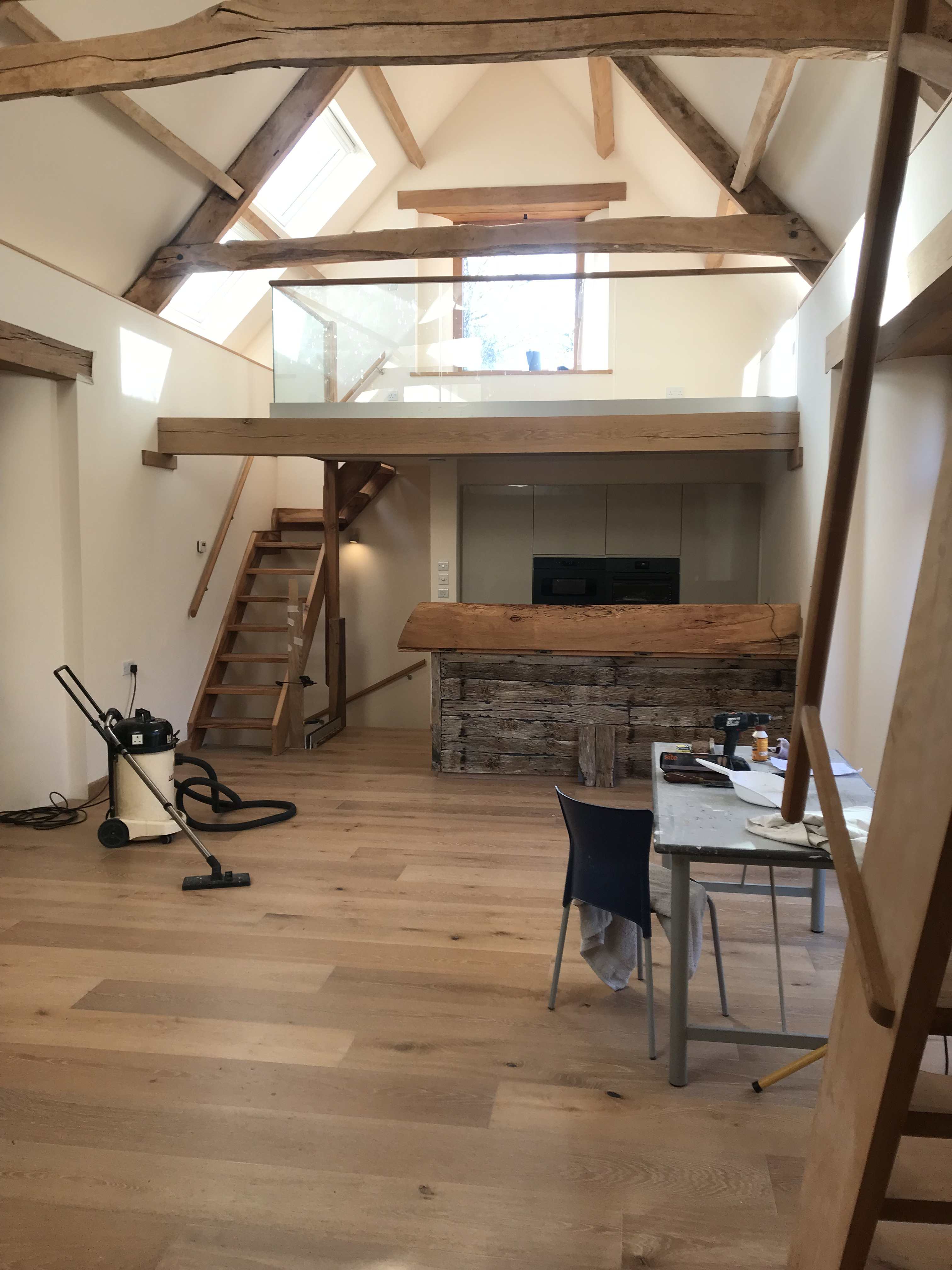

I’m doing work on an old barn that’s being timbered out like you describe
I can take a few pics if you drop me a reminder

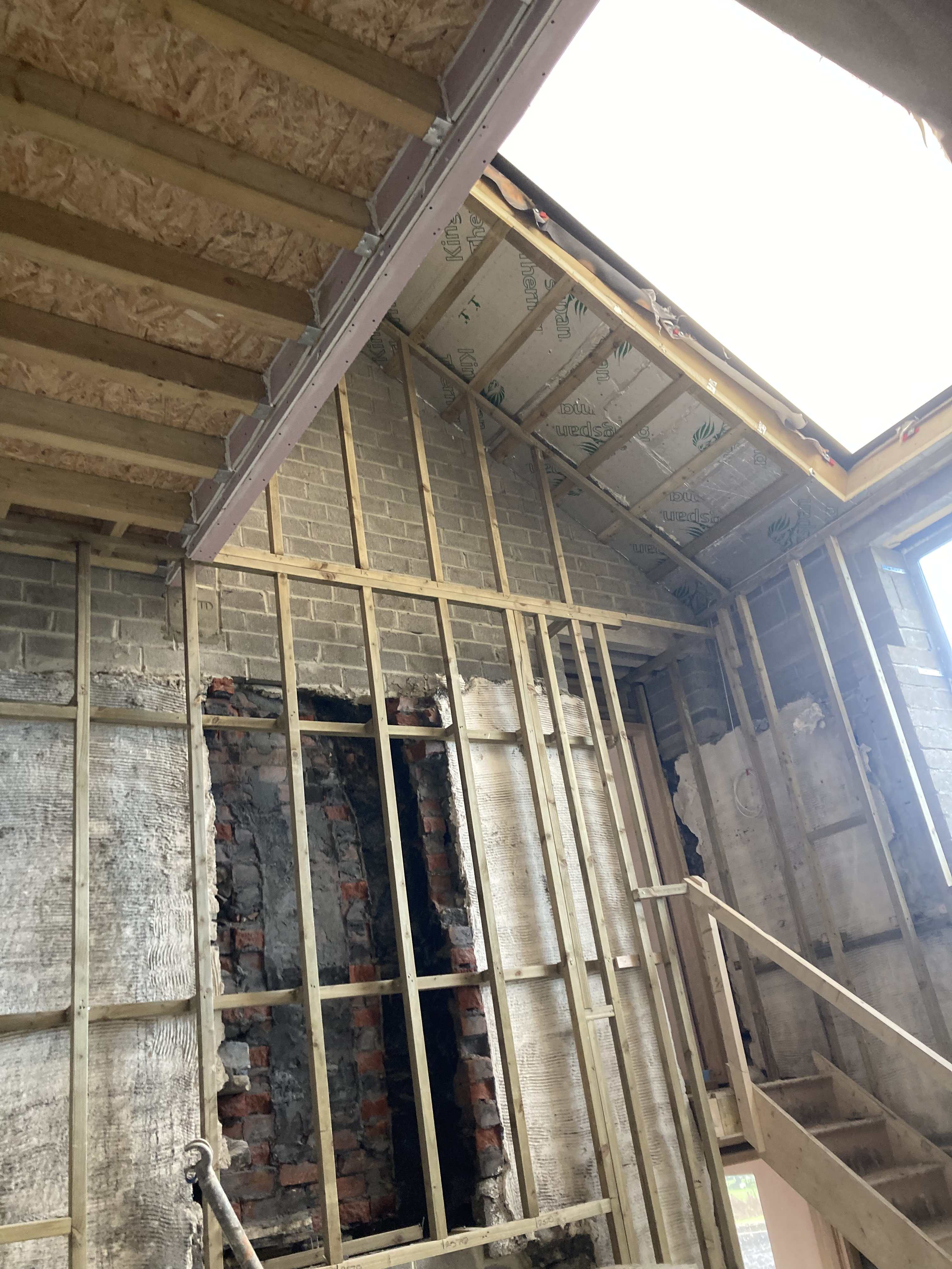

We had a converted barn in the 90s done that way. And did similar to a house (1830) we did up in 2012. In the house the windows remained in the stone wall - with a small thermal bridge.
Our last house was like this. 200 year old barn and a stick built frame assembled inside. The windows were fitted to the original brick wall like @JohnMo describes. We didn’t convert this barn, we bought it as a new house from the builder. They didn’t do a terribly good job with the insulation detailing unfortunately. There was plenty of it just not well done in places. The window reveals were particularly cold.

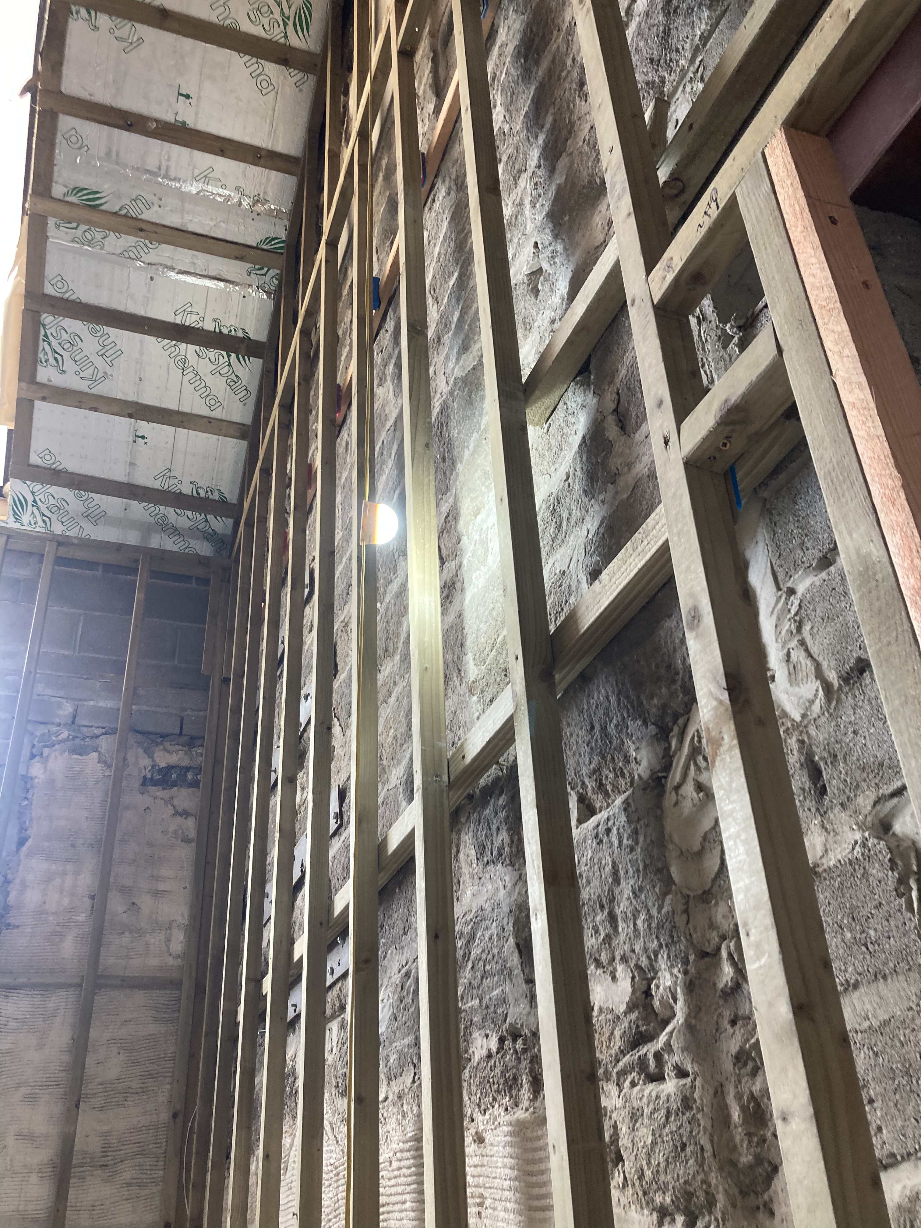

We would normally frame out in metalBut the client wanted timberA038C243-E609-457B-B24C-A30B5611C44A.thumb.jpeg.e3687ac02f9363c0e75f38ade8d984a1.jpeg

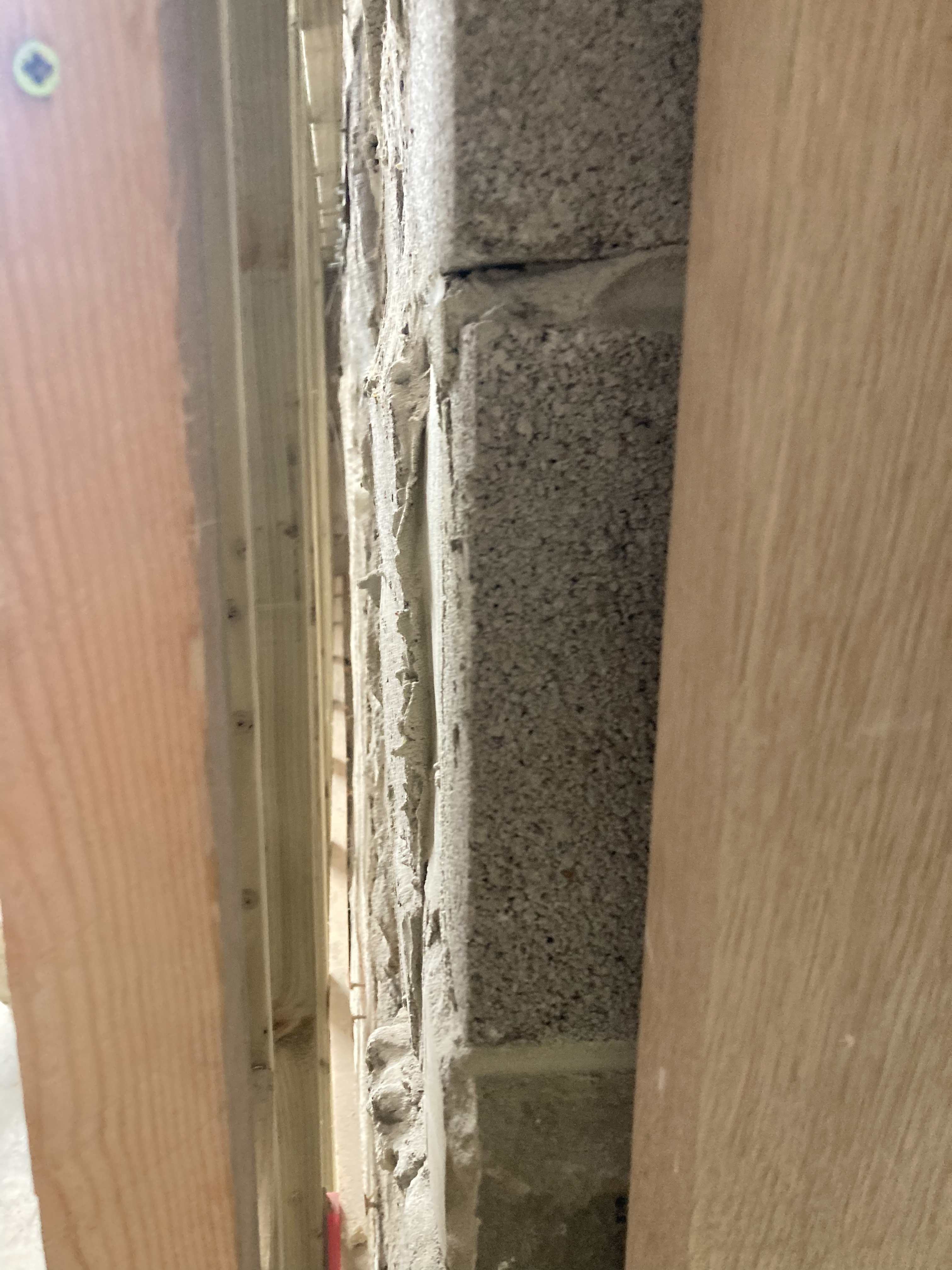

We did a structural 2-storey inner timberframe, 50mm away from the old stone rubble walls, with metal-web Posi-joists for the mid-floor (ideally hang these off the inner side of the frame to avoid cold bridging).
New slate roof was sat on the old walls at my insistence - the engineer wanted it to sit it on the inner timber frame *.

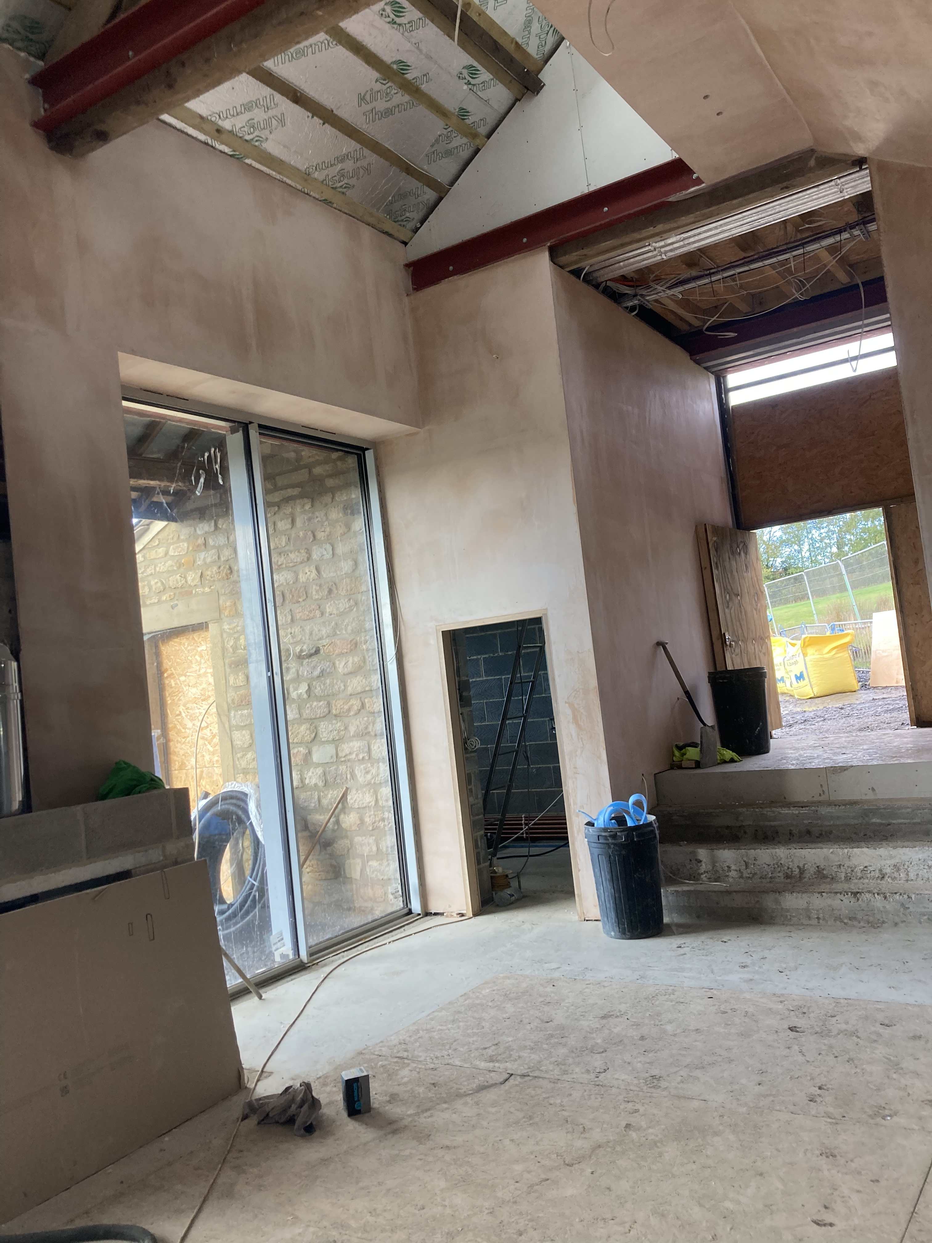

New windows (Accoya d/glazed traditional sash) also set into the original openings of the stone wall.
The difficulty with this is the foundations required - have to be very close to the inside of the old walls and, depending a bit on soil conditions, likely to disturb the ground under the old walls if you are not careful. When we dug for the new floor/foundation concrete raft and discovered the old walls stopped not much below ground level the engineer said we should underpin the entire building but then he agreed we could instead just feather the the edge of the internal foundation raft at an angle, away from the old walls. *If the foundations were even deeper, to support the roof weight too, I doubt we would have got away with it.
Edited by Hastings
Airtight build with MVHR.
Structural wall panels were filled with 100 wood fibre, fitted together with expanding foam tape, Intello membrane, then cross-battened 50mm and filled with 50mm wood fibre. One or two needed a pulley to lift.
Window reveals framed out and fitted with PIR, 25, 50, or 75mm depending on available space.

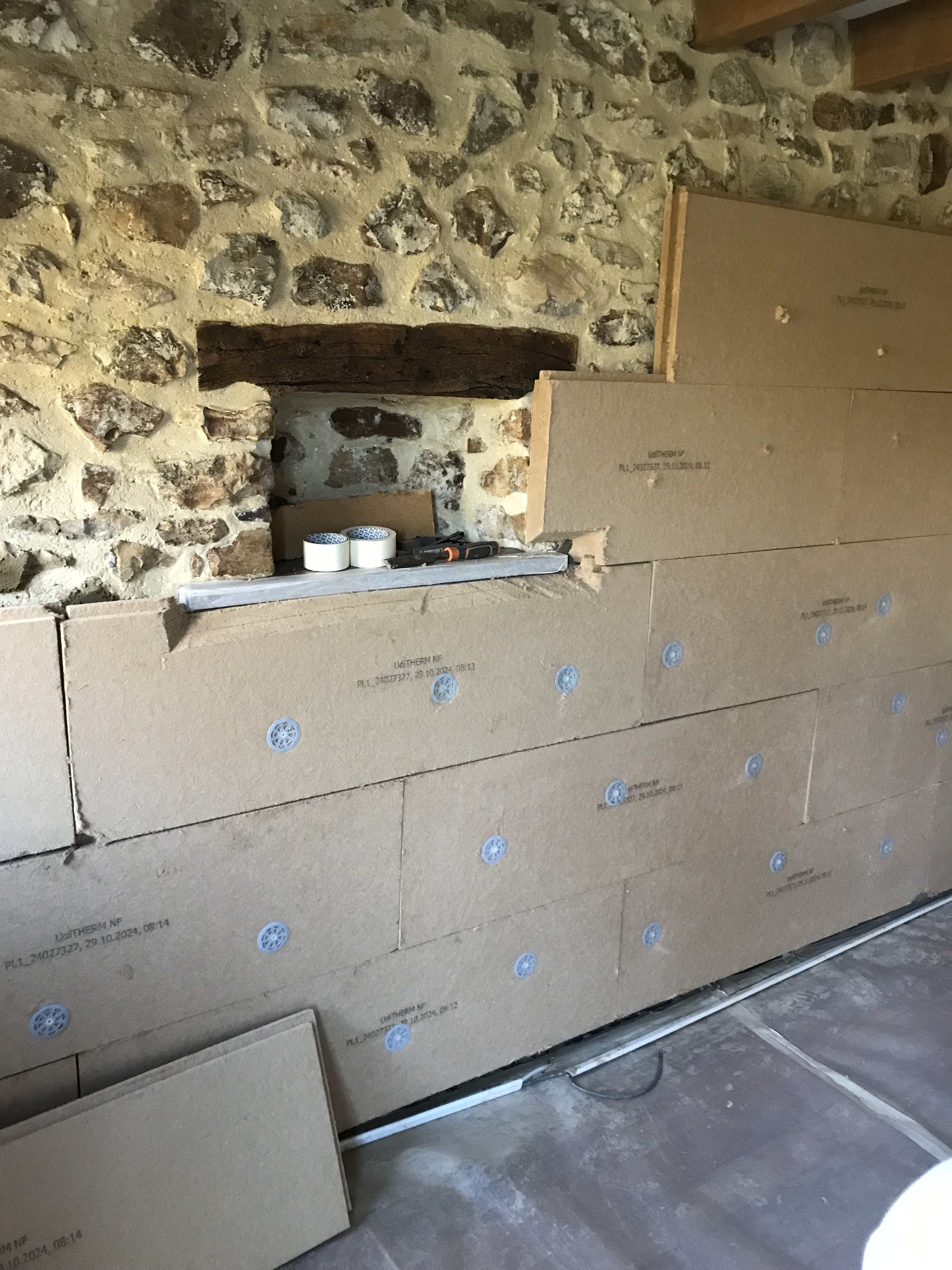

My parents ,now late octogenarians converted dilapidated flint stone barn late 90's. Tons of work. Only now, due to feeling the cold decided to insulate the walls with Pavatherm and lime plaster.
Huge difference in comfort and minimal space lost.
They also converted another shed using the approach above, internal timber frame, Pavatherm and lime.

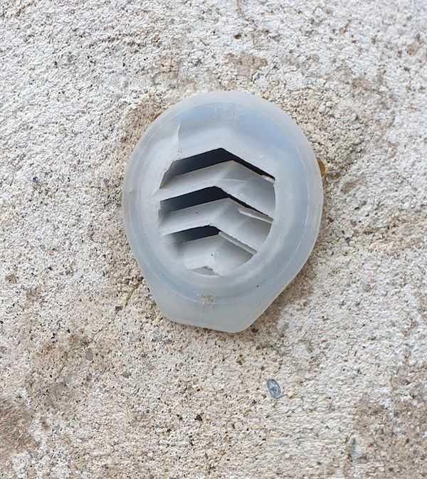

Yes. Building Control specified very small vents every 1.5m, 30cm above ground level, and that the cavity be open at the top to the roof space.
I used Manthorpe Refurbishment Drill Weep Vents set into the ends of MDPE water pipe drilled into the walls. Had to buy a 35mm x680mm masonry drill bit just for the purpose. These weep vents are rubbish and fall to pieces within months, due to UV I suppose. Drilling this type of wall seems a bad idea because it disturbs the loose stone fill inside (sometimes jamming the drill bit) and therefore the structure of the wall.
The gable end walls were too thick to drill but had a bigger vent in already to feed the woodburner. The woodburner had a duct off the back of it going through the internal wall to the cavity.
