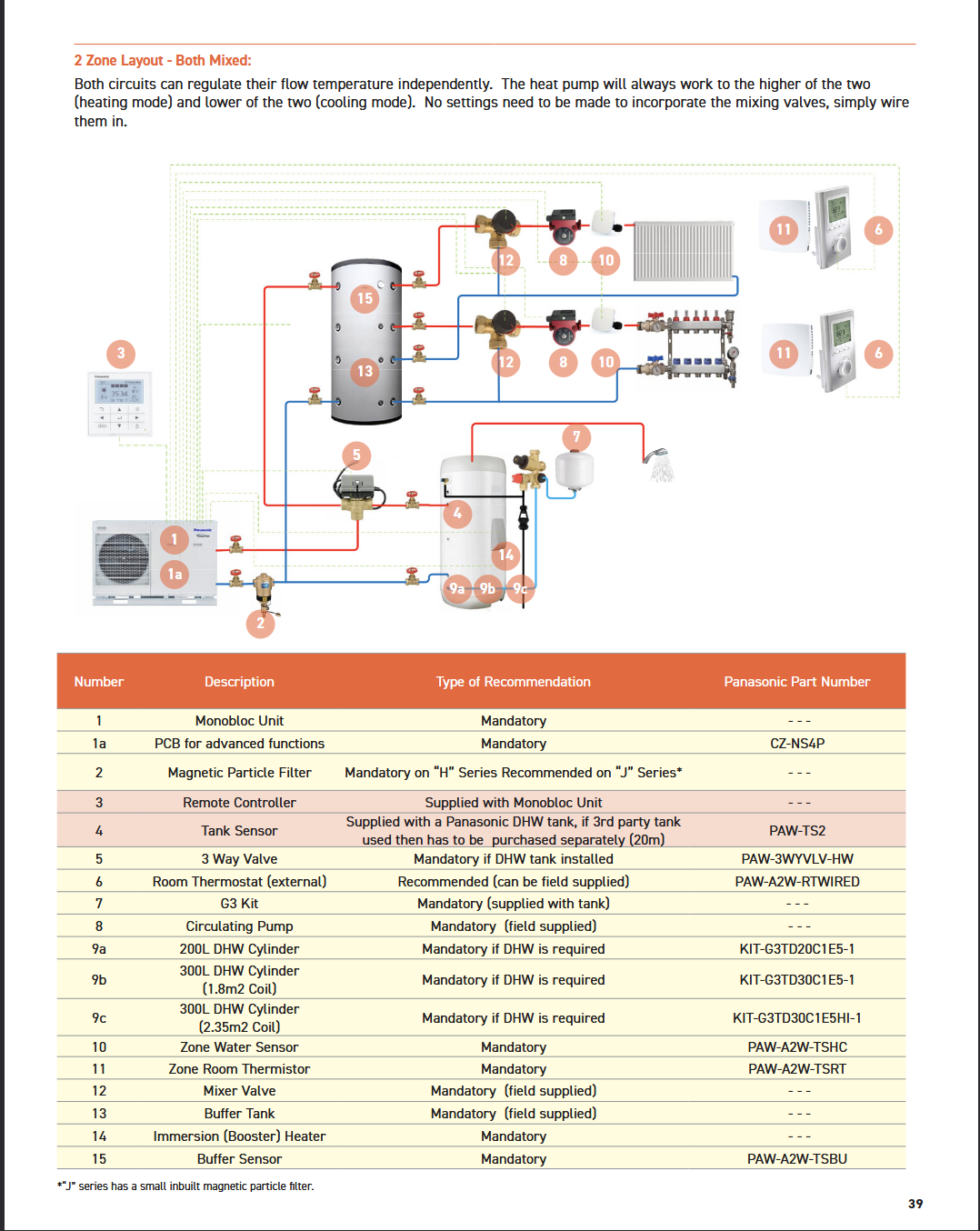

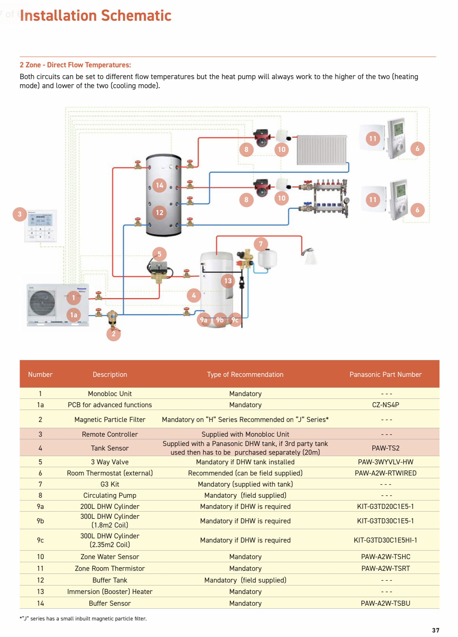

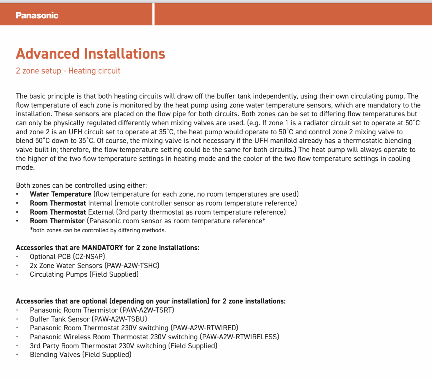

Nick Laslett Posted October 14, 2025 Posted October 14, 2025 (edited) Not sure how the ‘M’ is different to the ‘J’? Here are the pages from the installation set-up for the ‘J’ ashp about 2 zones, different temps. https://www.panasonicproclub.com/uploads/GB/catalogues/2023/UK_INSTALLATION_MANUAL_H 2023v3.pdf Edited October 14, 2025 by Nick Laslett

-rick- Posted October 14, 2025 Posted October 14, 2025 Definitely sounds like it should be possible. They are relying on mixing valves and running the heatpump at the highest (heating) or lowest (cooling) temperature so it's not necessarily the most efficient but I wouldn't expect you to need the very low cooling temps outside of heatwaves.

JohnMo Posted October 14, 2025 Posted October 14, 2025 Read a lot of ASHP manuals (yes sad), they all seem to work in a similar fashion. The ASHP receives a zero volt signal to run the second operating temperature, otherwise it runs at normal temperature So if your UFH is only calling for heat only it runs at one temperature, if your upstairs also calling for heat the second set point comes in, a mixer valve then mixes up/down in cooling/heating Work equally well for heat and cooling. You need (generally) an electronic mixer valve, volt free thermostat in addition to what in your fan coils, maybe a buffer or ideally a volumiser to cover just the fan coils calling for heat. Adds loads of additional complexity.
-rick- Posted October 14, 2025 Posted October 14, 2025 3 minutes ago, SBMS said: Heat pump produces 10deg water into buffer FCU takes 10 deg water direct from buffer and returns back to buffer. UFH branch comes off buffer with a 3 way thermostatic mixing valve with a hard min of say 16 degrees. Valve blends the 10deg water from buffer with the return from UFH circuit with output to the UFH. UFH circuit would be separately pumped and return to buffer. I think the issue is with the mixing valve. A normal analog thermostatic valve can't have different set points for hot and cold. I'd guess that many digital ones also require more setup work/software support to do this. Maybe their inbuilt control of digital valves is the problem? If so, wouldn't seem hard to make sure you bought valves that could handle two set points and wire them seperately from the rest of the system. Not sure off hand why they would need to be wired into the heatpump except for monitoring reasons, they should be set and forget.
