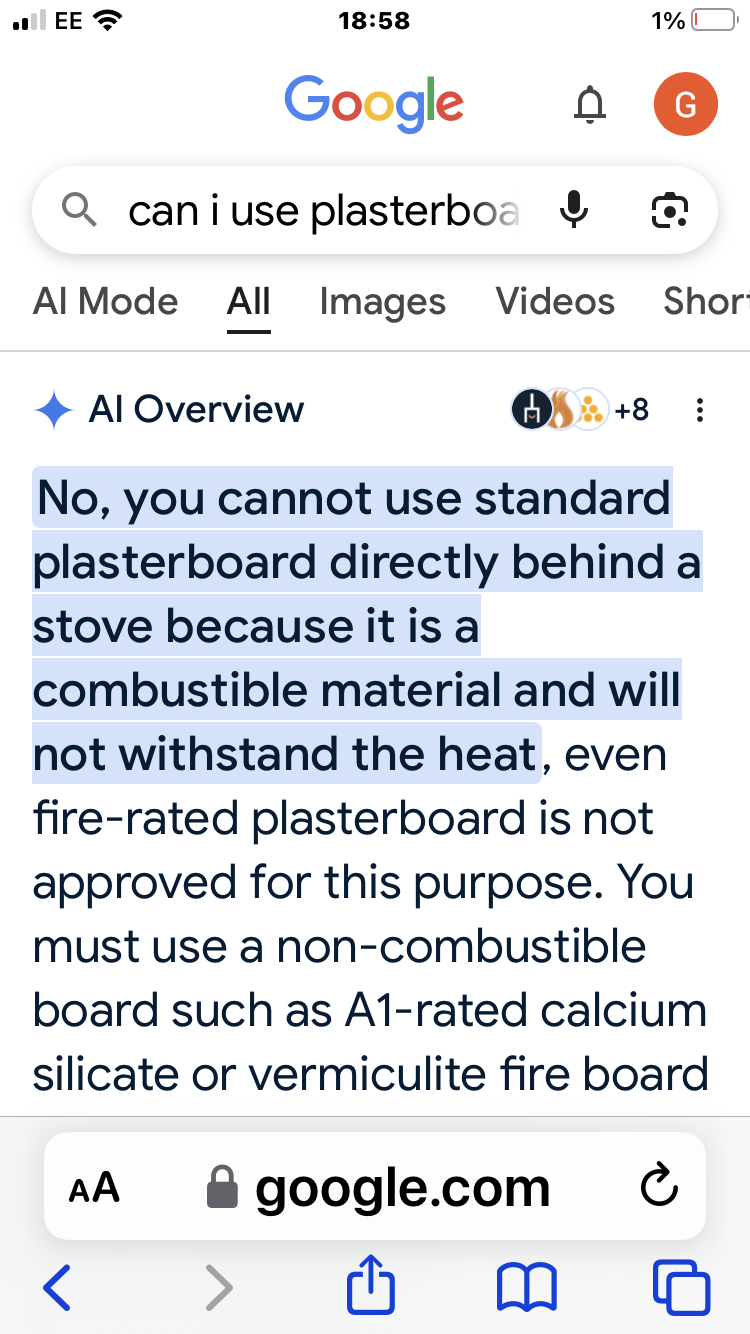

nod Posted October 14, 2025 Posted October 14, 2025 Most installers flag plasterboard as combustible (Paper) I tend to use a cement board Skim or tile

nod Posted October 14, 2025 Posted October 14, 2025 11 minutes ago, ProDave said: But if your stove (mine) says 100mm to combustibles then plasterboard 140mm away is fine for example. Still waiting for @benben5555 to say if his wall is greater than his "distance to combustibles" away from the stove or not. THAT answer will determine how he needs the construct the wall.

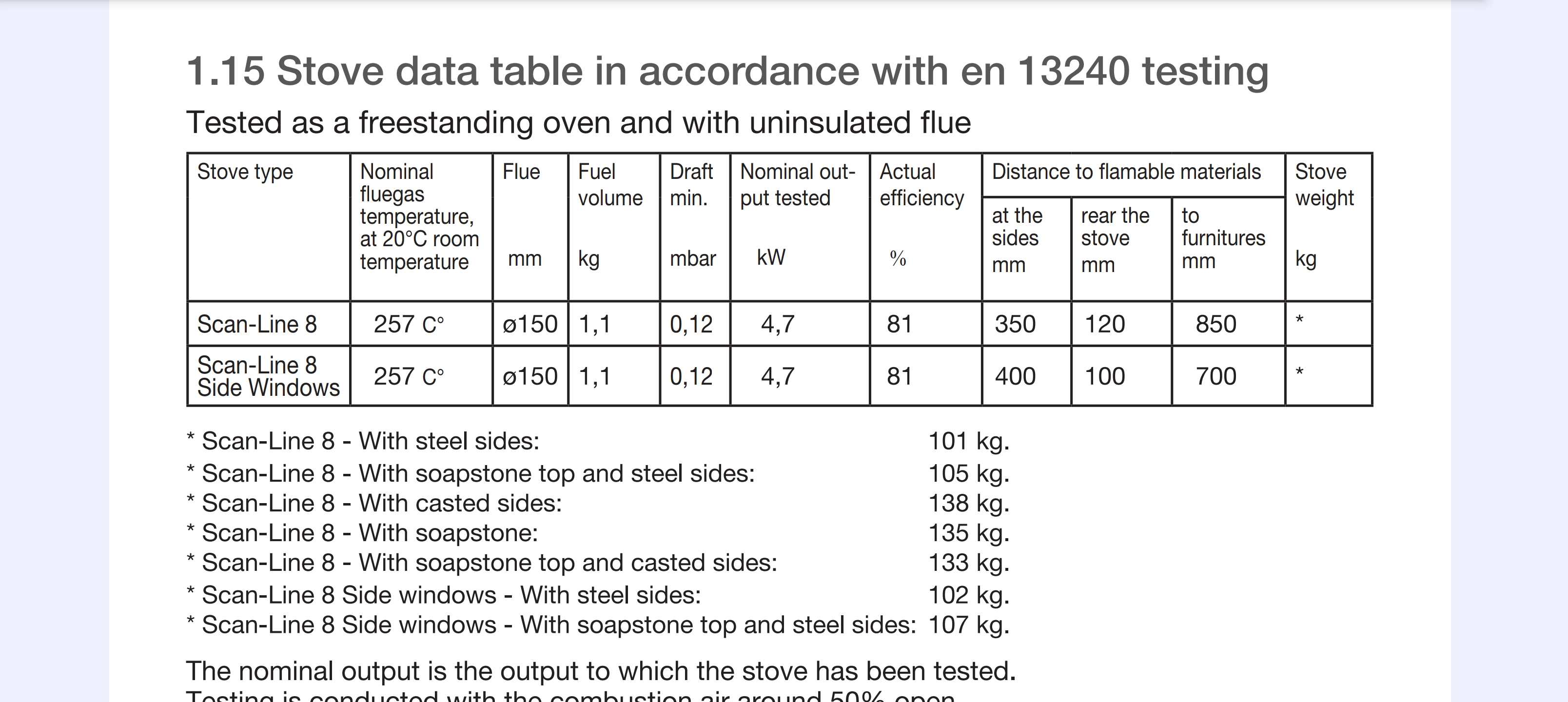

JohnMo Posted October 14, 2025 Posted October 14, 2025 23 minutes ago, nod said: AI may say that, but it depends on the manufacturers instructions for distance to combustibles. Mine for example clearly states 125mm at back and 350mm at the sides

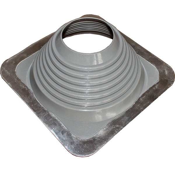

JohnMo Posted October 14, 2025 Posted October 14, 2025 1 hour ago, Oz07 said: Do you guys have photos of yours in? How do you maintain air tightness where flue passes thru wall? Mine went through cathedral ceiling and I used something like this taped to airtight membrane. 1

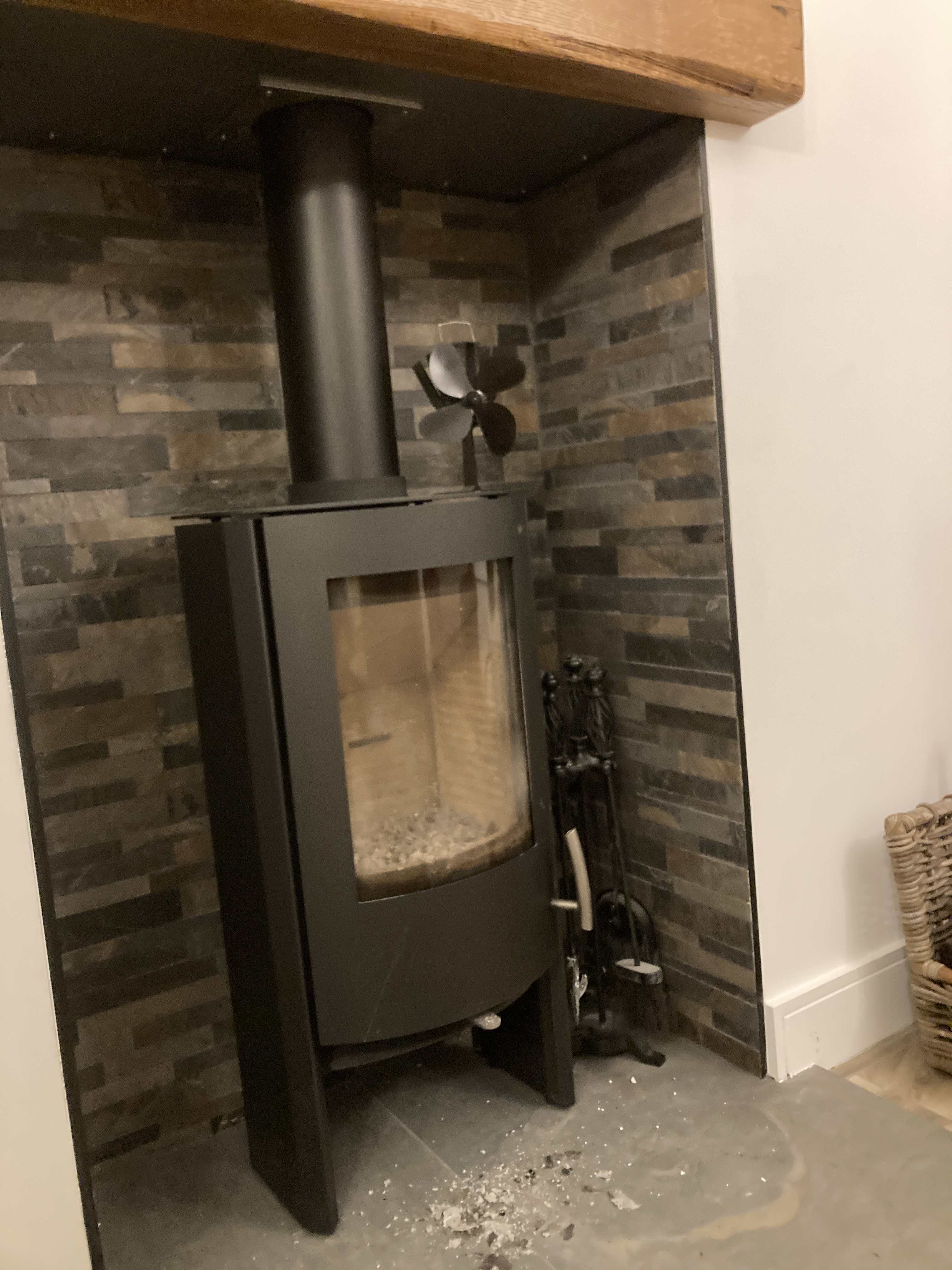

nod Posted October 14, 2025 Posted October 14, 2025 2 hours ago, JohnMo said: AI may say that, but it depends on the manufacturers instructions for distance to combustibles. Mine for example clearly states 125mm at back and 350mm at the sides It’s no great shakes to use a cement board rather than PB Most of the ones I do are tiled or skimmed Your only talking Pennie’s to use a cement board Ive put an oak beam on ours Your not supposed to do that either Done after installation
nod Posted October 14, 2025 Posted October 14, 2025 1 hour ago, Oz07 said: Do you guys have photos of yours in? How do you maintain air tightness where flue passes thru wall?

saveasteading Posted October 15, 2025 Posted October 15, 2025 On 14/10/2025 at 22:37, JohnMo said: something like this These are also made for hot flues. The plastic is red for clarity. I can't remember what "hot" is defined as... basically anything more than ambient I think, but up to very hot from gas burner flues.
