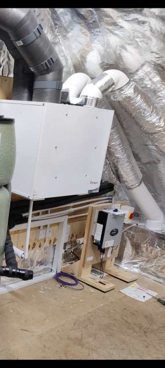

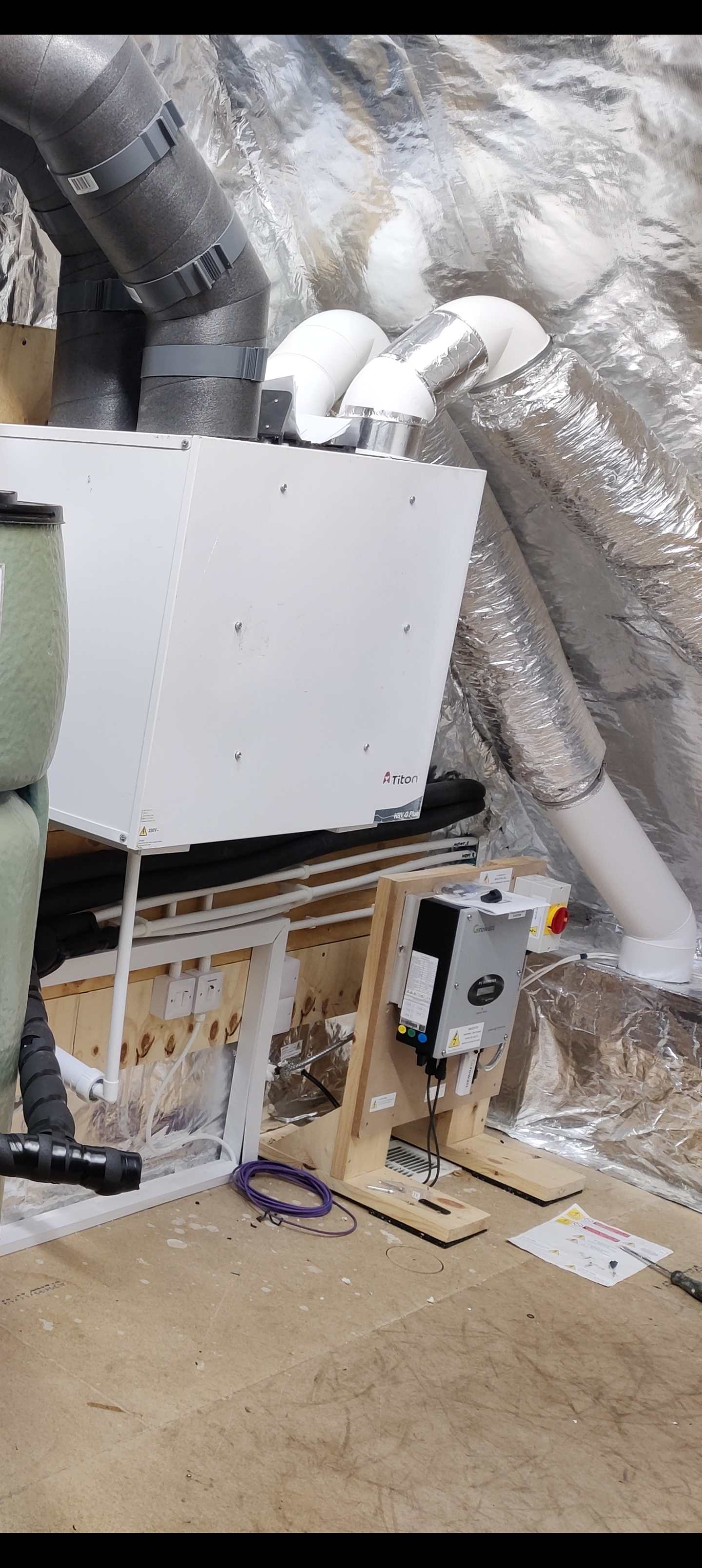

Mattg4321 Posted October 5, 2025 Posted October 5, 2025 (edited) I’ve finally got my system up and running and slightly disappointed with the slight droning noise I’m getting from the supply terminals. It’s by no means horrendous, but quite a few people on here say they can’t hear it even with their ear to it. Perhaps I’m (and also my wife!) sensitive to it, or perhaps it’s the unit I’ve chosen/the silencer I’ve fitted. Would be grateful for your thoughts. I have the Vent Axia sentinel kinetic fh With this silencer between both the supply and extract manifolds https://bpcventilation.com/products/quiet-vent-semi-flexible-silencer-range?variant=53736188707142 These manifolds https://bpcventilation.com/products/quiet-vent-10point-re?variant=53736193753414&country=GB¤cy=GBP&utm_medium=product_sync&utm_source=google&utm_content=sag_organic&utm_campaign=sag_organic&gad_source=1&gad_campaignid=22309731029&gbraid=0AAAAADpzxaWZxxdpXsjssay4R_gcCEWm-&gclid=Cj0KCQjwrojHBhDdARIsAJdEJ_fCPWKRHSNb-UR7UjrVugdzT9dmzVPeRhvT1YwSjs0a52VTXHXolz8aAivpEALw_wcB A double run of 75mm semi rigid ducting to the bedroom. The terminal is just past the foot of the bed and to the side by about 300mm. Unit is set to 15% overnight and still audible. Although to be honest not a great deal of difference between 15% and 40% boost. The drone stays similar. The air noise becomes audible as you get above 30-35% Edit: To clarify the noise is from all supply terminals. The extract terminals don’t really suffer the problem, or it’s much reduced - which probably makes sense to me. Thanks Edited October 5, 2025 by Mattg4321
JohnMo Posted October 5, 2025 Posted October 5, 2025 How is the MVHR unit actually mounted and where. Is the MVHR mechanical linked to the manifold by anything other than the silencers? Are they both hard fixed to the same wall for example? It could be vibration noise. Air movement noise generally isn't a droning noise, assuming you and I call a droning noise the same thing. Air house more Ssssssss.

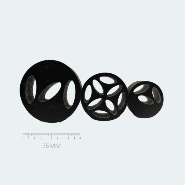

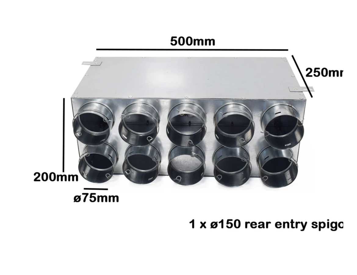

Mattg4321 Posted October 5, 2025 Author Posted October 5, 2025 To add to this, just been weighing up my options, other than accepting that’s as good as it gets with this unit… 1. Change silencer for something else. Will be awkward because of space, which is a big part of the reason I went flexi to start with. 2. Fit those foam disc baffles where you poke sections out. Problem with this is where? Fitting in the terminal doesn’t seem like it would help much to me - only a gut feeling. 3. Do something with the manifold box, which seems like it could be part of the reason for the noise, or at least an option for a solution. A square box with flat hard sides might be amplifying any sound. I could pull this out without too much trouble and use the 150mm entry hole for access to line the sides with eggbox acoustic foam? I wonder how much difference this would make as the 150mm inlet from the MVHR is still directly in line with the outputs. I’m not an expert, but guess the sound ‘bounces around’ rather than travelling in a straight line, past the eggbox foam?!!
Mattg4321 Posted October 5, 2025 Author Posted October 5, 2025 (edited) 5 minutes ago, JohnMo said: How is the MVHR unit actually mounted and where. Is the MVHR mechanical linked to the manifold by anything other than the silencers? Are they both hard fixed to the same wall for example? It could be vibration noise. Air movement noise generally isn't a droning noise, assuming you and I call a droning noise the same thing. Air house more Ssssssss. MVHR mounted to ply on stud wall and solid ducting up into the loft via a 90 fitting. Then there’s the flexi silencer and only then is the manifold a few joists away, so it’s almost certainly not going to be vibration I’d say. I think it’s fan noise. Possibly being amplified by the manifold/ducting? I’m no expert on acoustics though. I think we’re on the same page re droning noise. The old bathroom extractors were way noisier from an air noise point of view. But any drone wasn’t really noticeable. These were in line units fitted in loft. Edited October 5, 2025 by Mattg4321
JohnMo Posted October 5, 2025 Posted October 5, 2025 3 minutes ago, Mattg4321 said: 2. Fit those foam disc baffles where you poke sections out. Problem with this is where? Fitting in the terminal doesn’t seem like it would help much to me - only a gut feeling They are just flow setters - so doubt they will help just unbalance current settings. Your plenum manifold is the same as mine so may not be an issue.
JohnMo Posted October 5, 2025 Posted October 5, 2025 4 minutes ago, Mattg4321 said: solid ducting It could be the solid duct as it goes through the ceiling, the ceiling structure allows it to bridge the flexible element from a vibration perspective. The vibration then gets amplified in the hollow manifold. Put a couple of heavy books on the manifolds if the drone stops that is the issue. The fix may be as easy as some heavy sound deadening on the outside if the manifold - similar to that inside a car door to make it more solid. 1
Mattg4321 Posted October 5, 2025 Author Posted October 5, 2025 (edited) 9 minutes ago, JohnMo said: It could be the solid duct as it goes through the ceiling, the ceiling structure allows it to bridge the flexible element from a vibration perspective. The vibration then gets amplified in the hollow manifold. Put a couple of heavy books on the manifolds if the drone stops that is the issue. The fix may be as easy as some heavy sound deadening on the outside if the manifold - similar to that inside a car door to make it more solid. Thanks, I’ll definitely give that a go. My gut feeling is that it’s fan noise/noise from the unit being transmitted through the ducting though. I don’t think the ducting even touches the plasterboard as it passes through. It’s then just foamed in. Edited October 5, 2025 by Mattg4321

Mike Posted October 5, 2025 Posted October 5, 2025 6 hours ago, Mattg4321 said: 3. Do something with the manifold box, which seems like it could be part of the reason for the noise, or at least an option for a solution. One option might be to replace it with the Zehnder Comfowell CW-S 520, which has inbuilt acoustic attenuators (and can also take 10 x 75mm ducts). 1

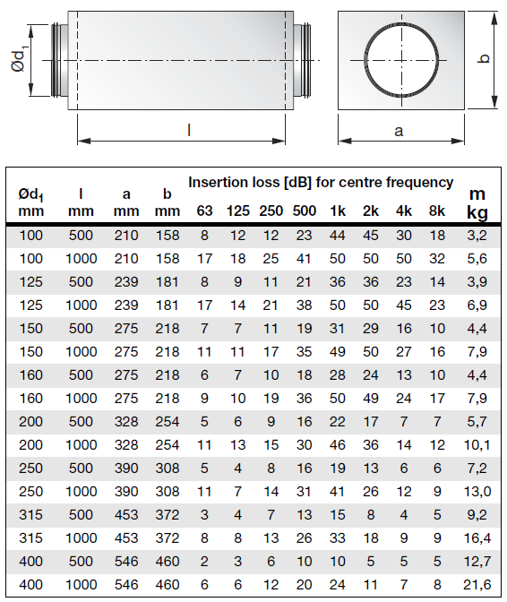

Nick Laslett Posted October 5, 2025 Posted October 5, 2025 (edited) @Mattg4321, you can buy these semi-flexible attenuators direct from Lindab. https://www.lindab.co.uk/Products/ventilation/Sound-attenuation/circular-attenuators/slfa/?sort=popularity&display=16&page=1 Unlike the BPC product, they actually have a spec sheet with the attenuators reduction for different frequencies. The BPC product might be great, but need more details. You can get an audio tools app for your iPhone/iPad, which will tell you the frequency you are trying to reduce. There maybe some free ones, but this is the one I recommend. https://apps.apple.com/gb/app/audiotools-db-sound-audio/id325307477 They have a video on their site demonstrating the FFT function. https://studiosixdigital.com/audiotools-modules-2/acoustic-analysis-modules/fft/ There are many MVHR ducting attenuators out there, but the good ones will provide the frequency attenuation charts. Good site here with multiple examples of different types. https://en.ventilatory.net/duct-elements/silencers Good BuildHub thread here about MVHR attenuators. Edited October 5, 2025 by Nick Laslett 1

Nickfromwales Posted October 6, 2025 Posted October 6, 2025 3 hours ago, dpmiller said: they have their uses. Do you need to silence the actual airflow, or isolate pipe lengths from each other to reduce propogation? Quite different requirements... If the sound is from the unit, you attenuate at source, but if its transmission of vibration which then manifests itself downstream then a totally different issue to investigate and resolve. @Mattg4321 if the unit is top hung on a wall bracket, pull the bottom of the unit forward and slide a towel up behind it, and see if that makes any difference.
Mattg4321 Posted October 6, 2025 Author Posted October 6, 2025 1 hour ago, Nickfromwales said: If the sound is from the unit, you attenuate at source, but if its transmission of vibration which then manifests itself downstream then a totally different issue to investigate and resolve. @Mattg4321 if the unit is top hung on a wall bracket, pull the bottom of the unit forward and slide a towel up behind it, and see if that makes any difference. Tried that and it made no difference. I think vibration would be dealt with by the flexi silencer anyway. I’m pretty sure the noise is from the unit and the silencer isn’t dealing with it effectively. The fact I have spiral ducting and a metal box as a manifold aren’t helping either, when some others have silencing material in their manifolds/foam ducting. I just need to find time to take it apart now
Nickfromwales Posted October 6, 2025 Posted October 6, 2025 Can you post some pics so I can make some suggestions? Unit > manifold etc plz.
