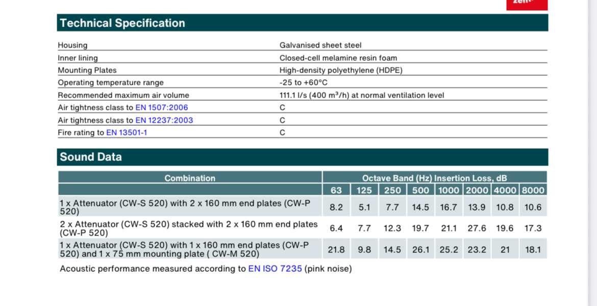

Looked into this more thoroughly. I had thought you needed to be buy the manifold and also the attenuator, as well as both end plates (1x160 and 10x75). It appears I’d only need the attenuator and the end plates, which makes the cost slightly more palatable.
Looking at the data and particularly at the low frequencies, what I find hard to get my head round is how 2x attenuators stacked, performs worse than only 1x at the low frequencies. Whats also slightly concerning is no 32Hz as part of their test. Would be frustrating to spend 300 odd quid and a few hours and not get a satisfactory result!

The main box is an attenuated manifold - item 990323502. Plus you need one end plate with a 150mm connection to suit your 150mm duct (item 990323568, by the look of it), and one end plate with 10 pipe connections (75 or 90mm - 990323614 / 990323615 depending on what you have). So yes, 3 items in total. Check those codes though!

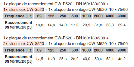

Yes, something counter-intuitive happening there - something to do with the extended dimension -v- the wavelength, I suppose.
However I note that the figures on the last line - with the 10 x 75/90mm end plate - are different to those in the French brochure. Either the English or the French figures have to be wrong (though whichever is correct still gives good attenuation). I just went looking for the German version, but the one I found doesn't quote any figures at all...
Looking again at the French figures, they give them for two connected boxes (160mm end plate + manifold core + manifold core + 10 x 75/90mm end plate) as well as for the single arrangement; the result is more intuitive:
