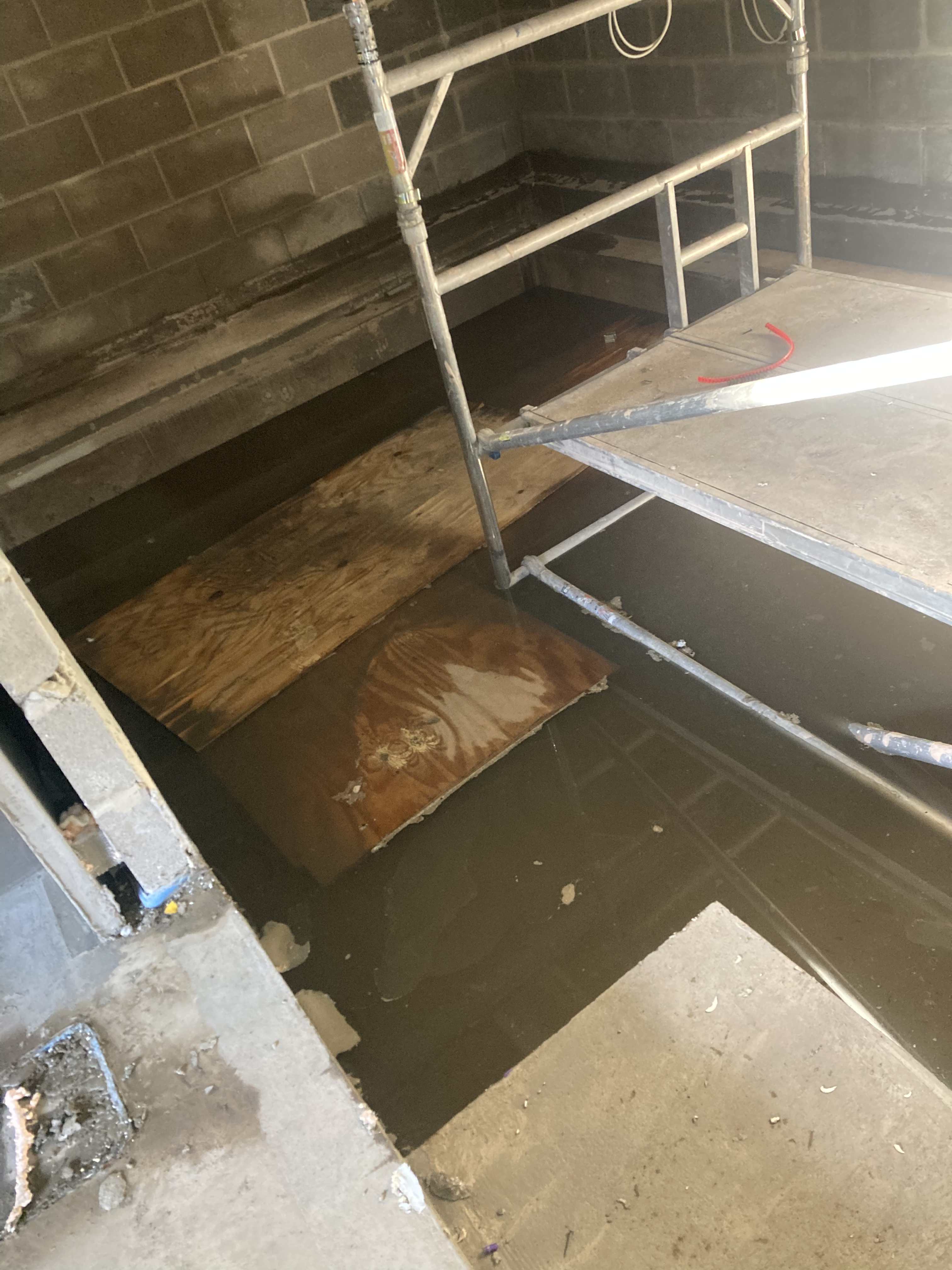

I went to tile a swimming pool last Monday and the tank that collects surface water has two pumps that work off a float One failed and the other couldn’t cope
2000 mil of water in what was a bone dry pool area the day before
