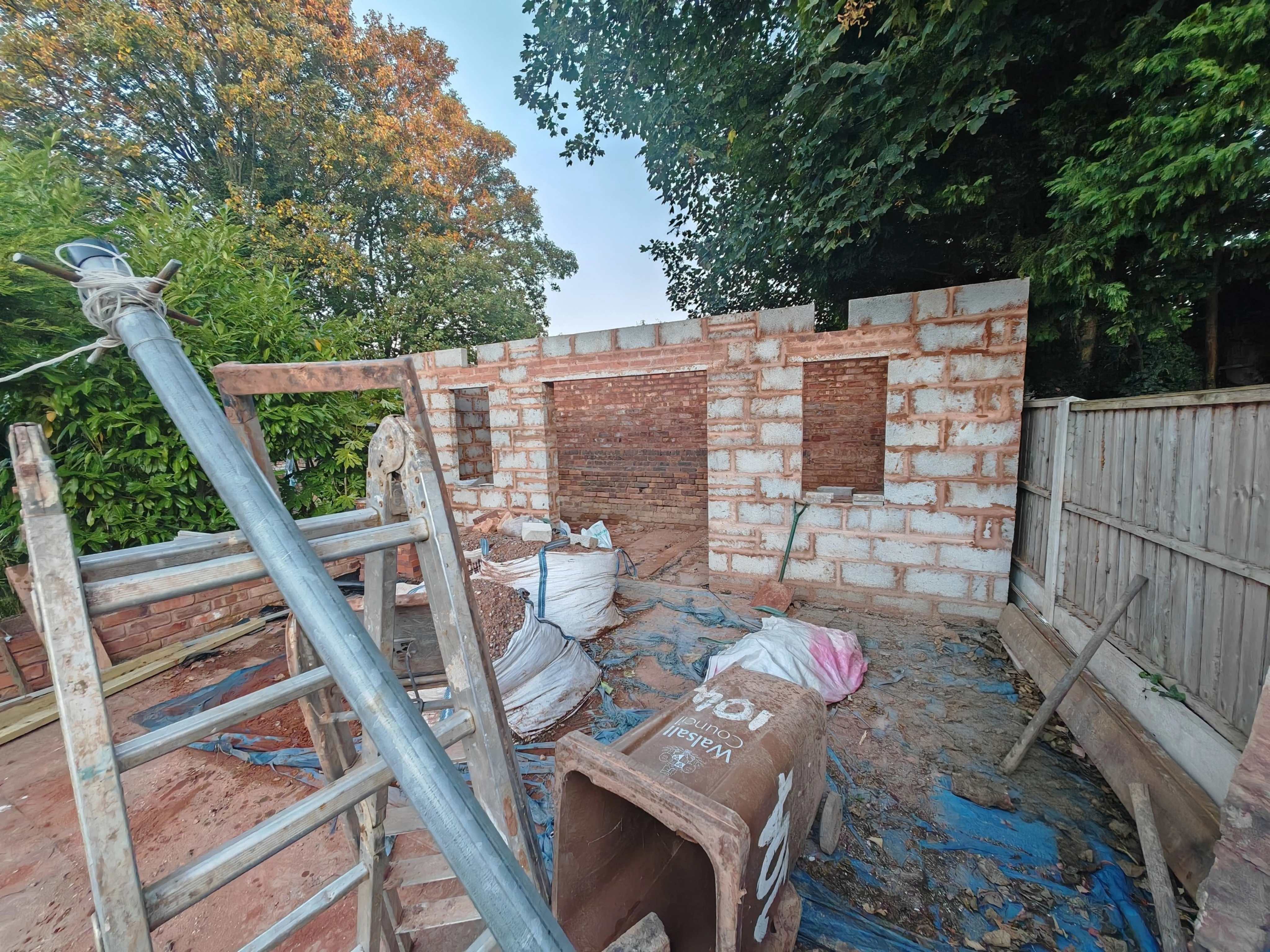

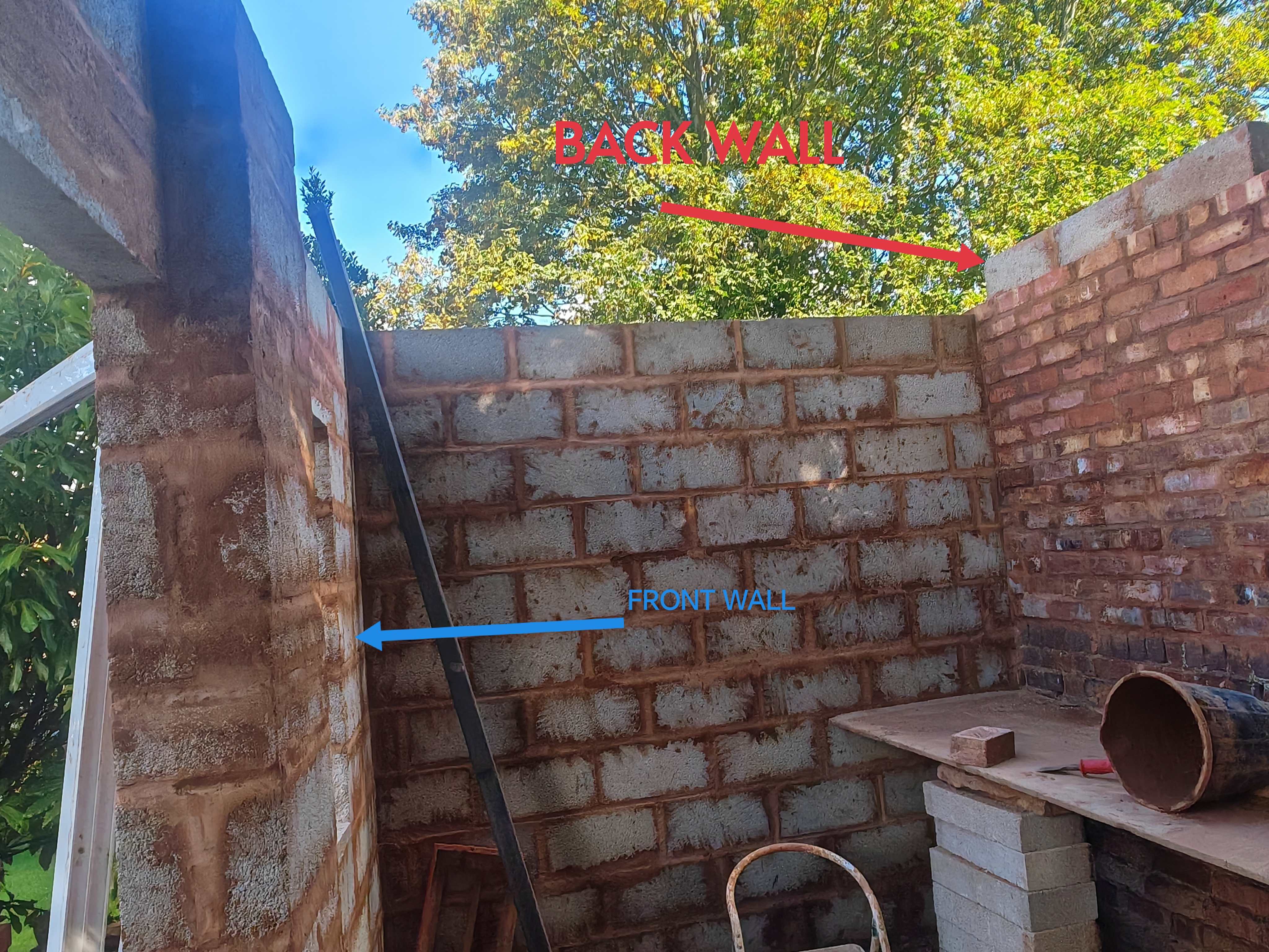

Margaret dailey Posted September 30 Posted September 30 (edited) Hi all, Would really appreciate if somebody would give me some advice. I'm building a block shed at the back of my garden. It's dimensions of it's just under 5.97 m long and 2.6m wide. The front wall is 2.48m high And the back wall is slightly higher at 2.71m I know this isn't much difference in order to create a slope but this is the best we could do. I'm looking to know what size rafters you would use for this mono pitch roof. Also what would be the space between each rafter. And lastly for the wall plate at the back on the higher wall what size timber would you use. I have read for the wall plate, it should be 6x2 and then the rafter in front of this would be 4x2 Please anybody can advise I'd appreciate it. Edited September 30 by Margaret dailey

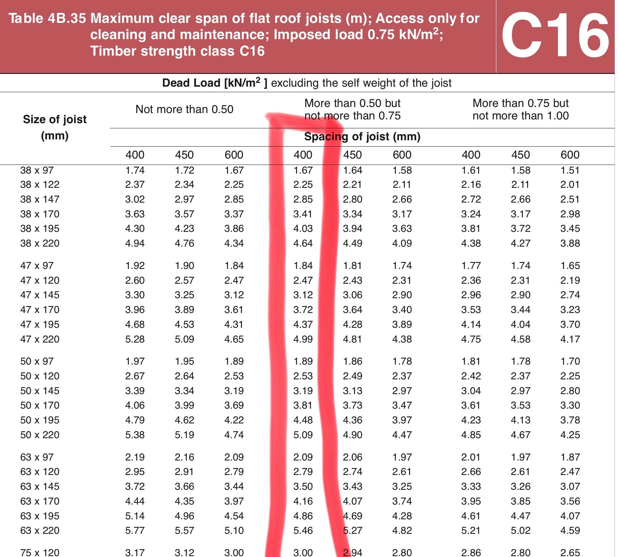

Ajm Posted Wednesday at 07:16 Posted Wednesday at 07:16 this might help https://www.timberbeamcalculator.co.uk/en-gb/span-table/flat-roof-joists?load=1&class=C16
Margaret dailey Posted Wednesday at 07:47 Author Posted Wednesday at 07:47 (edited) Thank you for your response. I had to look at this calculator but I'm not a good person with numbers or maths. It looks like it's telling me if I put the numbers in that I should use 4x2 rafters. I'm not sure if this is correct or not Also this refers to a flat roof but I'm trying to do a pitch roof which I can put roof tiles on. Edited Wednesday at 07:52 by Margaret dailey

kandgmitchell Posted Wednesday at 18:40 Posted Wednesday at 18:40 For a "flat" roof like that with EPDM use a minimum of 125mm x 50mm at 400mm cntrs for a span of up to 2.67m. The ply will come in 2440 x 1220 sheets and 400 fits with that better than 500 so that as many of the edges are supported on joists and you aren't cutting sheets down. The wall plate, if it's being bolted to the face of the wall can be 100 x 50 as it's the bolts really doing the work as long as the spacing of the bolts is sensible at say 600mm.

ETC Posted Wednesday at 21:24 Posted Wednesday at 21:24 Use the table I posted for flat roof joists. Install them at 400mm centres. Use a 100mmx50mm treated softwood wall plate strapped to the wall at maximum 2.0m centres. Straps should be 1000mmx30mmx5mm. Strap the end walls across three flat roof joists with the same straps and timber noggings between. Any joiner worth his salt will have that roof on in a morning.

Ajm Posted Thursday at 07:17 Posted Thursday at 07:17 Have a look at this thread on another forum: https://www.ukworkshop.co.uk/threads/help-how-to-fix-a-wall-plate.133457/ it shows how the wall plate rests on top of the wall (bedded on mortar) and straps go across it and down the wall to tie it all down. Then rafters are fixed to wall plate using brackets. In my experience 4x2 for wall plate is fine when used in this way. Looking at the span tables I would say 5x2 a bit small, I would use 6x2 (145x47)
Margaret dailey Posted Thursday at 08:12 Author Posted Thursday at 08:12 (edited) Thanks again. As I mentioned before you are referring to the wall plate that is fitted to the front wall. I've managed to work out from your previous instructions that that would be a 4B2 laid flat and mortared to the top of block wall and then strapped down. But I'm asking what type timber would you use as a wall plate for the back wall that's slightly higher to create a slope. Or are you saying that even the timber used on the back wall should not be bolted to the wall but laid flat on the top block and mortared just like the wall plate on the front block. My understanding has always been the back wall plate is bolted to the wall. I've asked my grandson to send a pic. You can see from the arrows there's a front wall which is where your instructions about mortoring the 4B2 flat will be done. But if you can see the other red arrow and the back wall which is higher. The wall was made out of bricks but the top course we used concrete blocks. Are you saying then on this back wall I also lay a 4x2 flat on top of the block and mortor it down and add straps to this as well. Or do you bolt a piece of timber along the side of the block. Really sorry to be a nuisance about this but I think there was some confusion about whether I was talking about the front wall or the back wall. Edited Thursday at 08:13 by Margaret dailey
Ajm Posted Thursday at 08:48 Posted Thursday at 08:48 For a flat (or slightly sloping roof like this) I would always lay the wall plate flat on top of the wall, both front and back the same. Both strapped down. The only times I'ver bolted a plate to the face of the wall is when putting a single storey flat roof extension on a two storey house, so the 'back' wall extends above the flat roof.
Margaret dailey Posted Thursday at 08:58 Author Posted Thursday at 08:58 Oh ok I got you now. I think every thing I've ever read about bolting a timber to the back wall for the rafters to sit on has always been referenced to sloping roof. But obviously this one is not going to be much sloping so I understand what you're trying to say now. so I understand when the rafter comes down and sits on top of the flat wall plate on the front wall and then you bolt this down using the straps and even brackets just like the guy did on the link you sent me. But how do I do that to the rafter sitting on top of a flat plate on the back wall. Because that rafter is going upwards so will not sit flush with the flat timber on top of the block. I understand you're saying that I have to strap that timber down as well. But what am I doing to secure the top part of the rafter to that flat plate because they are both mismatched. Rafter will be going upwards so just the bottom piece of the rafter will be touching or resting on the back wall plate.

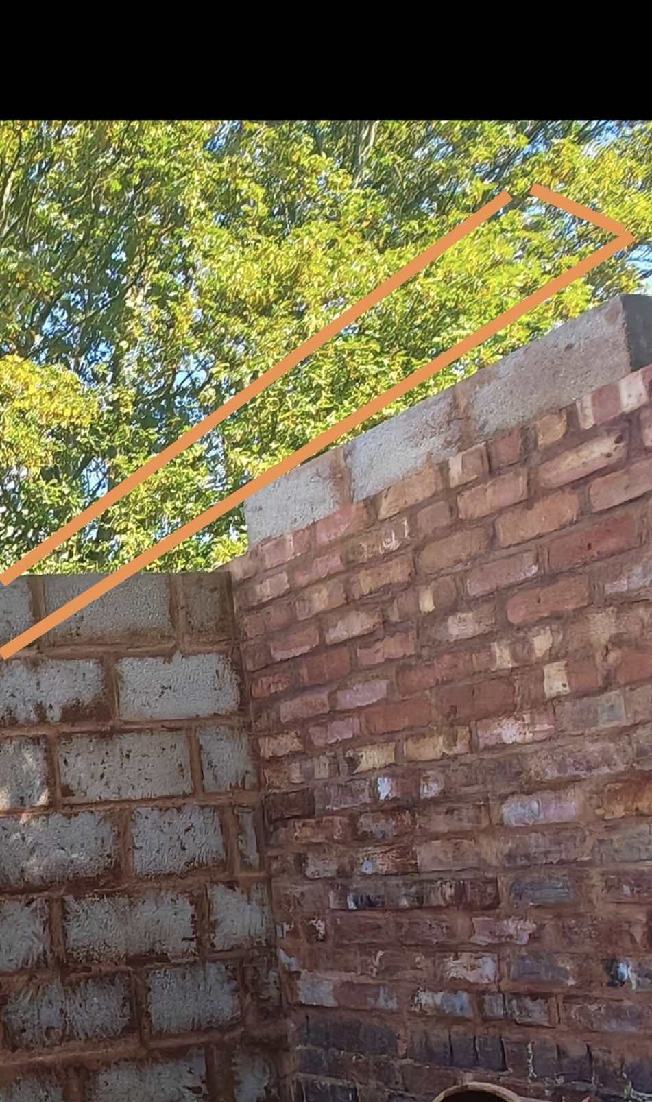

Margaret dailey Posted Thursday at 09:05 Author Posted Thursday at 09:05 (edited) Edited Thursday at 09:07 by Margaret dailey
Margaret dailey Posted Thursday at 09:07 Author Posted Thursday at 09:07 Sos for the poor drawing But I hope you understand what I'm trying to say. That back rafter will be going towards the sky and normally you would just cut it so it sits flush and then fixed it to the the wall plate you have bolted to the blocks. But here the rafter is going up and the wall plate is been laid flat.
