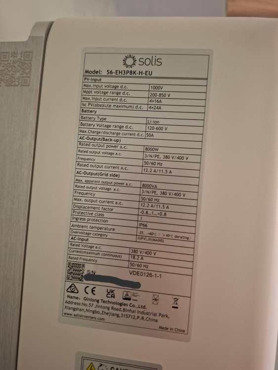

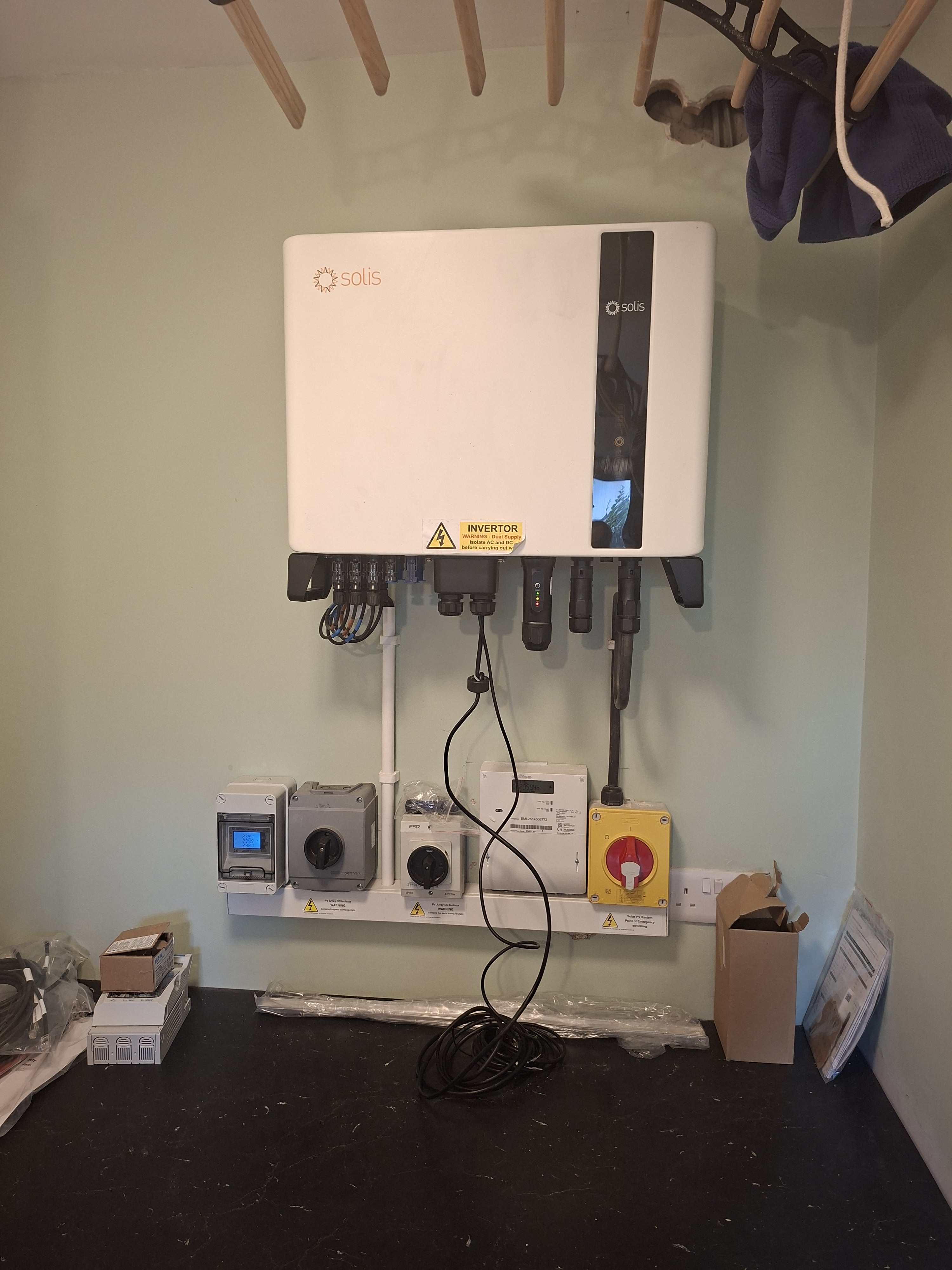

CalvinHobbes Posted September 21 Posted September 21 Hello, so we have just under 12kw of panels on roof, an 8kw inverter and on Monday 5.12kw x 2 batteries are being installed. All this talk of Putin and war is making me think of putting in a few sockets next to the inverter. What is the least expensive way of doing this, can it be an automatic switch? I just don't know what to ask for.

-rick- Posted September 21 Posted September 21 (edited) Looks like this inverter only has an EPS output for when the grid is down. So needs to be separately wired to circuits that need to be protected by the battery. It's a beefy inverter though so could probably power your whole house from the EPS output in all but the most unusal situations. If you want to do this properly you would ask for some of your house circuits to be moved to a separate consumer unit and have that wired via changeover switch to both the EPS output of the inverter and your normal consumer unit. Big change at this late stage though. Your idea of a few sockets near the inverter is a good one. You will likely need a small consumer unit with an rcbo in it to liimt the current to that circuit, not a big job but maybe one that the installer doesn't want. Oh, and if the shit really hits the fan with Putin, this system is unlikely to really help. But emergency backup would be good for less extreme emergencies. Putin is like all bullies, take as much as he can until he gets real push back then he'll stop. He was talking to Xi about living to 150, someone who has that ambition isn't going to commit suicide. Edited September 21 by -rick-
JohnMo Posted September 21 Posted September 21 9 minutes ago, -rick- said: you want to do this properly you would ask for some of your house circuits to be moved to a separate consumer unit and have that wired via changeover switch to both the EPS output of the inverter and your normal consumer unit. Big change at this late stage though That's what I liked about the GivEnergy AIO, once you find a home for the gateway, it does it all out the box, no house changes needed.
G and J Posted September 21 Posted September 21 I’m going for a split board with a battery that can run in island mode supplying one side of the board. I’ll run lights, internet, WiFi, MVHR and a set of charging sockets off the battery backed side, but I like the idea of a couple of sockets in the utility room that I can plug stuff I didn’t think of protecting into. Fab addition to the plan.
JohnMo Posted September 21 Posted September 21 43 minutes ago, G and J said: I’m going for a split board with a battery that can run in island mode supplying one side of the board. I’ll run lights, internet, WiFi, MVHR and a set of charging sockets off the battery backed side, but I like the idea of a couple of sockets in the utility room that I can plug stuff I didn’t think of protecting into. Fab addition to the plan. For the small uplift in AC coupled battery cost, why would you add the extra complication to just let your house limp? I get the full 6kW available from inverter plus what ever PV is generating. So heat pump runs, can cook the tea etc. power cut just go unnoticed.
