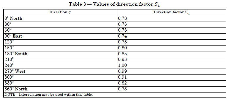

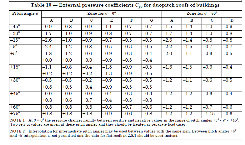

Gus Potter Posted September 22, 2025 Posted September 22, 2025 (edited) On 21/09/2025 at 13:58, Roger440 said: With a storm incoming, i decided to put some straps up the bedroom wall onto the rafters, in addtion to my other efforts. Every third rafter. Which is closer than required by BC as i understand it, but im onto the rafters at 45 degrees rather than a wall plate at 90. So obviously not as effective. Well done, bit of belt and braces works.. it would look a lot worse if the roof blows off! You mention 45 deg roof slope, these in general tend to be less vulnerable than roofs with a 5 -10 degree pitch for wind uplift. Much depends on the wind direction. For a bit of fun and to cut short the wind calculation we first calculate the site wind speed and then convert that using factors for the height of the building and orientation and so on. The worst case wind load often comes from 240 degrees and in terms of roof orientation we look at how the roof faces and apply a direction factor. I screen shotted some tables from the British standard that lets you see how we reduce the wind load depending on which face of the building / roof we are considering and the wind direction. NOTE here I'm not considering a quatering wind like the Citicorp building as has featured on BH... and I'm assuming the topography is reasonable benign.. ie you are not at the top of a cliff or on the upperside of a hill. But it's an old house you've got so let keep things simple and qualitative. In the above you can see that a 240 degree wind gets no reduction but a North wind gets reduced by a factor of 0.78. Now if you have a look on U tube ( and I've have seen myself) at videos of roofs getting blown off, intially you often see some rippling movement at the edges / verges or ridge of the roof.. it's often tiny but here the high local suction lifts an edge, the wind gets into the roof which increases the roof internal pressure that cause the drama of the whole roof flying off. To stop that we need to keep the vulnerable edges and occasionally bits around chimneys well tied down. Roughly to calculate the wind load on small parts of the roof we take the wind pressure and multiply it by a local coefficient to give the local pressure, in this case we are interested in the local suction loads. Below is a diagram that shows the wind directions and the notation for a due pitched roof. The above lets you understand the table below which shows the external coefficients that are applied to the wind loads for a duo pitch roof. In the table above the positive values indicate wind pressure.. a downwards load on the roof zone.. which is beneficial. The negative values are the suction coefficients. The wind load in the tables above is calculated as being applied perpendicular to the plane of the rafter (snow loads and roof access loads are on plan load so applied differently) thus the we need to calculate the vertical uplift component of load when designing the holding down straps. We take the perpendicular load and divide it by the square root of 2 = 1.41. One thing you can easily take away from the above table 10 is that flatter roofs are more onerously loaded in suction than a roof in the region of 45 degees. But the 45 degree roofs are still vulnerable when the wind is blowing on the gables or quartering to some extent. On 21/09/2025 at 13:58, Roger440 said: The thing that has changed is the introduction of ventilation into the roof space. If you have a study of this Roger it may hopefully inform and you can have a bit of fun looking at the values. The roof ventilation effective area is probably small, call it more trickle ventilation and thus is unlikely to dominate the internal roof wind pressure which gets added to the roof external suction. One word of caution again, if you have some significant topography then this can be significant. From time to time if say building near a big farm shed we may need to look at any wind funneling effects, but this mostly applies to walls. Edited September 22, 2025 by Gus Potter 1
Roger440 Posted September 22, 2025 Author Posted September 22, 2025 2 hours ago, Gus Potter said: Well done, bit of belt and braces works.. it would look a lot worse if the roof blows off! You mention 45 deg roof slope, these in general tend to be less vulnerable than roofs with a 5 -10 degree pitch for wind uplift. Much depends on the wind direction. For a bit of fun and to cut short the wind calculation we first calculate the site wind speed and then convert that using factors for the height of the building and orientation and so on. The worst case wind load often comes from 240 degrees and in terms of roof orientation we look at how the roof faces and apply a direction factor. I screen shotted some tables from the British standard that lets you see how we reduce the wind load depending on which face of the building / roof we are considering and the wind direction. NOTE here I'm not considering a quatering wind like the Citicorp building as has featured on BH... and I'm assuming the topography is reasonable benign.. ie you are not at the top of a cliff or on the upperside of a hill. But it's an old house you've got so let keep things simple and qualitative. In the above you can see that a 240 degree wind gets no reduction but a North wind gets reduced by a factor of 0.78. Now if you have a look on U tube ( and I've have seen myself) at videos of roofs getting blown off, intially you often see some rippling movement at the edges / verges or ridge of the roof.. it's often tiny but here the high local suction lifts an edge, the wind gets into the roof which increases the roof internal pressure that cause the drama of the whole roof flying off. To stop that we need to keep the vulnerable edges and occasionally bits around chimneys well tied down. Roughly to calculate the wind load on small parts of the roof we take the wind pressure and multiply it by a local coefficient to give the local pressure, in this case we are interested in the local suction loads. Below is a diagram that shows the wind directions and the notation for a due pitched roof. The above lets you understand the table below which shows the external coefficients that are applied to the wind loads for a duo pitch roof. In the table above the positive values indicate wind pressure.. a downwards load on the roof zone.. which is beneficial. The negative values are the suction coefficients. The wind load in the tables above is calculated as being applied perpendicular to the plane of the rafter (snow loads and roof access loads are on plan load so applied differently) thus the we need to calculate the vertical uplift component of load when designing the holding down straps. We take the perpendicular load and divide it by the square root of 2 = 1.41. One thing you can easily take away from the above table 10 is that flatter roofs are more onerously loaded in suction than a roof in the region of 45 degees. But the 45 degree roofs are still vulnerable when the wind is blowing on the gables or quartering to some extent. If you have a study of this Roger it may hopefully inform and you can have a bit of fun looking at the values. The roof ventilation effective area is probably small, call it more trickle ventilation and thus is unlikely to dominate the internal roof wind pressure which gets added to the roof external suction. One word of caution again, if you have some significant topography then this can be significant. From time to time if say building near a big farm shed we may need to look at any wind funneling effects, but this mostly applies to walls. Thanks for the explanation. If im honest, its probably beyond my comprehension from a maths perspective. The wind table is that where the wind is coming from or going to? The house is in a sizeable "hole" with big hills all around. Prevailing wind is, as normal (im in mid wales) from the south west, shielded by a massive bank of conifers, my barn, and behind that a 400ft high hill. Still 900ft up though. But, im not really able to interprete your excellent information to any useful extent.
saveasteading Posted September 22, 2025 Posted September 22, 2025 27 minutes ago, Roger440 said: where the wind is coming from From. so 180 is south, 270 is west . as you say the prevailing wind is SW so 225. 29 minutes ago, Roger440 said: in a sizeable "hole" with big hills all around. That could be a bit sheltered or cause funnelling. But the design guides allow for that, ie not allowing any reduction for real or perceived shelter. On 13/09/2025 at 15:38, Roger440 said: Am i over worrying? No, this is all very sensible. If you keep to standard detailing all will be good. As Gus says, the exposed edges are most vulnerable rather than the whole roof. After gales you will often see loose bits of roof hanging off, but seldom an area of roof. On the steel buildings I worked with mostly. there were standard details for fixings and the eaves corners received twice as many screws as the mid sections. 2
