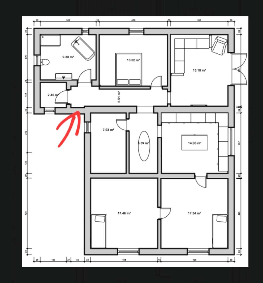

Hopefully the last time I bother you all with my floor. Next week I will be pouring the concrete floor in the house in renovating and looking for advice and tips. It's an old house with stone foundations, I dug out the old rubble that the old wood floor was sat on until I got to compacted ground and now have the following:
 -sand blinding
-30mm eps
-Dpm
-Insulation (200mm EPS in some places and 100mm PIR in others)
-underfloor heating foil
-underfloor heating pipes stapled to insulation
-4mm composite rebar 150x150 on 50mm chairs
-30mm EPS insulation around edges and an expansion foam skirt
I'll be getting the concrete delivered with a pump truck and hoses in one go. The main entrance is marked with the red arrow in the picture before, I'll start in the back room and work my way towards the entrance. It's approx 110m2 in total.
My questions are:
How do I make joints between the rooms taking into account there will be underfloor heating pipes going through doorways. Should the slabs be completely separate for each room to avoid cracking and allow expansion?
What advice and tips do you have to successfully pour it all. It will be the finish floor (just tiles and laminate going on top) so I need it smooth and level. I guess I need long straight pieces of wood or something for screeding. Should I make one for each room the full width of the room for screeding? but what do you normally use to screed from (like rails)
Then a bull float and keep working back through the house to the entrance. And then I believe after it starts to dry a little you trowel it up? How long after pouring is this normally?
Any advice or tips would be great.

I would recommend you get some experience help with this as it'll be a mess if it goes wrong.  What kind of team have you currently lined up?
You could build an expansion joint into the doors to allow it to crack there.
I wouldn't fret too much about DPC's in the walls but would ensure that the localises water table is well below it.
You might need to add a french drain to the house if it isn't.
The rest of the plan sounds fine.
Thanks for the advice.
Currently I have a few people who have no experience but are useful for lugging around hoses where we need them, then there's me and one or hopefully two more people who are not professional builders but pretty good with this stuff and some experience of building work. I will see if I can get someone with experience but not sure if that will be possible yet.
I'm thinking to use 100mm eps in all the doorways, set to the level of my concrete and put outer conduit pipe for my underfloor heating pipes to pass through, and tape up the ends. This will then make each room completely separate with it's own slab. I can then just put my flooring straight over the EPS.
The water table is pretty high but the foundations come up above the ground quite a lot so my dpc and floor layer is well above water table. But I am also in the process of digging a french drain as well.
Looking at local rental shops and see they have the vibrating bull floats and wondering if it's worth hiring one or just using a normal one
Not something I've done lots of but this looks quite challenging to me given all your walls are in place and you've got to work your way out via three or four rooms, much harder than having access from all around the slab.
You've quite a lot of concrete and limited access and working time while aiming for a finish you can tile on. How are you setting your level throughout the building? You don't want high spots and I'd be prepared to accept being a bit low in corners that are hard to reach if you're feeling pushed for working time and budget for some self leveling compound. It looks tricky to get back through to trowel over too.
Would it cost much more to do two pours? looks like a single doorway divides the top and bottom of the floorplan. That might take the pressure off a bit and let you see how the first one goes. As @Iceverge said this is messy if it goes wrong.

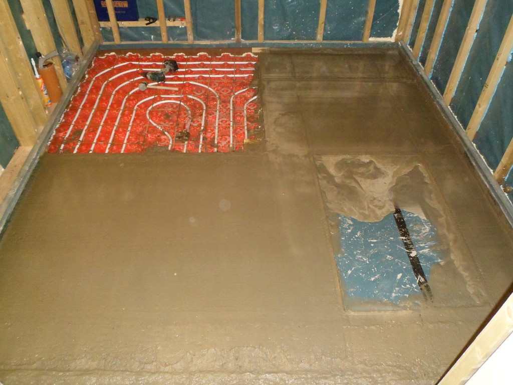

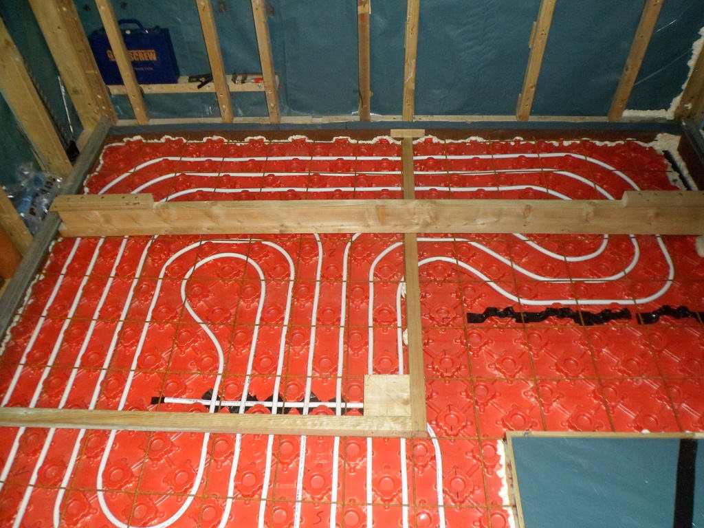

My 3x3m bathroom. I screwed "screed rails", (actually lengths of Unistrut), either side and made a tamping board. 100mm of wet concrete. Came out flatter than a flat thing.
24522042074_def25b7c61_b.jpg.100f2540450c2f7de16aec2e9a2f551f.thumb.jpg.8d1118ae0f797498f2b412cf22c26e56.jpg
25152711065_e657ae555a_b.jpg.b9d82cb2be22ebc6715fdffc046c2209.thumb.jpg.e572138003e4334337b26a34269fedd4.jpg
This is my room at the stage where the Type 2 hardcore on compacted ground had been sand blinded then had 25mm lain over it:

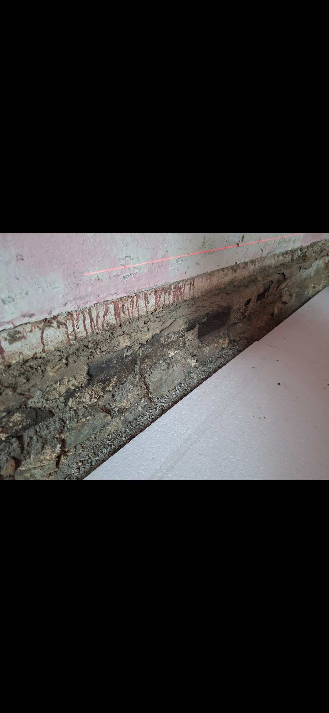

I squared of the old footings with shuttered concrete. The original tar DPC is at the top of the breeze block:
SAM_1121
I then painted liquid DPM up to the tar DPC:
SAM_1132
Then stuck 2" of EPS as perimeter insulation:

@Onoff nice job and that's closer to the size of floor I've done when renovating. The method works well, room or two at a time, even if inexperienced.
I don't think I'd have been confident to handle another 10 times the volume of concrete being poured in the next hour or two throughout the house though.

Where your original DPC is, I’d black jack the area, 100mm below, and 100mm above as insurance, as once you’ve poured there’s no going back. Use a 75% water / 25% mix of liquid DPM product to prime the areas that you intend to then brush the liquid DPC on to, as brushing onto friable masonry that has not been ‘sized’ will be a pita and it’ll pull off very easily. Priming will allow the product to soak into the surface, providing an excellent key for the surface applied layer(s). A good few £££ to go on this, but I’d be doing this if it were my place.
