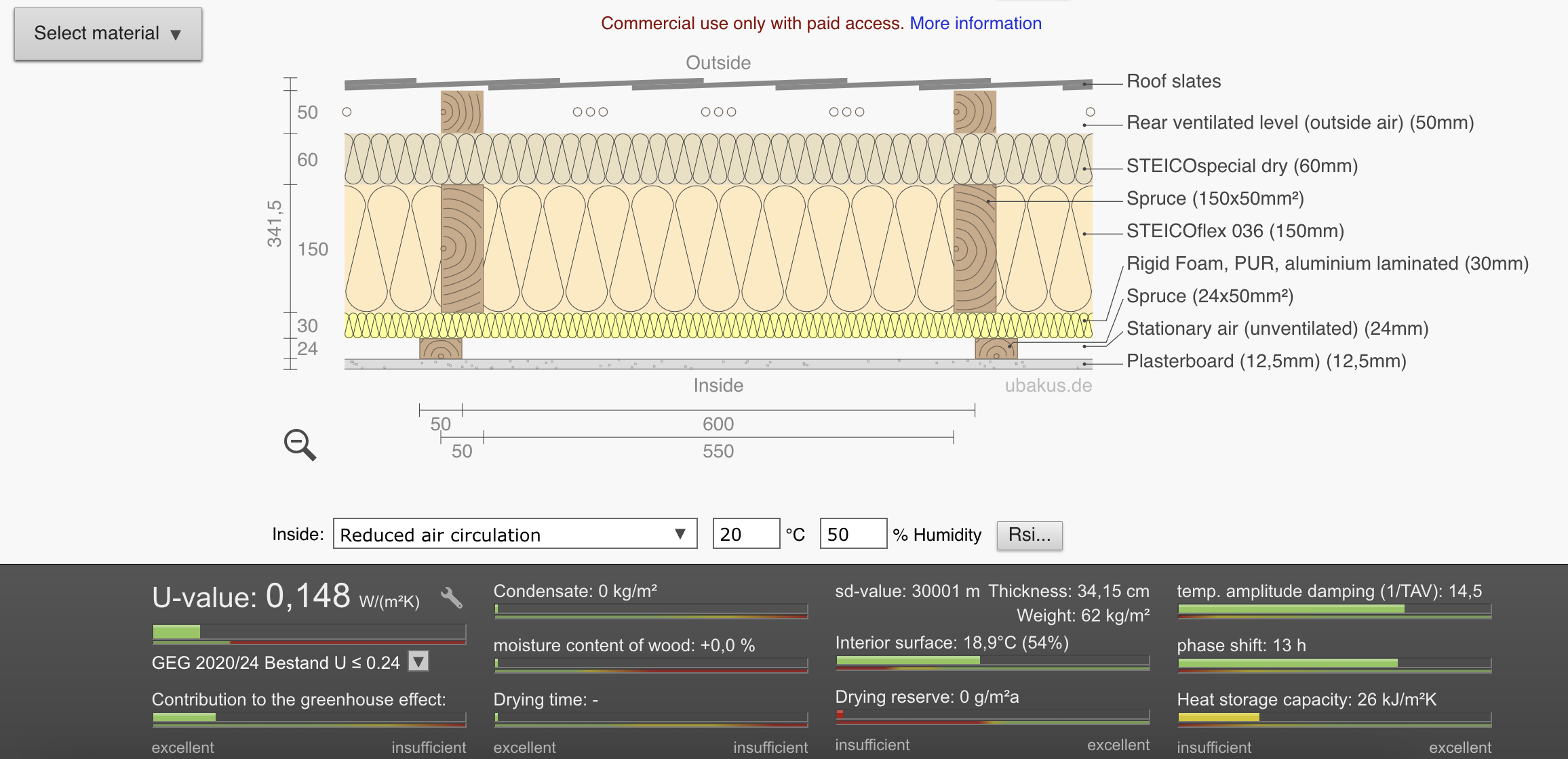

lookseehear Posted Saturday at 20:33 Posted Saturday at 20:33 We’re in the final stages of planning our re-roof. The engineer has specified 150 mm rafters, supported by a steel ridge beam. Our architect is encouraging us to use wood fibre insulation for its thermal mass and decrement delay (since the main living space will be upstairs), which I’m increasingly drawn to. The builder, however, would prefer PIR spray-foamed between the rafters, with multifoil stapled underneath, counter-battened to create a service void, and finished with plasterboard and skim. We’re already raising the roof height slightly beyond what was approved in planning (approval was for a 200 mm increase). If we fully fill the rafters with Steico Flex, plus add 60 mm of Steico Special Dry sarking board on top, we achieve roughly a 0.19 W/m²K U-value. I think adding multifoil underneath could bring us down to the required 0.15, while also serving as a vapour control layer—and it would keep the builder happy. My understanding is that multifoil requires a low-emissivity cavity, which in practice means leaving an air gap between the multifoil and the plasterboard. Still, it feels unusual to see it specified as part of a roof build-up. Am I missing something here? Are there obvious alternatives I should be considering?

lookseehear Posted Sunday at 10:07 Author Posted Sunday at 10:07 10 hours ago, bmj1 said: I don't understand why your architect is making this complicated. The standard approach is PIR boards cut to fit with any gaps foamed and joints taped, then plasterboard. Keep it simple! Multifoil is very controversial in the industry and so I would probably steer clear of it. Just to check you mean PIR under the rafters but still to use Steico within and above the rafters rather than PIR for the whole lot? The reason I didn't want to do this is it removes the service void, but I guess we could just add a service void below the PIR and put the plasterboard on battens.
lookseehear Posted Sunday at 10:15 Author Posted Sunday at 10:15 This would get me to required U value with at least 30mm PIR under the rafters. Am I right in thinking that any cables within service void need to be 50mm back from the surfact, so would need thicker batten?

bmj1 Posted Sunday at 12:43 Posted Sunday at 12:43 Is the reason for choosing steico because you need it to be vapour permeable ? If so - then PIR underneath will defeat this element. If the overall buildup does not need to be vapour permeable, then it's fine to have a mixture of impermeable (like PIR) and permeable, as long as the vapour permeable is on the outer layer (doing it the other way around risks interstitial condensation).
lookseehear Posted Sunday at 13:45 Author Posted Sunday at 13:45 55 minutes ago, bmj1 said: Is the reason for choosing steico because you need it to be vapour permeable ? If so - then PIR underneath will defeat this element. If the overall buildup does not need to be vapour permeable, then it's fine to have a mixture of impermeable (like PIR) and permeable, as long as the vapour permeable is on the outer layer (doing it the other way around risks interstitial condensation). I don't plan on making the roof vapour permeable from the inside, and am planning a VCL under the rafters to achieve this. The Steico is for decrement delay reasons as well as 'better for the planet' reasons. It's hard to know how a space is going to react in the heat of summer, but it would suck to go through all of this then feel we need some kind of cooling solution when we could have fixed it with an insulation that performs better vs heat. 1 hour ago, JamesP said: and 11mm OSB( for racking) instead of your 30mm PIR. Steico's standard roof buildup doesn't seem to include a structural board for racking, but I imagine it's probably preferable? How do you find your roof performs on hot days?

Iceverge Posted Sunday at 15:10 Posted Sunday at 15:10 3 hours ago, lookseehear said: was going to use multifoil taped to parged walls as VCL/airtightness layer on the inside of rafters but if I do PIR underneath I would assume that a continuous layer with joints taped and taped back to parged wall would be sufficient. Yes that would be fine. The internal layout matters somewhat on the location of your airtight layer however If you have a lot of funky junctions or timbers or internal walls that can't be erected post roof build I'd be in favour of moving the Airtightness layer to above the rafters. 3 hours ago, lookseehear said: Steico flex is (from my understanding) easy to fit between rafters in a snug way (held in place with battens), It should just friction fit I think. It's nice stuff but much dearer than the equivalent mineral wool. I'm a big fan of including insulation above the rafters. Keeps the timber thermally stable and you'll have less chance of rot etc. 3 hours ago, lookseehear said: These will be on top of existing roof, so that roof timbers can go on top and the existing roof can be removed in a phased way. Ok cool. Is the design of the cut roof set in stone? Can I get a cross section of the proposed structure? 2 hours ago, bmj1 said: then it's fine to have a mixture of impermeable (like PIR) and permeable, as long as the vapour permeable is on the outer layer (doing it the other way around risks interstitial condensation). Works both ways actually, structures can dry in as well as out. It's bad airtightness that is the culprit for interstitial condensation. A single hole the size of a 50p will let more moisture into a roof than the entirety of diffusion over a 100m².
