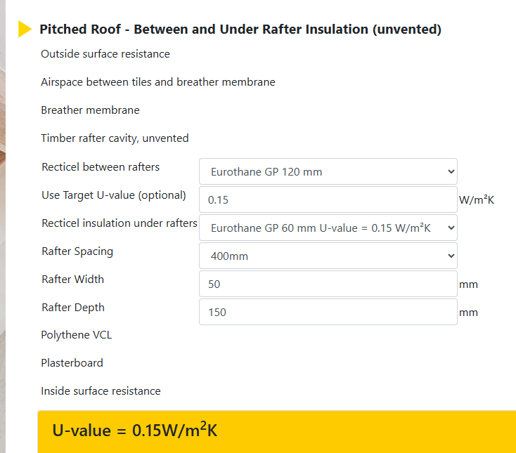

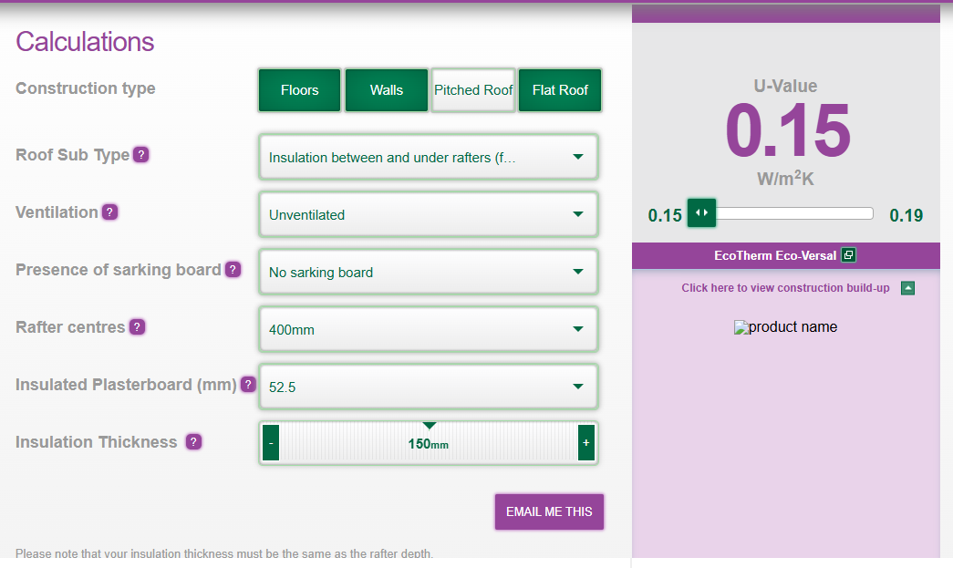

I've checked with the SE and no sarking board or 'racking' layer required.
I'm thinking about taking the simple route here and going with PIR between and under the rafters. I've been on a few websites (ecotherm, recticel etc) and they seem to indicate that a 50mm ventilation gap isn't required providing a breather membrane is used, but that maybe you need to leave at least 25mm of rafter 'unfilled' and potentially counterbatten as well. Ecotherm calc below showing 'fully filled' with 150mm PIR, with 40mm underneath to get to 0.15, and Recticel only showing 120mm in 150mm rafter.
Is going 'unvented' a bit of a risk or are modern breather membranes combined with a good VCL underneath sufficient to ensure no risk of condensation?
Edited by lookseehear
The answer below is based on non direct experience. BTW i'm in a similar position in that I need to get roof insulation done but just haven't decided how its going to be done.
I think the risk with non breathable materials is that if any moisture seeps through any compromise in the air tightness then there will be risk of condensation on the rafters when the moisture reaches the cold side of the insulation. Although breathable materials won't provide a comparable U-value to PIR for the same level of thickness it is considered possibly safer route especially for retro fitting old properties.
Incidently what is the depth of your rafters?
It’s a brand new roof, so it’s actually less of a retrofit. Rafters are 150mm.
i think you’re right that the risk is higher, I just can’t work out how much higher and if it’s allowable by Recticel etc then maybe the risk is mitigated by decent breather membranes and a small amount of ventilation from counter battening and not having the insulation jammed against the breather.
