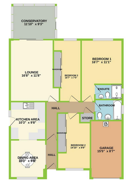

September 5, 20251 yr Hi, i'm looking for some advice on how we might accommodate going in to the loft of our bungalow please. we're not looking to make wholesale changes to the property but we would like to go in to the attic so just trying to figure out the best place for stairs any help/thoughts appreciated thanks
September 5, 20251 yr My thought: split Bedroom 3 horizontally, u-shaped/half turn stairs in lower part. Upper part turned into dresser/walk in wardrobe for bedroom 1 and/or extra space in lounge. Replace bedroom 3 upstairs.
September 5, 20251 yr Author ok interesting, had not even considered that, was looking more at bedroom 2 to replace that and make hallway wider..

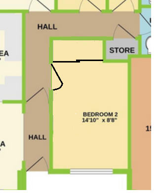

September 5, 20251 yr 22 minutes ago, DWBungalow said: ok interesting, had not even considered that, was looking more at bedroom 2 to replace that and make hallway wider.. Bedroom 3 seemed like the more awkward space as is so would benefit more from a change. Having said that making the hallway wider is a good idea. You are somewhat limited by the window in bedroom 2. Depending on your appetite to make changes you could potentially do as I propose and also do the hall way. First, rearranging the entrance and built in units for bedroom 2 would create a much better space IMO and should be relatively trivial/easy. Depending on the construction (load bearing walls/foundations) it may be possible to move the wall in at the same time creating that wider hallway while stlil having a more spacious feeling bedroom: I should note I've not considered any regulations when proposing any of this. Others here are more familiar, there may be something that that trips this up.
September 5, 20251 yr Author great thank you. had not even considered moving that door way for bedroom 2! another great idea to think about. thanks!

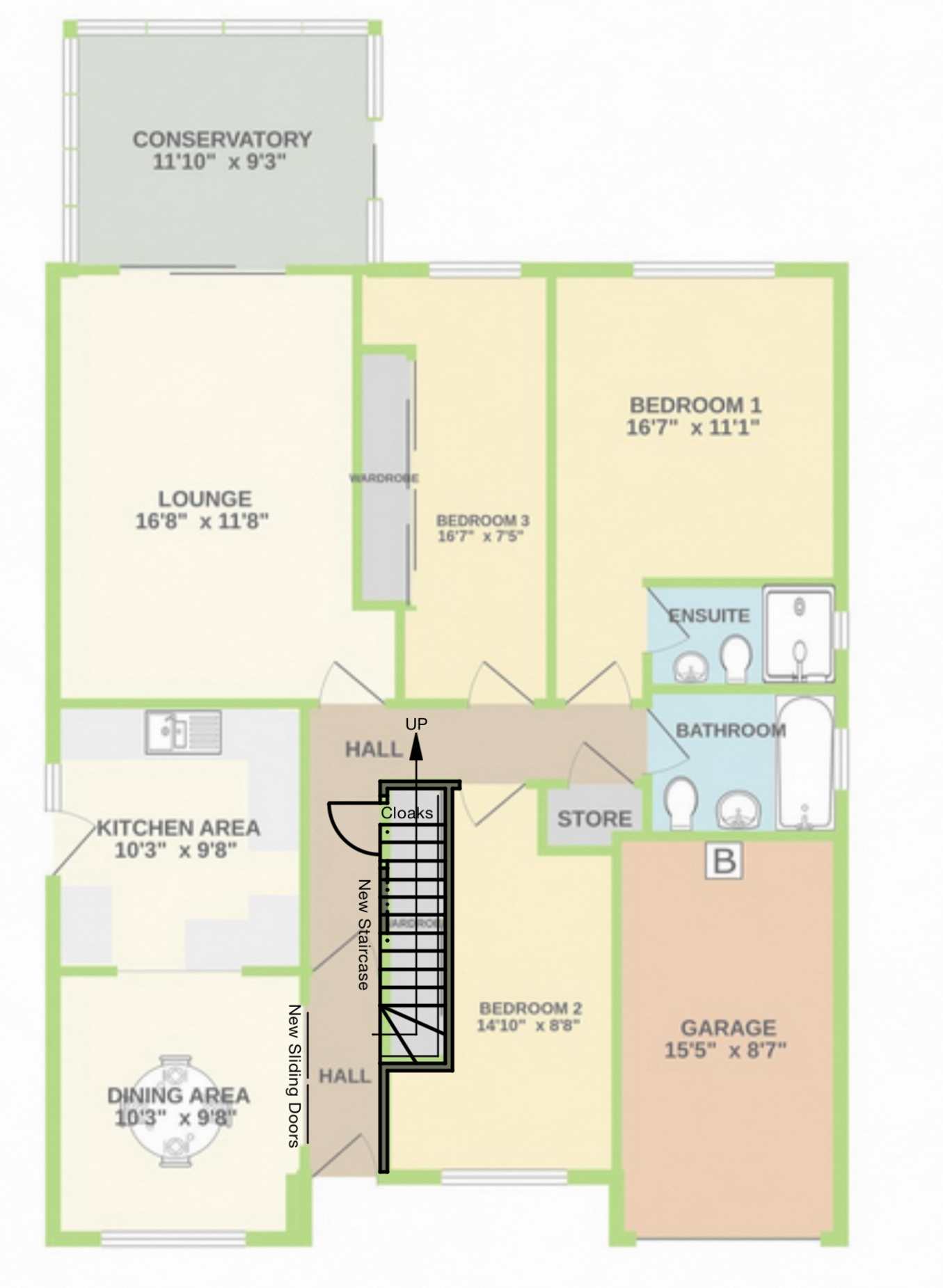

September 5, 20251 yr Author 2 hours ago, ETC said: Thanks for this, but I think the bedroom 2 has the potential to feel small then because where you have the stairs are currently built in wardrobes

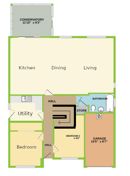

September 5, 20251 yr Author 2 minutes ago, Mike said: Something more radical? This is great and the ideal but also pretty costly I imagine
September 5, 20251 yr 2 hours ago, DWBungalow said: This is great and the ideal but also pretty costly I imagine Not cheap, but the cost will depend on factors such as the roof structure & how much you want to get involved in the work. But if you want to achieve something like it later, then it's worth developing an overall plan now, rather than making things up as you go.
September 6, 20251 yr Author 8 hours ago, Mike said: Not cheap, but the cost will depend on factors such as the roof structure & how much you want to get involved in the work. But if you want to achieve something like it later, then it's worth developing an overall plan now, rather than making things up as you go. Yeah I know the for where you have the living room/dining/kitchen are definitely load bearing. i would try and phase it ideally so i can potentially get the loft and stairs done as a phase 2…. But I need 3 bedrooms…so thats the dilemma
September 6, 20251 yr What shape is your roof? Hip or gable and are any gables front/back or at the sides? Winding anticlockwise from the door into your store and back over the bathroom toilet might work and lose only a limited amount from corners of bed 2 and garage. You already have some quite long but relatively narrow bedrooms, I'd try and avoid anything that narrows them further. What use do you hope for from the loft? Extra bedroom and ensuite?
September 6, 20251 yr 13 hours ago, DWBungalow said: Thanks for this, but I think the bedroom 2 has the potential to feel small then because where you have the stairs are currently built in wardrobes By putting the stairs where I have shown may minimise the amount of demolition you will need to do plus it should get you to the highest point of the roof for headroom upstairs - just a thought.
September 6, 20251 yr 10 hours ago, DWBungalow said: Yeah I know the for where you have the living room/dining/kitchen are definitely load bearing. i would try and phase it ideally so i can potentially get the loft and stairs done as a phase 2…. But I need 3 bedrooms…so thats the dilemma So skip the staircase for now and make this phase 1:

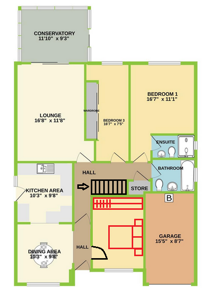

September 9, 20251 yr Coming back to this after taking a while to think. I'm not really coming up with much that hasn't already been suggested. Reconfiguring bedroom two as posted would allow you to widen the hall and potentially allow space at the end for stairs. I like Mikes suggestion best if you want to preserve bedroom 3 as it keeps the top of the stairs fairly central and the rooms fairly square. I would look at reconfiguring the built-in's in bedroom 3 to create a square space for the bed around the window. Simpliest is just deleting the builtin nearest the window. Alternatively it looks like there might be room to slot the wardrobe in next to the door (would mean a narrow corridor) and then putting another at a right angle to that facing the bed/window: If the room was wider I'd have a desk by the window and the bed headboard on the left hand wall but I don't think there's enough room to comfortably pass by the end of the bed. Not really coming up with a good use for the garage without a much more significant remodel. If you widen the hall then putting a wall up with door to separate the hall from the dining room wouldn't be a big issue. Probably lots of layout options within that space depending on your preferences. With a more involved project you might be able to look at stealing a bit of room from the living room but that doesn't seem overly worth it to me.
