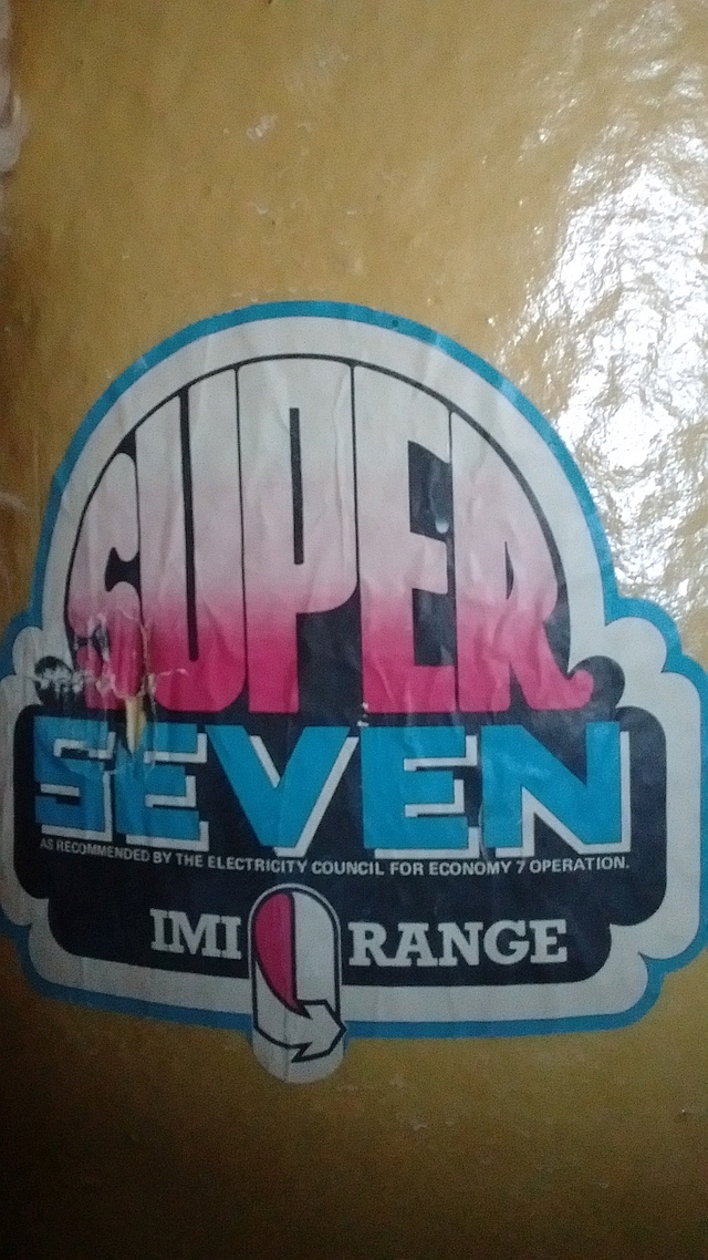

SteamyTea Posted January 6, 2018 Posted January 6, 2018 I am finally going to have to do the element replacement next week. I have a Super Seven cylinder (about 30 years old) and need to change at least the bottom immersion element. The cylinder is approximately 18" (0.46m) wide and 60" (1.52m) tall. When I try and measure it it is a little wider because of the pitifully small amount of insulation, about an inch all around it. Now having a quick look on the interweb, I can get 11" or 14" elements and they can be made from copper, copper and incoloy, incoloy only and seemingly titanium. How as the last element lasted almost 30 years, and I am in a very soft water area (not always good as things dissolve in water, eventually), what should I go for and where is a good online store to get them from. So length and material, and where from. Cheers.
